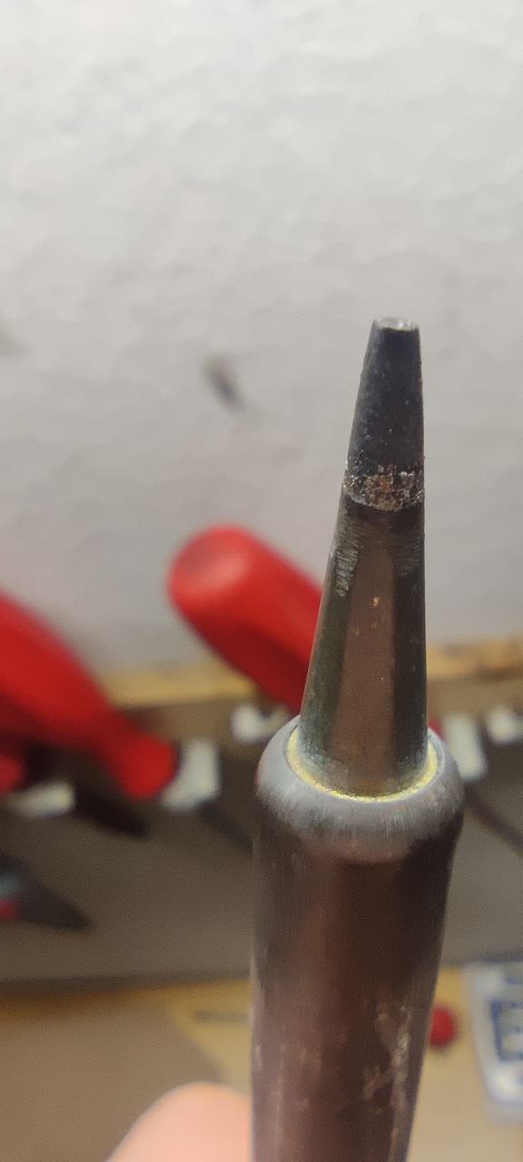

    solder isn't sticking at all to my iron.
    i always tin it when turning it off, not sure maybe i didn't do it properly one time and it oxidized.
    i tried dipping it in rosin and applying tin to try to re-tin in like in some youtube videos, but it don't work
    i also tried very lightly brushing it with a brass sponge to remove the oxidation layer but nothing seems to help.
    why am i having so many issues with this? how do i remove the oxide layer and re-tin it?
    (i can't use tip tinner as they don't sell it here, i had to buy it from the internet but delivery is gonna take a while)
    is there any way i can restore my tip without tip tinner? i've seen people do it with rosin but it doesn't work ((
    https://imgur.com/a/j3l0qSJ pics
    the rosin i'm using: https://www.aliexpress.com/item/1005...martRedirect=y
    also i have a liquid rosin that is transparent, can't remember where i got that tho. not sure what it is but it gets the job done.
    the solder i'm using is likely a 60/40, it doesn't say anything other than it being 2% flux. so since it doesn't specify it's lead free i'm guessing it's a 60/40

    what tip temperature did you use?
    that looks very strange - why is the end of the top not rounded?

      It looks pretty cheap, what you've bought. The tip probably has lousy plating and not much hope for that to work. Try a Hakko tip

          what temperature did you use?
          and never put flux on a tip - it will dry on it and burn

            up to 450c
            about the tip not being rounded- i don't know? it came likes this, there is also a similar tip but rounded

                    450 is too hot - 330-350 is optimal

                      i was soldering some 18650 batteries, most guides said to keep 400-480c because you don't wanna heat up the battery.
                      also, i dont have a welding station, it's just a 60w iron with controllable temp.
                      so being that there is no station the tip loses heat quicker and takes longer to heat back up, also the reason i used high temps.
                      is do stay around 350 for most other stuff tho.
                      is there no way to avoid oxidizing the tip at high temp?

                        o.k. lets start with flux, flux is heat activated acid that keeps oxygen off the solder joint your soldering.
                        if your running 400+ you will oxidise the tip super fast.

                          The tip - it's dead. From your pic, I can see grinding marks (cheap) and porosity, as if it's sintered. I don't remember ever seeing that usually there is a copper core with steel cladding.
                          Plato guide has some good advice:
                          "One of the common causes of tip failure is the loss of this protective layer of solder with the result that the tip working surface becomes oxidized. This is commonly referred to as a detinned tip. Simply stated, it reflects the inability of the tip to accept solder and to efficiently transfer heat to the metals to be joined.
                          Some of the major causes of detinning are:
                          1. Failure to keep the working end of the tip covered with solder during idling periods.
                          2. Operating at high temperatures, which speeds oxidation. Maintain the temperature of 800°F (427°C) or less, whenever possible.
                          3. Use of very small solder wire. Its small diameter carries inadequate flux to keep the tip tinned.
                          4. Lack of flux in the soldering operation. Use of no clean fluxes and low-residue fluxes.
                          5. Use of solder with low tin content.
                          6. Repair and touch-up, and the use of wick.
                          7. Wiping of tips on dry sponges, man-made sponges, rags, paper towels, or metal wool in lieu of a wet cellulose sponge."
                          Any of the Weller or Plato tip scrapers are to be used COLD on a tip.
                          Once I was working with a PC board lead-free, really hard dull solder and adding 60/40 lead and touching up cracked joints. The tip plating got destroyed by the lead-free joints, I'm not sure why. Running at 700°F (370°C). So some solder might wreck a tip's plating, shouldn't be the tin so I'm not sure what happened there. I never need or use tip cleaners, flux pastes etc.

                                honestly in the pic it looks much worse because it's a macro camera, to the eye it doesn't look much different from a new tip exepct that it became blue due to oxide.
                                i tried scratching it off a bit before work and it seems to work, i'll try again with some time on my hands so i can do it properly .ty!

                                  If you have a polishing wheel clean up with that and try tinting the tip and see if this help

                                      No —>just ( use the cloth type on ) high speed on the buffing wheel until you have a shiny surface and then tinted the tip and see if it will stick to the tip
                                      You do not say what type of solder you are using but if you have leaded solder this will help it stick better to the tip
                                      If you are using lead free solder is a little hard to use you have to have the temperature higher and you might need use the type that has flux but not the no clean type in the solder not just flux to me this is different type of flux

                                        WOW, it works wonders, i never though something so soft could work, thanks!!! can this be done often or does this also shorten tip life?
