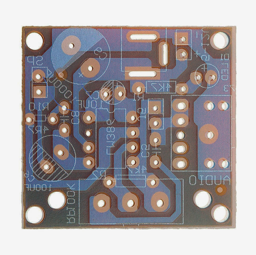

      It shouldn't get really quiet like that. Unless the speaker GND is shorting out the input signal or something?
      I couldn't make out all the wiring, this pic might help. The hookup wire is a bit thick and awkward, I take wire out of old junk stuff like inkjet printers are reuse it. In case this starts to drive you nuts.
      The PCB has the speaker ground (JST) trace go around and over to the input jack, and the IC GND is at the the other end of the trace. Sigh. It's not the greatest.
      I would the leave the 2.2uF cap where it is, and move the DC power GND up to where the DC jack GND is or C6(-).
      Then the signal ground is from the pot GND that goes to pin 4. The input jack GND is far away so I would prefer to not use it. If you must use those input jack pads, I would cut the trace to it and the LED/or to it and at the corner, and run a jumper from the pot GND at pin 4 to the input jack pad. Getting rid of the long loop this board has there, look at the path from input jack GND to the IC lol.
      Ideally you want to have the four major grounds: DC power, loudspeaker, IC, signal input - all connect to one point or the star. It's not usually a big deal but some LM386's I built up get finnicky and I have to redo things. The IC has no markings on top?
      R2 4k7 is only in if really strong signals coming in, I would leave it out.

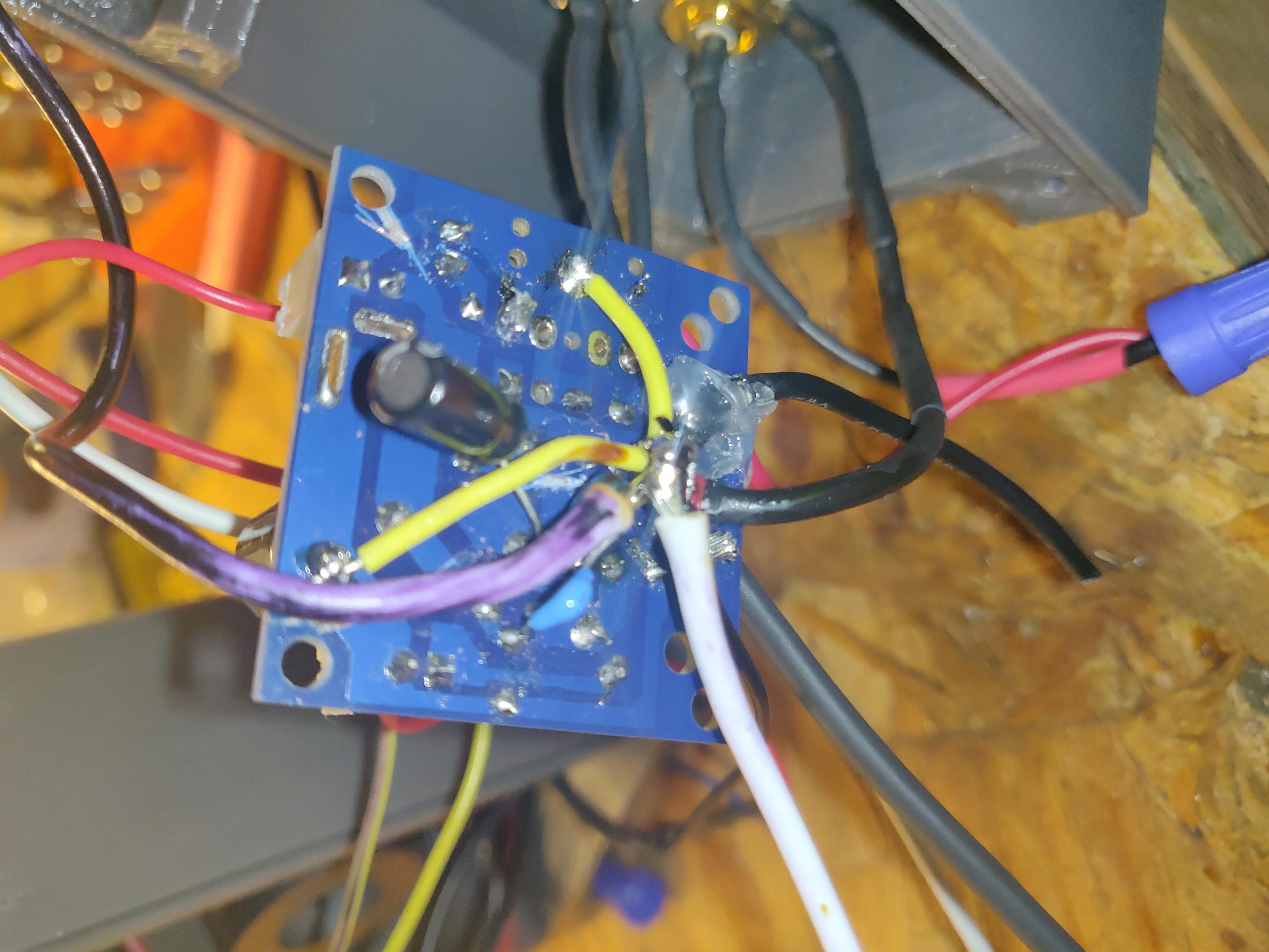

        R2 4k7 was replaced with one of the ceramic caps shown in your schematic.
        I cut the ground trace in the top left and top right corners. I ran a jumper wire straight to the cap from pin 4, and ran another jumper wire from pin 4 for the led and where I grounded the two diodes.
        Then I soldered all the grounds to a large blob attached to pin 4. Pic attached. Not proud of this.
        The chip is marked "16CXY LM386 M-82". It doesn't show unless you get the camera angle just right.

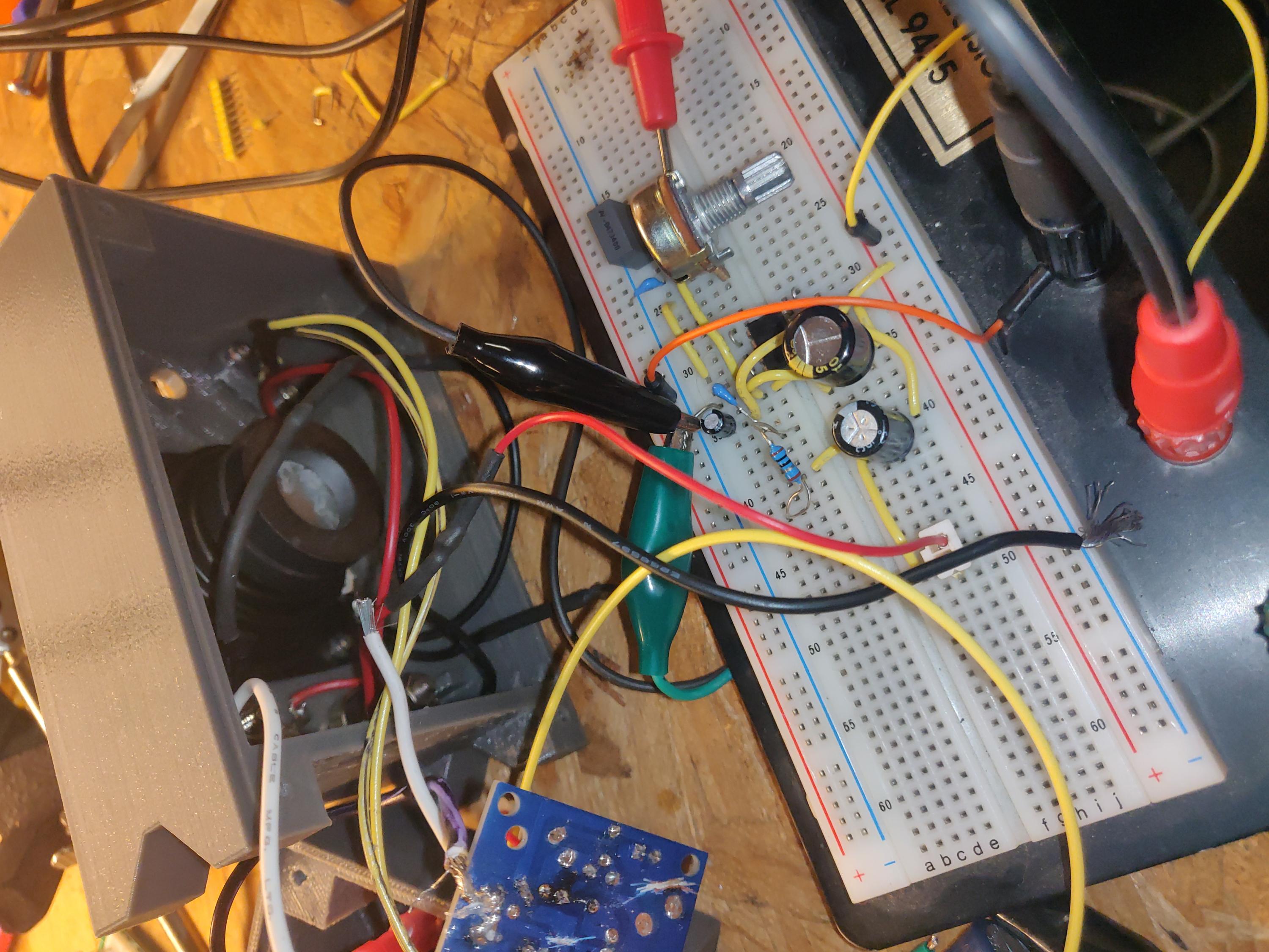

                  I peeled the components off the board and put them in my breadboard (pic attached) for troubleshooting. I swapped out the caps that came with the kit for nichicon / kemet and I do think the sound is a touch better, but the noise didn't change. I didn't add in the protection diodes, the led or the resistor from pot to pin 3. When I add the 10uf cap between pins 1 and 8 (200x gain), the noise is overwhelming, so my breadboard layout is probably worse than the PCB, but results without the cap (20x gain) are similar.
                  A minor miracle has occurred, the electronics shop has some JRC LM386D in stock. From what I have read, that's pretty much the gold standard (if not fake), I'll go pick one up and see how it sounds...

                    Problem with the chip itself not your design, at least if you make sure you're not introducing more noise for it to amplify...
