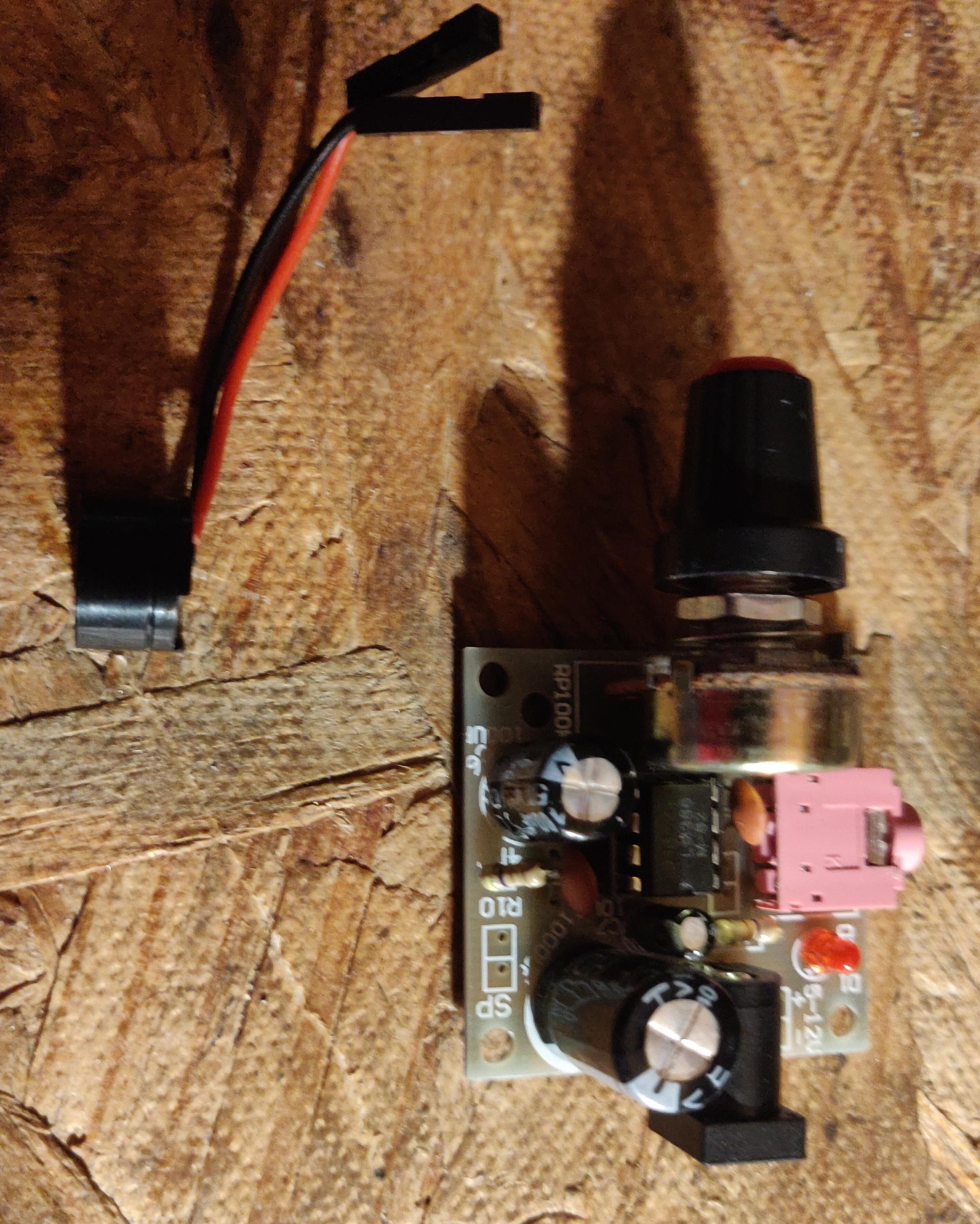

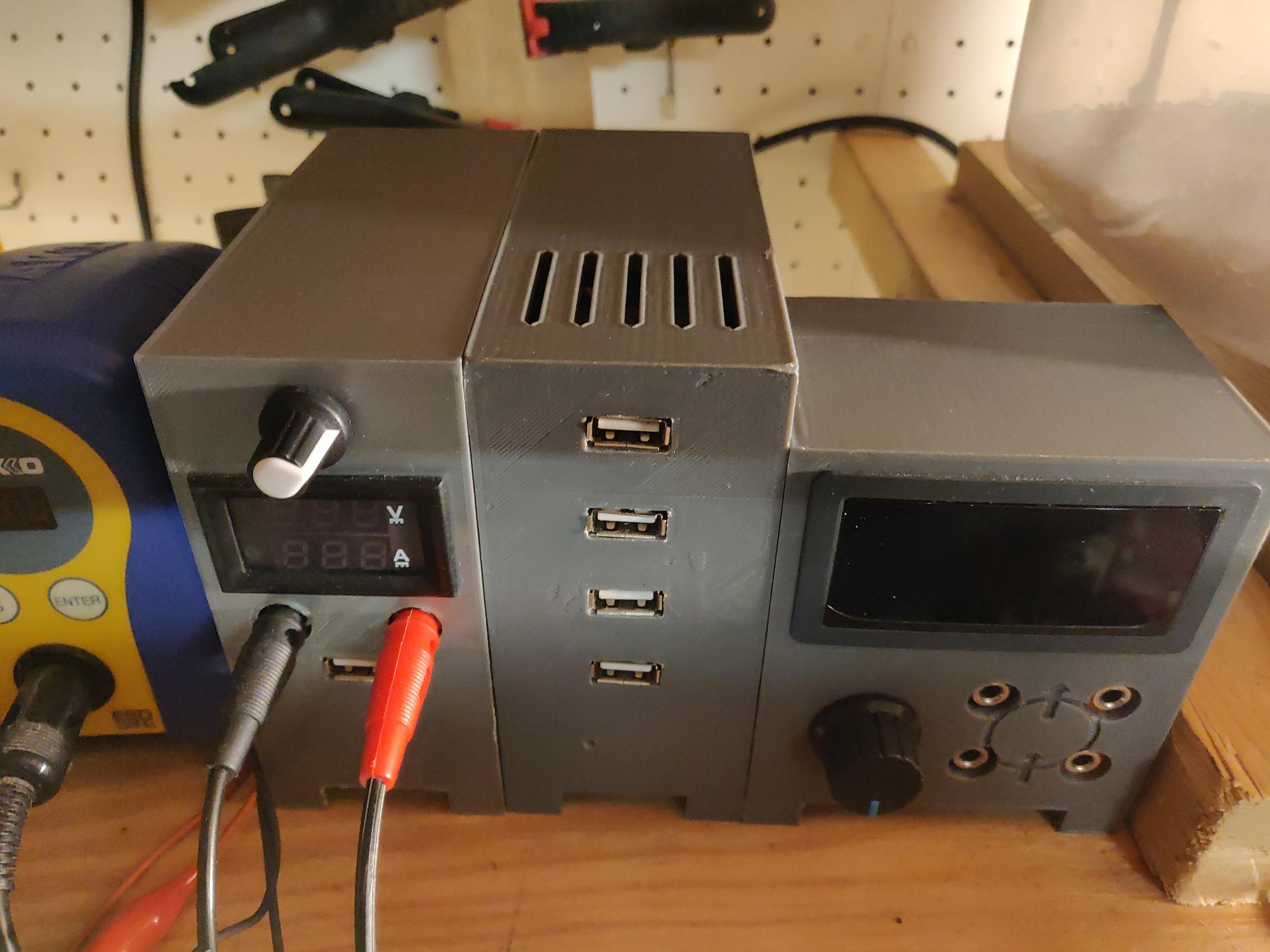

    Full design will be posted when finished. Here's the board I have:
    Here are some examples of my other design work.
    https://www.thingiverse.com/thing:4249306
    https://www.thingiverse.com/thing:4126979

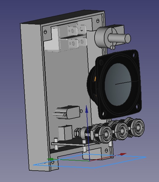

          Progress is being made. Here's what I have so far, I need to add in a place for a 9v battery and a headphone jack. It took me a while to get around to making the enclosure parametric, I have used this box design 3 times already (didn't anticipate that) and wanted to make it easily changable for implementing new designs.
          I need to get a stereo audio switch, right now I only have a mono audio switch, though I'm not certain this little amp can drive two speakers, even if headphone sized.
          Looking at this, I think I'm also going to inset the speaker a bit and have screws come through the front to protect the speaker a bit and allow for a grill to be installed.
          Comments anyone?

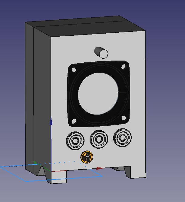

            I like this better after adding the audio jack switch, it pushes the banana jacks up a bit, away from the amp board. I try to keep to a 120mm height limit, it's getting crowded. I need to devise a way to capture a power led with the plastic, I'm going to put it in the mirror image (along X axis) spot from the audio jack switch. I have another device and the led shines through the plastic, it's a cool effect.
            Going to start printing some small pieces to test fit, I haven't used these safety banana jacks, the speaker or the power switch before. Power switch is going to be a pain, getting the right fit on the wings is always hard.

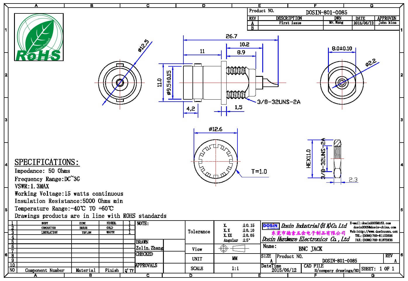

                Also, do you have a link to a bnc jack? I don't have a probe, so I don't know the exact type, I'll probably do two versions, one bnc and one banana for no-scope people like me...

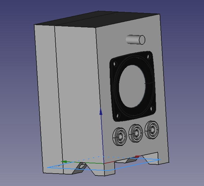

                  BTW, here's the general form factor I'm going for.

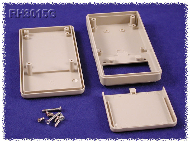

                    For a case something like a handheld Hammond RH enclosure with battery door.

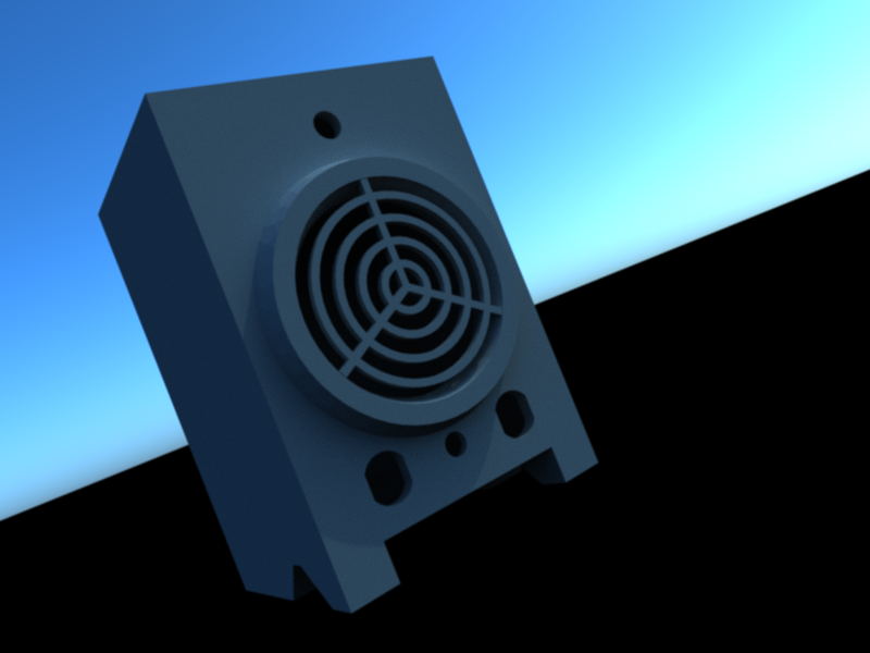

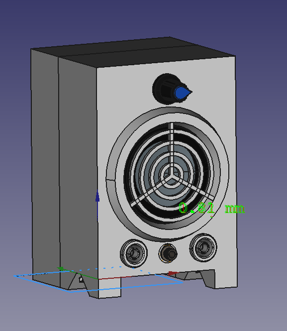

                                    The bnc connectors arrived, I have a working cutout for them. I'm going to make two versions, one for banana plugs and one for BNC. There just wasn't enough room to fit everything and keep it in a small envelope.
                                    The grill was a serious pain to make, I learned a different part of freecad to make it. I think I'll slap an rca jack in the back in case I want it to do double duty as a speaker.
                                    Otherwise, going to start to do some test prints tonight. Overall, I'm pretty happy with how this is turning out.
                                    Redwire: Can you get me a outer diameter measurement on one of those BNC jacks on the probe? I realized I don't have any, so I don't know how to space it.

                                      Was watching some tutorials yesterday to figure out how to do the grille quickly (and took longer) and saw something about rendering. Everything looks better rendered. Too bad I couldn't figure out how to include the 3rd party STEP files.

                                        Had to laugh, as usual BNC missing a critical dimension.
                                        I measure the mounting threads at 9.2mm (3/8"-24UNS) but with 8mm flats to stop it from spinning around. Like the banana jacks. I'd use a tight hole and file it out.
                                        A probe is fat, I measure 19mm barrel so it would hit your raised grille?
