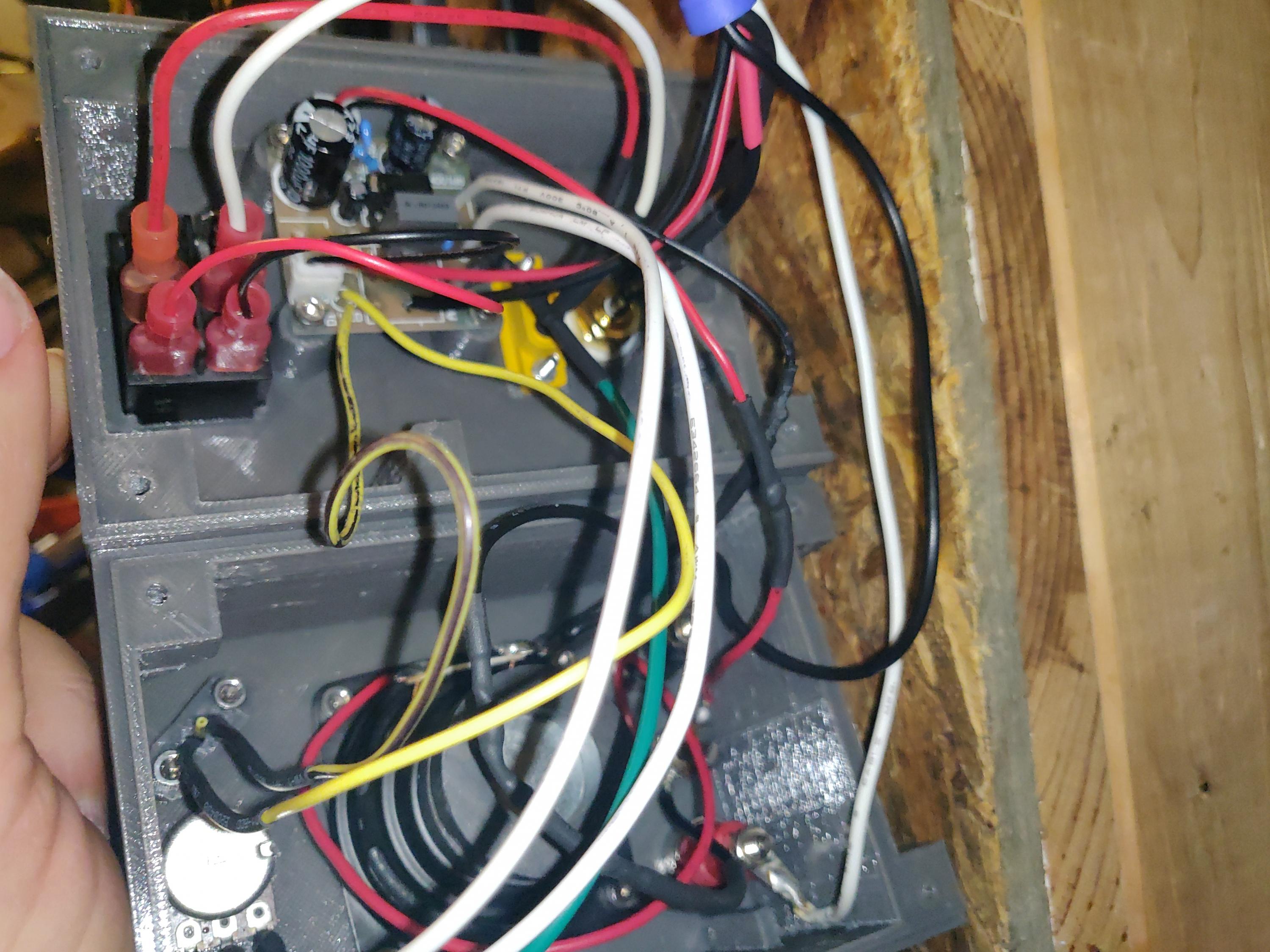

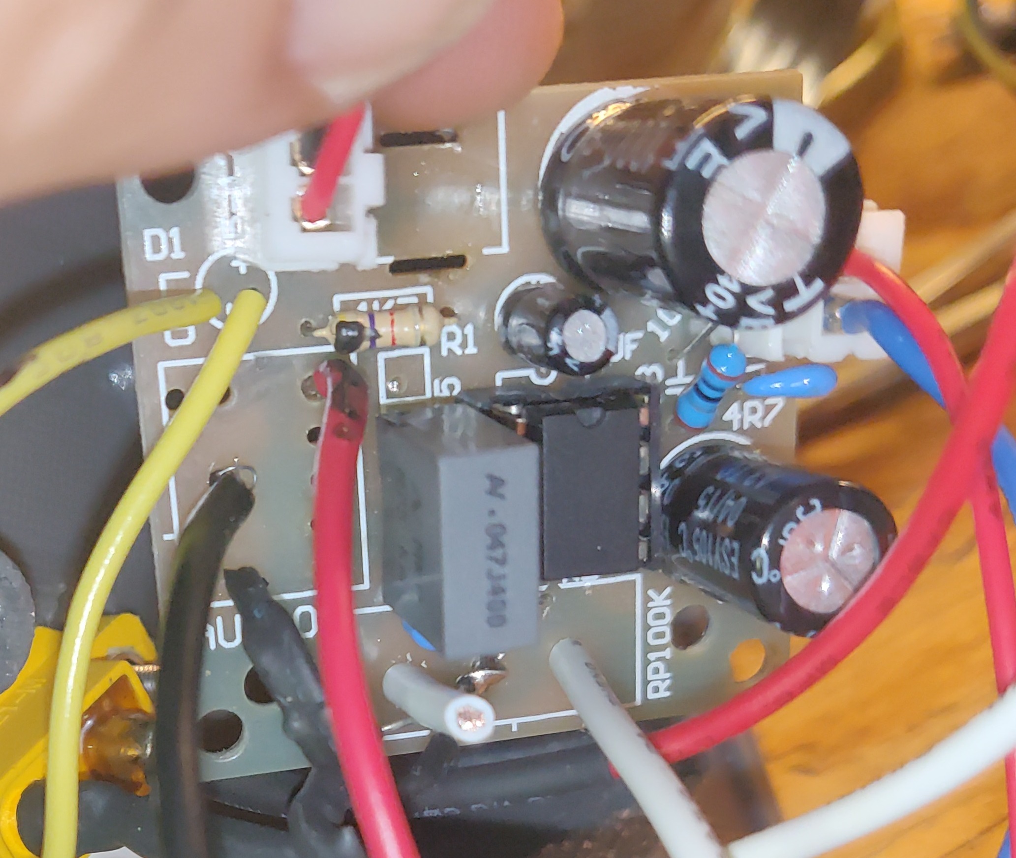

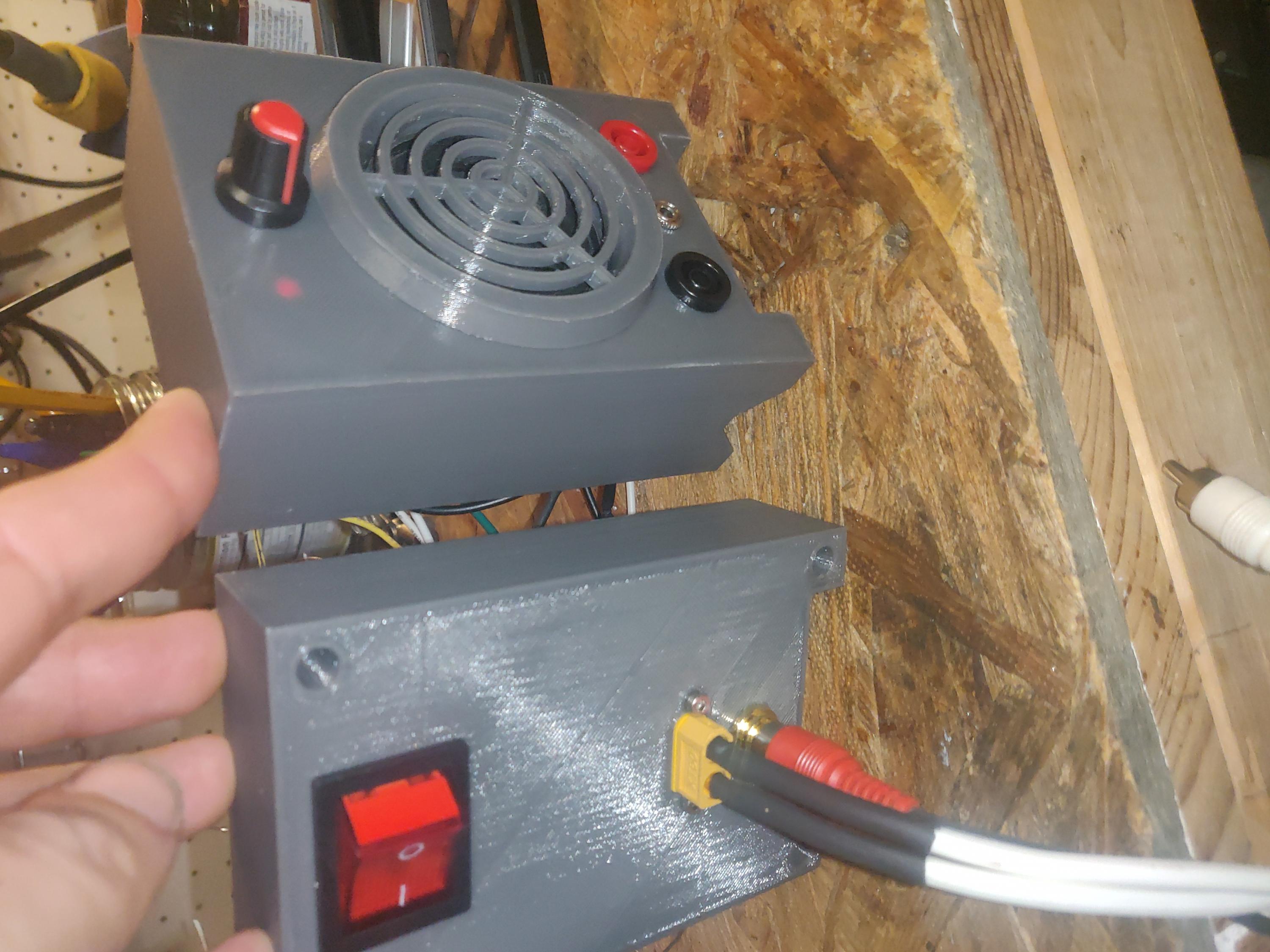

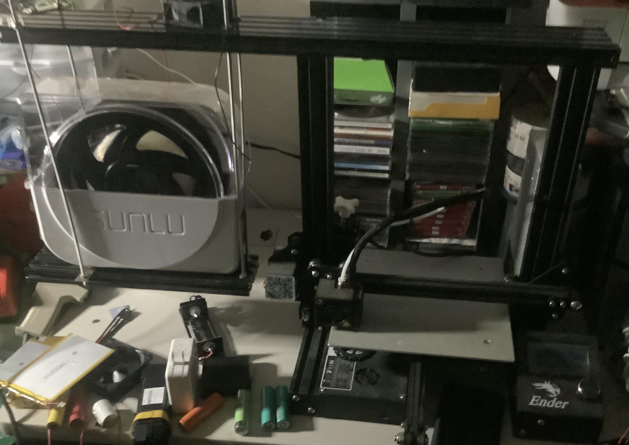

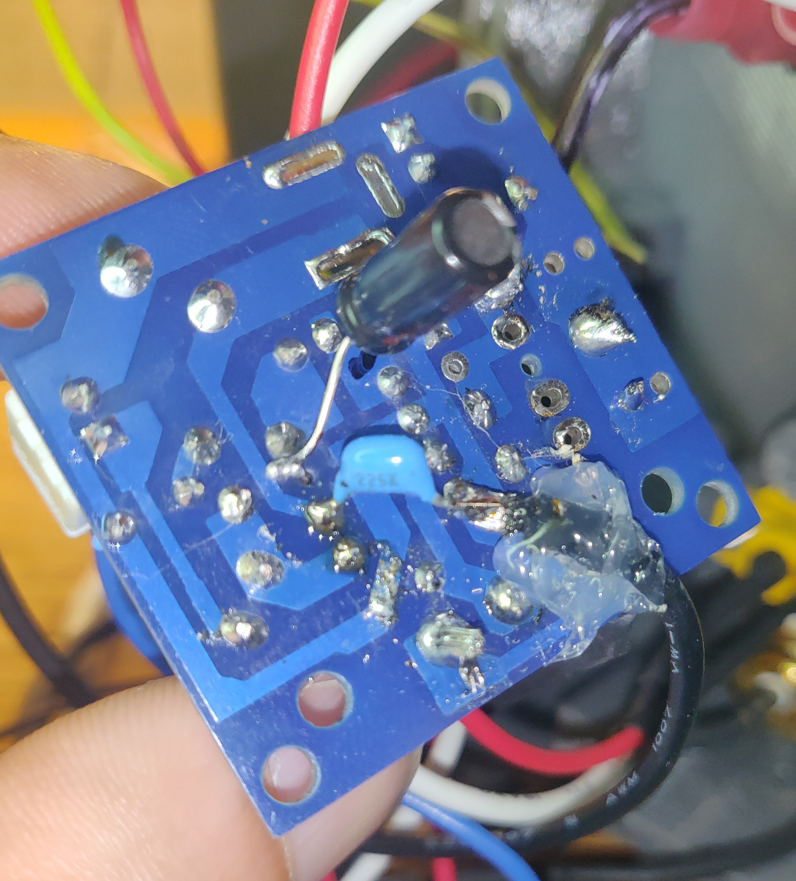

Signal Tracer - Requesting input on requirements
  • clearchris
    • Dec 2013
    • 687
    Re: Signal Tracer - Requesting input on requirements
    A probe is fat, I measure 19mm barrel so it would hit your raised grille?
    Looks like it would hit ever so slightly, I'm glad I asked. I thought the probe would be thinner. Plenty of room to move the jack out though without changing the overall envelope.
    Thanks!
    • redwire
      • Dec 2010
      • 3912
      Re: Signal Tracer - Requesting input on requirements
      What hardware and software are you using for the enclosure 3D printing and design?
      P.S. I would have an on/off LED so the battery doesn't go dead.
      • eccerr0r
        Solder Sloth
        • Nov 2012
        • 8701
        Re: Signal Tracer - Requesting input on requirements
        TBH may well just use a ⅛" phone jack as input instead of BNC, since these frequencies are so low that you don't have to worry too much about connector discontinuities...?
        But then it'd look like a...speaker... instead of test equipment? heh.
        • clearchris
          • Dec 2013
          • 687
          Re: Signal Tracer - Requesting input on requirements
          Originally posted by redwire
          What hardware and software are you using for the enclosure 3D printing and design?
          P.S. I would have an on/off LED so the battery doesn't go dead.
          Freecad. If you download it, get the hidden weekly build, don't use the big download button. Don't bother attempting to use it before you watch some tutorials.
          For slicing (translating from design to 3d printer gcode) I use SuperSlicer.
          Yeah, I was working getting an LED placed on the front panel today.
          I'm printing this on a monoprice select mini. It's a good first printer, but it's very small. The new hot starter printer is the Ender 3.
          https://www.monoprice.com/product?p_id=15365
          My other printer is a beast, Tronxy x5sa-400. Not a starter printer, I had to print a few pieces just to get it assembled.
          Originally posted by eccerr0r
          TBH may well just use a ⅛" phone jack as input instead of BNC, since these frequencies are so low that you don't have to worry too much about connector discontinuities...?
          But then it'd look like a...speaker... instead of test equipment? heh.
          Heh, I am putting an rca jack on the back so I can use it as a speaker, but it will still look like test equipment. But then again, it is going on my electronics bench, so it won't look out of place.
          Last edited by clearchris; 05-31-2021, 05:38 PM.
          • eccerr0r
            Solder Sloth
            • Nov 2012
            • 8701
            Re: Signal Tracer - Requesting input on requirements
            Make sure you have enough hard edge free surfaces inside your case so you'll less likely get resonances, heh. Then also trying to increase the effective air volume in the path so you can get better bass response too...
            One thing I hate about 3D modeling is having to build a component library just like any other CAD... or is there a library of existing components somewhere?
            Currently using OpenSCAD at the moment with Cura as my slicer. Talk about obscure CAD programs, that even less likely has libraries available.
            FreeCAD looks intimidating. I don't quite get how to move and make pieces around yet. And then attaching pieces together...
            • redwire
              • Dec 2010
              • 3912
              Re: Signal Tracer - Requesting input on requirements
              Before, I used a mono 3.5mm jack and some leads with alligator clips. This works but noisy with high impedance circuits and probing with an alligator clip can short stuff out on a board.
              Adding the BNC - I found a scope probe great for poking around equipment. It's shielded cable so no hum and noise picked up, and the tip or clip handy, no accidental slips. The X10 I can use if high voltage up around 300V or more if you have guts.
              For free 3D cloud-based software, I tried Onshape but found its user-interface brutal. It's dumbed down so much you can't figure out or find basic instructions and the metaphors, grouping of commands is so bad I laughed so hard at how dumb the software left me.
              • clearchris
                • Dec 2013
                • 687
                Re: Signal Tracer - Requesting input on requirements
                Originally posted by eccerr0r
                Make sure you have enough hard edge free surfaces inside your case so you'll less likely get resonances, heh. Then also trying to increase the effective air volume in the path so you can get better bass response too...
                I made no attempt to better the acoustics, I have read about speaker enclosures before, and it seemed much like antenna science, there's so much to know before you can hope to be effective.
                I can round the interior corners, do you think that would help? I can also pretty easily add ports, etc, but again, I haven't the slightest idea how to size any of that type of thing.
                Originally posted by eccerr0r
                Currently using OpenSCAD at the moment with Cura as my slicer. Talk about obscure CAD programs, that even less likely has libraries available.
                No libraries for openscad? Look on thingiverse. There's plenty. I use freecad or openscad, depending on the situation. They seem to be the most supported open source CAD options. If you really want to feel pain, check out Blender. Some people use it, but I imagine those are the ones that use if for it's other strengths.
                Originally posted by eccerr0r
                FreeCAD looks intimidating. I don't quite get how to move and make pieces around yet. And then attaching pieces together...
                There's three workbenches in freecad. "Part" and "Part Design". To get going quickly, you can cobble some things with primatives in "Part" quickly. If you have wierd shapes not handled by primatives, use "Sketcher" and extrude the shapes. If you want to make parametric designs, use "Spreadsheet" and name some cells. You can then refer to them in the other workbenches. Once you get the hang of Sketcher you can graduate to "Part Design". I personally find that "Part" is easier to build your own library of commonly used shapes for reuse. "Part Design" you are making sketches in place to affect on object, it's hard to explain until you do it, but I find it's harder to reuse pieces. Though I don't have as much experience with "Part Design" so I could be wrong. Use "Mesh Design" to create a mesh from your design and export to STL.
                To specifically answer your question, in "Part" there are a series of icons for boolean operations that consist of two overlapping circles with different shading. You will know what they mean when you see them.
                I find that freecad is much easier to use than openscad when you have a design that's modelled around an object you can find on grabcad.com. You import the piece you are using, the build your object to fit. If you look at the pictures in this thread, nearly everything except the enclosure and grille was pulled from grabcad. It's much easier when you can see how everything fits together before you print.
                Originally posted by redwire
                Before, I used a mono 3.5mm jack and some leads with alligator clips. This works but noisy with high impedance circuits and probing with an alligator clip can short stuff out on a board.
                I have a pair of nice multimeter probes that I was planning to use, thus the banana jacks. One gets an alligator clip attachment for ground and I can go hunting with the probe and a covered tip.
                Originally posted by redwire
                Adding the BNC - I found a scope probe great for poking around equipment. It's shielded cable so no hum and noise picked up, and the tip or clip handy, no accidental slips. The X10 I can use if high voltage up around 300V or more if you have guts.
                That's a good point about shielded cable, I hadn't considered that.
                Originally posted by redwire
                For free 3D cloud-based software, I tried Onshape but found its user-interface brutal. It's dumbed down so much you can't figure out or find basic instructions and the metaphors, grouping of commands is so bad I laughed so hard at how dumb the software left me.
                Yes, there are many choices for "baby's first CAD" but you will find the limits quickly. I use freecad and openscad. Others like fusion360 among others, I found that it ran super slow on my machine. Also, recently the authors limited what the community version is allowed to do, so if you learn their system, you may find yourself in a situation subject to the whims of the company.
                If you want examples of either, I have released all the source files of designs I have released. Some of them are "remixes" of existing STLs, which might be less interesting though. https://www.thingiverse.com/clearchris/designs
                • eccerr0r
                  Solder Sloth
                  • Nov 2012
                  • 8701
                  Re: Signal Tracer - Requesting input on requirements
                  Well, parts like speakers, BNC connectors, ICs, ... I guess screws and stuff is available, otherwise I've been having to make my own everything to get a fit test...
                  • clearchris
                    • Dec 2013
                    • 687
                    #29
                    Re: Signal Tracer - Requesting input on requirements
                    You still have to do a fit test, you can't trust the models completely, but the models are remarkably good for visualizing the solution together. I don't bother with screws, I have rules of thumb I work with. Holes exactly the size of the screw are good for threading, add 0.2m for a light fit.
                    • eccerr0r
                      Solder Sloth
                      • Nov 2012
                      • 8701
                      #30
                      Re: Signal Tracer - Requesting input on requirements
                      .. as long as the models are available, that's the rub.
                      End up having to fake it, some of these would take too long to model themselves *sigh*
                      • clearchris
                        • Dec 2013
                        • 687
                        #31
                        Re: Signal Tracer - Requesting input on requirements
                        My mouser order should arrive by Friday, so I should be wrapping up this project soon. Which means... new project time!
                        Kind of related to this thread, I'm going to bulid this, a 3d mouse for freecad.
                        https://github.com/mnesarco/HyperController
                        If anyone is interested, I'll post some links to the parts and go through the build.
                        • redwire
                          • Dec 2010
                          • 3912
                          #32
                          Re: Signal Tracer - Requesting input on requirements
                          Adding some acoustic padding behind the speaker does help a lot to improve sound. I've used rags or an old sock folded up behind the speaker to lessen reflections on the backside.
                          I'm using GrabCAD library for electronic parts i.e. 3D models by Alex Federov he's using Russian CAD software that makes very compact models. Solidworks makes fat bloated .step files just huge, look inside one and laugh.
                          • clearchris
                            • Dec 2013
                            • 687
                            #33
                            Re: Signal Tracer - Requesting input on requirements
                            That's interesting, I'll try the sock trick.
                            Why would you want step files for smd parts? Doesn't the pcb layout software you use have all that?
                            • clearchris
                              • Dec 2013
                              • 687
                              #34
                              Re: Signal Tracer - Requesting input on requirements
                              It took me a while, something was bothering me about the back case, but I couldn't put my finger on it. I ended up changing a few small things, it's printing now. I should have something to show soon.
                              • clearchris
                                • Dec 2013
                                • 687
                                #35
                                Re: Signal Tracer - Requesting input on requirements
                                Everything is together, pictures aren't the greatest, but decently happy about how it came out. It would have looked nicer in PLA, but I have been trying to use PETG. The wires are a bit of a mess, but that's partly due to there just being a lot of wires...
                                There's a bit of buzzing that changes when I move the wires around, but I have to do the star grounding yet. I hope that fixes it. I just reread redwire's instructions and realized I need to attach a wire to the amp IC pin, so that's going to wait until tomorrow when I can take it apart, solder a flying wire in under the board, and reassemble it.
                                Overall, either the case mounting or the amp mods (thank you redwire) have definitely increased the level of sound coming out of the speaker. It's decently loud and clear for its size. Of course, it's not perfect fidelity at higher volume, but I can't expect much out of this speaker size. I'm definitely glad I included an RCA jack on the back, this would make a decent speaker on my bench for some tunes in a pinch.
                                BTW, the red dot that looks like it might be a reflection isn't a reflection, it's the LED behind maybe 1mm of plastic. I have grown to like this effect, having done it once before by accident.
                                Last edited by clearchris; 06-30-2021, 08:04 PM.
                                  • Jul 2011
                                  • 6069
                                  #36
                                  Re: Signal Tracer - Requesting input on requirements
                                  Originally posted by clearchris
                                  Everything is together
                                  BTW, the red dot that looks like it might be a reflection isn't a reflection, it's the LED behind maybe 1mm of plastic. I have grown to like this effect, having done it once before by accident.
                                  Very nice work
                                  I need to put my 3D printer back together so I can do some printing projects I had redone my office where I had my 3D printer but I got a spool heater for the filament and I made a holder for the spool heater ( with the spool heater it would not fit in that spot anymore)
                                  So I have to hook up everything on one power supply so let see how this works out
                                  Last edited by sam_sam_sam; 07-01-2021, 07:14 AM.
                                  • clearchris
                                    • Dec 2013
                                    • 687
                                    #37
                                    Re: Signal Tracer - Requesting input on requirements
                                    Well, I soldered a wire to the back of the PCB on the LM386 to pin 4. When I added that to the star ground point (power, pcb ground, speaker ground and pin 4), I wasn't able to get any of the signal (some noise) out of the speaker.
                                    I also noticed that there was considerable noise from the wires that went to the 1M pot. Moving those wires around caused considerable noise and even touching the knob on the pot caused considerably more noise. I could add the 1m pot ground to the star grounding point, would that help anything? Right now all three wires are run back to the PCB. Could I add a magnetic core to help suppress the noise?
                                    Also, how much noise should there be when I turn the volume pot all the way down? Right now there's a pretty decent amount of static.
                                    Any suggestions would be very appreciated. Thanks!
                                    • clearchris
                                      • Dec 2013
                                      • 687
                                      #38
                                      Re: Signal Tracer - Requesting input on requirements
                                      Ok, somehow I figured out the buzzing. I had a 1/8" audio jack from my mobile phone to a 2 rca jack cord, with one rca jack plugged into the signal tracer assembly, the other hanging free. If I touch the ground on the second RCA jack, the buzzing goes away. Pretty strange that the buzzing only cuts in at a very defined location in the pot and cuts out as I turn the pot up. I'm sure there's a very technical reason for this... Highly sensitive signal tracer as promised!
                                      Anyway, the static is still there, it doesn't seem to be affected by moving wires, touching things, etc. It's the same volume when the pot is turned down and turned up if the mobile phone is muted. I'm starting to think that I might have a substandard LM386 chip, but I'm not convinced.
                                      I did some more experimenting with the star ground, and I have found that I can connect the LM386 pin to the star ground, but I can't connect the speaker to the star ground, speaker ground must be connected back to the PCB at the designated "speaker" JST connector. I'm going to do some more experimenting...
                                      Last edited by clearchris; 07-02-2021, 08:13 PM.
                                      • redwire
                                        • Dec 2010
                                        • 3912
                                        #39
                                        Re: Signal Tracer - Requesting input on requirements
                                        Your board schematic was missing two capacitors that I always include, on my schematic in Post #10.
                                        If the LM386 is doing RF oscillations (around 13MHz shows up at higher output power) it will sound trashy. Make sure it's got a bypass cap like 2.2uF X7R across pins 6 and 4 right at the IC. The 220-1,000pF cap to block RF/AM radio at pin 3 In(+) to GND is important too. Sometimes I mount it at the pot.
                                        The potentiometer housing is best to have a ground connection tack-soldered to the housing, like they do in electric guitars. Just a small jumper from the case to the pot's ground terminal, without melting everything. Sometimes I scuff and scratch the pot's can to make solder stick.
                                        Keep the loudspeaker wires away from the input wiring, best is a shielded cable from pot to board. The speaker wires do radiate several volts at higher volumes and the wires right next to each other
                                        Important on the star-ground is the power/battery (-) and speaker (-), LM386 GND pin 4, all go to one point as best as possible.
                                        I can't see a pic of your board, sometimes they are done poorly for pcb layout.
                                        It's worth it to tame this thing and get it to work without killing sensitivity.
                                        • clearchris
                                          • Dec 2013
                                          • 687
                                          #40
                                          Re: Signal Tracer - Requesting input on requirements
                                          Originally posted by redwire
                                          Your board schematic was missing two capacitors that I always include, on my schematic in Post #10.
                                          If the LM386 is doing RF oscillations (around 13MHz shows up at higher output power) it will sound trashy. Make sure it's got a bypass cap like 2.2uF X7R across pins 6 and 4 right at the IC. The 220-1,000pF cap to block RF/AM radio at pin 3 In(+) to GND is important too. Sometimes I mount it at the pot.
                                          The potentiometer housing is best to have a ground connection tack-soldered to the housing, like they do in electric guitars. Just a small jumper from the case to the pot's ground terminal, without melting everything. Sometimes I scuff and scratch the pot's can to make solder stick.
                                          Keep the loudspeaker wires away from the input wiring, best is a shielded cable from pot to board. The speaker wires do radiate several volts at higher volumes and the wires right next to each other
                                          Important on the star-ground is the power/battery (-) and speaker (-), LM386 GND pin 4, all go to one point as best as possible.
                                          I can't see a pic of your board, sometimes they are done poorly for pcb layout.
                                          It's worth it to tame this thing and get it to work without killing sensitivity.
                                          I made all the changes you proposed earlier. The only differences I can tell between your schematic and my board is the LED resistor is 4.7k instead of 10k, the cap before the speaker output is 1000uf instead of 300uf and I'm running a 12v buck converter off a 20v SMPS for power. I also substituted a C0G cap for the 2.2uf ceramic cap.
                                          The 2.2uf cap is mounted to pin 6 and pin 4.
                                          I attached the pot case jumper to the ground pin on the pot. That resolved the issue that touching the pot causing the sound to change.
                                          I do have a 1nf cap on pin 3, but it's on the PCB, much closer to the LM386, I can move it to the pot if you think that would help.
                                          I can add shielded cables. I have some balanced 2 16ga conductor with copper shield cabels, but they are really thick, closing the case could be an issue. RCA cables are usually shielded right? I don't have any other shielded cable on hand, so maybe I could sacrifice an unused RCA cable and get this going...
                                          I have tried many times, but once I add the speaker connection to the star ground, I get only super-faint sound from the speakers. It's so quiet I can barely hear it. Any ideas?
                                          Pics attached of the board, front and back. The two diodes and resistor are hidden in some heat shrink, but are present.
                                          • ugamazing
                                            820-02020 Super Weird Issue: Keyboard Input Character Map "Wrong"?
                                            by ugamazing
                                            So, I have a really bizarre issue that I'm struggling to identify the cause of. Working on an 820-02020 board with some bizarre keyboard/input-source character mapping. My suspicion is a possible damaged SPI ROM (U1970), perhaps, but I'm really not sure in this case:
                                            1. The issue is pretty weird, but when installing MacOS, I noticed my WiFi password did not work. I quickly realized the special characters (!@#$%^& etc) were not mapping correctly.
                                            2. I noticed the keyboard layout/input-source is defaulting to JAPANESE every single time I restore the board. I am not...
                                            04-10-2024, 08:06 AM
                                          • CoinCoin88
                                            Garage door RX unit (Cardin S38C) does not short relay to send opening signal
                                            by CoinCoin88
                                            I'm turning to the Badcaps community to help me troubleshoot the radio Rx card from my (old) garage door opener. While I could just ditch that card and replace the whole system, I first would like to understand "why" it suddenly stopped working, because that's just how I am wired...!
                                            Some basics: the receiver works on a 30.875 Mhz frequency. Yes, I'm aware this is not in use anymore in a looot of places. It does not use any rolling code, it's just a regular dip-switch code that you have to set up on both the receiver and transmitter. The receiver...
                                            09-15-2025, 03:36 AM
                                          • AstutePauciloquent
                                            Requesting Help For GA-970A-DS3 rev. 1.0, No Post code, no RSMRST# signal
                                            by AstutePauciloquent
                                            Hi everyone, over the past few months i have taken a deep dive into motherboard diagnostics and I love the challenge. Currently im trying to learn all about the signals that travel around the motherboard, such as frequencies, enable signals High and Low logic states etc. And i have been learning to read and using the Schematics for this board that i requested here on Badcaps forum, from a few months ago, this is such a great place for these.
                                            I’ve been working on a GA-970A-DS3 (rev. 1.0) that does not post. This motherboard has been my main learning board. I would like share...
                                            11-23-2023, 11:02 PM
                                          • Xristakis795
                                            samsung ue40d503problem reboot logo only when i have input signal from hdmi and tuner
                                            by Xristakis795
                                            hi to all
                                            i have the above model ue40d5003
                                            the damage was definitely caused in my case by a generator that I installed burned the protection at power supply of tv and created the following problem
                                            when I have not connected the antenna, any input source lights up normally i can insert on the menu and the tv doesnt reboot
                                            when I connect,the antenna or hdmi signal however, when it goes to show an image, the image appears momentarily and then restarts appears the logo and the same again.the lights of standby blinking continously
                                            Can you tell me from your experience...
                                            02-09-2023, 03:17 PM
                                          • howardc64
                                            Vizio M65Q7-H1 Red Vertical Strips fixed by tape blocking LC1 signal to half of the panel
                                            by howardc64
                                            Failure Symptom
                                            No picture, just red vertical stripes. Google search shows quite common problem for these recent Vizio M series although red vertical stripe pattern may differ. Some call it "Netflix" boot screen haha.
                                            Where is the short?
                                            Panel has 4x buffer boards. Quickly found the 1/4 panel buffer board with the problem by selectively disconnecting buffer board flex cables.
                                            Having recently fixed another Vizio with similar symptoms that was a shorted ESD diode array ( link ) Probed the ESD diode array but...
                                            05-27-2025, 02:56 PM
