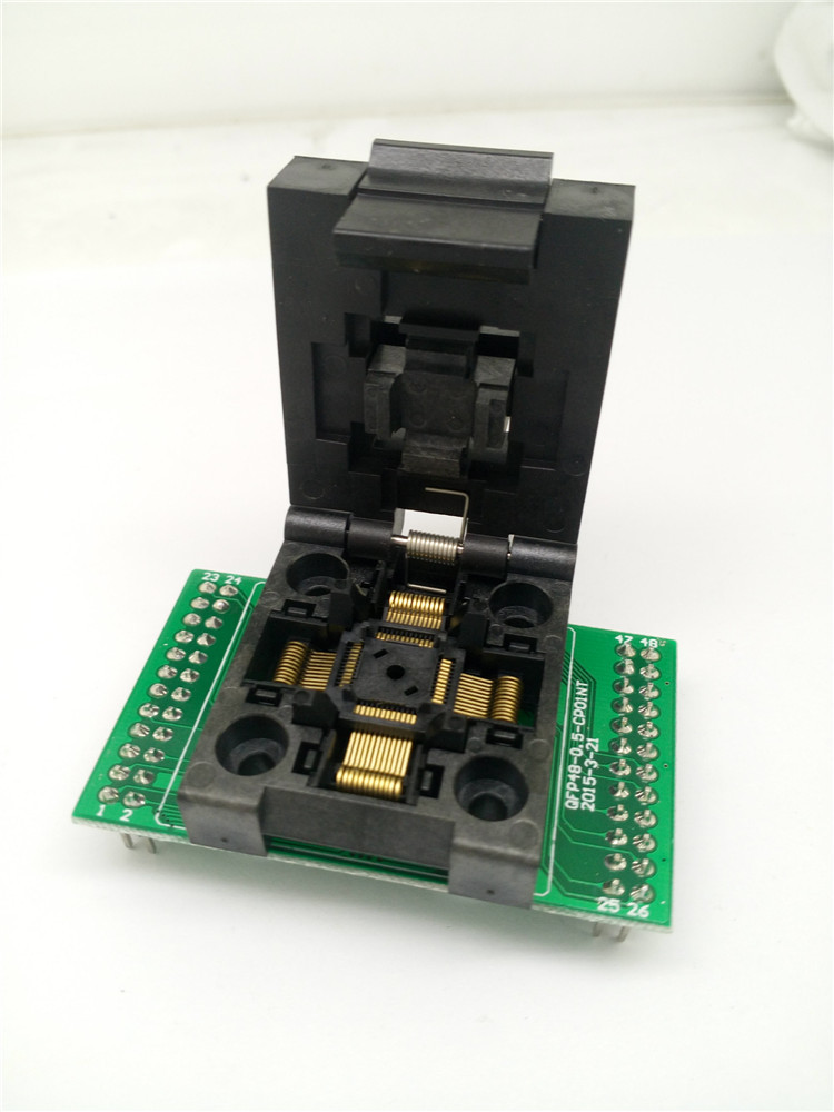

    Hi Guys
    I'm trying to program a WELTREND WT61P805 QFP48 chip externally using a RT809H programmer.
    Before you ask, yes i do use it sometimes with VGA ISP and works perfectly.
    I have an external QFP48 socket that i would like to use witht the programmer.
    I doesnt work this way normally and have to use ISP... Bummer....
    I would like to know if the device can be added ? If so how? bit of a progressive beginner me on the RT809H.
    If no, how can i use this to wire link the ISP and external QFP48 socket adapter. ?
    Cheers
    Matt

        I can't understand a word he sez, but he does add a custom IC to the RT809h software. I've checked your IC in the software I've got for my RT809h and that Weltrend IC is only supported in ISP mode. So you have to add a custom IC to your programming software, in order to read and write with that RT809h and that QFP48 socket.

              This post i suite old already, i know ! But i would like to add some information as update for readers, This chip is especially used on Samsung mainboard and Samsung enables some connections to flash this chip onboard.
              Then to be brief, using the ISP port of RT809H connect the blue and grey wires to SDA and SCL and the black wire to GND of the mainboard, power the main board with its power supply, and that is done, the programmer can access the chip to do anything as necessary.
