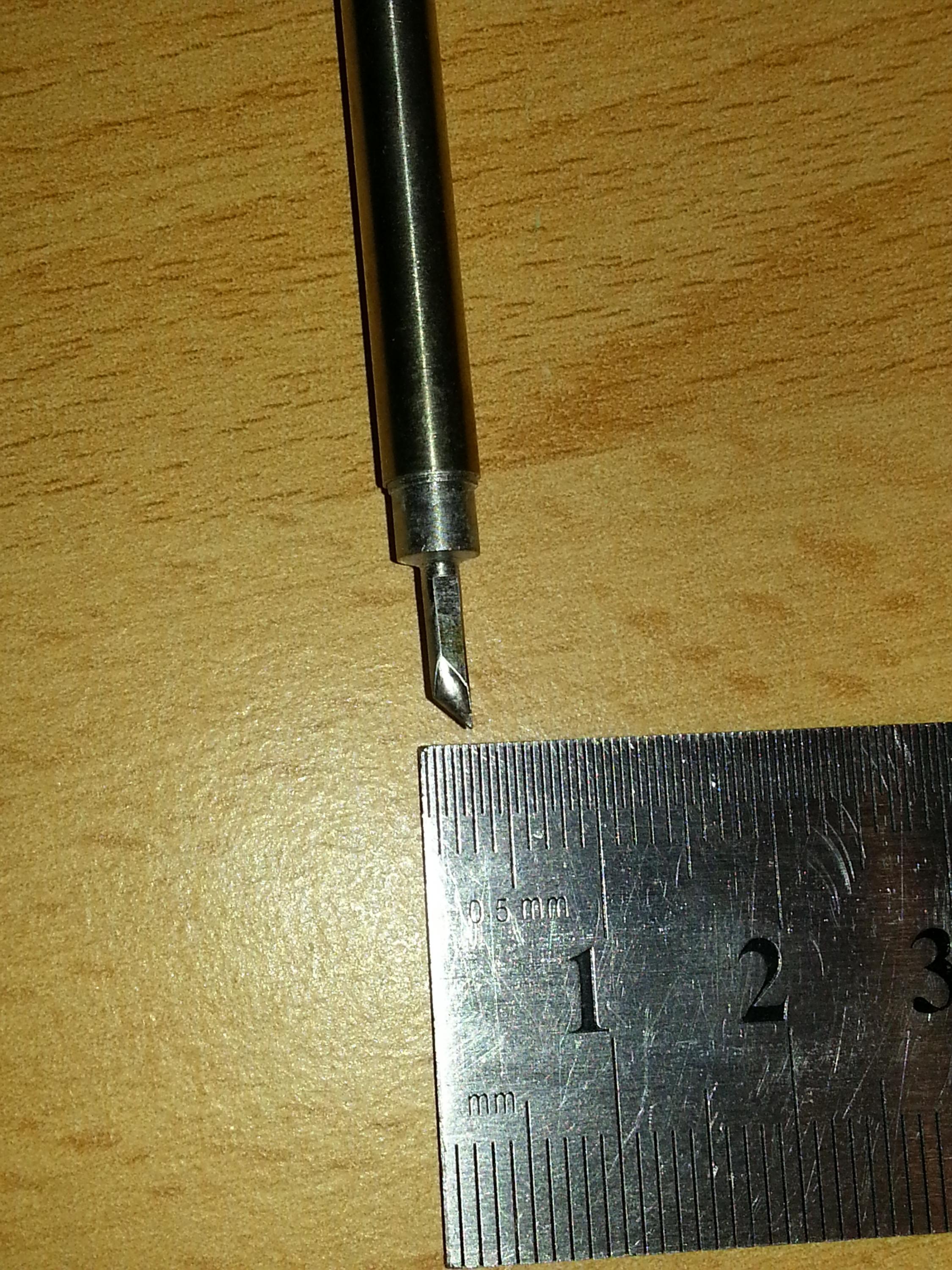

                  Re: Soldering station thoughts and guidelines
                  This showed up in the mail today. The photo doesn't really do it justice, so here's the product page to see for yourself. It took me a while to find this, since it's as close as you're going to get to a MicroPencil. It still uses the T12 standard and I stumbled upon it mostly by accident among the ubiquitous T12 tips. Haven't tried it out yet.
                  Wattevah...
                      I still don't understand the use for those ultra-thin tips. Aside from soldering very fine-pitched resistors and TSOP/TSSOP ICs, I'd hardly ever fine use for such tips. Even if fixing thin traces, I still use my fat D52, lol.
                      As for thin wire for trace repair: I just pull strands from various regular wires. If I want something very thin, I use the wires out of audio cables. Those tend to have very fine stuff in there.
                        the function of small tips is not to solder fine parts, it's to avoid other stuff nearby.
