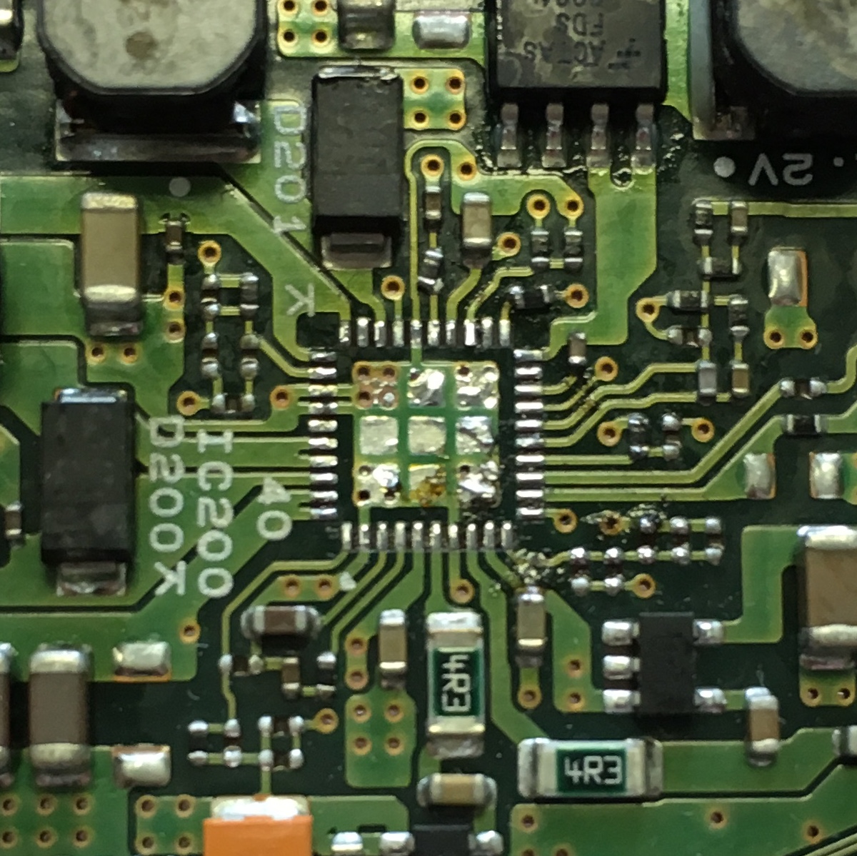

    After lots of swearing and practice on scrap boards I've finally managed to remove a QFN IC using my budget Huakko 998D soldering station, without completely destroying it.
    I had to crank the temp up to 420 °C, much higher than expected, but she did eventually come free. Judging by the close up attached picture I've slightly lifted one trace in the process and moved a couple of SMD's a little, but I think I could actually use this board again
    Practice makes perfect as they say

    Nice job, minimal work required to get those moved components back in place.
    I recommend Amtech 559 flux, allows for plenty of reworking before it goes off. Be careful on ebay, there's loads of fakes. Insatint is the genuine seller.

      speaking of removing SMD components, did you use square attachments or just used a regular circular nozzle?
      The best luck I've had in desoldering board is using a heat gun, but it tends to rip off more than just the target device and destroys plastic connectors ...

        I had some very thin watery flux, it wasn't much use. Thanks for the suggestions, I'll be getting some of that tacky Amtech stuff.
        I used the smallest nozzle in the kit, bog standard kinda thing, quite low air speed (setting 2 of 8), spent plenty of time bringing the board up to temp.
        Kapton tape on your plastic connectors should protect them from the worst of the heat.

          I wouldn't worry about warming the board when doing SMD rework. It's only when doing large BGA work does it matter, far more heat needs to be put into a much larger area.
          Nozzle up close, little waft for a few seconds and watch as the solder changes through the microscope.

            Yes, and yes it has an extremely high chance of destroying the board...

                    Don't be afraid to crank the heat up. Hot air doesn't work exactly like a soldering iron, so you need hotter temperatures and longer exposure.
                    If you have a small bottom heater, though, you can often make your work a lot easier. I typically use the gas burner on my stove set on low. It actually does a perfect job of even heating on the bottom where I want to work.
                    Just keep this in mind if you have to remove bigger stuff with hot air.
