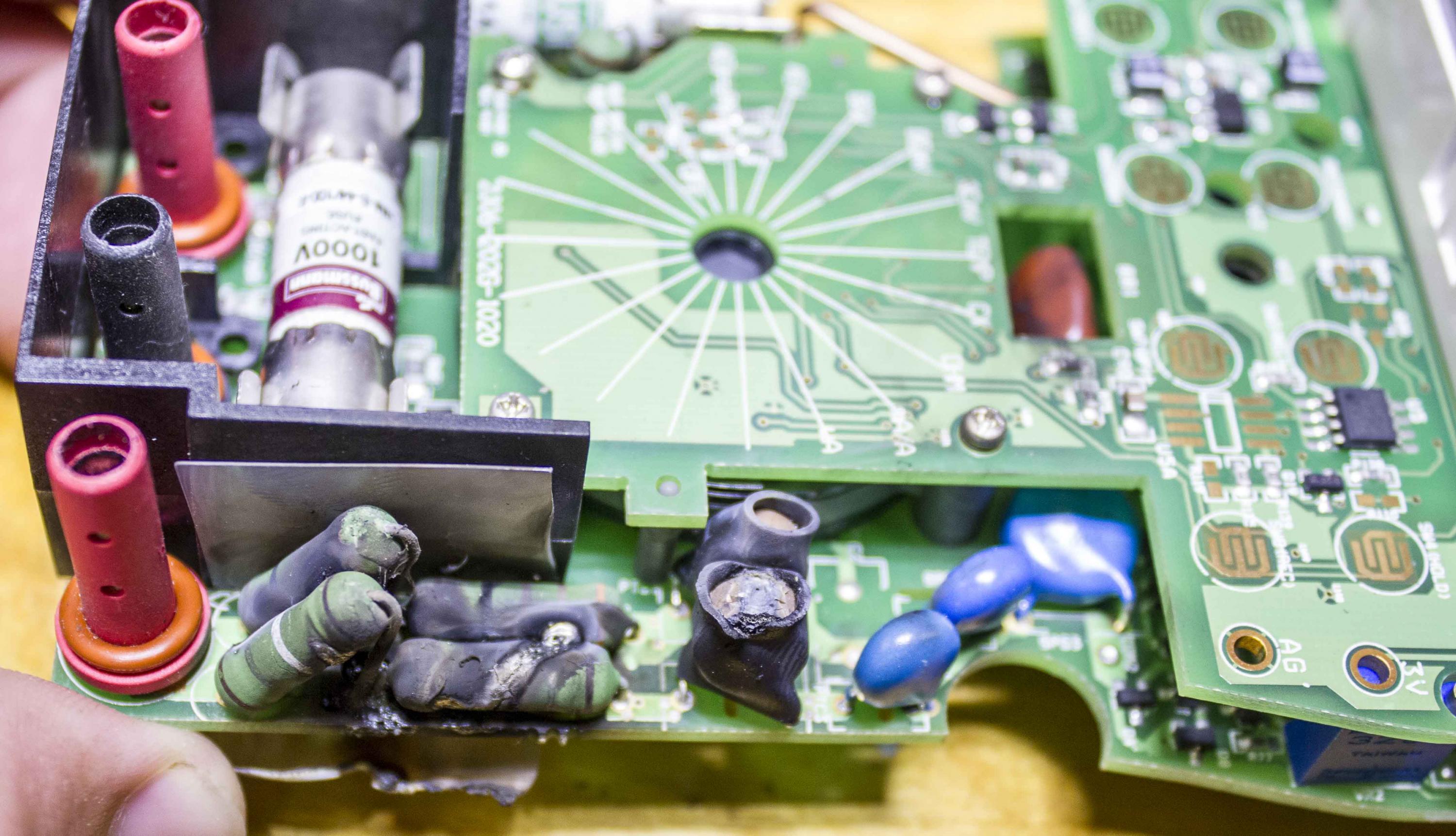

            BTW, the Brymen BM869 is UL listed to 1000V CATIV, but when subjected to high votlage (i.e. > 1000V) like this badcap member did, look at the damage
            https://www.badcaps.net/forum/showthread.php?t=45936
            Just one of the pictures from that thread below. Badcaps member won't say what he was measuring, but look at the damage.
            And this is from a company that designs well made multimeters and gets many third party certifications.

                  retiredcaps, yes I remember that thread, read it also on eevblog.
                  Consider what kind of damage could have been done if a meter with a fake CAT rating at 1000v had been used like the first batches of the UT61E for example.
                  Scary to even think about when you see this picture and imagine your hand holding the meter!
