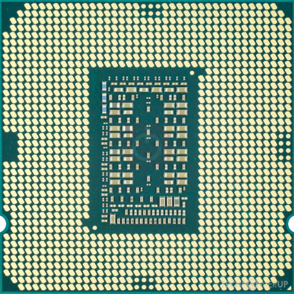

Intel i7-11700K or similar knocked resistors off, could someone measure theirs?
This topic has been answered.
Tags: None
Answer selected by Herbs n spices at 10-13-2024, 10:27 PM.
Yes, that worked perfectly. Thank you very much! It went from failing to pass the RAM debug light to properly booting into windows.
I took one resistor off a totally dead 12900f and one off a destroyed motherboard. I imagine the blue color means something specific, like 0.01% tolerance, or a special temperature range, so I have yet to see if the black 1% tolerance resistor makes any difference.Comment
