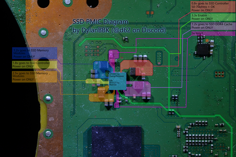

PS5 Dialog DA9081 in power on measure pin EN with 0.5v
  • aandrade
    • Oct 2021
    • 6
    • Chile
    According to the image, pin EN should be 3.3V, and I currently measure 0.5V when turned on.
    Does the 3.3V come from another line or is it generated by the DA9081?
    Thanks!
  • LaPCon_IT
    • Sep 2022
    • 81
    • Malta
    Check resistance on this rail. If it's low, inject voltage to see if anything is getting hot. This signal comes from SB I think.
