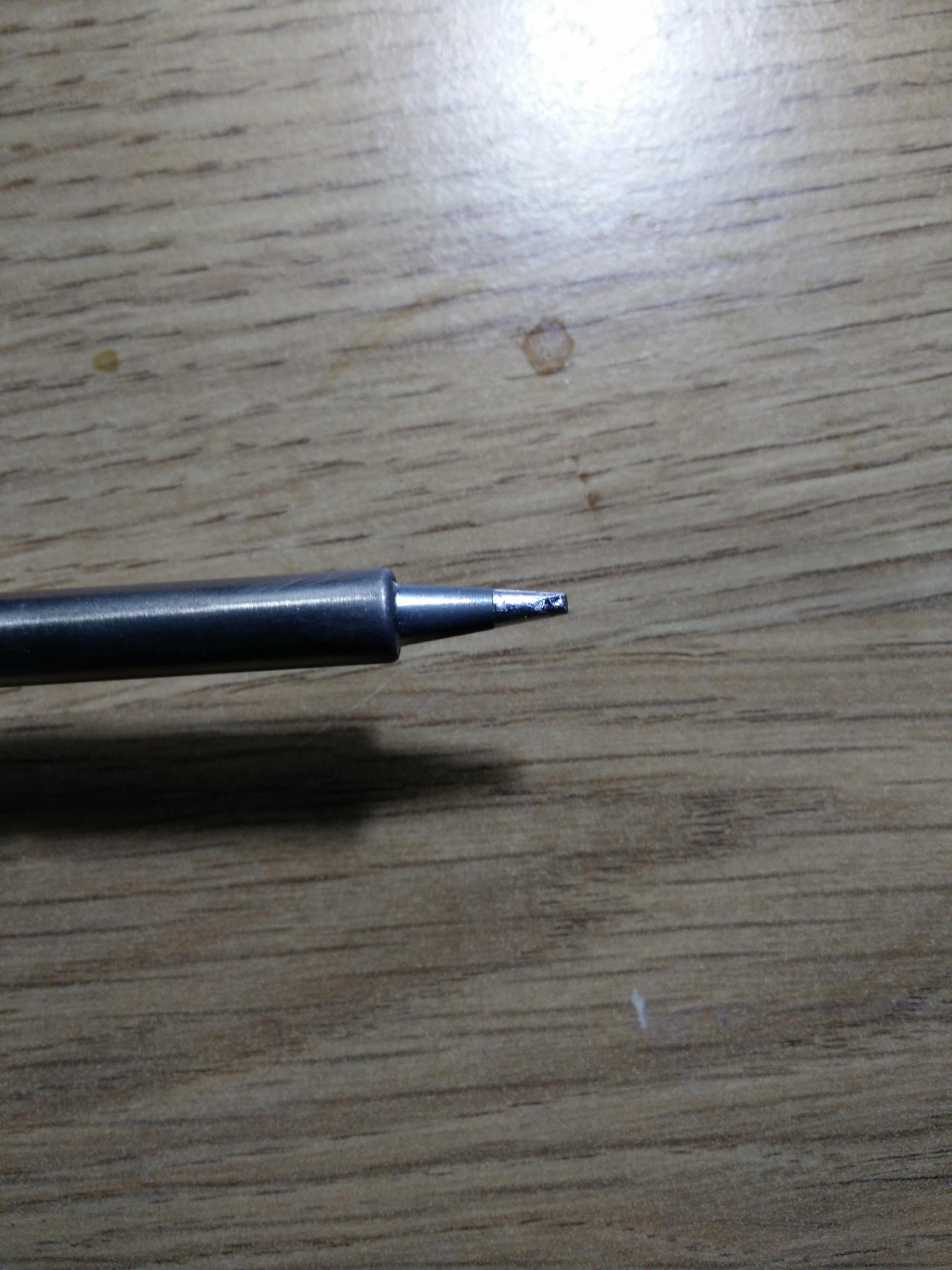

    So I am new to soldering and electronic components. I had some capacitors go bad on my Dell mobo and decided to take a crack at it. I was successful and the computer is working great again but I have to say it was more difficult than I imagined. Desoldering the capacitors was tough but I found clearing the holes even tougher. I tried a wick and a pump. I added some fresh solder and pulled them out using a Hakko station at 650 F. Somtimes, I felt like this was not enough heat or maybe it was the small Hakko tip it came with. I will post a pic of the tip in a moment.
    I would appreciate anyone's input on how to improve on this. Specifically should I use more heat or a bigger tip or both?

      Here is the soldering tip I used.

          Motherboards have large copper planes, thick traces, several layers ... so without additional help from something that would heating the work area, I would probably set the iron to 350-380c
          But I have good soldering stations, an old original Hakko 936 and a Pace hw50 for finer work... with Chinese copies or models based on 936 you may have to set the temperature higher because the heater element is often smaller power (36w vs 50w or so) and there's poorer heat transfer between heater element and tip so the iron recovers (goes back up to configured temperature) slower between operations.
          The clones/copies are also often poorly calibrated, running the iron tip at 20-40c less than configured temperature).
