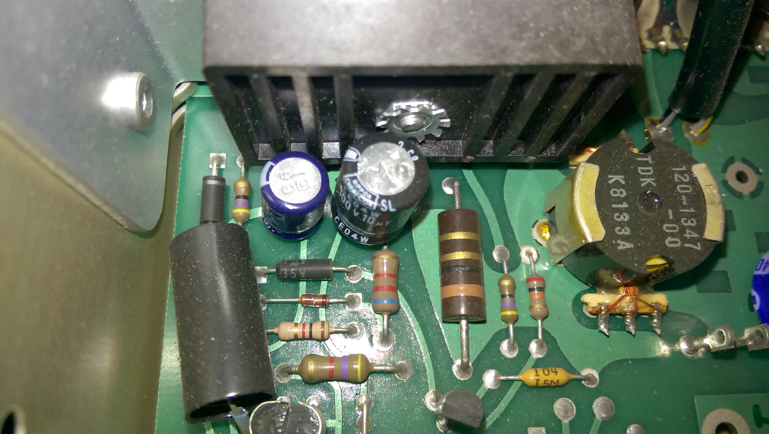

    Found this beauty at work.
    Been neglected in a corner of the warehose for god knows how long!

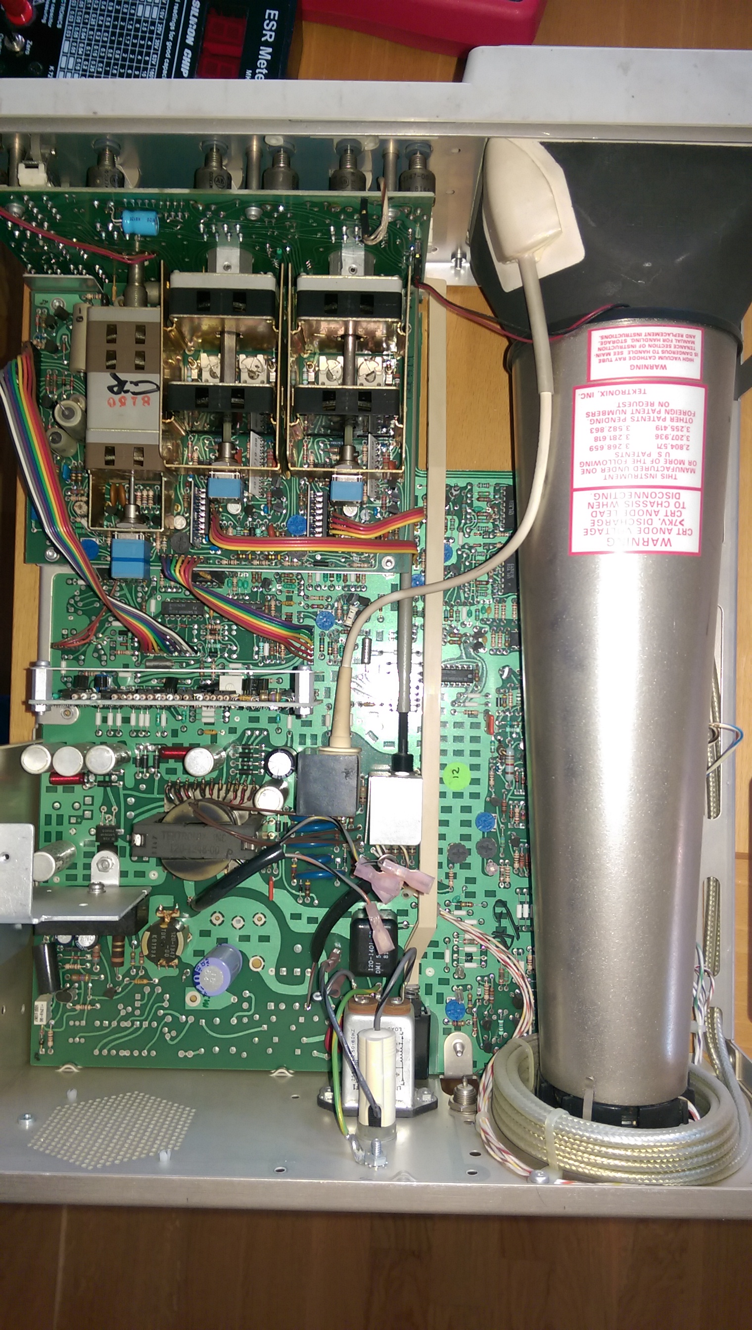

    I took it out of it's casing and gave the casing a thorough wash, came out great!
    I don't think it's been used much at all through the years...
    But it's slightly older than me being built in '82!

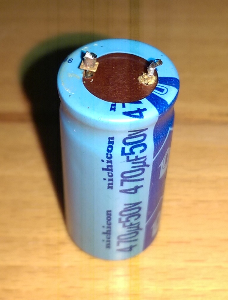

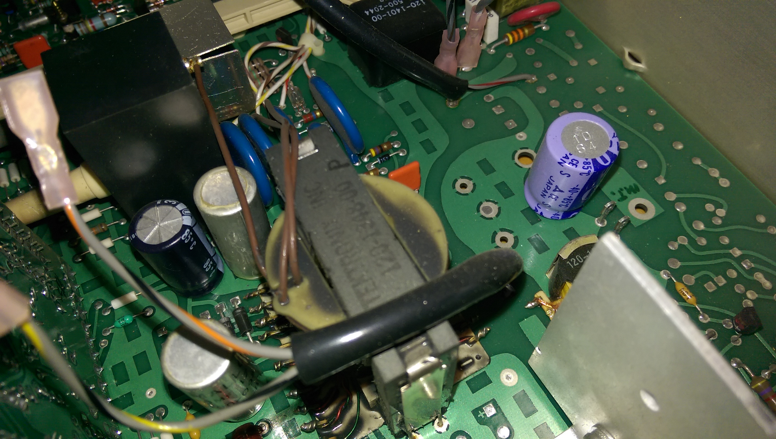

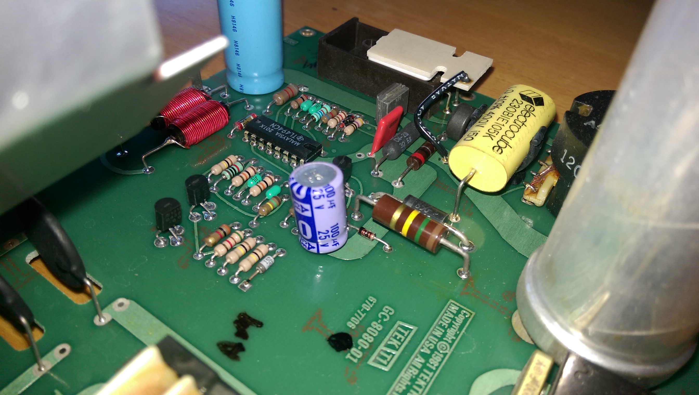

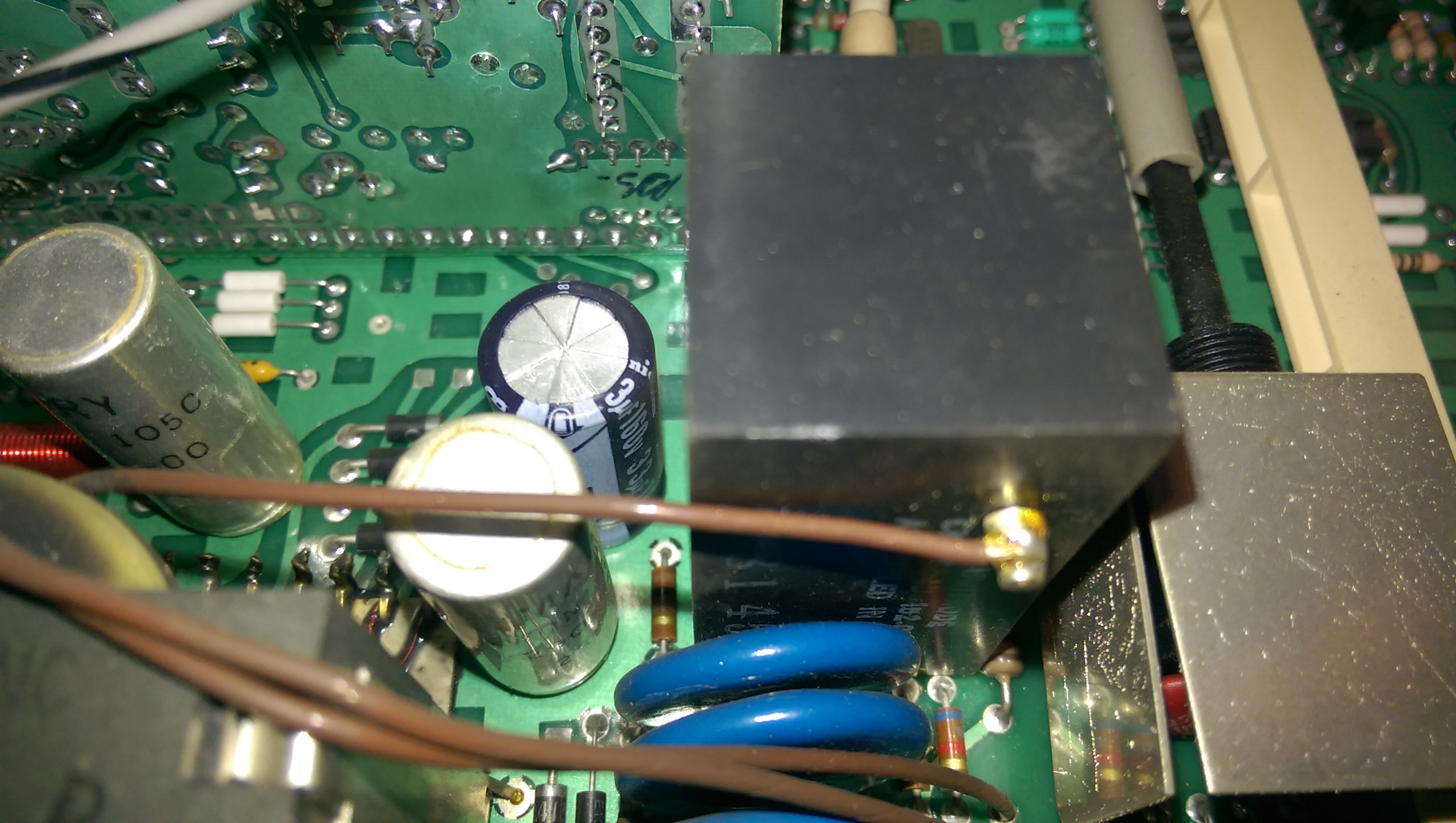

    I gave the PCB's a glance over and found one cap looking a little suspect.
    Desoldered it and sure enough some electrolyte on the negative leg.
    It measured fine though for capacitance and ESR and I didn't have anything to replace it with so I put it back.
    What do you say, should I recap it and if so with what?
    Most of the caps don't have any model designation.
    Of course they are all quality caps like Mallory, Sprague, Nichicon & Nippon Chemi-Con.

    What does the cap look like when you clean that stuff off?

      Looks like you pulled out a circuit feed-thru when you removed that cap. Its still on the positive lead of the cap. I would just use the scope as is if its working fine now.

        Re: Tektronix 2215 Oscilloscope with preregulator board recap?
        you pulled the through-hole plating, but the cap is still fucked.
        if i have to use "regular esr" caps, i use panasonic NHG
        i cant remember why i selected those, probably temperature or lifespan.
          Yes I know, the through hole was not actually used for anything, it's a simple dual layer PCB with no tacks on the top where this via went to.
          Nonetheless I actually did manage to put it back on anyway, steady hands
          Thanks for the tips, guess I'll leave well enough working alone
