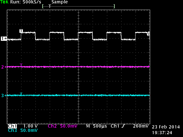

                  Once you get the trace on screen there should be a spot on the 'scope labeled "PROBE CAL" or something like that on the front. Use the probe on that point and you should see a square wave on the display. You'll need to adjust the trace knobs to get it to display right but if you get nothing at all either your probe is bad or there's a scope issue.
                  The wave will look like this wave, except cleaner being an analog 'scope over a DSO. The horizontal position doesn't matter as that's just controlled by a knob and you'll only have one line.

                    I have the scope set to AC 50mv 1X. There's a bunch of other things the directions said to set but I'm not sure what is relevant.
                    I turned the horizontal position fully counter clockwise and slowly rotated the vertical position from full counter clockwise to full clockwise. Then I turned the horizontal a bit clockwise and rotated the vertical a full sweep again. I repeated this until the horizontal was fully clockwise. I did this on both channels. It's my understanding that I should've seen something if this scope was working properly. Is this correct?
                    I tried the "AMPL CAL" plug as well with no results on either channel.
