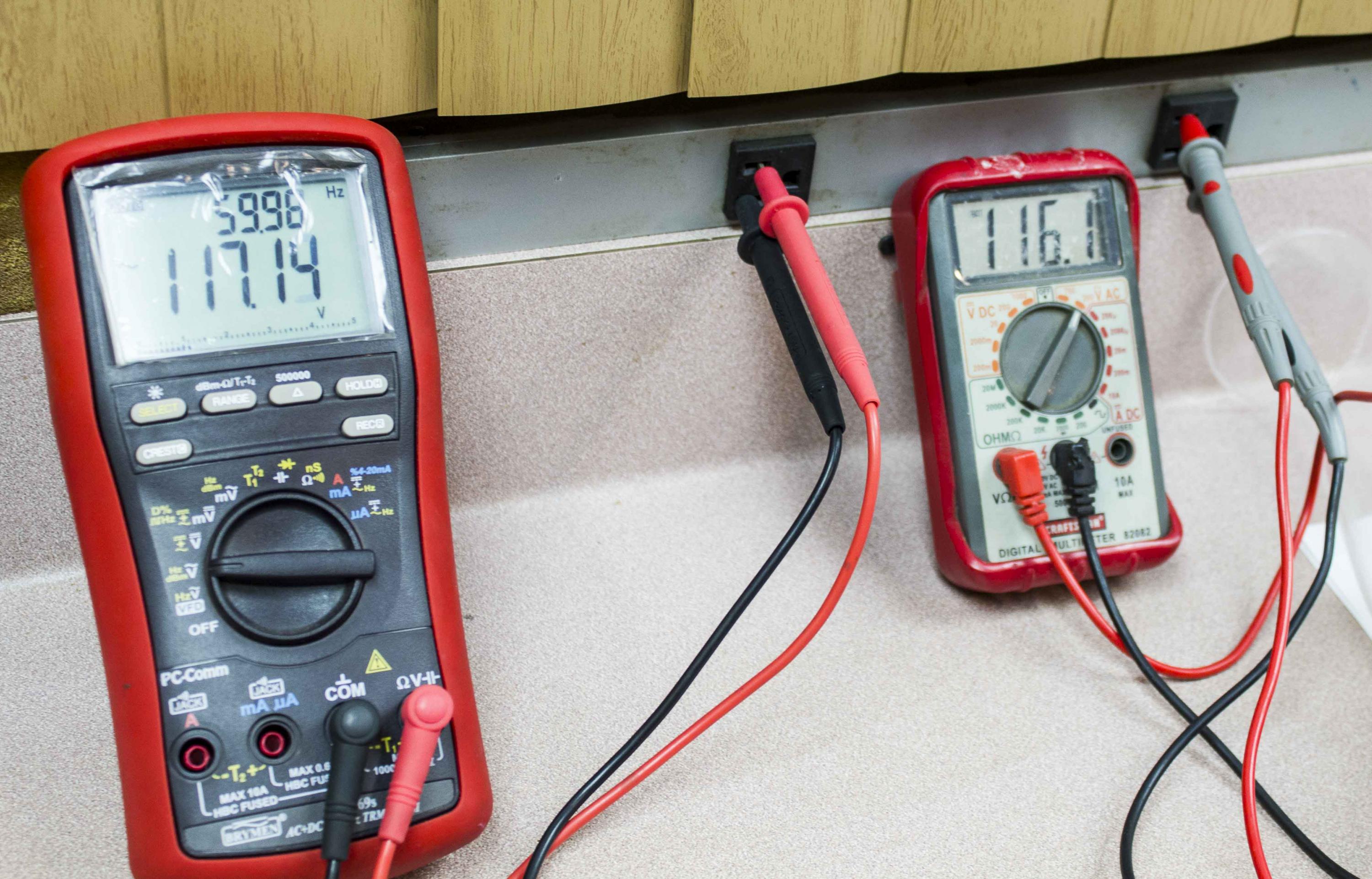

      this is completely separate, but my Milliamp range is inaccurate. by a lot. say my meter shows 200ma, but the load is really 100ma. this is based from an harbor freight cheapo and the 10A range of the 869.
      Can you actually get some real measurement values as to the error?
      A picture of the BM869 and your Harbor Freight in series measuring the same current load would be idea. In an earlier post, I referenced
      http://mrmodemhead.com/blog/yokogawa...03-multimeter/
      In that blog, you can see the Yokogawa and Fluke 189 both in series measuring the same current so we can see side by side.

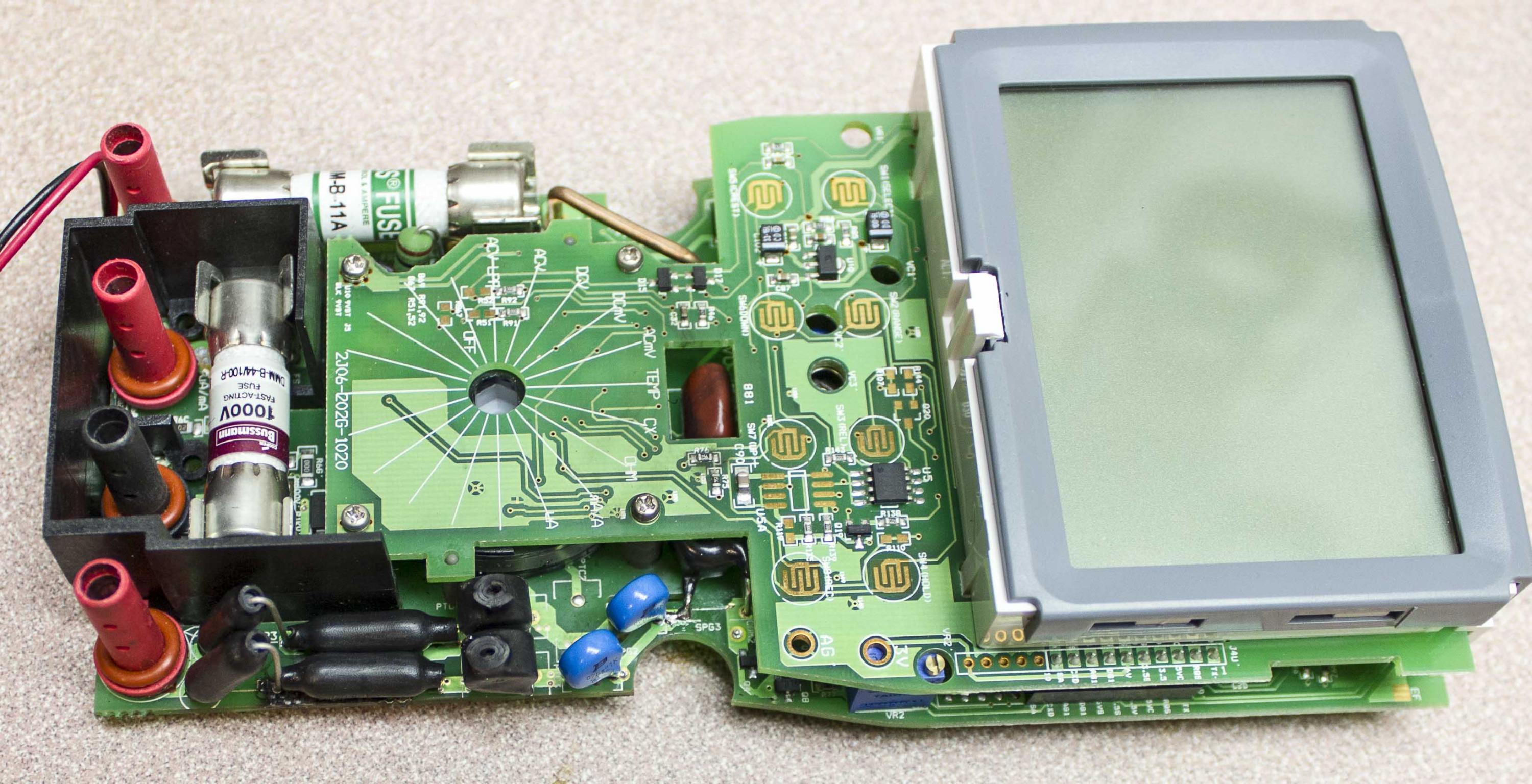

                    Here is a suggested list of replacements. I tried to pick the big name/well known/reputable brands.
                    1) Bourns 820V varistor - 17 cents each x 2 = 34 cents total
                    http://www.digikey.com/product-detai...7D821KTRCT-ND/
                    2) Epcos 500V PTC 1.1k ohm - $2.31 each x 2 = $4.62 total (NOTE: This is a 500V PTC, not 1000V)
                    http://www.digikey.com/product-detai...3890-ND/652053
                    3) Vishay 1k ohm 3W resistor wirewound flameproof - 87 cents each x 4 = $3.48 total
                    http://www.digikey.com/product-detai...KCT-ND/1587922
                    4) Bourns 1000V varistor - 49 cents each
                    http://www.digikey.com/product-detai...02K-ND/2798254
                    0.34 + 4.62 + 3.48 + 0.49 = $8.93 + whatever shipping (I'm guessing $4 USD for first class).
                    Please note that while there is a 1000V PTC that 1.1k ohm, it is not available for purchase anywhere that I can find. The part number is YS4020. Datasheet at
                    https://cdn.badcaps-static.com/pdfs/...52b8cf1a8b.pdf
                    As such, I would consider this repaired BM869 NOT a UL listed 1000V meter anymore. While the repaired meter is likely okay for normal househould mains use (120V), I would urge caution and practice good safety like wearing goggles, using hand-free probes and not working alone.
                    I will leave it to the OP to double check part numbers and specifications, but more importantly, check the dimensions of each components. I don't have a BM869 so I cannot verify if these replacement parts are the same size or larger.
                    Email from Brymen re components ...
                    "Those components are:
                    R1 ~ R4: 1k ohm/3W wire-wound resistors
                    PTC1, PTC2: 1.1k ohm/1kV PTC
                    SPG1, SPG2: 820V Zinc Oxide Varistor
                    SPG3: 1000V Zinc Oxide Varistor"

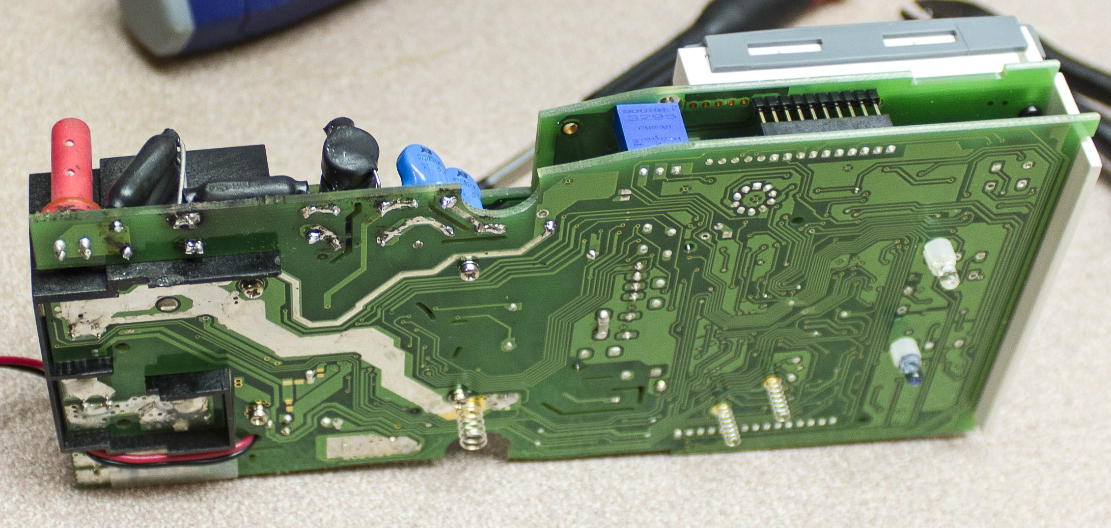

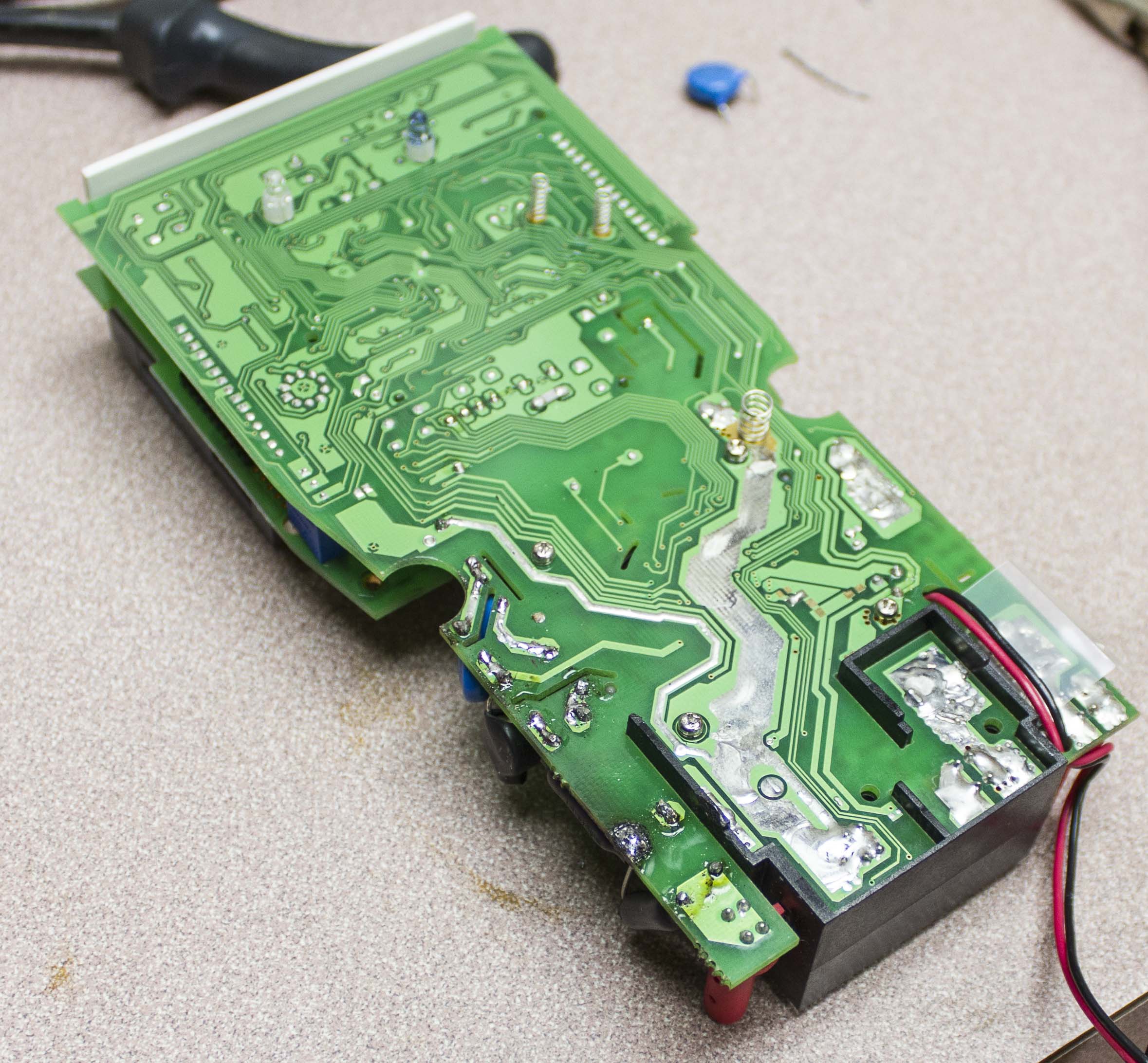

                                    Alright. done patched it up and got some pics. and if you are wondering about the flux and soldering, i took that pic just after cutting the leads and later cleaned it up with some 91%.
                                    ohms mode works, havent tested accuracy and all modes yet. but it should be fine as long as i dont do something stupid again :/
                                    really surprised it didnt die completely.
                                    Thanks all so much for the help.
