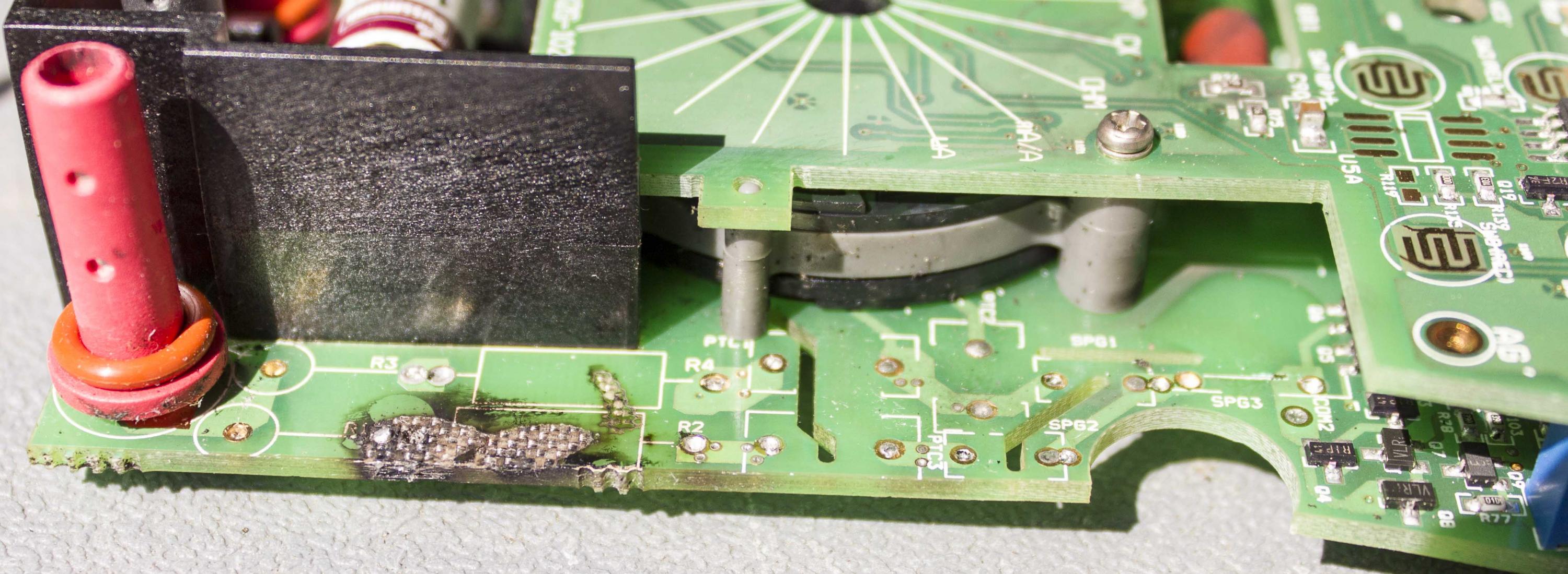

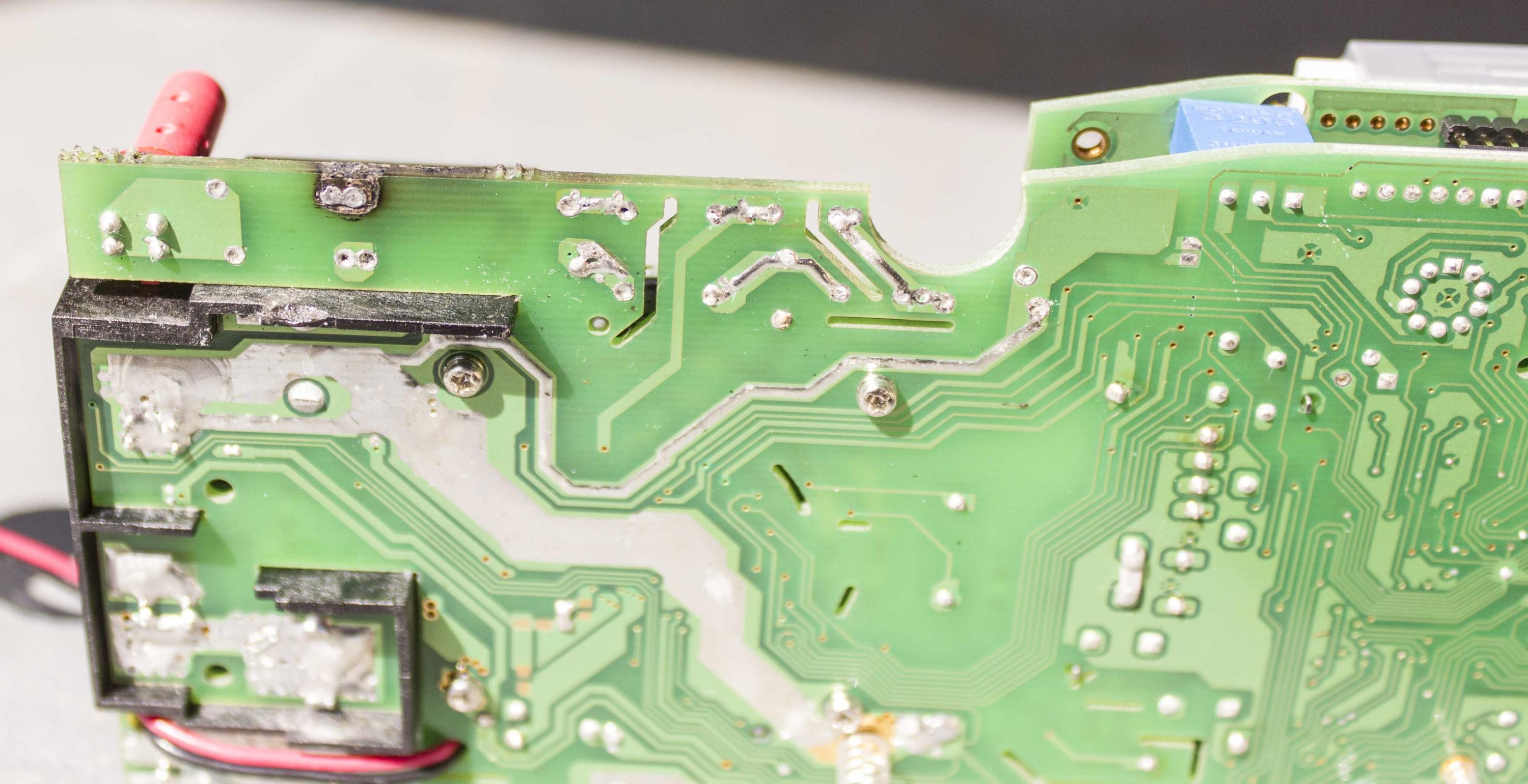

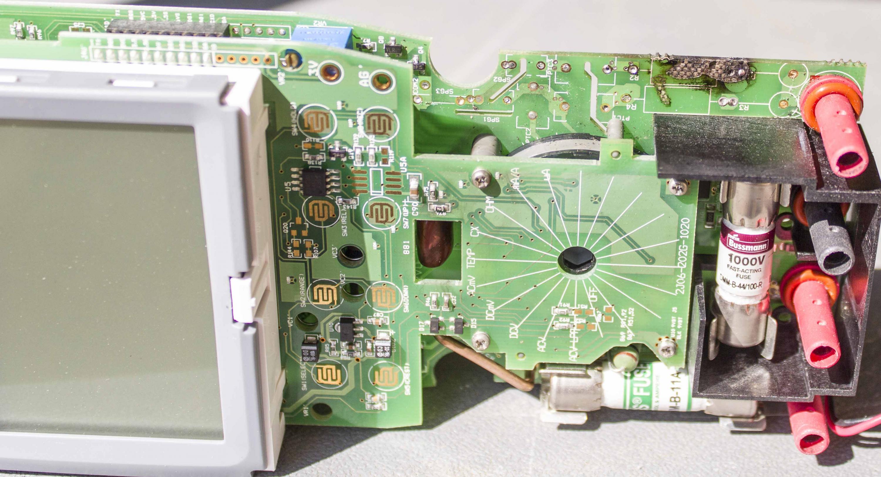

        i did measure the values of the parts i took off jff, referencing pic 36, the bottom left resistor measures 1k, the others broke taking them off. both ptcs are open. movs are 200ohm, open, and the big one is 1k. the r76 is just some residue on it, tests ~12.7Mohm and reads 156. same as r75. cleaning up and pics now.
        I have seen some abused meters, but this one is in the top 5.
        If you are willing to put in 1 hour work, I suggest removing all 4 power resistors (green), 2 PTCs and 3 MOVs. No need to measure or test the components. They are all likely bad just by looking at the pictures.
        After removing all these components, scrub the entire area with 91% IPA using a clean toothbrush. Scrub until all the carbon residue is gone.
        After it has been cleaned and dried, please post pictures so we can assess the damage.
        If the damage looks minimal, we can, temporarily, put in regular 1k ohm resistors for the 4 power resistors and 2 PTCs. For testing, we do not have to put in any MOVs.
        So with 6 temporarily 1k ohm resistors, we can power up and see if volts and ohms work. If it works, then we can order proper replacements.
        PS. Post a picture of R76 and measure it in-circuit.

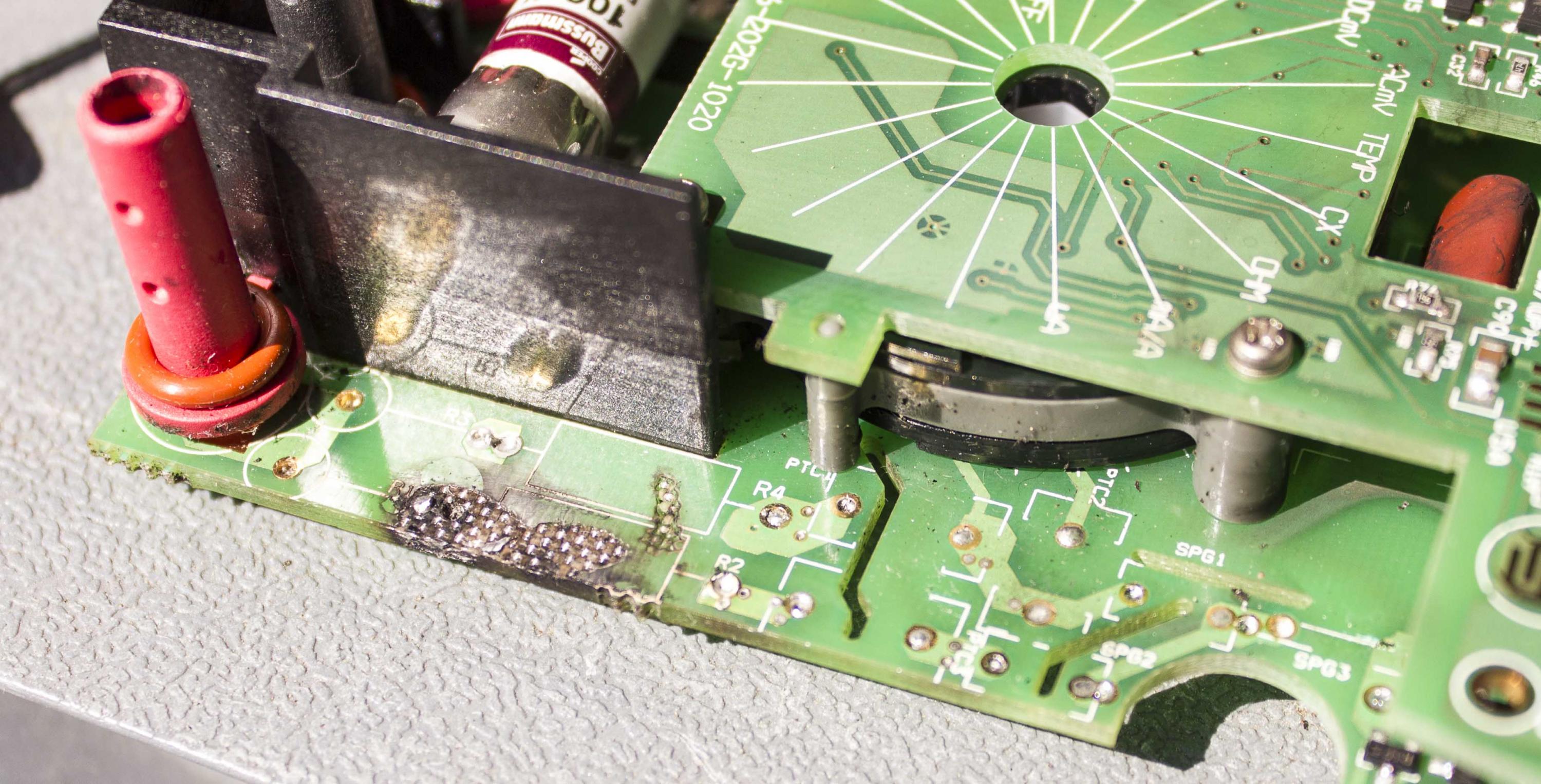

            Except for that one resistor area, the rest of the pcb looks pretty good.
            I would take a bit more effort to clean off that carbon residue. Here are two case studies by modemhead where that carbon can be conductive.
            http://mrmodemhead.com/blog/ideal-carbon-footprint/
            http://mrmodemhead.com/blog/yokogawa...03-multimeter/
            After cleaning that area a bit more, I suggest soldering in the 1k ohm resistors as discussed and trying some low voltage measurements like measuring a 1.5 AA cell. Then try measuring a 1k ohm resistor.

              I cleared as much of the black away as i could without digging too deep. i soldered in those 6 1k resistors and upon power up in volts and ohms it correctly shows 0 volts and 0 ohms, then with a battery showed 1.4v and i had a 40k resistor that showed within spec of the resistor. even gave capacitance and diode a test. didnt try ac measurements as i have no readily available ac source besides the 120v line. dont wanna blow it up a second time.....
              is it now time to order correct replacement parts?

                Can you post a picture of the updated pcb?
                Does the 1.4V reading match another DMM?
                So it sounds like you lucked out and the input protection components protected the main proprietary IC.
                If all the other functions work, AC likely works.
                I would say yes. We need the help of the eevblog community to find out the values of the two PTCs. I'm not sure if the PTCs are connected serially or not?
                We also need the markings from the 3 MOVs in order to get the proper replacements.
                For the power resistors, we know they are 1k ohm, but I'm unsure what size and type (flameproof, fusible, metal, etc?). I'm guessing 2W from the size, but they could be 1W.
                I'll post a question on the eevblog forum asking for the above values.
                Now there is some concern given the damage to the pcb that the input protection might not have the same performance in a future "oops" moment. I can pretty much say with confidence that if you sent this meter back to Brymen for $$$ repair, they would chuck it in the recycle bin and send you a new meter. They have to worry about meeting UL standards, liability, etc.
