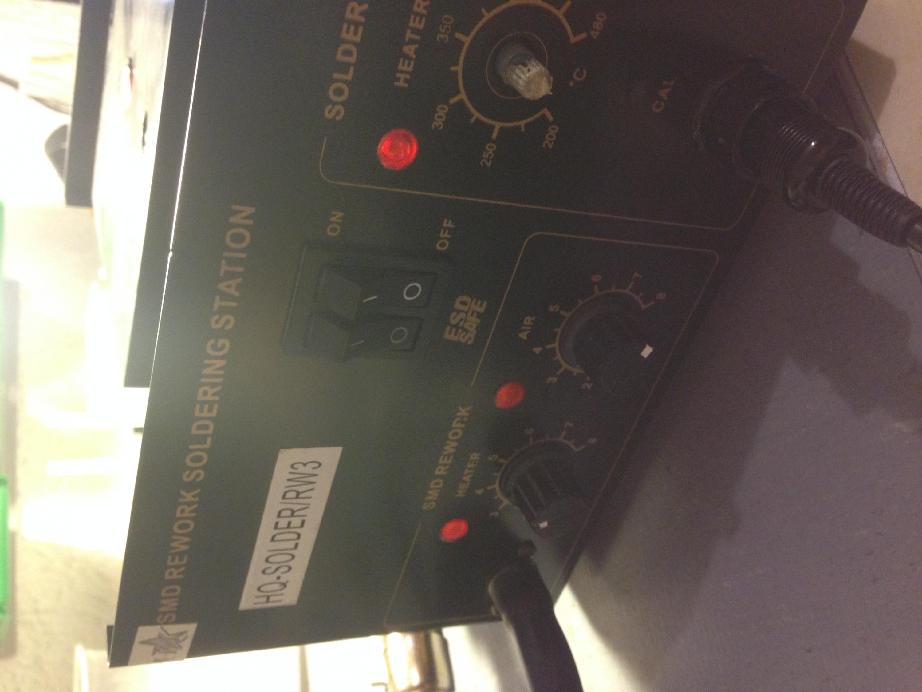

    Hello, i need some help. On my soldering station solder iron died (heater) So i order new one and when i get it it wont work.
    So i check it, disassemble it and i cant read the resistance of heater! Am i doing this right?
    On pins from the picture i can read 28V AC so i think the heater is dead?

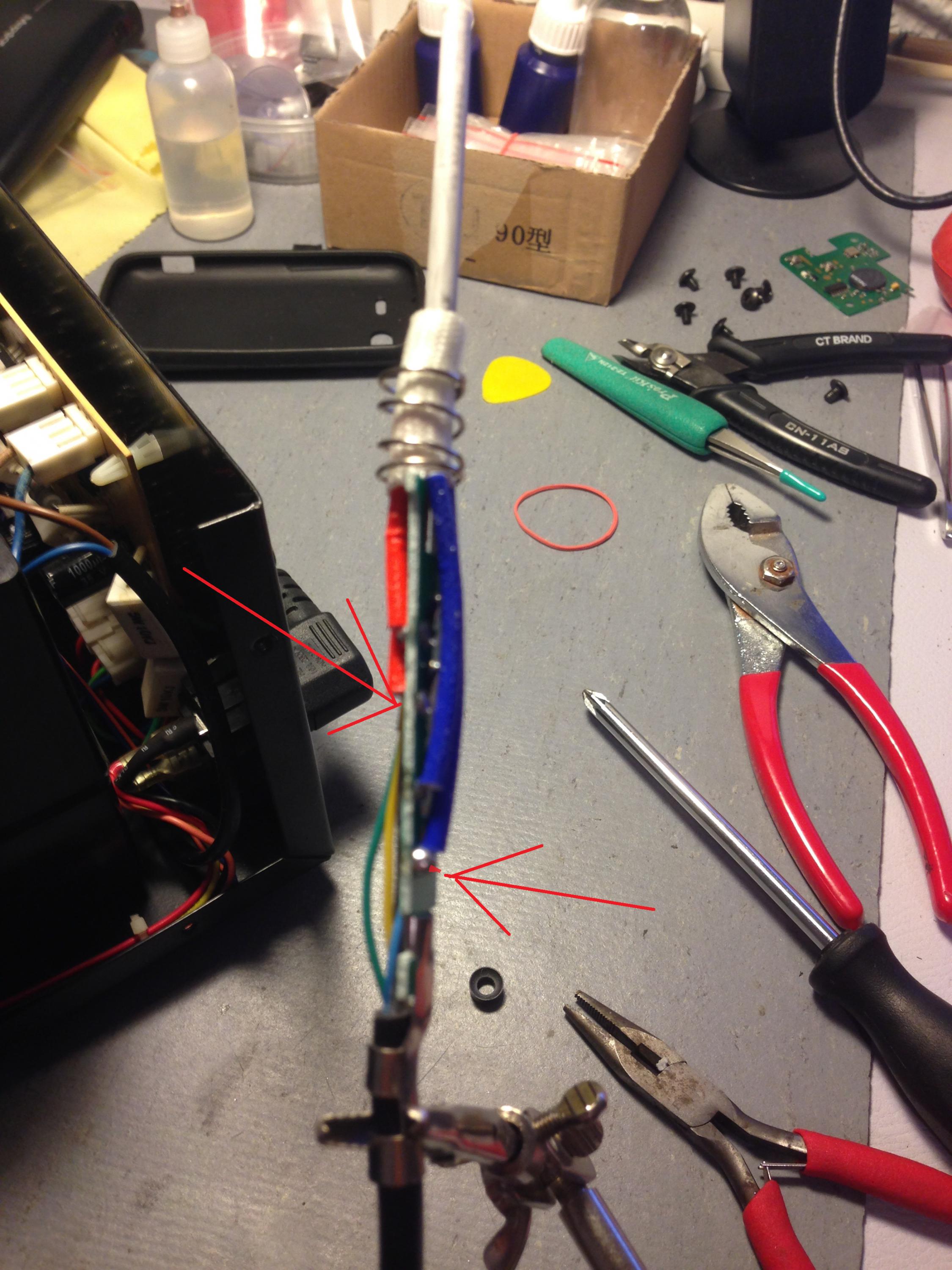

        hello i noticed that i have 28V between red and blue wires. So i think this hakko soldering iron have different wiring.
        ...the quieter you become the more you are able to hear...
        • rtstorm
          • Feb 2012
          • 971
          • Croatia
          Re: HQ SMD Rework station soldering iron repair
          i have check by this link
          https://cdn.badcaps-static.com/pdfs/...9e73bfb1cb.pdf
          and i have pin 4 and 5 - 3ohm, pin 1 and 2 - 54ohm, and pin 3 and tip - 2 ohm. i measured output from station on pin 4 and 5 i have 3VAC

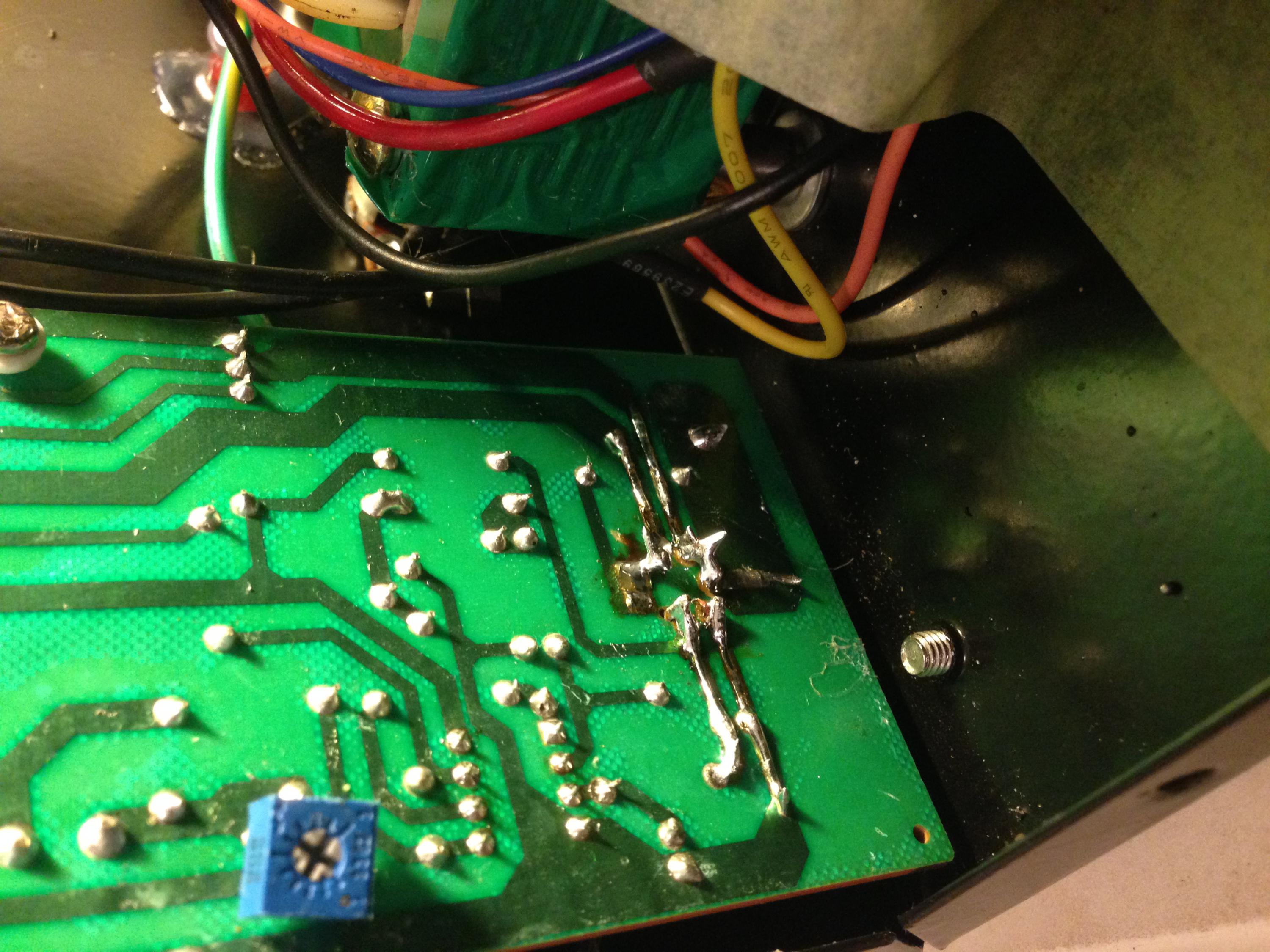

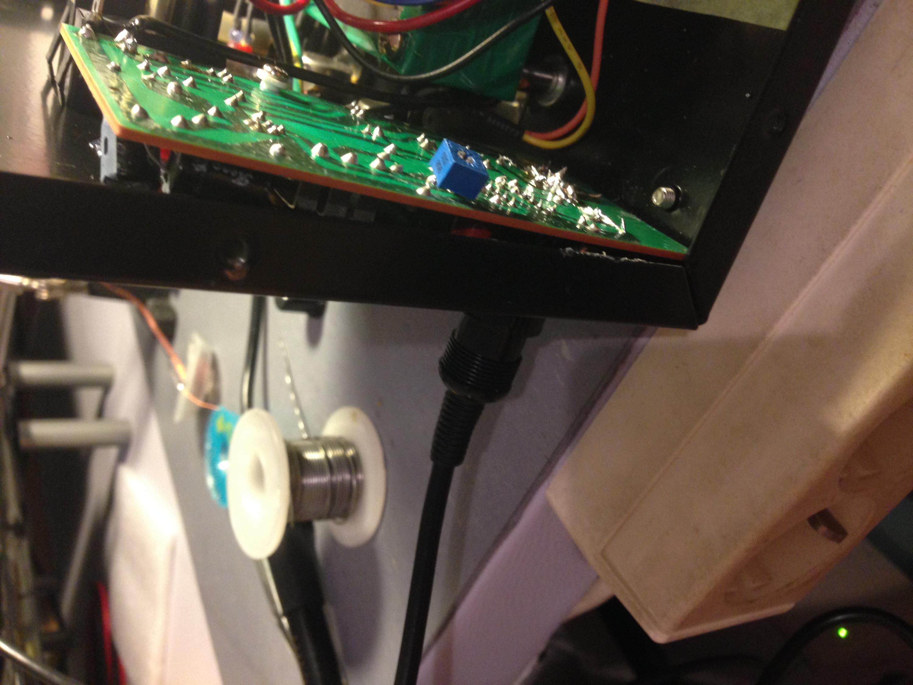

            ok i am stuck at this and cannot get this thing to work. I changed heat element and i cannot get 24V on heater. I disasseble the station and i see a crap of soldering. Please tell me how this this work? What shoud be connected to sensor and what to heat element?

                  these cheap units keep changing the wiring around, that's probably why you have that mess where the pcb connects to the socket.

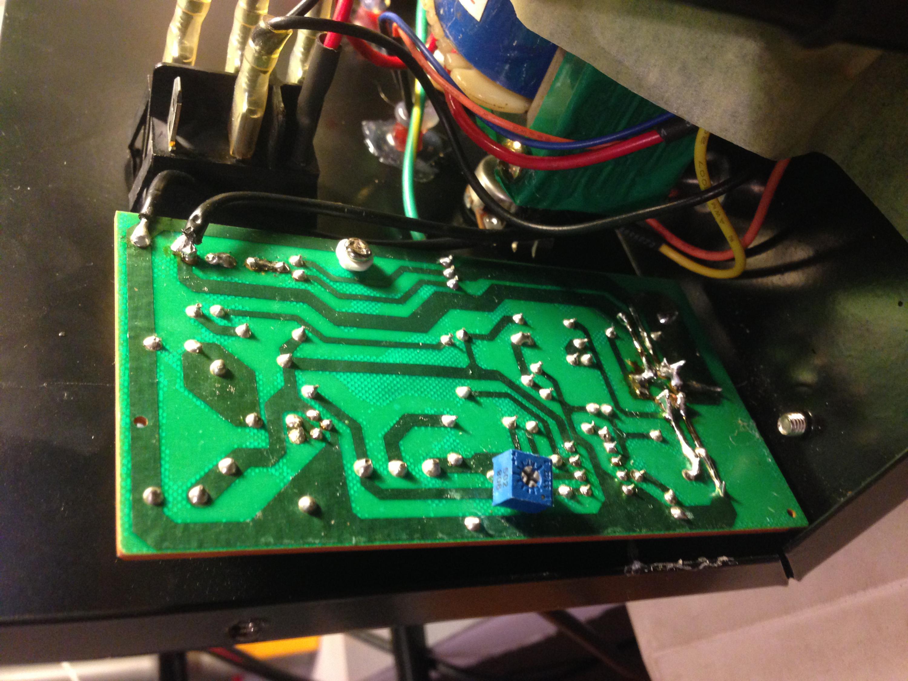

                          i notices when i shorted sensor pins the heater instantly go really hot. i think that something is wrong on board.

                                    ahh i going crazy, now main filter capacitor i blown every time i turn on soldering.
                                      • 31196
                                      then a rectifier diode is shorted.
                                      • rtstorm
                                        • Feb 2012
                                        • 971
                                        • Croatia
                                        hmm, i test and it's OK. But now i see that i put 16V cap the voltage of board is 28V AC. I think that is the reason why it was blown
