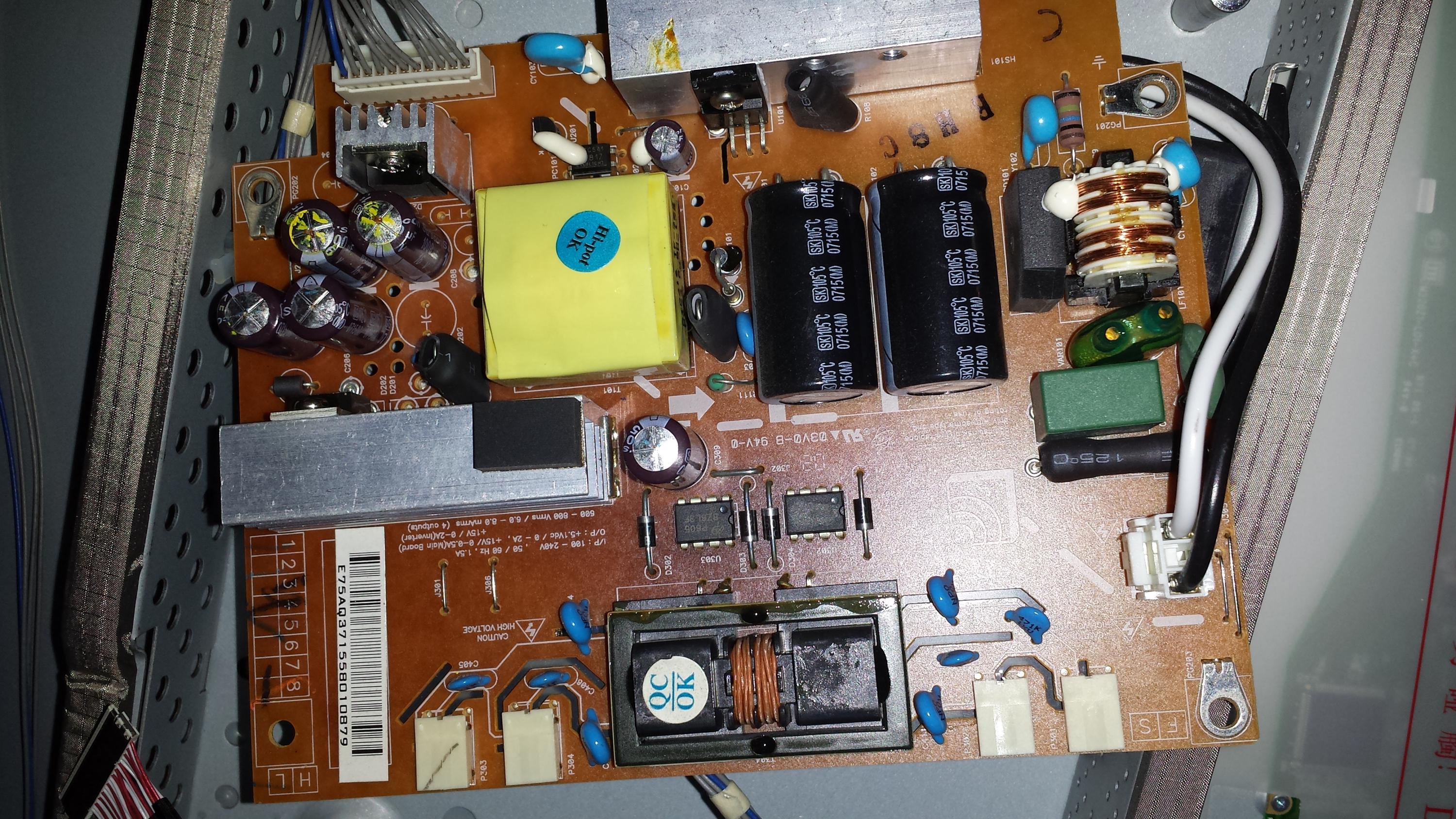

            Re: [newb] Need some advice on difficulty of this repair
            Ok, so here are the pics (I'll add them to my old thread too)
            Budget wise I'm preferably looking for under 50-75 bucks all told (including the caps for the job). I'm a "semi employed" college student, so money is tight. I already replaced the monitor that died, so this is more of a "nice have" project, than a must repair deal.
              that looks like the same psu i'v converted for LED on some HD-tv's
                for that soldering, a normal 8€ soldering iron + desolder wick + rosin flux + 63-37 or 60-40 tin is more then enought, just pay attention to not stay too much on the pad (if iron get too hot)or u can damage them.
                if ur badget is 70 bucks dunno if a controlled temperature iron will fits your money; maybe some only iron atten (936b) is 50 or 60

                            On the last one, bammbammfran suggested i replace it, but I'm looking at it, and I'm not sure, plus, I'm not positive what the putty like substance is on the side, almost looks like thermal paste to me.
                              • 31163
                              CHANG brand?
                              you gotta be fucking kidding me - we take those out and bin them on sight!!!
                                Those caps are a dreadful choice! Noname brand one picture is even a Changi
                                You NEED to use good brand caps else yuo will be redoing it again in a month or so.
                                    This site has a store, you know.. see here: https://www.badcaps.net/store/ - go there and add the capacitors you need in cart and order them.
                                    You should replace with capacitors of same capacitance value or just a bit higher (10-20%), the voltage rating MUST be at least equal to the voltage rating of your current capacitors if you don't know what they do in the circuit. You can use capacitors rated for higher voltage but unless you know what you're doing, never use capacitors rated for lower voltage.
                                    Pay attention to what's written on the capacitors on your board. You have 5 that definitely should be replaced (the four on the left top corner and the one in the center) and a sixth one is optional (the small value one on top center part of the board by the heatsink.
                                    You don't need flux pen, but it wouldn't hurt to use extra flux. It's optional, you'll do ok with some decent solder with good percentage of flux inside.
                                    The holes on the pcb are large and so are the pads, so you can use solder of thicker diameter, too thin solder will just give your wrist pains from the amount of solder wire you'd have to slide onto that pad.
                                    No need for solder wick, a solder sucker will be a better tool for you but even that is not that required. A solder sucker will simply be more versatile and cheap solder wick often comes without flux or with very little flux, which will make the wick useless and will make you think you're doing it wrong, while it's simply the wick bad.
                                    The holes on that pcb are so large that you can just move the hot iron tip from one lead to the other of the capacitor and as you do that, gently angle the capacitor on each side and pull out, and the leads will come out. Solder will be in the holes, but you can just put the iron on the solder and you can then insert the new leads through the liquid solder.

                                      • 31163
                                      you need to aim for panasonic or rubycon.
                                      and NOT from ebay/amazon because they are all re-labelled crap.
                                      you also need the right series.
                                      for a psu repair i would recommend panasonic FR type or FK type or FC type - in that order.
                                        You need indeed Low ESR capacitors, can't just use anything.
                                        Ideally, you would match the impedance (it can be a bit lower) and ripple (it can be higher) but if that monitor survived with capacitors going bad slowly to the point electrolyte evaporated, the circuit won't be that picky.
                                        So don't worry about right series, pretty much all capacitors on Badcaps store are low esr and good enough, just match capacitance and voltage like instructed. Panasonic, Rubycon, Nichicon, United Chemi Con, even Samxon stocked by Badcaps store will be fine.
