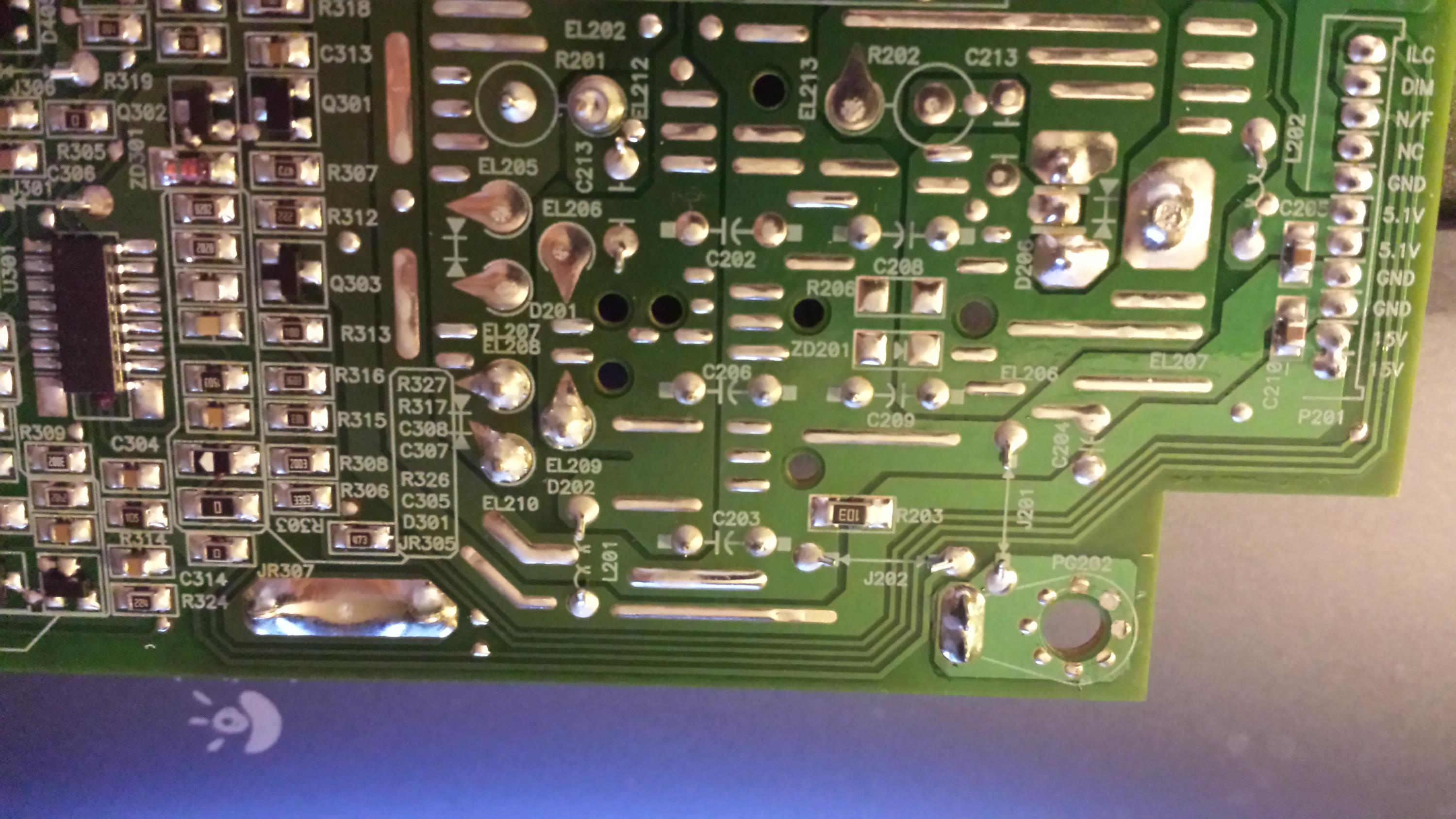

                      One last set of pre-op questions. On the back of the board, there is a seemingly significant amount of solder like material in lines going from place to place, is that something i need to be concerned with melting away? or is it something that has a higher melting point than solder will?

                        Make a picture and point out what you mean.

                          Re: [newb] Need some advice on difficulty of this repair

                            That's just tin/lead free solder applied on the traces to make them able to carry more current without heating so much.
                            You're not going to put so much heat on the board to make that solder flowing.

                              ignore that,
                              your iron will only melt solder wihin a few mm of where you place it.
                              and even if you did melt that it would just re-solidify when you remove the iron.

                                  Ok, so The board is almost done, here's my work so far (forgot i had one more large cap to do, not going to do the small one, since I don't know what the substance is on it that's covering it)
                                  https://drive.google.com/file/d/0B15...it?usp=sharing
                                  My only concern, at the moment is that I'm not able to snip them very close to the board. Hopefully it won't be an issue.

                                    i dont know how you did it that badly, but i have an idea.
                                    what temperature did you set the iron at?
                                      about 60%, which was reading ~400C.
                                      Is it going to be non functioning? or just ugly?

                                        400 on leaded solder?
                                        i think it should be more like 250.
                                        do some tests on the tip of the iron - you want a temp where it melts pretty instantly into a shiny liquid ball.
                                        if the iron is too hot you get what is called a "dry joint" where all the flux burns or evaporates and the solder goes nito a sludge instead of liquid.
                                        the joints should not have an uneven surface because when you lift the iron off they should still be liquid.
                                        dont touch the board again, practice with the iron first - get the hang of soldering and play with the temperature settings.

                                          What of the tall leads, is that going to be a problem?
