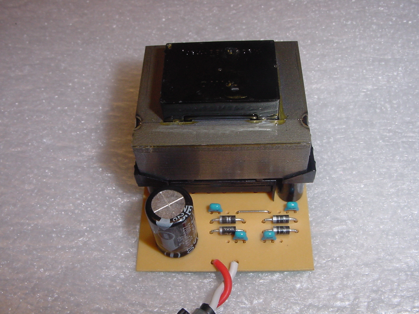

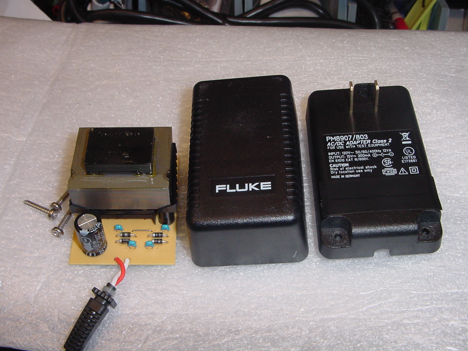

    Have two dead out of four power supply for (4) FLUKE 43B.
    The resistance reading on the two power prongs shows open circuit.

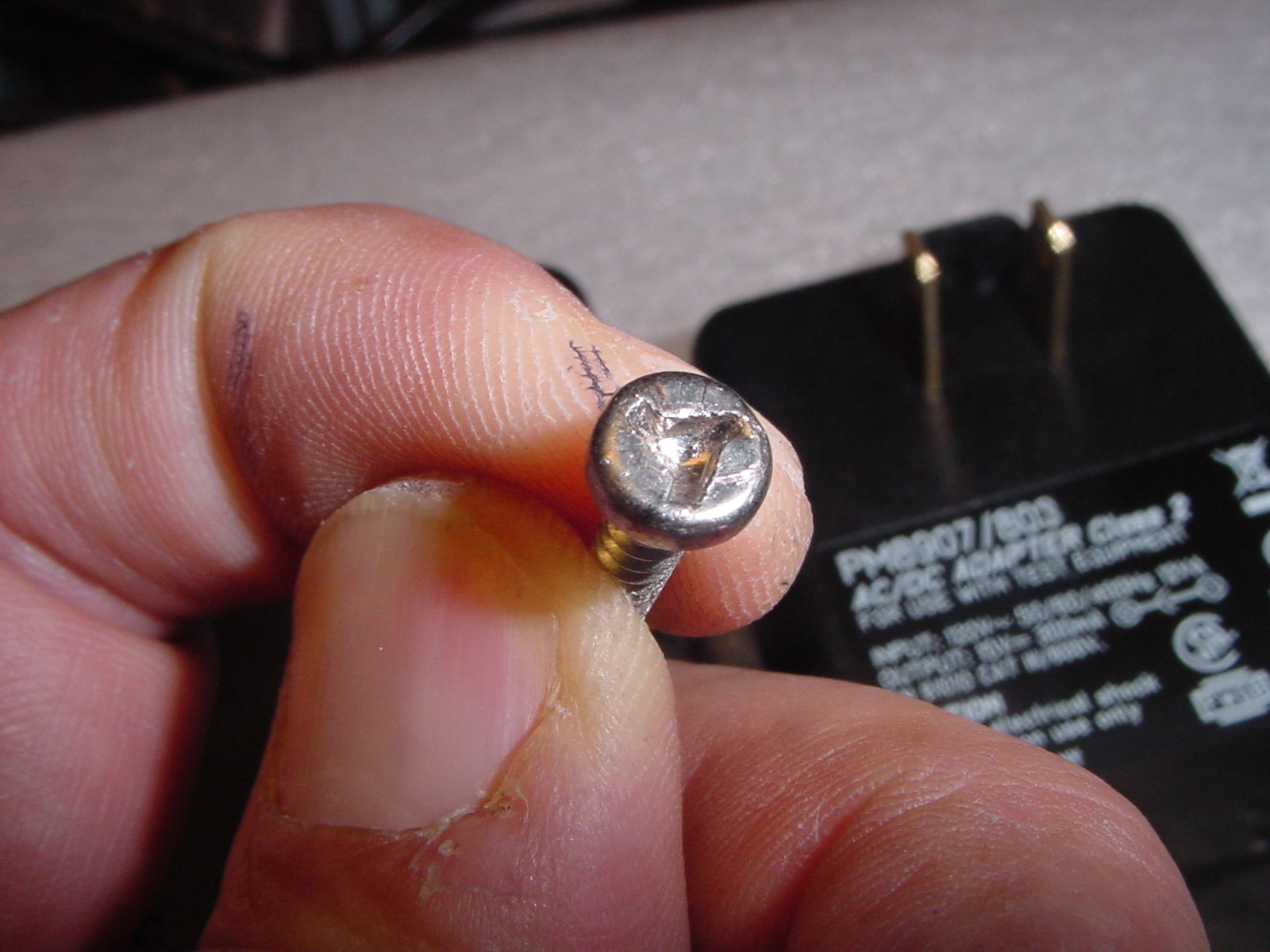

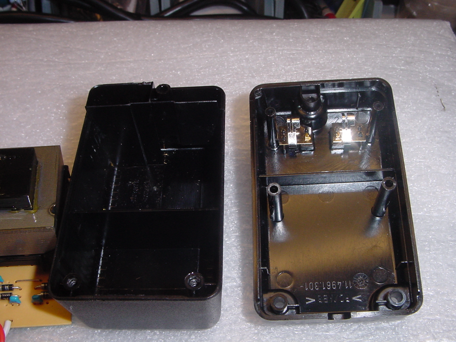

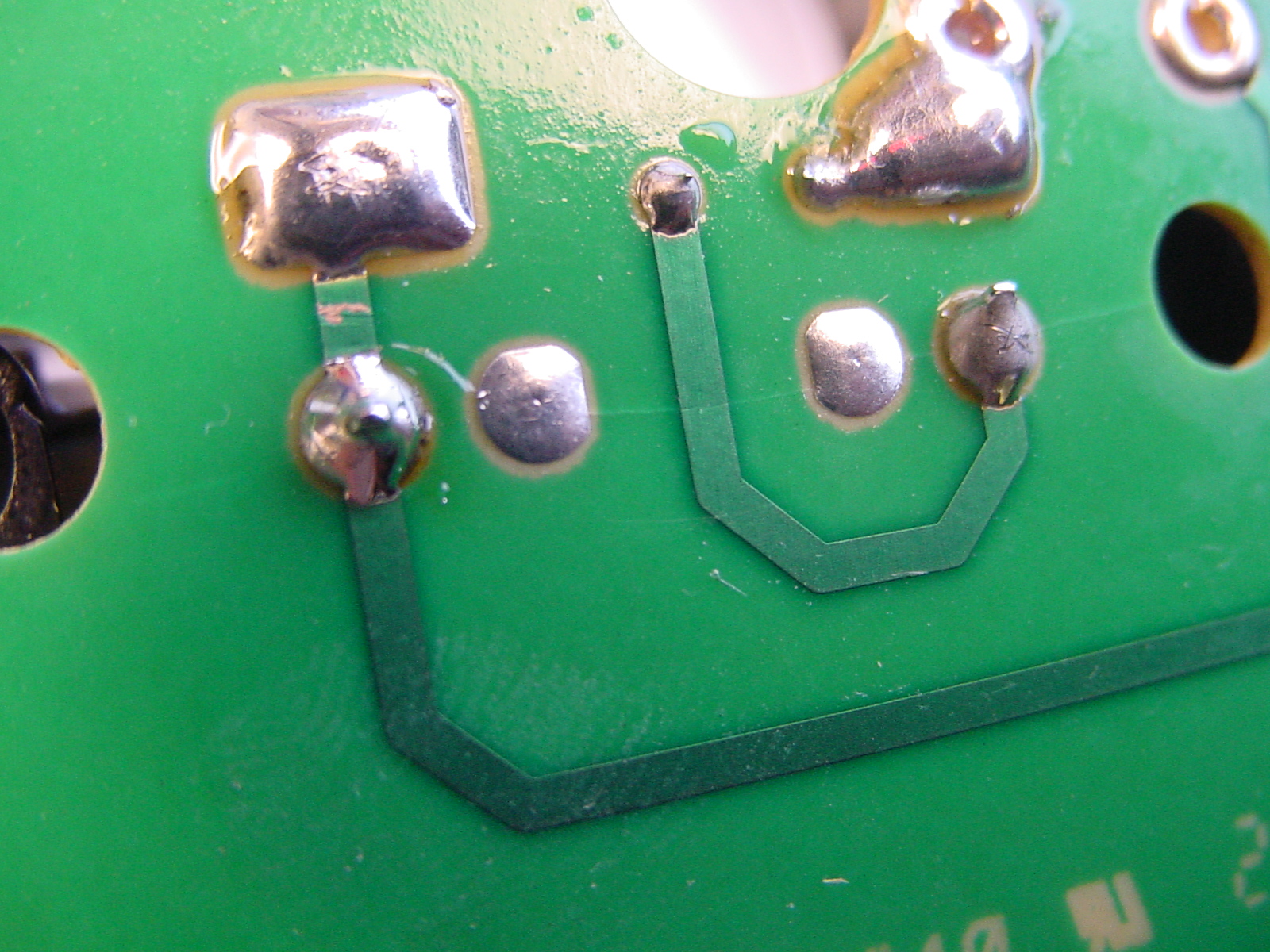

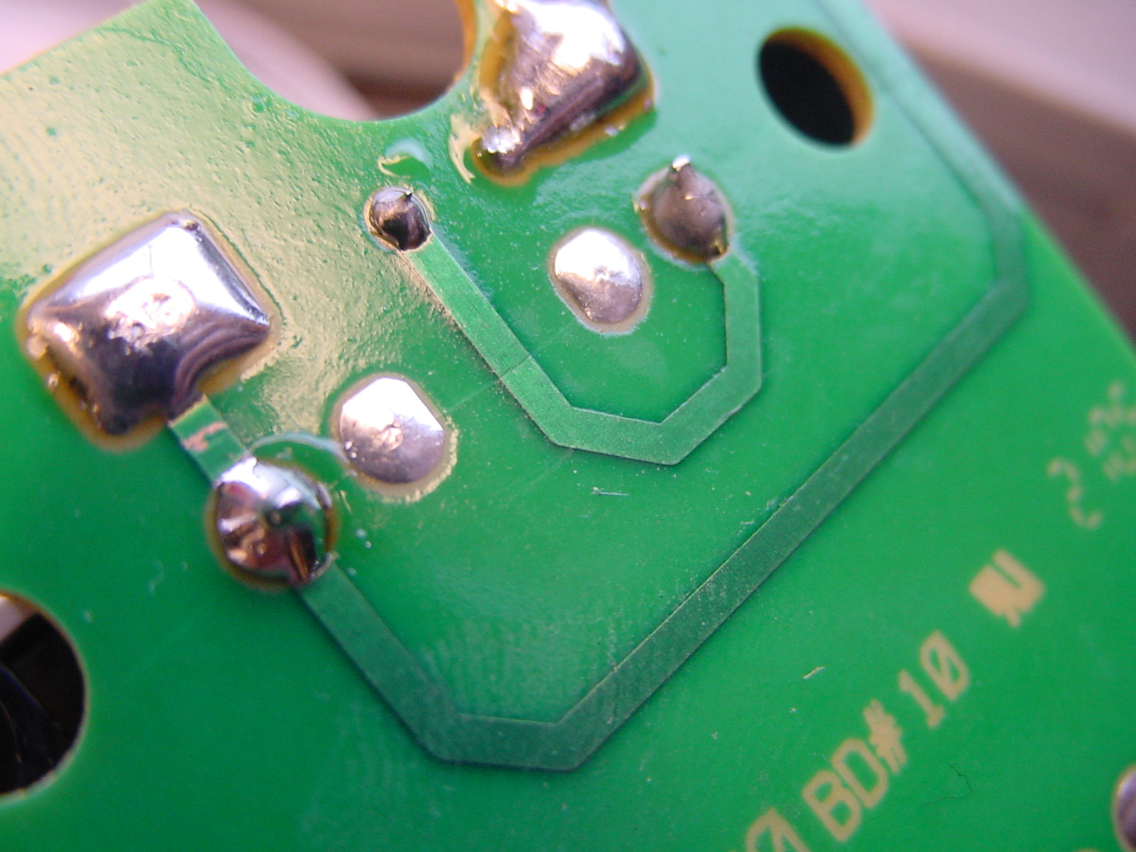

    Open up the module, you will need security bit, and found hair line crack on the circuit board. Too bad that FLUKE did not spec in fiberglass PCB to build this power supply.
    Fixed the broken traces and added epoxy to the PCB to help supporting the board.

        Power supply is made in Germany with lousy cap. The replacement power supply is around $100.
