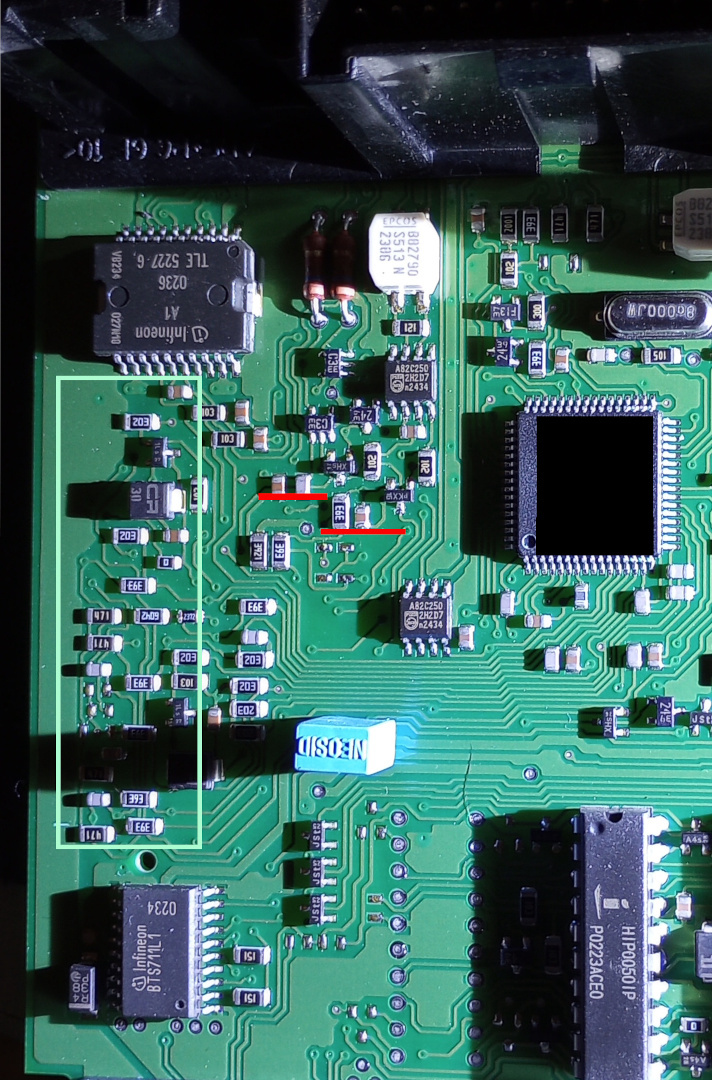

    I'm a newb concerning electronics repair and I'm looking at a Hantek DSO2D15 oscilloscope. It's on sale for a good price IMO. I'm asking any feedback concerning this device and a few power supplies if anyone is willing the help an old tech.
    The Hantek seems like a decent machine for $175 new. I'm also looking at a 60v 24a power supply for $60. Sound like a good deal?

          Everything I get will be used for testing and checking automotive control module circuitry. I'm starting with automotive power distribution.

              I'm working on a Mercedes and yes I will be working on the CANbus occasionally. I've been troubleshooting the Xenon headlamp power circuit. No voltage from the AAM to the EAM so that's where I'm working atm.
              The red lines are where the current stops and the green area has voltage throughout that area. I need a power supply for bench testing and that's why I requested some feedback on equipment. Testing that while it's in the vehicle is not fun because that module lives just beneath the engine compartment fuse box.

                  This may not be a faulty circuit. I was studying about a specific DTC concerning the headlamp zero leveling and I have the same problem one person had a while back. He took some measurements, adjusted the front suspension to +1 inch lift to match the rear and poof! Fixed. WTF I'm going to take measurements tomorrow while installing a new a s-belt to see if there is a height difference.

                      I use a 2023 Launch CRE for Benz and it does almost everything needed. I've programmed replacement used TCM, reset adaptation data and even learned new key fob transmitter with a tool that was a buck twenty. BTW resolving the out-of-spec leveling didn't resolve the headlight problem but I believe I know why and a few simple tests will confirm the theory.

                        headlight leveling must be based on feedback from the suspension ride heights so maybe a sensor is dirty or worn

                          The front suspension -1" when compared to the rear so I increased it to match the rear. I d/c the rear sensor looking for corrosion or anything in the connector. Everything was clean and both front/rear sensors did respond to the adjustment. Still no low beams.
