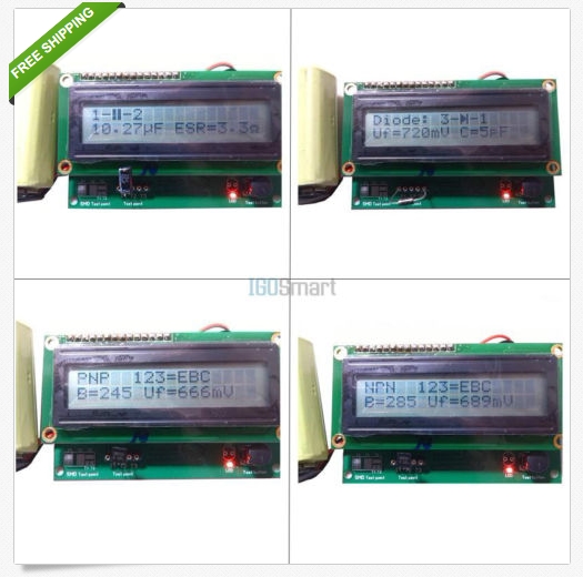

    I'm an amateur. All I need is an inexpensive tool to test if the capacitors I have are faulty. Would this tool (http://www.ebay.com/itm/Capacitor-ES...item3cd5c5e22b) work? It doesn't say that it comes with test leads. Would I need to solder some to the PCB?
    The capacitors I am testing are 2200microF, 25V and 1500microF, 16V. What size resistor should I use to discharge them before I test them?

    This is mostly a DIY transistor tester.

          I have an Anatek Blue ESR meter. I feel it is adequate for most repair purposes, but is not as accurate as a real LCR meter. I bought mine as a kit from a vendor on ebay.
          I have heard that some users are also finding the MESR-100 to be adequate, but I have no personal experience with it (seek out reviews and make up your own mind).
          I also recently acquired a DER EE DE-5000 LCR meter, and it is a much more accurate piece of gear. There may be situations where this meter doesn't work well in circuit (e.g. near germanium or some Schottky diodes).

              It appears to measure capacitance. It does not measure ESR. ESR is often more useful than capacitance for diagnosing bad capacitors. Many circuits will not work if the capacitors develop high ESR, even if the capacitance does not change (or not very much). And this is a pretty common failure mode for aluminum electrolytic capacitors.

                  I have that exact meter and although it may not be accurate, it will definitely work to determine a bad cap. Contrary to many on this site, I use capacitors from defective motherboards and power supplies to fix other motherboards and power supplies. I use this meter to test the used capacitors before I put them on the boards. I don't care for exact measurements, just whether it is good or bad. This meter does fine for that.
                  This meter does not come with leads so yes you would have to solder some on to it. I use it with the socket that it comes with since I have the capacitor already off the board. This unit is very good at identifying components such as pnp, npn transistors, or diodes.
