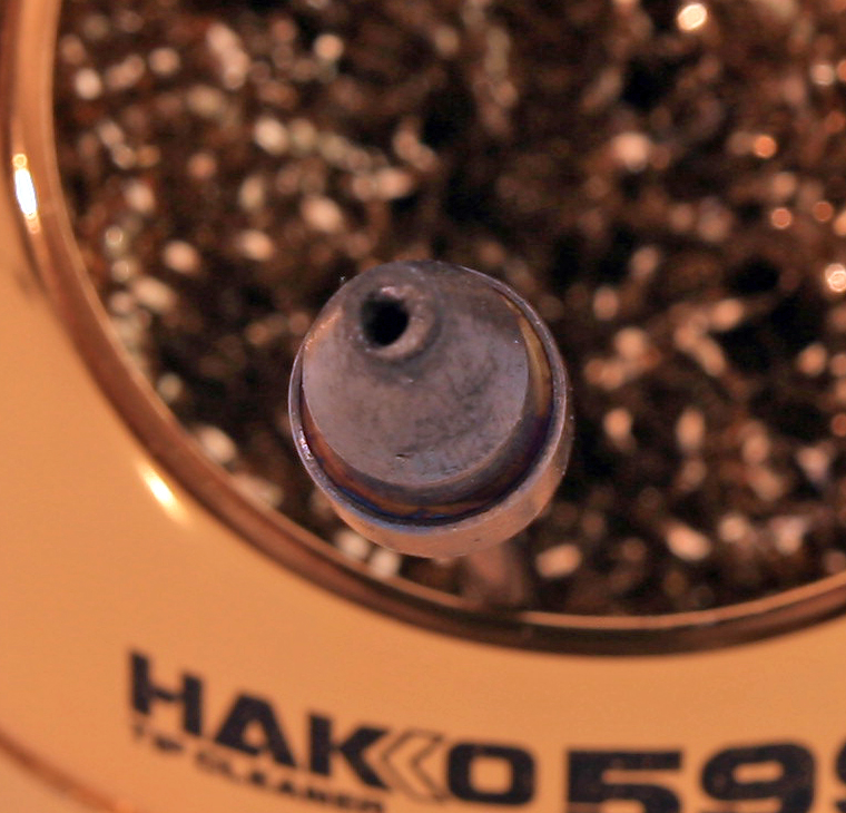

                              2 months past since my purchase of the BK 4000 desoldering station, I repaired may be 10
                              monitors. I already wore out 1 tip. My question is how long does a desoldering tip last
                              is there a better quality tip available for this BK 4000.
                              Other then getting a better quility tip the BK 4000 desolding staion works great

                                Re: Desoldering Iron upgrade
                                Show to us a picture of what you consider as damage.
                                • 1supertech
                                  • Apr 2012
                                  • 384
                                  You can teel that it is worn on side I replace it with a new 1.5mm and it works better

                                    You have get married with a low cost system, which looks to come with three spare tips in total.
                                    My advice is to use them all, and if this system are still standing regarding the health of the heat element and pump, only then move forward & buy some extra tips.
                                    Looking for quality made tips for this system is a wild dream.
                                    There is no such compatibility with solutions offered by other vendors.
