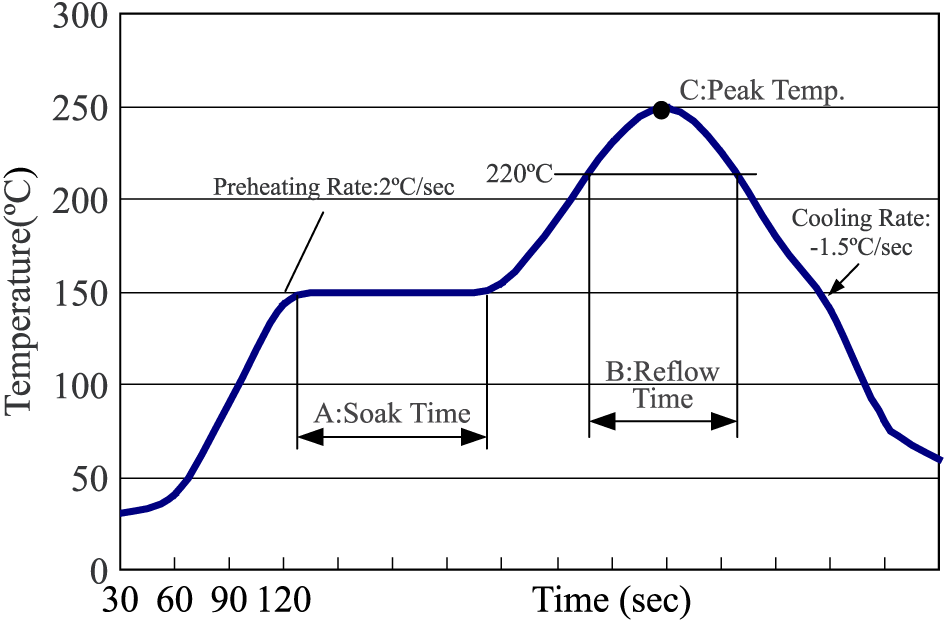

    I'm newbie in reball, so pls forgive me if technical words I use are wrong.
    What may cause the BGA solder pad lift before or after reball? I am having problems where solder pad lifted during removal of bad solder ball. It also occurred during reball, where the pad lifted after BGA been melted 2-3 times due to misalignment of new solder balls.
    My procedure of reball as below:
    1. Bake the BGA at 125 deg C
    2. Remove bad solder balls manually using soldering iron with solder wick
    3. Place new solder balls
    4. Reflow (I'm using hot plate to melt the balls due to limited space, so BGA might experienced sudden change of temperature from room temp to high temp)
    5. Inspection
    Any feedback would be appreciated. Thanks.

    You are lifting the bga too soon and forcing it (not hot enough). That's why the pads are lifting, also when you are cleaning the bga pads with solder wick you are probably spending too much time trying to get them clean and you are over heating them, that causes the pads to lift also. Try to find some bga solder wick it's about 5mm wide, that will allow you to clean the bga pads with a couple of passes and don't forget to use plenty of flux you can never have too much. Look at the picture that I provided, that will give you an idea on the temperatures needed for the reflow process. When the temperature is at it's peak 250deg, you should be able to lift the bga with no problems. You can test to see if it's ready to be removed by lightly pushing it to one side. It should move and fall back into place by itself.

      Thanks for the feedback and profile, I'll try to use the method you suggest, hope it can solve the problems

        can we share out profiles here?
        for remove bga my profiles is
        Air : 5
        IR : 180
        Top
        R1 3.00 R2 3.00 R3 3.00 R4 3.00 R5 3.00
        L1 90 L2 110 L3 140 L4 200 L5 240
        D1 40 D2 40 D3 40 D4 40 D5 40
        bottom
        L1 90 L2 120 L3 150 L4 210 L5 250
              You don't need to get to 250 as you can burn the chip. If it doesn't move when poked at 235C, you've got other issues there. Uneven heating (too little bottom heat), poor quality flux, things like that.
              As for lifting pads on the BGA when trying to clean them, you're probably using poor quality braid, or your soldering iron is not the right temperature.
              I would say it's due to the flux, as you mention that the pads lift from the BGA mostly when the balls have not attached on the first go. If you are using good flux, all the balls should attach on the first go, always.
