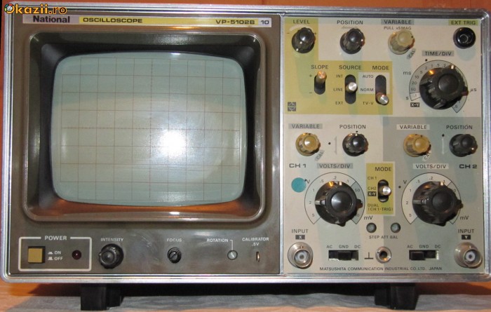

Picture is attached. The volts/div knob looks like it maxes out at 5v/div so with an x10 probe that would be 50v/div, and with 8 divisions on the vertical this translates to 400 vpp max, but i'll be making my own probes anyway, so no problem making a x20 or or x50 probe if need be. By far more interesting are the numbers on the right side - which although obscured by the angle, logic says they're 50, 20 and 10mV. With a x10 probe that's a minimum of 100mV/div - the scope i used to have had a 5mV/div setting and that was just barely enough for viewing SMPS output ripple with a x10 probe, so this is going to be some trouble. Although, whipping up an amplifier to increase vertical sensitivity shouldn't be too hard.

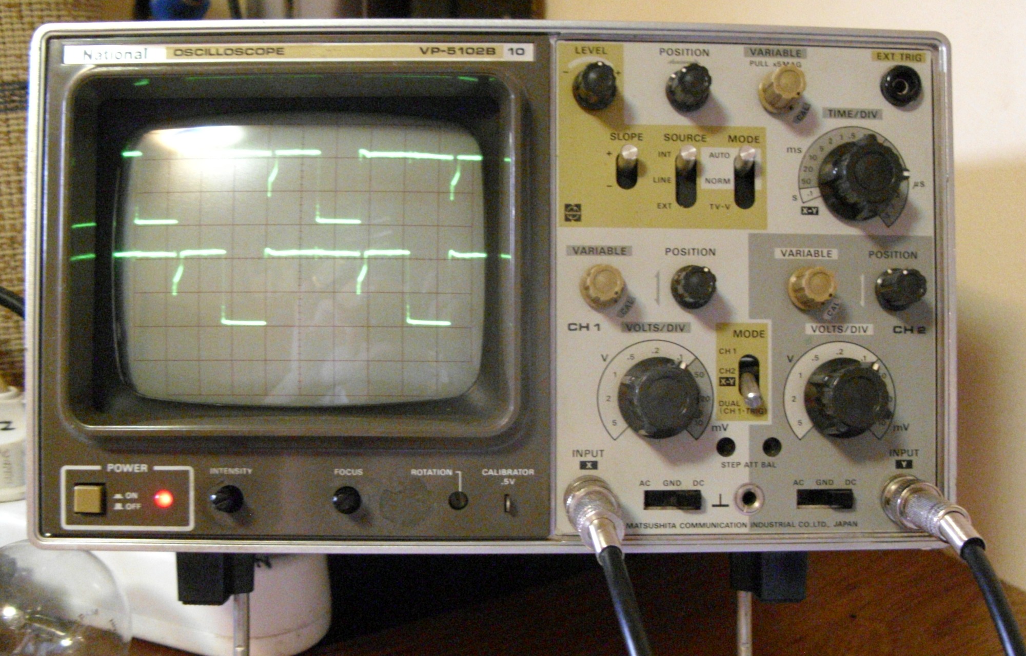

There's a coil around the tube that i have no idea what it does, as IIRC oscilloscopes used electrostatic deflection. Maybe degaussing or magnetic field compensation? It has a resistance of about 570 ohms and has 0.783v DC on it when the scope is on. No AC signal could be detected on it.
