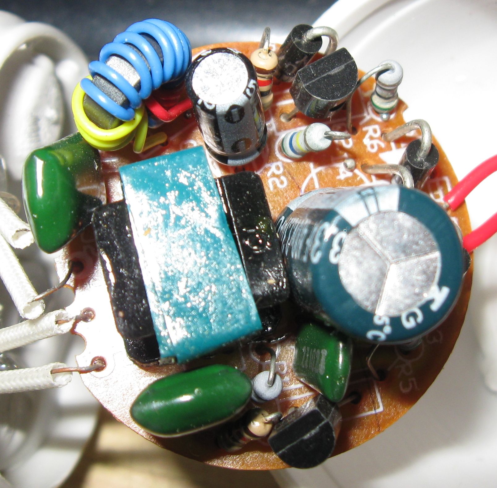

      Can't measure a CFL lightbulb from outside.
      There's electronic circuits inside it that generate an impulse of around 700v to start the whole process... so basically the two "terminals" you have access to from outside (the metal screw and the metal tip of the bulb) end up connected to some electronic parts and then other things inside may be broken or not.
      The regular light bulb is basically a wire under inert gases ... when electricity passes through it it heats up until it becomes incandescent. If the wire is continuous the bulb is good, so set the meter on continuity and touch the terminals of the bulb.
      From the picture I see on google, you have to set the meter on resistance (ohm) and then press a button to switch between modes (resitance, diode, continuity). When set on continuity the meter should beep if it has a beeper.
      This is what's inside a CFL lamp, the red wires go to the outside terminals, all the way on the other side the tubes are connected to the small board:
      The large green capacitors are often the reason why the lamps stop lightning up - no way to test those from outside the lamp.
