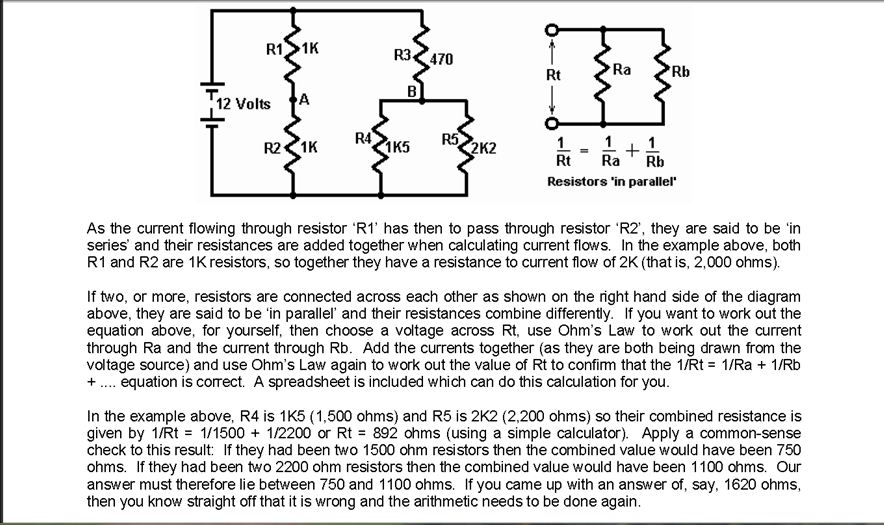

            Is there any time when the reading will be (reasonably) accurate?
            (e.g. like when measuring across a resistor in a circuit should never show o/c no matter what it's in paralell with) - the reading cant determine if the (resistor in this case) is good, but can certainly tell if it's bad i.e. open circuit
              No you can't because you still have the parallel path.

                the post above mine is correct.
                If you have two resisters in parallel the total resistance will be lower than the smallest resistance of the two. Please see my attachment that explains it better.
                Merry christmas to you all
                  - True
                  But
                  If you have two different sized resisters in parallel, and the larger one is open, then in circuit tests won't tell tell you squat because of tolerances. (Both the meter and parts.)
                  An in circuit check of parallel resistance should never be considered reliable or accurate.

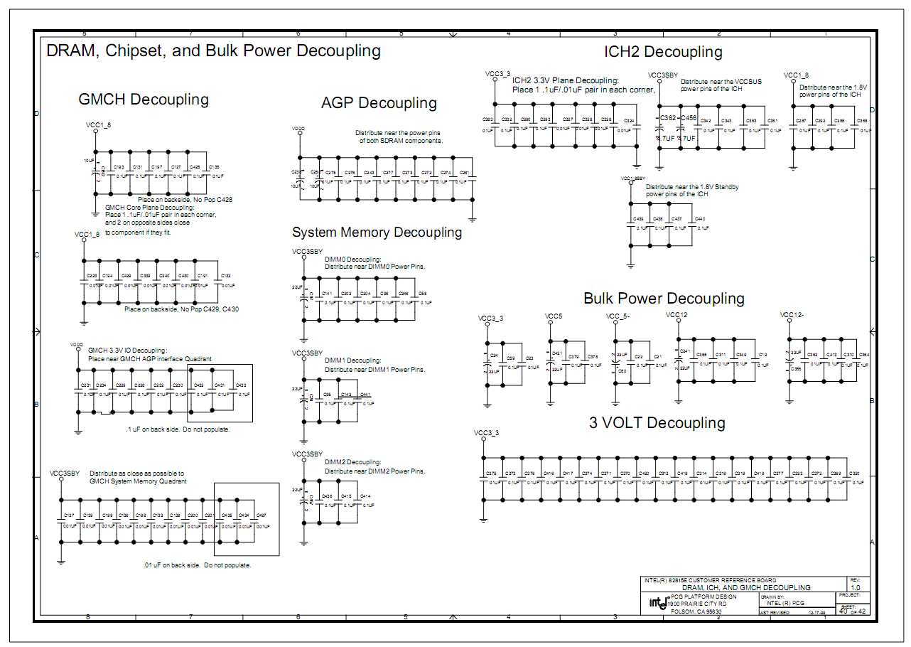

                            If you don't believe me then go find a mobo schematic in old Intel docs. They used to provide an example mobo schematic in -some- reference design guides. [Mostly for server boards.] They quit doing it sometime during the run of socket 478.
                            On mobos most caps over 6mm are in parallel with others or across IC's that for all you know are bad and shorted.
                            You can poke solder balls all you want, but if you don't actually trace the circuit too then you aren't doing anything productive.

                            • PCBONEZ
                              Grumpy Old Fart
                              • Aug 2005
                              • 10661
                              Re: Measuring ESR in circuit
                              Going to visual mode....
                              Here is what is going on SMD wise on a mobo.
                              All those SMD caps are in parallel with the lytics you think are the only caps there.
                              Some shown are also those small 22uF-10uF lytics but the majority are SMD.
                              EVERY voltage on a mobo has SMD caps in parallel with the lytics to take care of EMI.
                              Still think you can check ESR in-circuit on a mobo?
