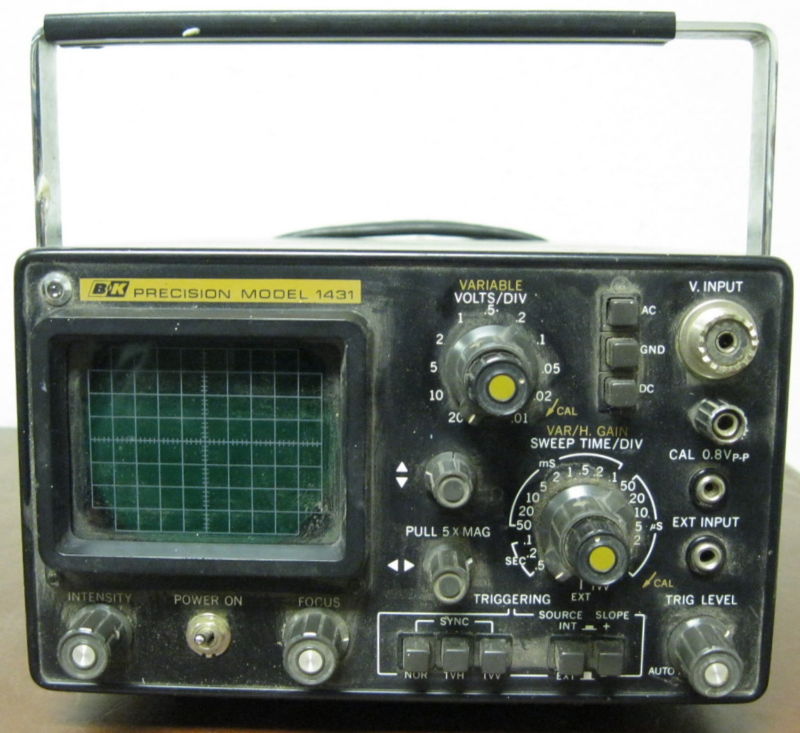

need some help fixing an old oscilloscope
oscilloscope repair HELP

Re: oscilloscope repair HELP
Welcome, mitchell2120!
What make and model is it?
Also, what is the problem you experiencing with it?My first choice in quality Japanese electrolytics is Nippon Chemi-Con, which has been in business since 1931... the quality of electronics is dependent on the quality of the electrolytics. -
bk precision model 1431 solid state-triggered sweep
powers on no traceComment
Check the simple stuff first is the main fuse blown?
Are the heaters at the rear of the tube glowing a faint orange? Do you have high voltage at the anode?Last edited by Krankshaft; 03-05-2011, 11:52 AM.Elements of the past and the future combining to make something not quite as good as either.Comment
M,
It may not be broken.
Look for the trace trigger and sweep controls.
Set them for a slow trace such as .1 second / CM
Set the 'trigger' pots to center
Set the sweep controls for auto or free run
Now turn the display brightness up to full.
Can you see a bright spot either high or low moving across the screen?
Set the vert position so that the trace is centered.
If the above 'fixes it' be sure to turn the brightness down.
Report back.
Jack Crow"You are, what you do, when it counts"
The Masso
"Gravity, the quickest way down"
Mayor John Almafi
"You ever drop an egg, and on the floor you see it break?
You go and get a mop so you can clean up your mistake.
But did you ever stop to ponder why we know it's true?
If you drop a broken egg you will not get an egg that's new?"
MC HawkingComment
heaters at the rear of the tube glowing a faint orange, high voltage at the anode no sure dont see it . i know this model does no have a wire to the front of the crt .Comment
