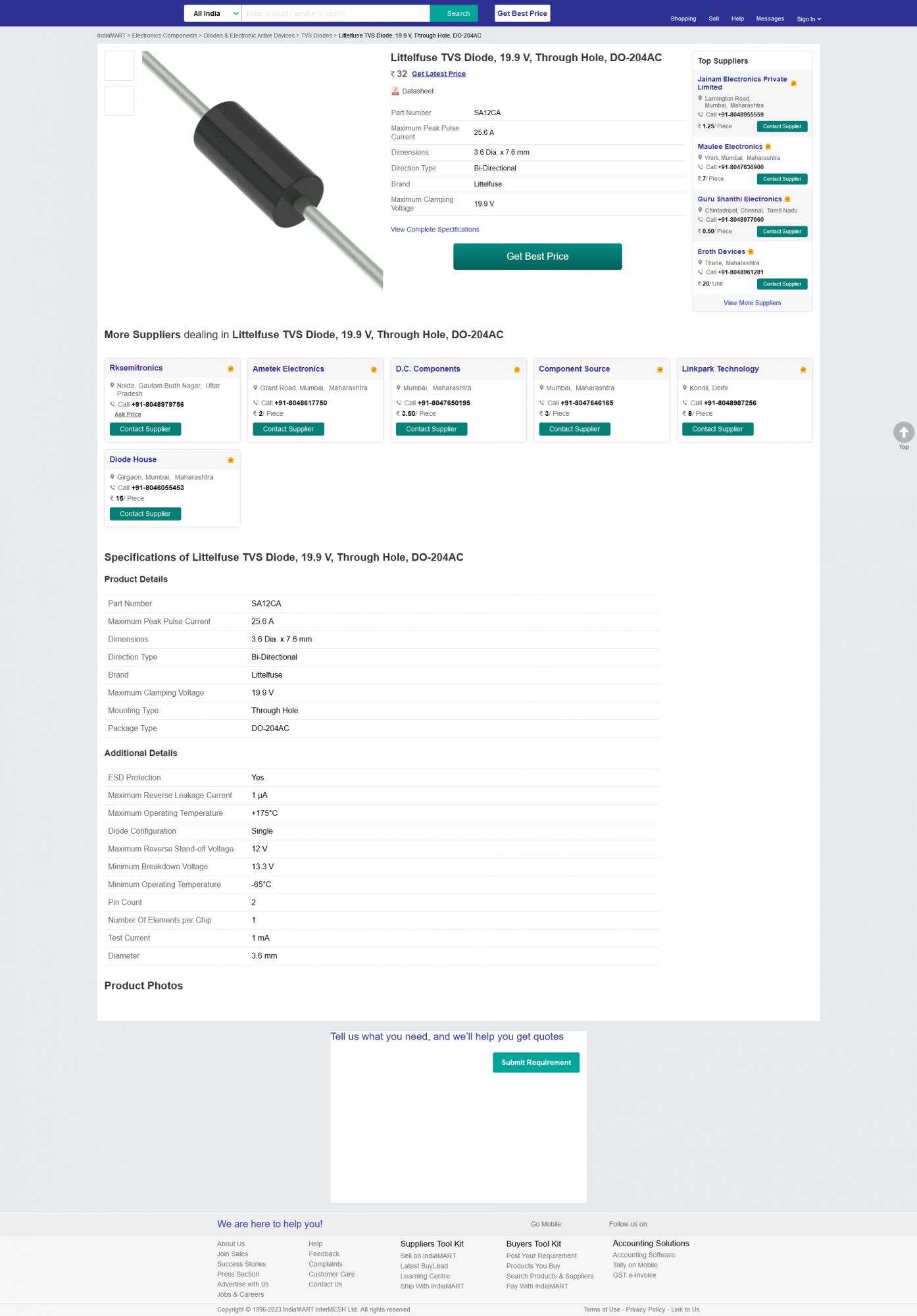

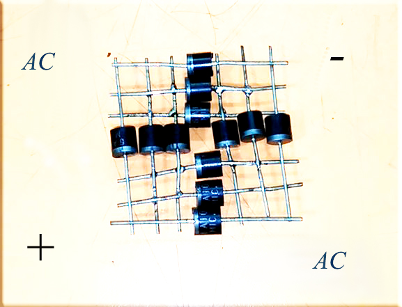

Re: Benchtop Power Supply Question
the chinese breakers are probably "B" grade.
there are 3 or 4 speed-grades - B is often used like you say for motors and other high-inrush stuff.
you need "B" for a lot of the battery-tab spot welders!
btw, a fuse or breaker should stay intact at 100% current indefinatly.
Benchtop Power Supply Question
Re: Benchtop Power Supply Question
I have an LED energy meter DIN panel mount like https://www.aliexpress.com/item/10000138101252.html
But I don't like it because it has such slow averaging, it takes 3-4 seconds to ramp up to its power reading. I guess that's OK for fluctuating loads. Otherwise it works really well.
Ali DIN-rail circuit breakers looked a bit hokey - they seem to need 3X rated to trip fast, never mind they have no safety approvals. They seem suited to motors etc. I would want a fast trip on a workbench, so I think a glass fuse is best.
edit: In North America we don't use DIN-rail for the service/consumer unit panel, and those breakers look really slow.
Others I look at and have used:
Tyco W58 series (thermal) but 0.5-3.4 sec fastest response at 1,000% rated current.
Tyco W28 series (thermal) but 0.12-0.3 sec fastest response at 1,000% rated current.Last edited by redwire; 01-23-2023, 03:33 PM.Leave a comment:
Re: Benchtop Power Supply Question
i have this:
https://www.aliexpress.com/item/1005002687372957.html
the oldskool LED version.
although the lcd one is a tempting upgrade
Leave a comment:
Re: Benchtop Power Supply Question
it doesnt,
an iso transformer can kill you as easy as mains
they are to isolate the device from ground for your scope.Leave a comment:
Re: Benchtop Power Supply Question
I really should look into getting one of those cc current/voltmeters, been using my P3 Kill-A-Watt for that purpose but I only have one of them and would like to keep it for measuring real watts (versus VA which is more interesting for debug in general)...
Alas I just use an isolation transformer, though I should just use an RCD/GFCI near my work area. Alas as of now, I think every time I had a GFCI trip, it was a nuisance trip
As for the isolation transformer, I get no indication when it saves my life...Leave a comment:
Re: Benchtop Power Supply Question
i have a din rail box containing an rcd, a breaker and a chinese volt/current meter with a socket on the outside
Leave a comment:
Re: Benchtop Power Supply Question
The GFCI basic circuit allows you to change sensitivity but the hassle is that latching relay in one. I could not find one to buy separately.
Also, the CT's are really good 1000 turn can be used for measuring low AC currents.
I just took a Leviton GFCI stuffed it in a metal box with line cord and that is an inline GFCI I added to the workbench. I have no DIN-rail stuff.
It's a good reminder I need to add a fuse to it as well. I don't need 15A surprises and even a 5A fuse is good for whatever I am repairing.
I might look at an arc fault circuit interrupter (AFCI) but so far these are all only available as breakers, not outlets.Attached FilesLeave a comment:
Re: Benchtop Power Supply Question
What redwire was implying is you can modify them to be more sensitive.
Not a good idea to be tinkering with such devices and possibly introducing errors.
I would not recommend to build one yourself, they are cheap enough brand new and are designed to save your life if you fuck up too badly.Leave a comment:
Re: Benchtop Power Supply Question
Good points ; Electricity and Electronics aren't something to take lightly , and I always wondered if someone put some reminders each thread or so . Beginners and hobyists must always be aware of safety and security measures . If we add a case of spilled water or naked feet , it could be a recipe of disasters .an RCD, good but not foolproof.
it works by balancing an arm between 2 coils - if one side has more current than the other then the arm moves and it trips.
i think the newer ones overcomplicate things using a 3rd coil and an opamp to trip a solenoid
if you connect a transformer to the line the RCD cant see what happens on the secondary side.
in short - you can kill yourself if you get careless with an isolation transformer!
Even a variac or an isolated transformer won't protect you from a big capacitor's lethal discharge . Even a 19 volts secondary circuitry can hold a potential danger .
That's said , I had this idea since the table is in the room's center and future probable cables will pass on ground , so the RCCB is placed now in the lead casing of the room's circuitry .Leave a comment:
Re: Benchtop Power Supply Question
Big Clive has reverse engineered a couple on his YT channelLeave a comment:
Re: Benchtop Power Supply Question
I added a GFCI outlet to my workbench power and it's tripped once, paid for itself.
I wasn't using an isolation transformer (what is everyone rich?) and had line/neutral flipped on the alligator clips doing some live stuff. A small spark and that's all.
In North America these are electronic, use a CT and trip at >4-6mA imbalance and activate the latching relay. Not the hairdryer crap mechanical ones.
You can also find GFCI's in the trash, take them apart and modify. Although they frequently are blown inside, you could make a custom one.
Modern complicated circuit TI AFE3010 but I like the old orginal LM1851 DIP-8.
Old GFCI's get hit with mains transients, MOV's fade out.
I had one GFCI trip but the relay jammed and power stayed on and the coil+SCR burned up badly. It latches power to the coil which is fine for a short time to trip.Last edited by redwire; 01-21-2023, 12:10 PM.Leave a comment:
Re: Benchtop Power Supply Question
an RCD, good but not foolproof.
it works by balancing an arm between 2 coils - if one side has more current than the other then the arm moves and it trips.
i think the newer ones overcomplicate things using a 3rd coil and an opamp to trip a solenoid
if you connect a transformer to the line the RCD cant see what happens on the secondary side.
in short - you can kill yourself if you get careless with an isolation transformer!
Last edited by stj; 01-21-2023, 07:41 AM.Leave a comment:
Re: Benchtop Power Supply Question
That's the anti-electro i talked about previously :
RESIDUAL CURRENT CIRCUIT BREAKER (RCCB)
Device installed in the distribution board upstream of the electrical circuits, this detects current leaks due to insulation faults and prevents any risk of electrocution by immediately cutting the power to the circuit concerned. A switch handle is used to reset it after the fault has been eliminated.Leave a comment:
Re: Benchtop Power Supply Question
So far , I've finished the over-voltage timer , and looking to start designing the main board .
Till now I've decided on one winding DC part (low AC) with one tapped center , despite that two windings are better for noise and easier repair . Anyway , I won't wind it until I finished designing the whole circuit , including protection ones . It's the preferred method anyway to work it in reverse , since it will be decisive in core's calculation .
Right now , I'm studying the different options of diodes or rectifiers ..Attached some of the primary ideas , but nothing decisive yet ..Leave a comment:
Re: Benchtop Power Supply Question
InterestingThose are never used parts from new not used devices , most of them given as bonuses on quantities sales or left overs defaults , or stocks . Those are surely the 0,001% of my arsenal , the ones that I didn't have time to arrange in their accordingly drawers and left on purpose at home for quick repairs .
If you were a projects designer , you would know that those are for repairs mainly , and more important , a precaution measure against an obsolete part . When I want to do a project , I prefer ordering a complete kit , like this one attached , mainly for time saving more than money saving . This kit was delivered 2 days ago .
Leave a comment:
Re: Benchtop Power Supply Question
Those are never used parts from new not used devices , most of them given as bonuses on quantities sales or left overs defaults , or stocks . Those are surely the 0,001% of my arsenal , the ones that I didn't have time to arrange in their accordingly drawers and left on purpose at home for quick repairs .
If you were a projects designer , you would know that those are for repairs mainly , and more important , a precaution measure against an obsolete part . When I want to do a project , I prefer ordering a complete kit , like this one attached , mainly for time saving more than money saving . This kit was delivered 2 days ago .Leave a comment:
Re: Benchtop Power Supply Question
I'm always pleased to learn way more than the simple answer to a question. These comments are great.Leave a comment:
by sam_sam_samI have wanting to do this project for quite sometime now and I finally found a switching power supply that will work on this desoldering gun station ZD-915 that the original switching power supply took a shit and just was not worth trying to fix it because this switching power is not quite big enough to handle the heater element and the vacuum pump
One note when I tested the switching power supply and the voltage control board I noticed that this desoldering gun heat up much faster than the original switching power supply which I was really surprised by to the point that I might buy... -
by sam_sam_samI have been working on this concept for quite some time now with limited success but recently I found a switching power supply that is setup for the voltage that this soldering station needs to operate at however it also needs part of the secondary circuit from the original switching power because you need several voltage rails
I once tried to get a ZD-915 desoldering station to work on a 18 volt battery power supply but unfortunately things did not go well but I did find a work around but I might try this idea again but going at a little differently more about this another time... -
by JimBanvilleThe sub developed a constant popping every couple seconds from woofer and power LED flickering with nothing but wall AC connected. Connecting an audio cable didn't change anything. It doesn't play but a second or two of audio in between the pops.
I measured the power supply output going to the amp board and it too has this pulsing. Voltage cycles...-
Channel: Troubleshooting Audio Equipment
Vizio e601i-A3 - Has Sound and Display, But No Backlight - Bad Power Supply Board or Bad LED Bulbs ?by Tynan DillI was given this TV from my great uncle. He said it just wouldn't turn on one day out of nowhere, replaced the TV, and gave it to me to possibly fix and use for myself.
Assuming...7 Photos -
by GjacksonHi all, I managed to narrow down which PCB was causing my Haier AC to throw out an E7 error code (E7 indicates that the indoor unit and outdoor unit cannot communicate). I found that the outdoor unit power board which gives 5v and 15v to the outdoor unit module board fails to fully power up.. The power Led starts to fade in incredibly slowly and the 5v and 15v power buses jump around like crazy and never reach their required voltage. I unplugged the module board from the power board and the power board powered up fine! It had a steady 5v and 15v out and the power LED came on instantly and Bright....
- Loading...
- No more items.
Leave a comment:
