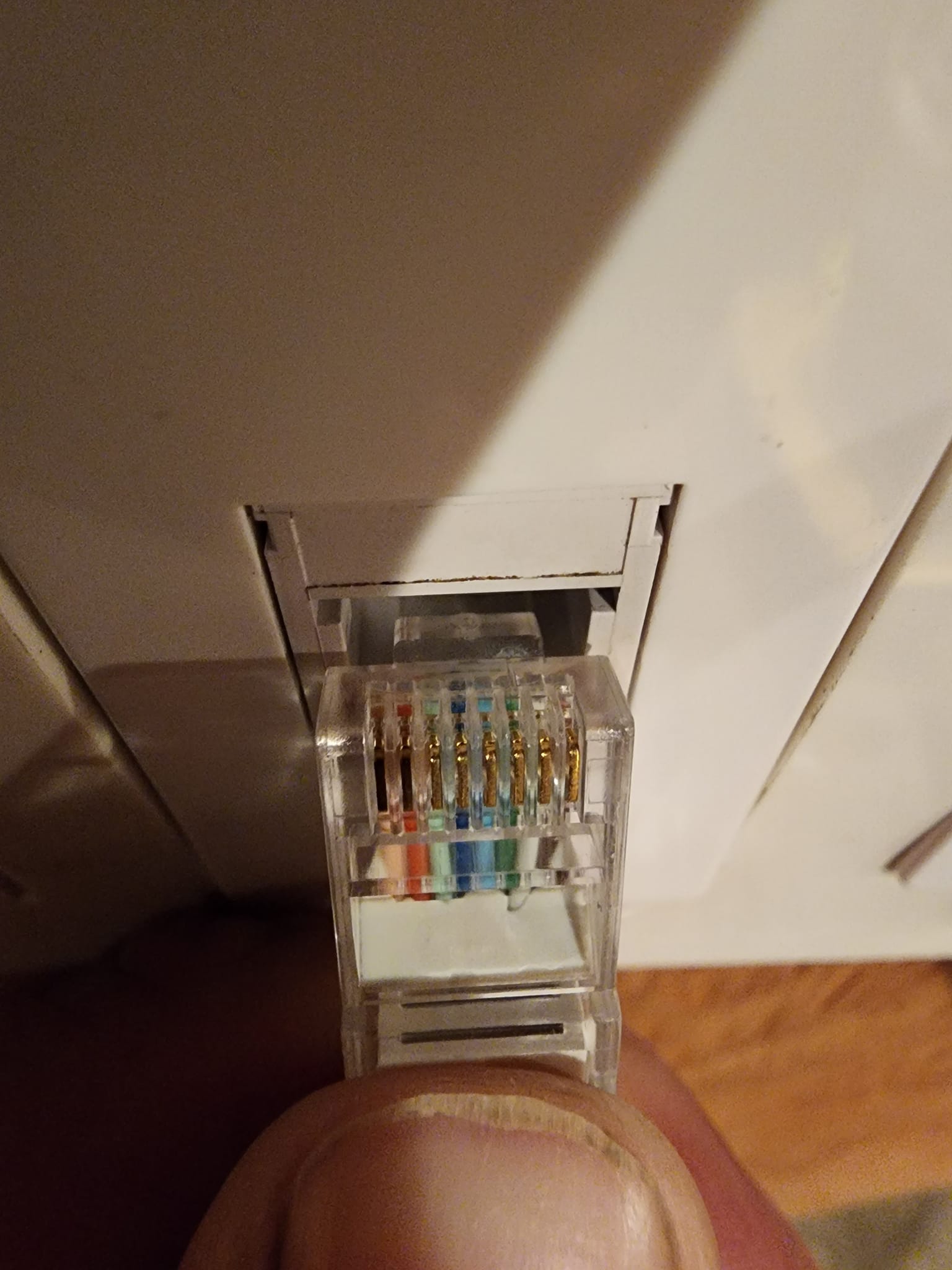

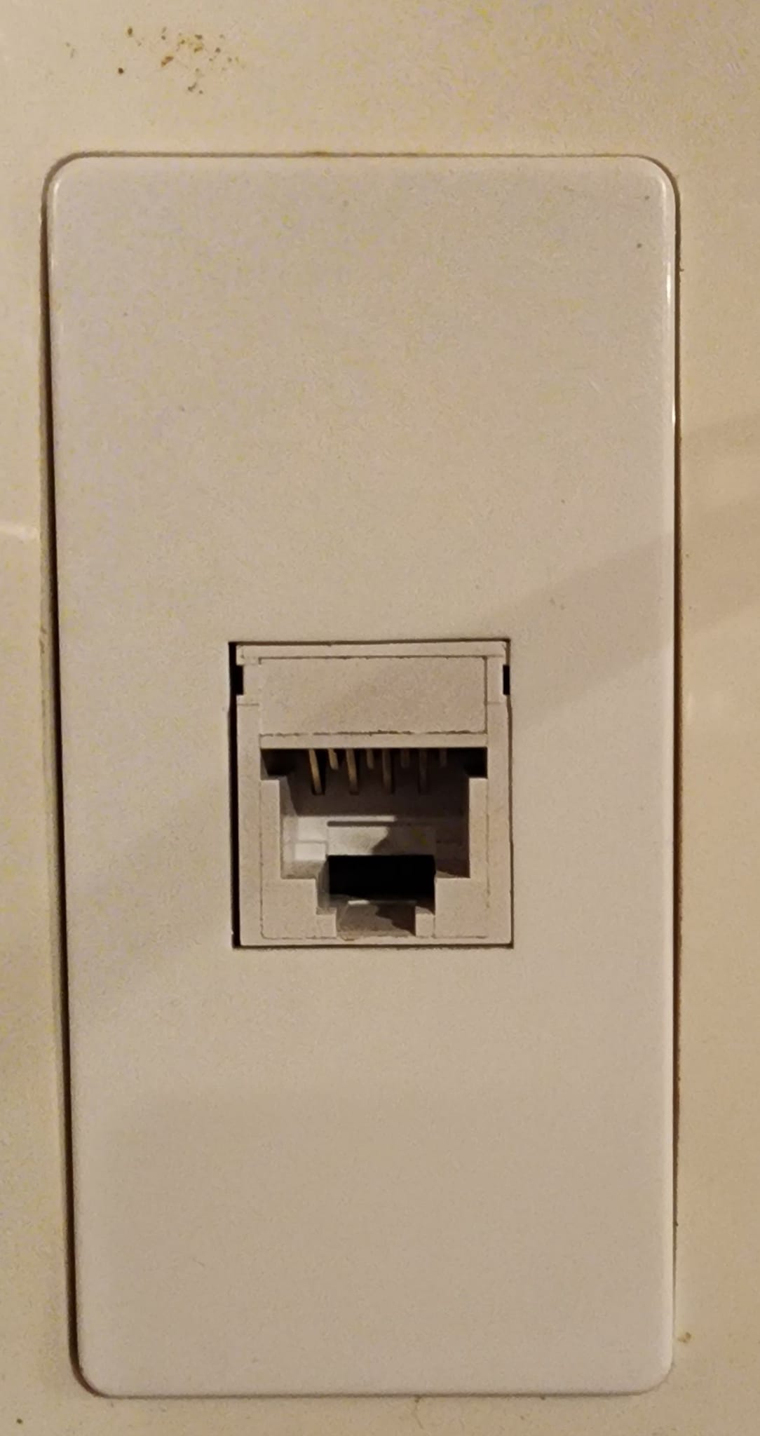

What connector is this?
  • Uranium-235
    Comrade Glimmer
    • Aug 2007
    • 5042
    • US
    From facebook group. It's 8p8c but just a bit narrower

    Re: What connector is this?
    is it ethernet ?
      • 31142
      no, it's a variant of a u.s. phone plug
      • Uranium-235
        Comrade Glimmer
        • Aug 2007
        • 5042
        • US
        It's starting to lead me into AT&T Merlin, but I can't tell the width
          • 31142
          why do you have a small telephone switchboard??
          not seen one of those for decades!!
          • Uranium-235
            Comrade Glimmer
            • Aug 2007
            • 5042
            • US
            Someone on a telephony forum figured it out pretty quickly, RJ31X
            • Uranium-235
              Comrade Glimmer
              • Aug 2007
              • 5042
              • US
              Actually he now takes it back lol
              • Uranium-235
                Comrade Glimmer
                • Aug 2007
                • 5042
                • US
                they can't really figure it out either
                https://sundance-communications.com/...598#Post643598
                • fuuton
                  • Jan 2023
                  • Italia
                  ethernet?
                  • Uranium-235
                    Comrade Glimmer
                    • Aug 2007
                    • 5042
                    • US
                    Originally posted by fuuton
                    ethernet?
                    look at the second picture, it's actually thinner than ethernet
