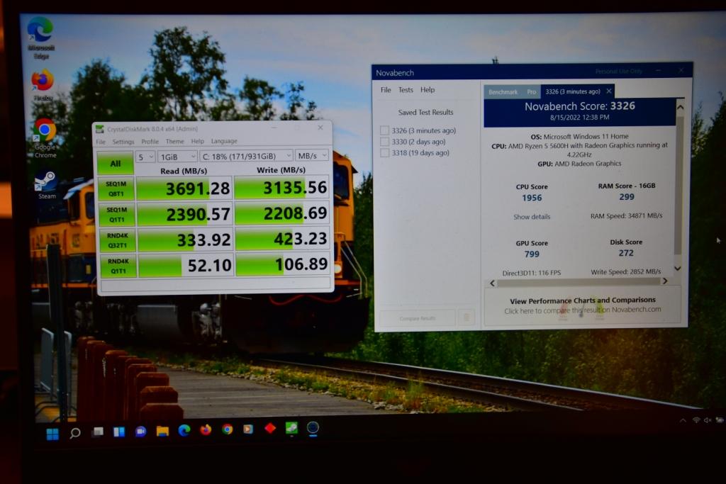

      My new HP Victus 15-fb0121nr (if you live near a Micro Center they have these for $550 right now, one hell of a deal, though note it comes from the factory with a single stick of 8GB RAM so I'd recommend spending a few bucks more to add a second stick to bump it up to 16GB and more importantly enable dual-channel):
      Specs:
      -CPU: AMD Ryzen 5 5600H
      -GPU: Nvidia GeForce GTX1650
      -SSD: 512GB NVMe (since upgraded to a Crucial P5 plus 1TB for capacity, which is theoretically faster than the HP supplied Hynix drive, but write performance is about the same, so the interface seems to be the limiting factor here)
      -RAM: 16GB (upgraded from the 8GB it came with) DDR4 3200MHz
      -Display 15.6" 1920X1080 144hz refresh
      -OS: Windows 11 Home

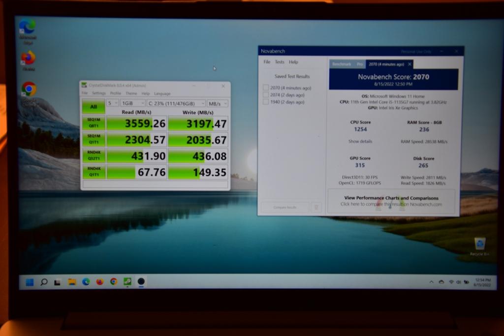

      The Lenovo Ideapad3 I recently setup for my dad:
      Specs:
      -CPU: Intel I5-1137G7
      -GPU: Intel Iris Xe integrated
      -SSD: 512GB NVMe (The old Hynix drive from the HP Victus, replaced a slower Samsung P991 256GB that came with the laptop)
      -RAM: 8GB DDR4 3200MHz (4GB soldered on the motherboard + a 4GB stick)

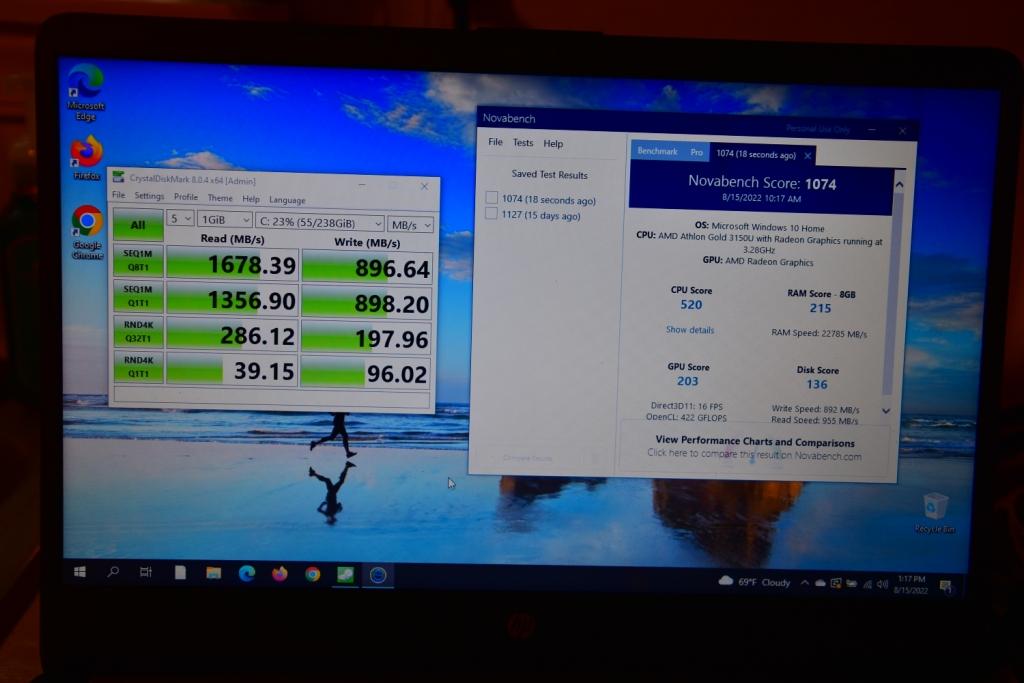

      My HP 14-fq0090tg cheap travel Laptop (this is below what I'd recommend for 3D/CAD work ,but just to show what even new
      "low-end" laptops can do):
      Specs:
      CPU:AMD Athlon Gold 3150U
      GPU: Integrated Radeon
      SDD: 256 GB M2 NVMe (upgraded from the included 128GB dog-slow M2 SATA drive) Silicon Power P34A60
      RAM: 8GB DDR4 3200 (upgraded from the included 4GB)
      Display: 14" 1366x768
      OS: Windows 10 Home

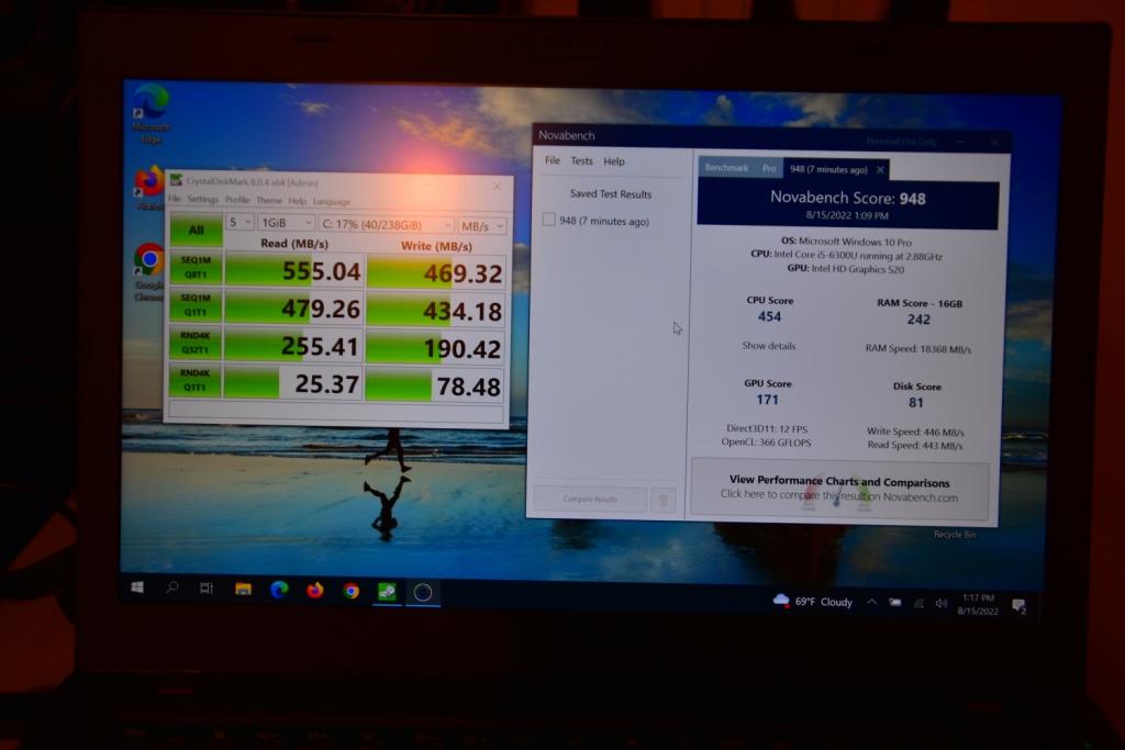

      Lenovo ThinkPad T460 (circa 2017):
      Specs:
      -CPU: Intel I5-6300U
      -GPU: Integrated Intel HD Graphics 520
      -SSD: 256GB SATA Intel SSDSC2KF256H6L
      -RAM: 16GB DDR3 1600
      -Display:14" 1920x1080
      -OS: Windows 10 Pro

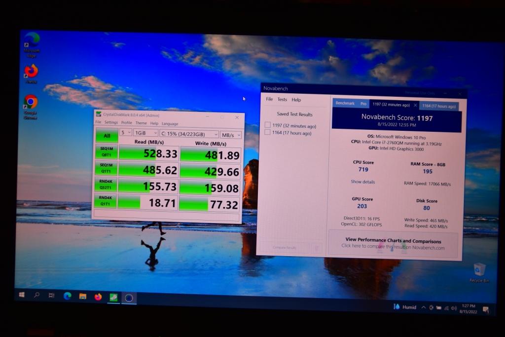

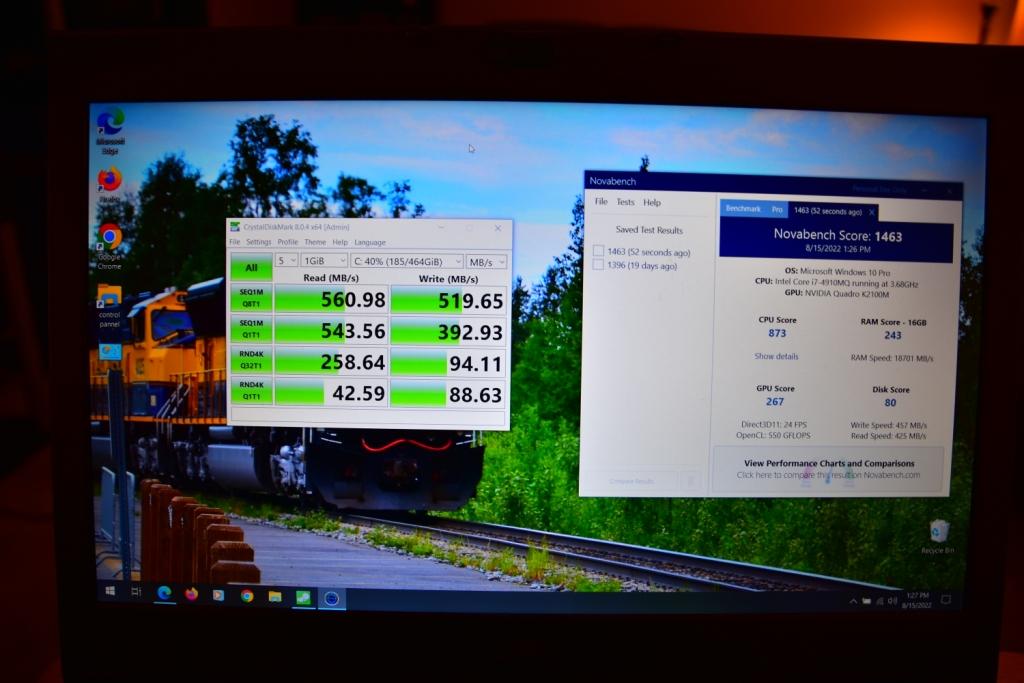

      Dell Precision M4800 (circa 2015):
      Specs:
      -CPU: Intel i7-4910MQ
      -GPU: Nvidia Quadro K2100M
      -SSD: 500 GB SATA SSD Samsung 970 EVO
      -Display: 15.6" 1920x1080
      -OS: Windows 10 Pro
      Lenovo ThinkPad W520 (circa 2012):
      Specs:
      -CPU: Intel I7-2760QM
      -GPU: Nvidia Quadro M2000
      -SSD: 240GB SATA SSD Teamquest T-Force Vulcan Z
      -RAM: 8GB DDR3 1600
      -Display:15.6" 1920x1080
      -OS: Windows 10 Pro

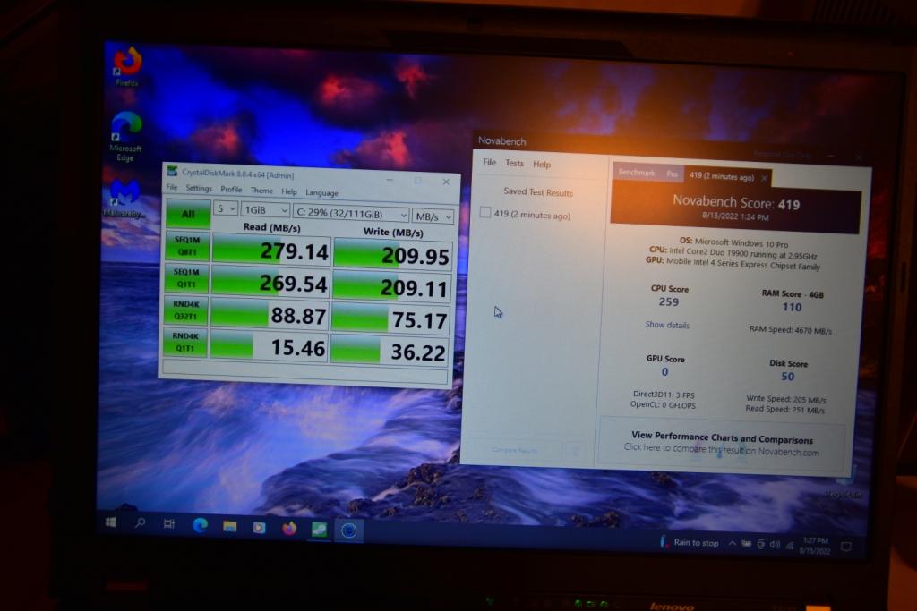

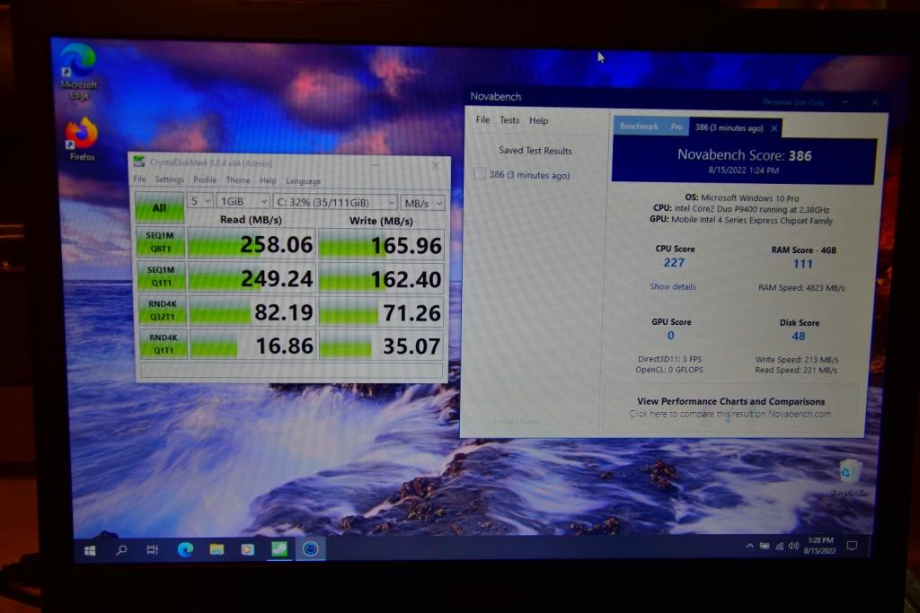

      Dell Latitude E4300 (circa 2009):
      Specs:
      -CPU: Intel Core2Duo P9400
      -SSD: 120GB SATA SSD Kingston A400 (slow SSD but since this Laptop is only SATA 3 it will still be limited by the interface rather than the drive)
      -RAM: 4GB DDR3
      -Display:13" 1280x800
      -OS: Windows 10 Pro

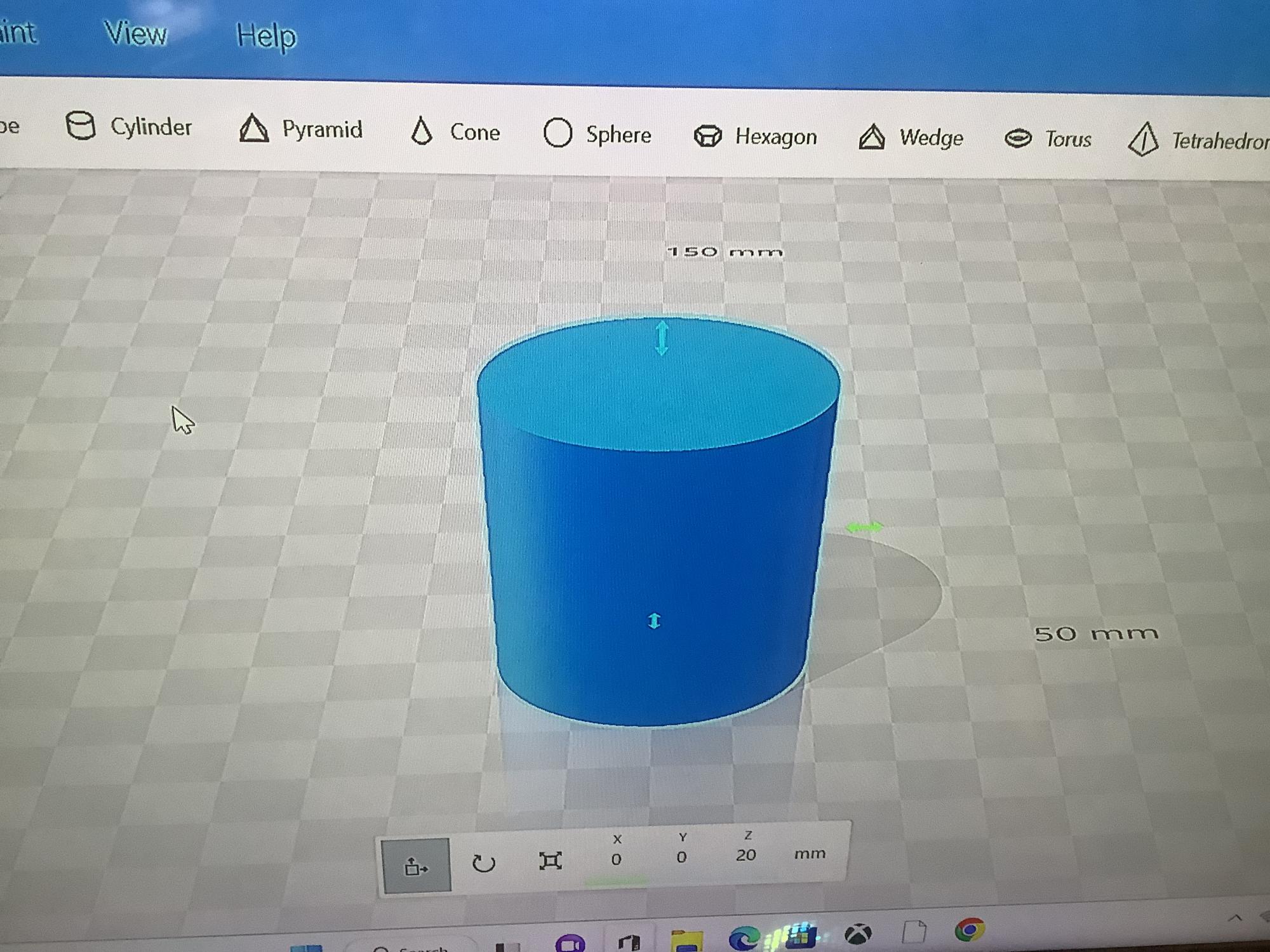

                        I installed Windows 3D Builder which I have used before and just doing the basic objects and moving them around what a breeze doing this on this computer now I just have to find my USB disk drive that I have some project on and relearn how to use this program again
                        I also watched a couple of music videos on YouTube and what a different experience that was ( video quality and not waiting for the buffering was not even an issue at all )
                        I will have to get use to using Windows 11 it is a little bit different than Windows 10 but not by much

                          I watched a video on YouTube about the new features Windows 3D builder and was playing around with a little bit more today I have get use to this program again I just realized that I had a lot of trouble with the laptop that had this software on and I had reformatted the hard drive because of it not wanting to boot correctly and completely most of the time so I lost all of the files that I had made it was just a few of them
                          I need to redo most of them anyway because of errors that I was going to fix
                          Plus the items that I had for the battery holders that I was making the custom cup ends needed to be a slight bit bigger in diameter anyway and the top half removed so the battery would go in and out of the holder easier
