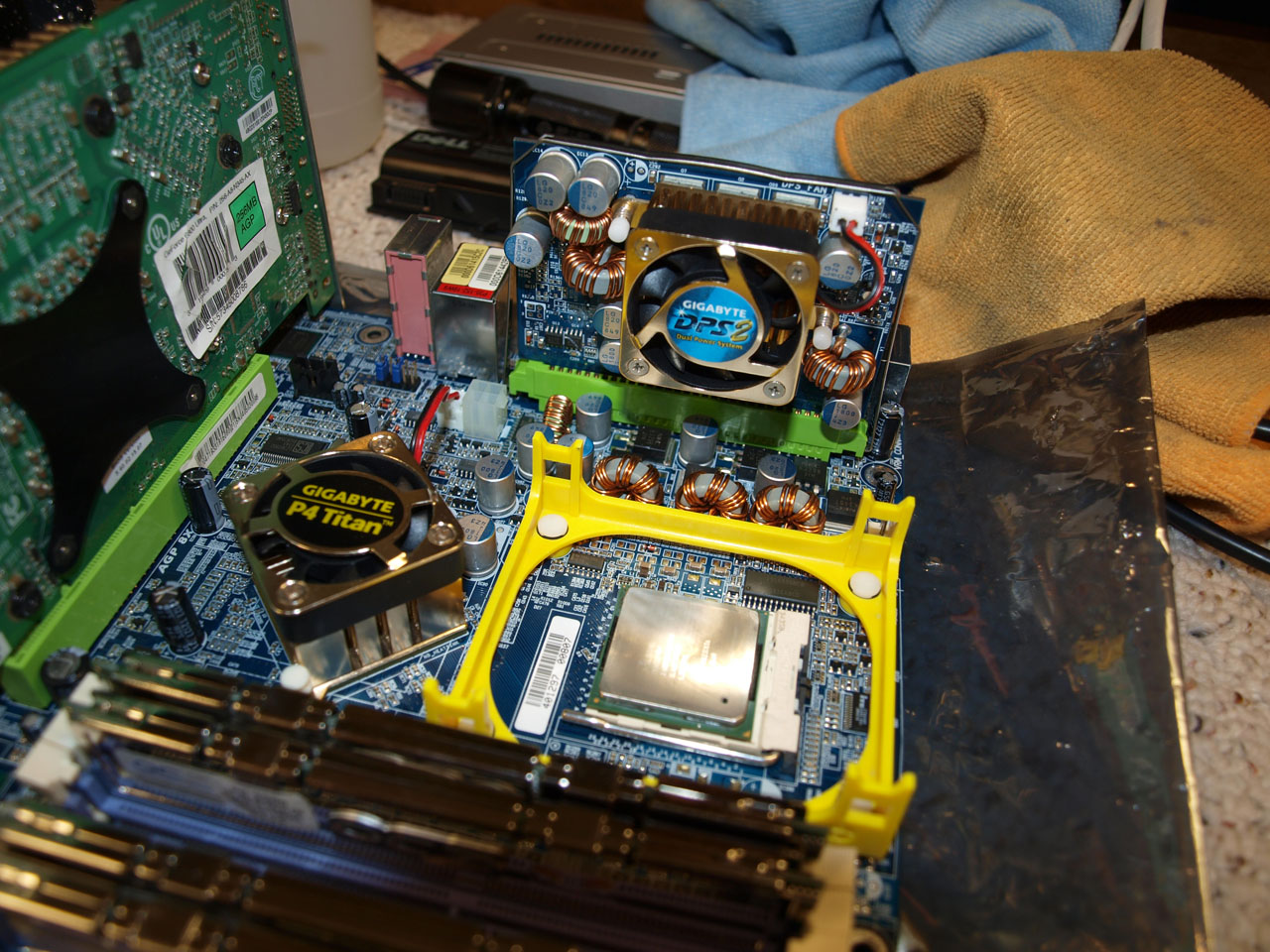

On top of the modular VRM, there's also an onboard as well. It will run without the added VRM.... The VRM is supposed to add increased stability with the higher TDP P4's or with overclocking....or so I read....but yea, interesting feature...and the board was 100% complete, all accessories present. It also had a add-on card to allow one of the SATA ports to function as an eSATA.

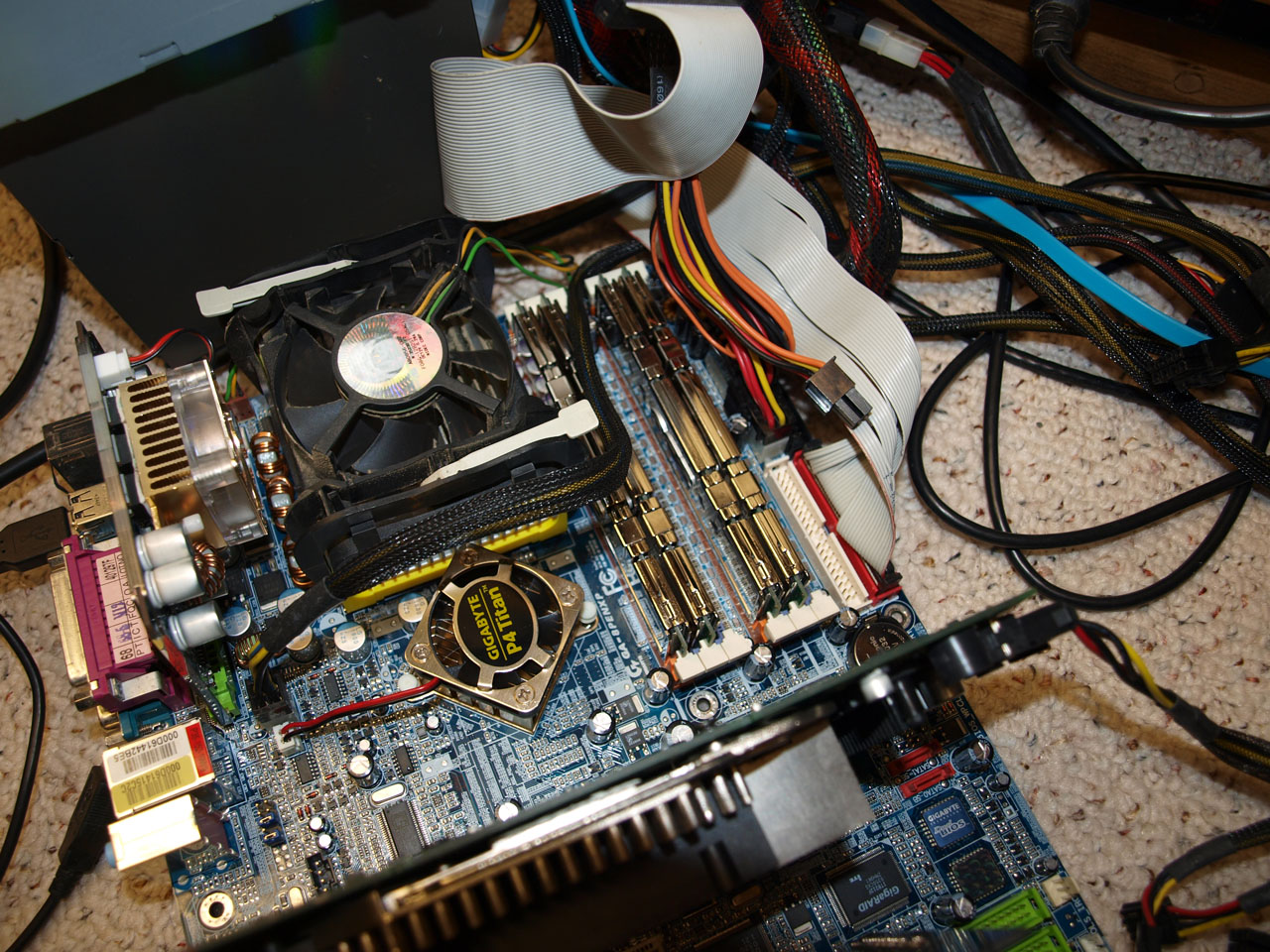

Indeed...the sink is less than impressive for the GPU chip itself, but the RAM chips are very well cooled...I picked up on that as well. I am not going to uograde it like the one in the other thread apparently was....this thing won't be ran much, honestly....I'd prefer to keep it original. I did a quick ebay search for that Zalman cooler....just for grins. None to be found.Actually, the thermal paste isn't/wasn't trash at all on these GPUs.
The main problem is the heatsink size - it's way way WAY too small for the 80 Watts of heat that this GPU chip outputs. Come to think of it, that's more or less how much that 2.6 GHz Northwood outputs when maxxed out. Try putting the heatsink from this GPU onto the CPU and see how hot it runs. It will hit 70+ Celsius easily and settle around the lower range of 80 Celsius... which is a shame, because the heatsink on this 6800 Ultra has a very unique look/picture. But nVidia just couldn't be bothered to do better. Funny, though, they did make the VRAM's heatsink almost as big as the GPU's, and the VRAM isn't the one that's dissipating that much heat.
If you have a spare Zalman VF-1000 heatsink or similar, that should do the trick here for this card... even if it does ruin the card's cool original look a little bit. Worth it, though - it's a 6800 Ultra.

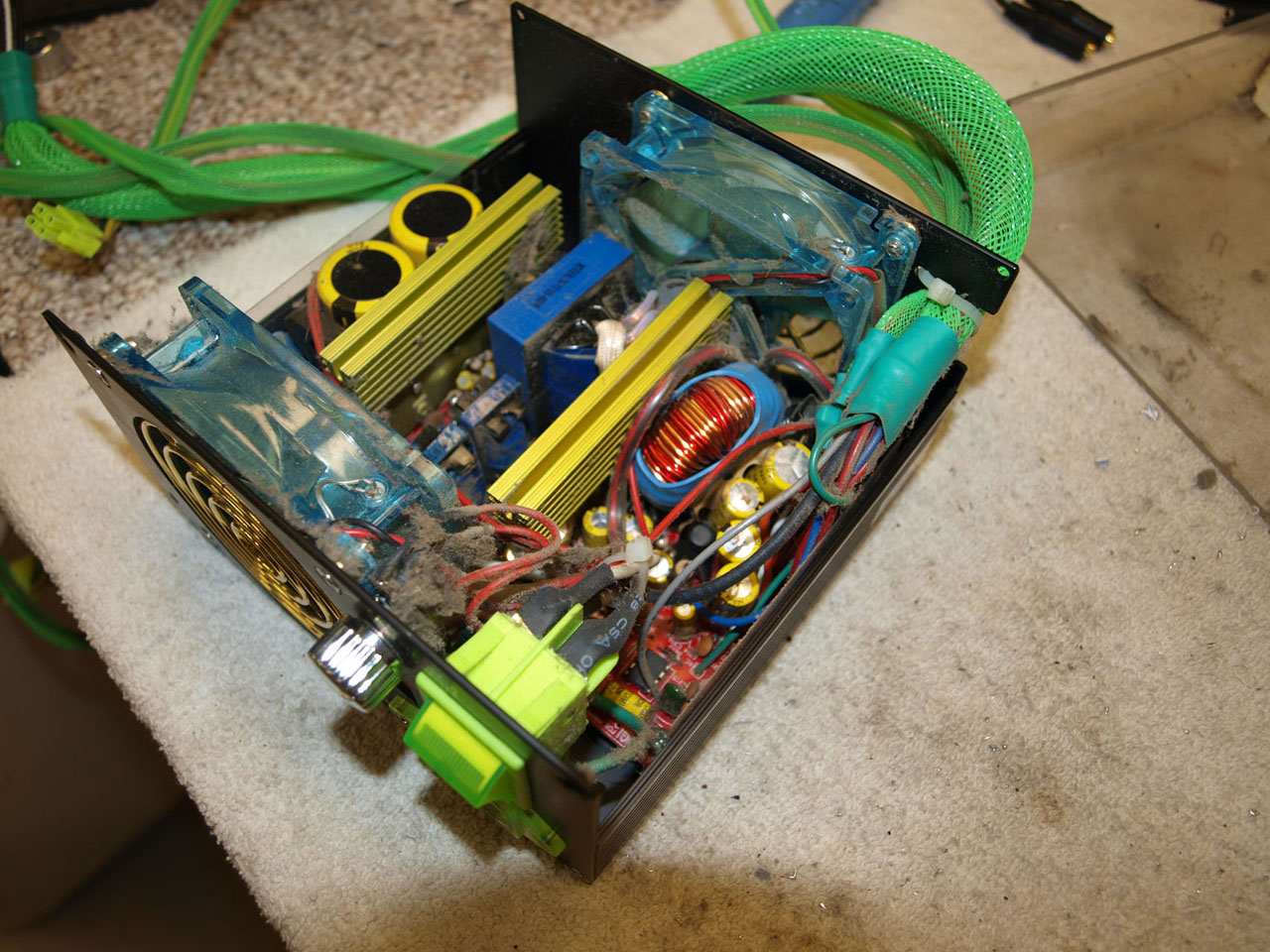

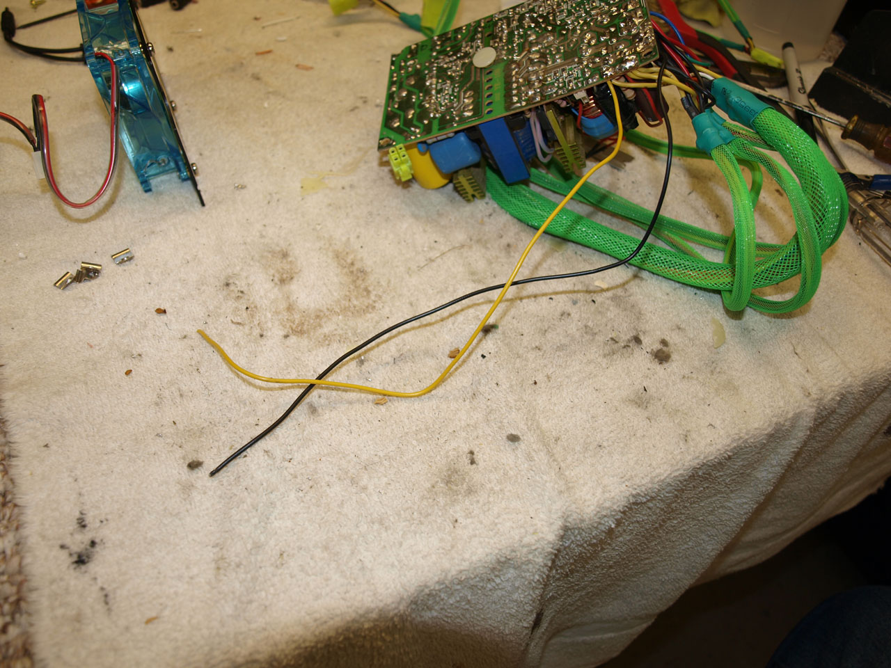

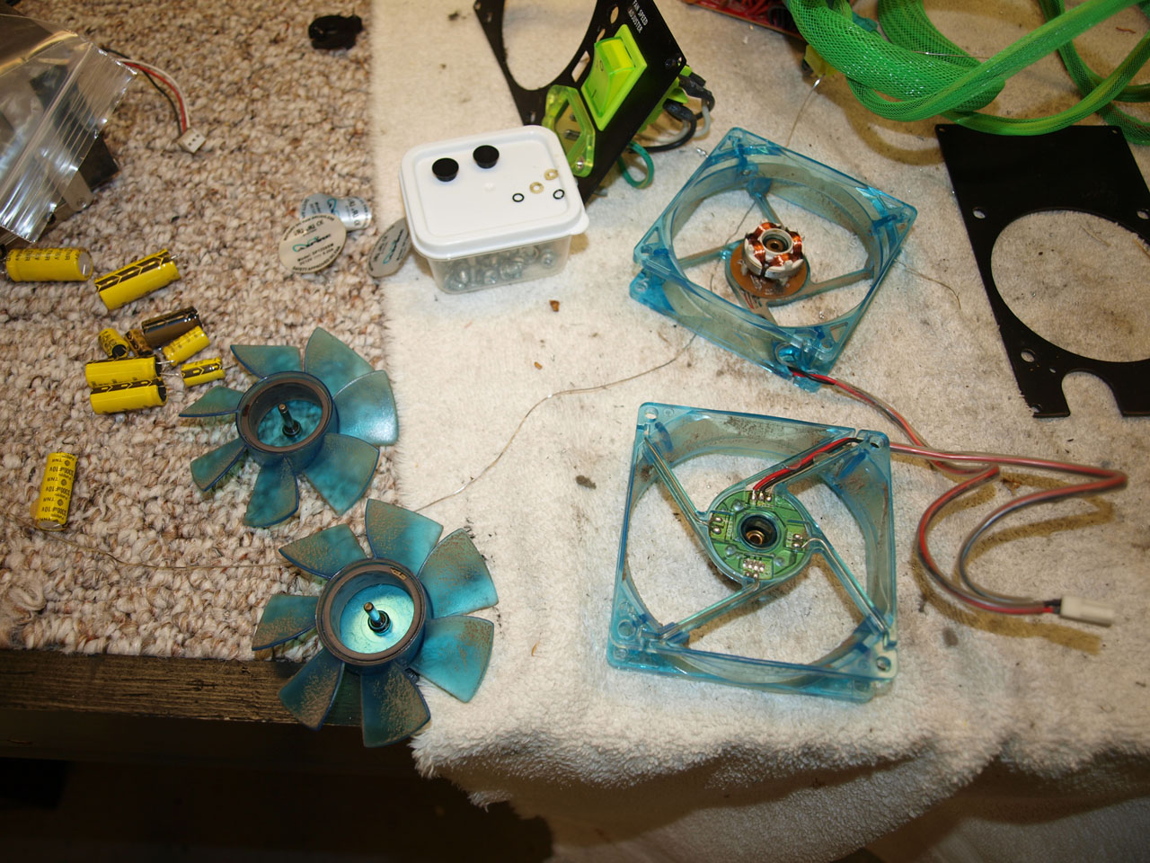

Today's task was to tackle the power supply that originated with this system... I have never seen one of these before (transparent case)....but lets have some fun with it!
It was grungy.....
When it came to servicing this unit, I really liked the way it came apart.....but that was about all I can say I liked about it from a servicer standpoint.

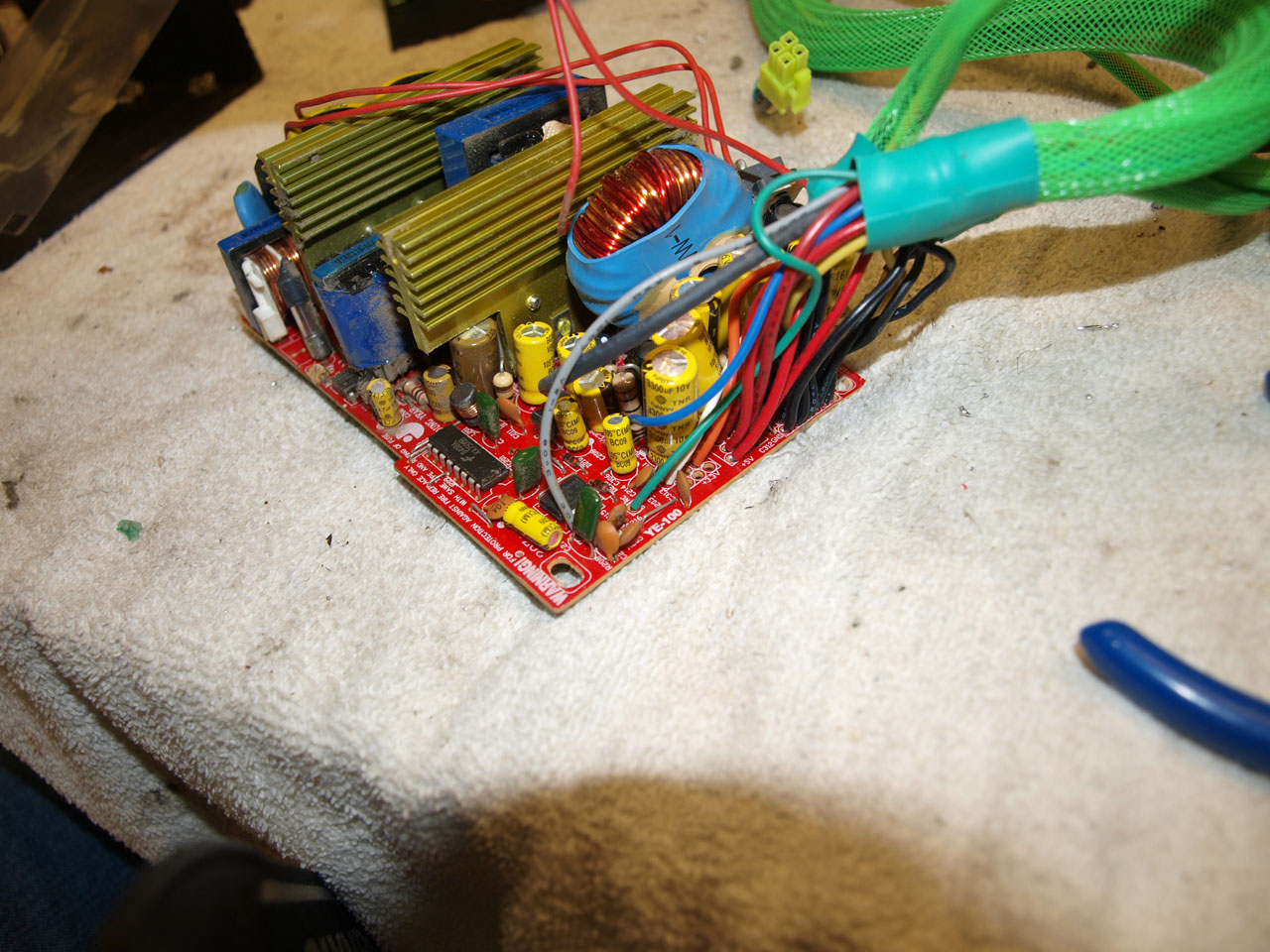

The build quality was fair at best.... The PCB was rather flimsy and a corner had cracked. I attribute that to the way it was shoehorned into the main part of the body as well, there are small mounting brackets that slip into a track in the aluminum, and they don't sit flush, so it stressed teh corners. Fortunately, no trace damage resulted from the broken corner, we're still good to move forward.
Yay, a bunch of spooged fukkyou's!!

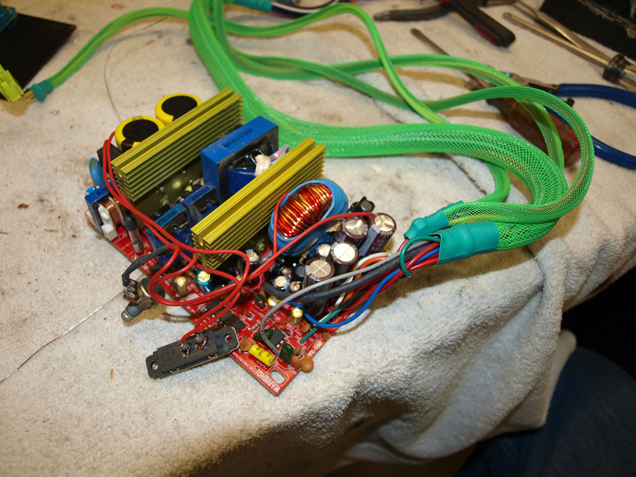

Note the one under the heatsink....it expanded itself so tightly in there, it was a real joy to remove it....I was almost forced to desolder all the FET's and remove the sink....but I finally got it loose. Also note how discolored it is....it was supposed to be yellow like the rest of them....but it apparently got very hot.
Fresh caps.

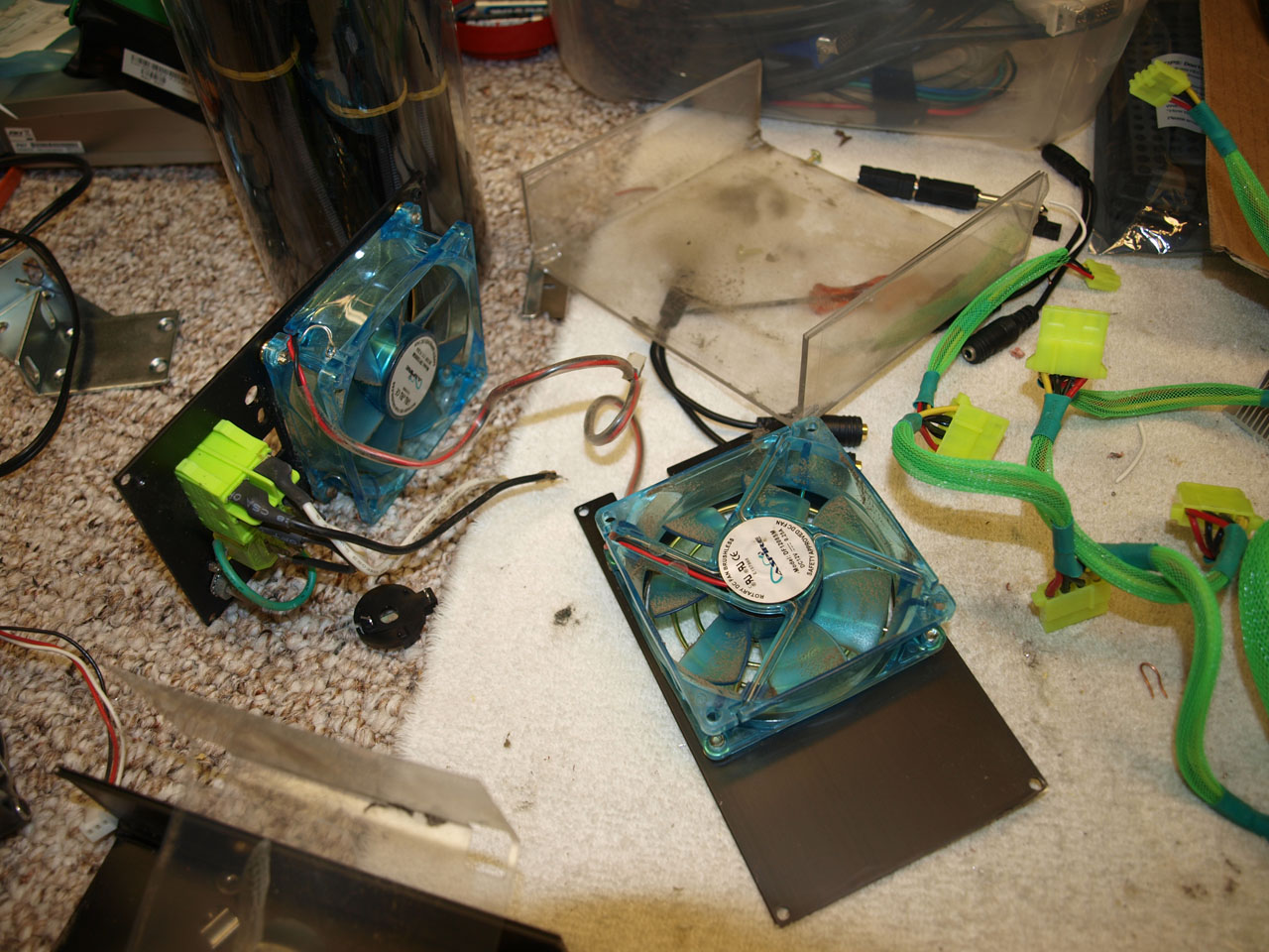

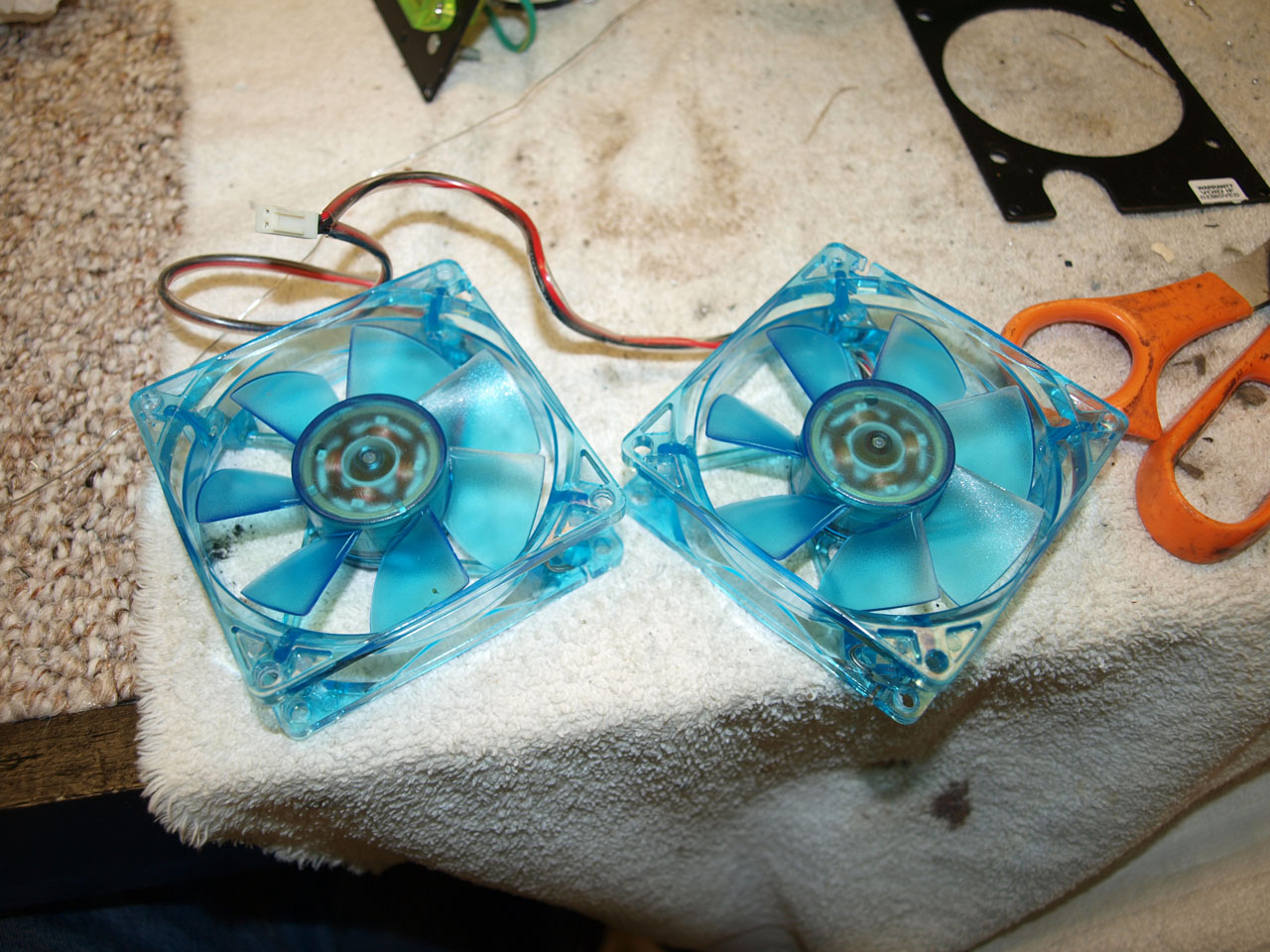

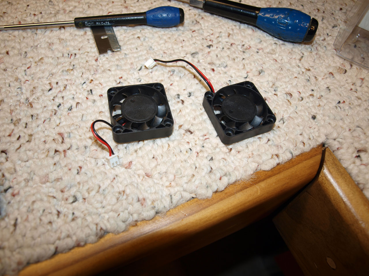

Now time for the fans. To their credit, they actually spun smoothly and the bushing sleeves had not dried out.....but I wanted to clean & repack them anyway. These were 'siamese twins'....joined at the power wire....so that made washing real fun.... There was no way to separate them without cutting, depinning, or desoldering....so I just made due.
Just like the day they were born!

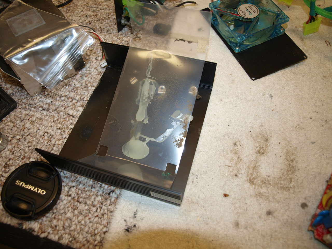

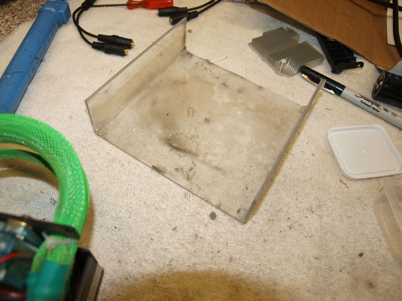

Also washed the shell and the clear cover. The clear cover still had the protective film on it... Yea, I'm sure that sounds all well & good....but bear in mind it's been on there 20+ years.... Removing it was no treat!!
Not bad!

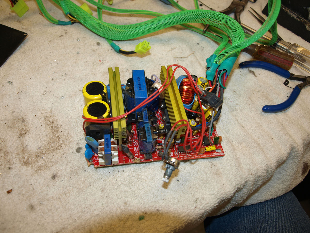

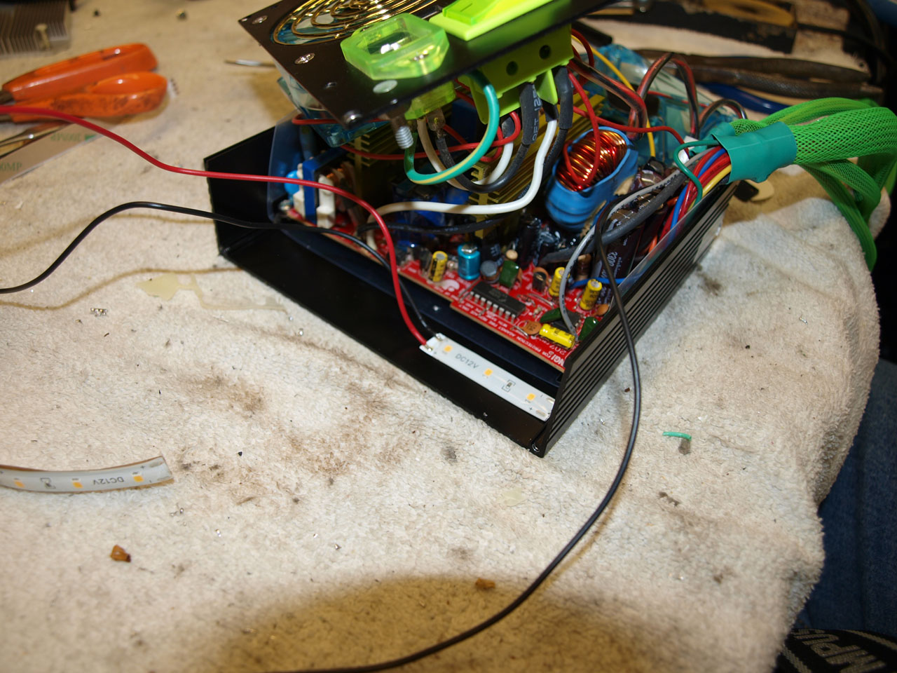

Now lets have REAL some fun!! Hmmm....extra wires....
Ohh hell no....

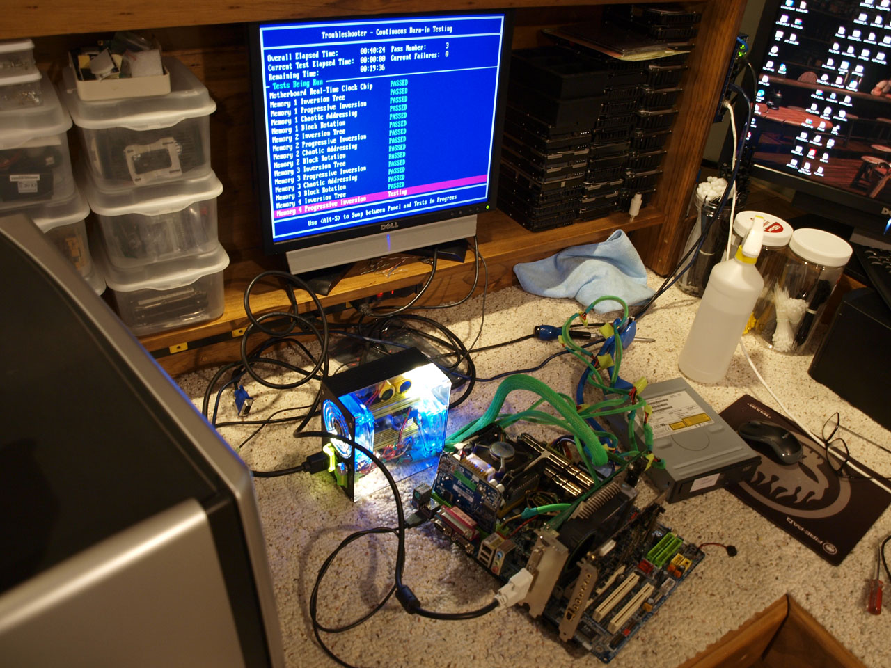

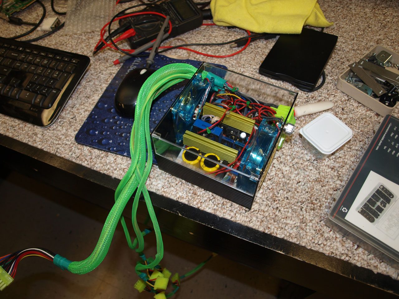

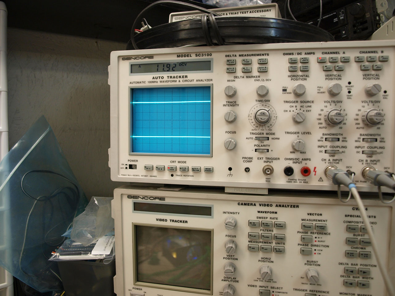

PSU buttoned up. All voltages present and some very noise-free outputs. Not bad if I do say so myself!! I've seen 'high end' PSU's making more output noise than this!
...and done!!

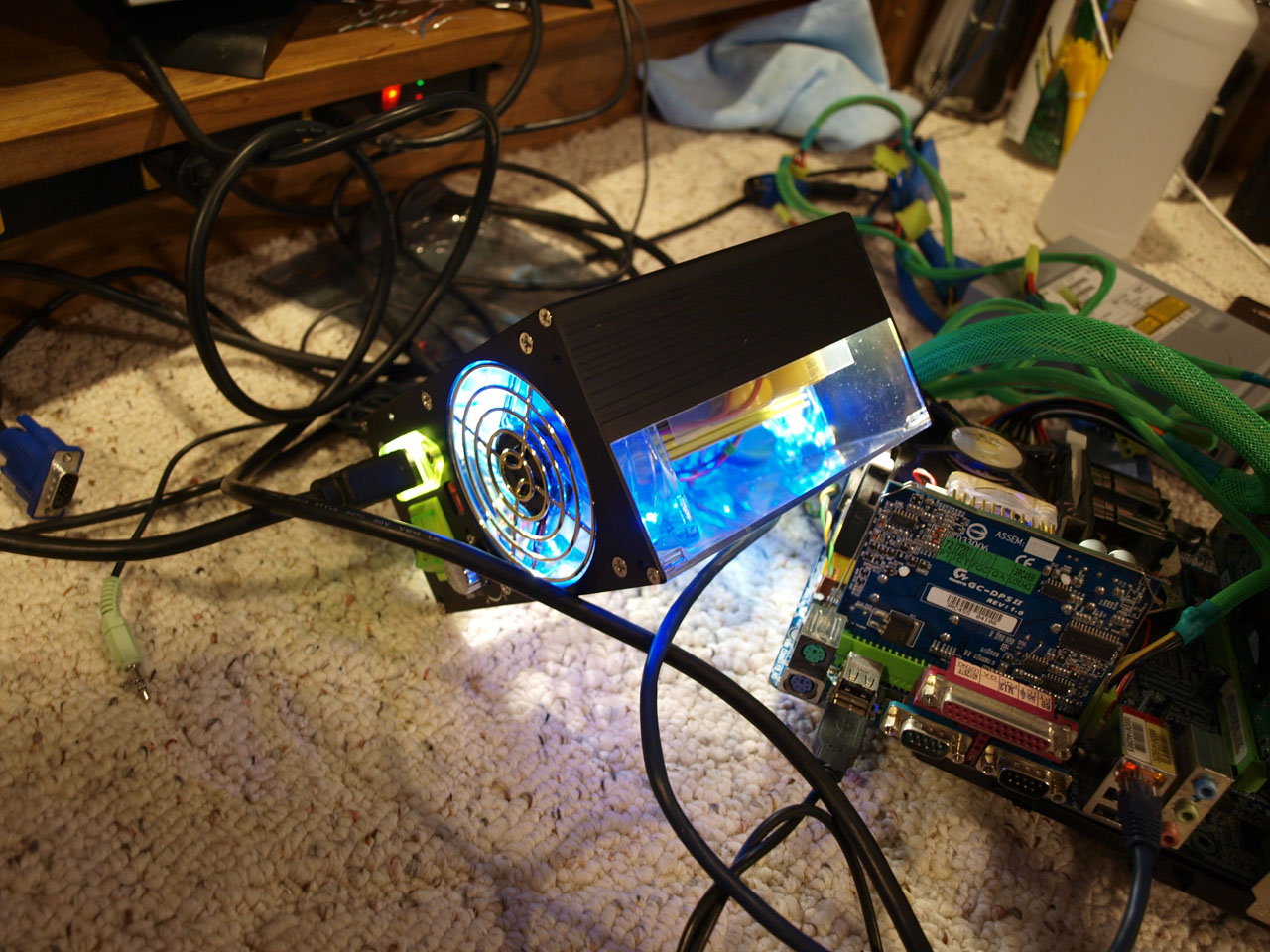

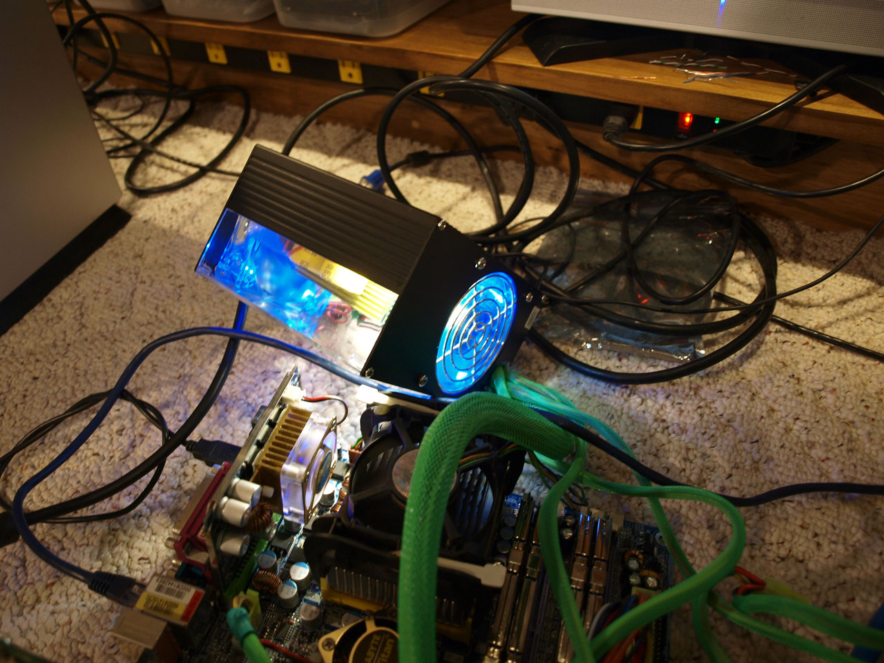

Now the cheesiness you've all been waiting for!! ...and keep in mind, this isn't the end to the strangeness this build will render!!
The clear portion faces downward in the case, so this is what you'll see peering into the big window on the case....
Note the translucent power connector plug! The pics don't do that justice, it lights up in a super-cool pimptastic manner!!
What's under it will be nicely lighted....and it'll make more sense later on.
...but in the mean time, the power supply has been revived; plus some!!

Shockingly enough, the caps in the primary side were in spec, I checked them...they were values I didnt have on hand....so if they were out of whack, I'd have had to place an order..... The only ones that spooged were teh secondary caps. I didn't look to see if they were all the same series.<--- Badcaps.net Founder

No, the primaries and secondary caps are different.Shockingly enough, the caps in the primary side were in spec, I checked them...they were values I didnt have on hand....so if they were out of whack, I'd have had to place an order..... The only ones that spooged were teh secondary caps. I didn't look to see if they were all the same series.
Primary should be "LP" series, if from Fuhjyyu (and I think I can see that on your PSU pictures... but you can easy check by glancing through that clear window
). The secondaries were probably Fuhjyyu TNR's. They're all yellow because Apevia / YY order them this way. On my ATX-IB680W, they're CapXon KM, also in the same yellow color. Definitely custom ordered... but always terrible choice of cap brands, though.

Agreed. These are great to take apart, until you get to the recapping part - the secondary side capacitors were literally an afterthought to the PCB's design. Apevia/YoungYear just shoved them all in there where space allowed.
What they should have done, IMO, is scrap the front fan and make the PCB bigger to make everything fit. Notice how big that main PS transformer is? It's ERL44, IIRC. The output inductor is also T130 size (1.3" diameter), which is appropriate for the power rating of the PSU. They didn't skimp on the size when it came to parts (and size does matter when it comes to half bridge PSUs.
) But the PCB layout is very sub-par.
And that's exactly the 2nd thing I dislike how these PSUs were built.The build quality was fair at best.... The PCB was rather flimsy and a corner had cracked. I attribute that to the way it was shoehorned into the main part of the body as well, there are small mounting brackets that slip into a track in the aluminum, and they don't sit flush, so it stressed teh corners.
YY put a good deal of cash into the aluminum case. It would have probably cost them almost nothing more to have proper stand-offs punched into the aluminum case instead of the cheesy metal clips/springs/brackets. Well, there's a ton more stuff I don't like how they did, if you read through my ATX-AS520W thread.
https://www.badcaps.net/forum/attach...1&d=1647636250
Sorry, I don't mean to be laughing at your struggle... but it was just too funny how YY decided to place the cap there, and of course it bulged.
Yes, it turned dark because it filters the 5VSB, and the 5VSB is one of those 2-transistor self-oscillator designs. If the caps on its output go bad, it doesn't care - it will keep going " 'till it pops", as PhotonicInduction would say.
One of the caps on the 5VSB of my ATX-AS520W also did the same thing... and unfortunately, the 5VSB circuit's secondary-side auxiliary rail also burned the series resistor for the totem-pole driver circuit when this happened (due to over-voltage.) Luckily, no other damage and the PWM IC and supervisor survived on mine.
Apevia used pretty decent sleeve bearing fans here. On mine, one was starting to grind / run dry... but a good cleaning and machine oil brought it back to life and running great again. With good cleaning and lubrication job, I think these fans should last a long time.
You couldn't help yourself, could you?Now lets have REAL some fun!! Hmmm....extra wires....
Ohh hell no....
Actually, that's a pretty neat idea! I think I might even "borrow" it for my ATX-IB680W. I though of doing something similar back when I was fixing the ATX-AS520W, but with regular colored incandescent bulbs from Christmas strings (was thinking of that so as to provide more load on the 5V rail for better regulation... though it may not be needed.)
Thanks for sharing this!PSU buttoned up. All voltages present and some very noise-free outputs. Not bad if I do say so myself!! I've seen 'high end' PSU's making more output noise than this!
I tested my ATX-IB680W with a load after recapping it last year, but I didn't have a scope to test the output ripple. In terms of voltage regulation, though, it did fairly well. I say "fairly", because despite the strong rating on the 5V rail, the 12V rail's voltage was riding a little "high" with a heavy 5V load and low 12V load. Doing this cross-load in reverse - with the 5V rail almost not loaded, but the 12V rail loaded "heavily" (just 15 Amps, really) - both the 5V and the 12V rails were well in spec. So at least my ATX-IB680W seemed "happier" with a 12V-heavy load. Oh, and the short-circuit protections worked pretty well. Plus, I was testing this with a series heating element, which dropped the AC line down to 90'ish Volts... and the PSU still worked.
So these are not bad PSUs.
Looks good... though I'm curious how that would have looked with some UV LEDs instead of the strip. I might try that on mine.The clear portion faces downward in the case, so this is what you'll see peering into the big window on the case....
And if you add an LED behind/inside the power switch and connect it to the 5VSB, you'd be level 9999 pimpNote the translucent power connector plug! The pics don't do that justice, it lights up in a super-cool pimptastic manner!!

Neat!On top of the modular VRM, there's also an onboard as well. It will run without the added VRM.... The VRM is supposed to add increased stability with the higher TDP P4's or with overclocking....or so I read....but yea, interesting feature...and the board was 100% complete, all accessories present. It also had a add-on card to allow one of the SATA ports to function as an eSATA.
That is definitely a rare find. I wouldn't be surprised if people used a motherboard like that back in the day for crazy CPU OC. I still remember that video of a P4 CPU being OC'ed to over 5 GHz with liquid Nitrogen. I wonder what board was used there.

Re: Topcat's Ultimate Pentium 4 Retro Gamer!
I don't know why I said chenbro....I meant to say Chieftec. It is absolutely a chieftec case....the parts actually interchange with the steel one I have here.

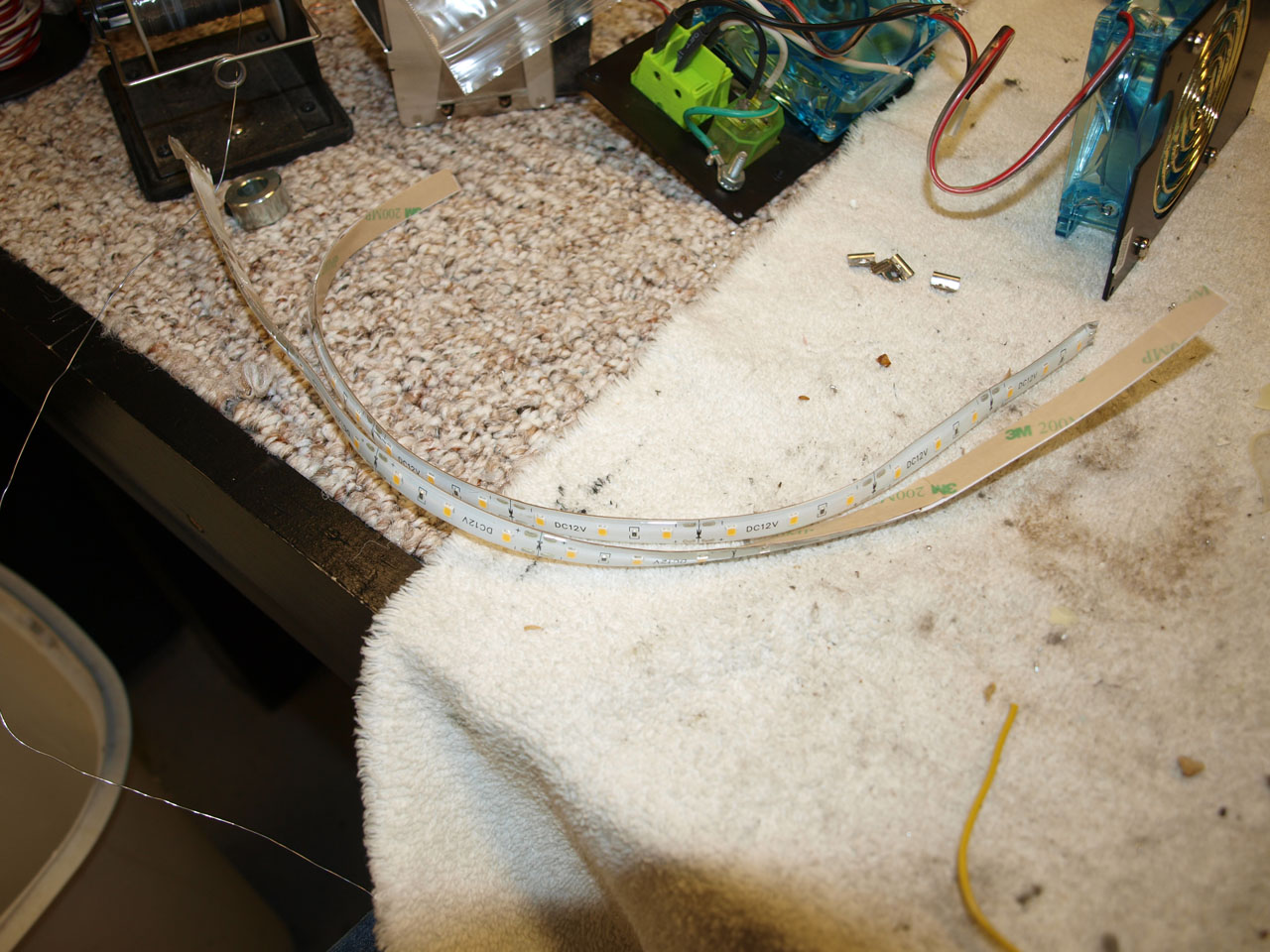

You're killin' me! HAHA UV LED's....hmmm you're contributing to the delinquency of a minor!!
Not sure what I'd do with another one....but they are unique for sure....and they seem to put out some pretty clean power, you saw the waveform (or lack thereof).eBay.
Just have to look for "Apevia Power Supply" and look through the listings. They don't come up very often, as these are rather OLD PSUs now. But if you look often enough, one will pop-up. You'll certainly be in for a full recap job, though.
That said, I was able to find one for you.
https://www.ebay.com/itm/115142190636?
Not sure if I'd pay what looks like close to $35 (though it does have a "Make Offer" option.) I got mine (model ATX-IB680W) for just the price of shipping... and its caps weren't even popped yet (or bad.) I haven't posted this one BCN yet, but I will. It's almost the same as TC's, but has RGB fans - as in, fans that can be switched between Red, Green, or Blue light and not the modern RGB "rainbow" types (which is all the better, IMO.
If this were to be heavily used, I would have replaced them all.... The primary caps lasted this long... HAHANo, the primaries and secondary caps are different.
No kidding!! Packed very tight. The dual push-pull fans move a lot of air....but even that couldn't save those junk caps.
Agreed 100%...and used better PCB material....What they should have done, IMO, is scrap the front fan and make the PCB bigger to make everything fit. Notice how big that main PS transformer is? It's ERL44, IIRC. The output inductor is also T130 size (1.3" diameter), which is appropriate for the power rating of the PSU. They didn't skimp on the size when it came to parts (and size does matter when it comes to half bridge PSUs.
Another 100% correct. Neat & well designed casing....but that PCB mounting design wasn't worth a shit....And that's exactly the 2nd thing I dislike how these PSUs were built.
Yup, +5vstby indeed....I figured that out when I saw how 'overdone' it was compared to the others....and then of course looking at the circuitry in its path. Makes me wonder what the inside looks like...
The rest of the case has a bunch of them as well...blue and light up! :LOL:
The LED's I used, 5v wouldn't strike them....it took about 8. I was doing to run some on the 5vstby, so there'd be lighting even if the system was off....but that didn't work out.You couldn't help yourself, could you?
This was under no load. Ripple leaking through would show up either way; with or without load...so I was still happy to see what I saw. I tend to always scope outputs of a reworked PSU before ever putting it on a motherboard.Thanks for sharing this!
I'm not done yet....but the clearance was tight around the switch...but I bet I could make something fit.

I forgot to mention in my previous post: that resistor next to the 5VSB cap looks like it could have contributed allot to it as well?
I also moticed something else funny in the same picture: the fuse is heatshrinked but not over the glass.
I guess the OEM of this thing must like glass sharpnel flying everywhere in their nice plexi glass
Also forgot to mention another thing that crossed my mind:
Those LED's you installed are very near the primary side.
If anything comes loose there and touches the high voltage it would end very badly...
https://www.badcaps.net/forum/attach...1&d=1647636250"The one who says it cannot be done should never interrupt the one who is doing it."Comment
The fan is actually pinning that in place by a good half inch (note the direction of the wires) and everything is tied up well. The exposed terminals aren't going anywhere, the rest is encased in the rubber coating. I actually thought of that. If they came loose, there's really noplace for them to go.
https://www.badcaps.net/forum/attach...1&d=1647636250<--- Badcaps.net Founder

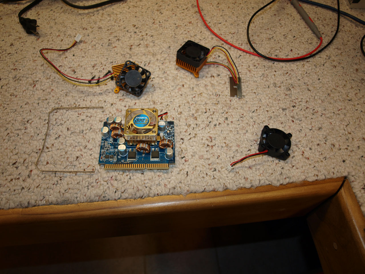

I ordered a couple new 40mm fans for the northbridge and for the secondary VRM. They actually came with the heatsinks....they were new. Since one fan on this system (VRM fan) was wonky, I just went ahead and replaced them both....if nothing else, so they match.
Old fans removed & disassembled.
The next round of fun was swapping the plugs over....
...and done! Two fresh new fans! Yes, I did grease them even though they were new.

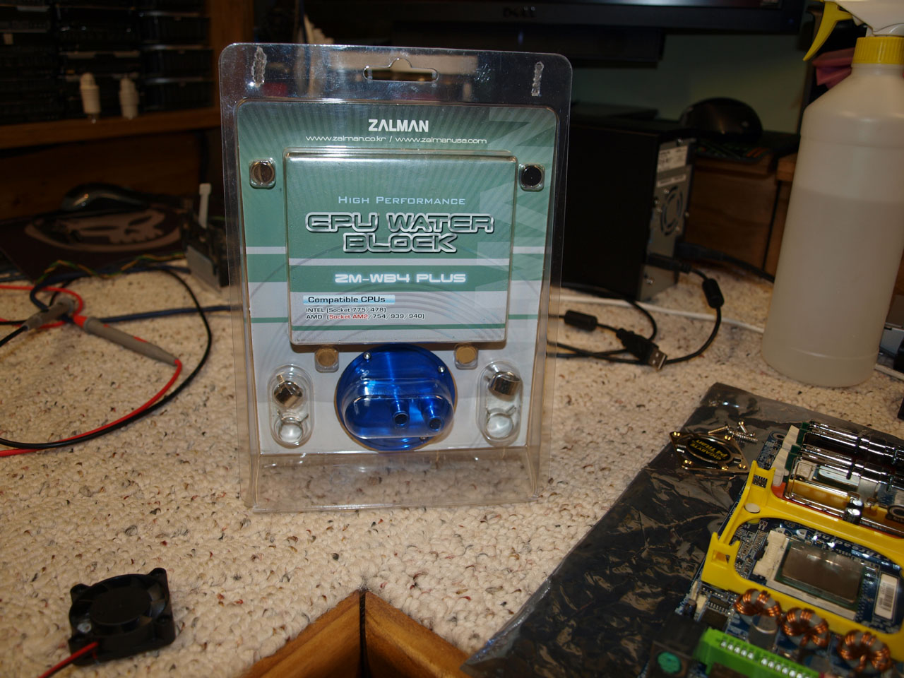

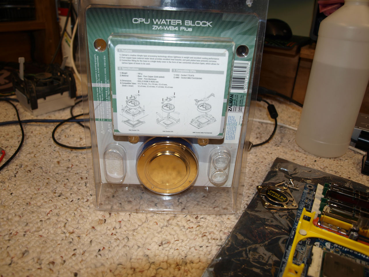

Now for her to reveal one of her well kept secrets. This was an inadvertent find when scouting a new heatsink/fan. I really wanted to use this Zalman Heatsink & fan on this build, but this Gigabyte has too much jazz packed on it, there was no way it could fit. It hit the VRM on one side of the CPU and hit RAM on the other. Not even close enough to modify...so that got quickly scrubbed....and I was looking for an alternative to cooling besides the yawn yawn boring Intel stock coolers....and I stumbled upon this; which is why I mentioned the long lost PC enthusiast base from this era.......because here's what I came up with!

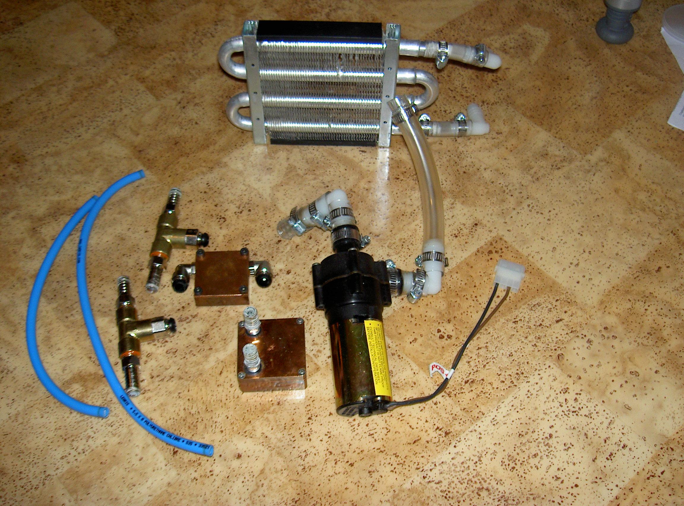

A Zalman ZM-WB4 Plus water block for a socket 478! Now we're talking! I didn't think any of these were even left.... Finding one new old stock apparently not an easy feat....and it didn't cost much; $26 IIRC.
Alright, I know what you're thinking....water cooling is not a big deal today....you can buy prefabbed coolers all day long, all self-contained units...just plug them in and go.....so why is this significant? The last CPU I liquid cooled was a Pentium 3 750/100 @ 1GHz/133 in an Asus CUVX4-E....not really a big deal today; a whopping 250MHz overclock (coppermines were awesome overclockers if kept cooled)....but at the time, the P3 @ 1GHz was astronomical in price versus the P3 @ 750... Be that as it may, here's the fun part....you couldn't just go buy water cooling gear back then....it all had to be fabricated... Pumps were no biggie, those decorative back yard pond pumps worked great. The radiator wasn't a big deal either, I used a heater core out of a Mazda pickup. The greatness came in the form of the water block made to fit on a socket 370. I was lucky enough to have a friend who's dad owned a machine shop....and not an engine shop.... He did design & fab engineer work for a local manufacturer and had some wicked tooling available. Long story short, he fabricated a water block from copper not only for flow & cooling but also so it could be attached to a S370 using those two stupid little tabs on the ZIF socket. He welded 2x 5/16" fuel line barbs; input and output into the block....and turned it over to me and told me to figure out the rest....and I did! ...and my first (and only) water cooled system was born... This was maybe 2000-ish.... I ended up selling the system to his son (my friend) for what I had in it; he wanted a gaming rig....and after the fab work his dad did (for free), I would feel like a jerk making money on it....so I gave it away for cost. IIRC the GPU was a Radeon 8500. I ran it for about 5 months and never had a bit of trouble out of it.
Ok, fast forward to today....I've done a few pre-fab liquid cooled rigs for customers here & there....nothing to write home about...and no, nothing will ever live up to the hand crafted water block of decades past.....but I'm going to make a little attempt at it anyway....and this is the start!!Attached Filesif you find these attachements useful please consider making a small donation to the site

Wow TC, you jogged my memory today.
I actually built a few waterblocks waaay back when.
Those where the good old times!
Crazy to think it must be 20 years ago though!Attached Filesif you find these attachements useful please consider making a small donation to the site
I can imagine people doing this now with the VRAM on modern video cards.
(a smaller radiator for the VRAM chips)ASRock B550 PG Velocita
Amen, brother on all accounts!!
PC's today are so boring in comparison to back then!
BTW, I love those water blocks. That radiator looks like a small oil cooler, I bet that worked great with a bank of fans blowing through it!! I really miss those days!<--- Badcaps.net Founder
