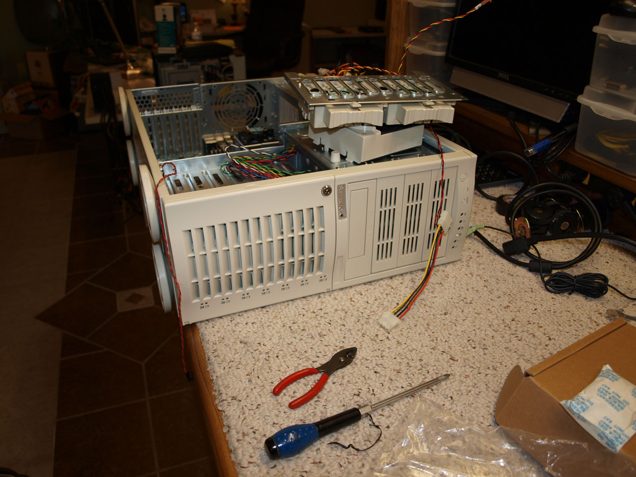

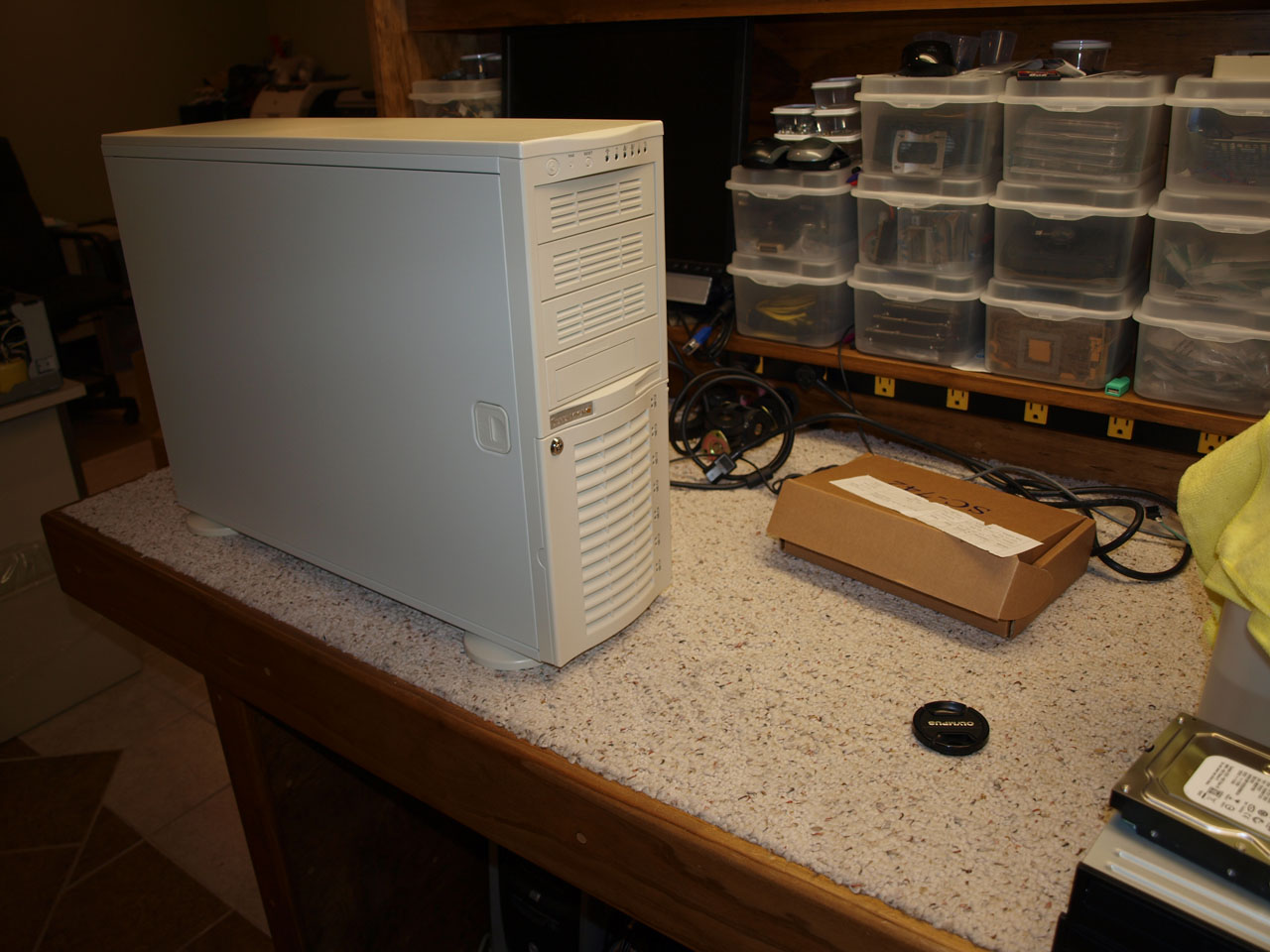

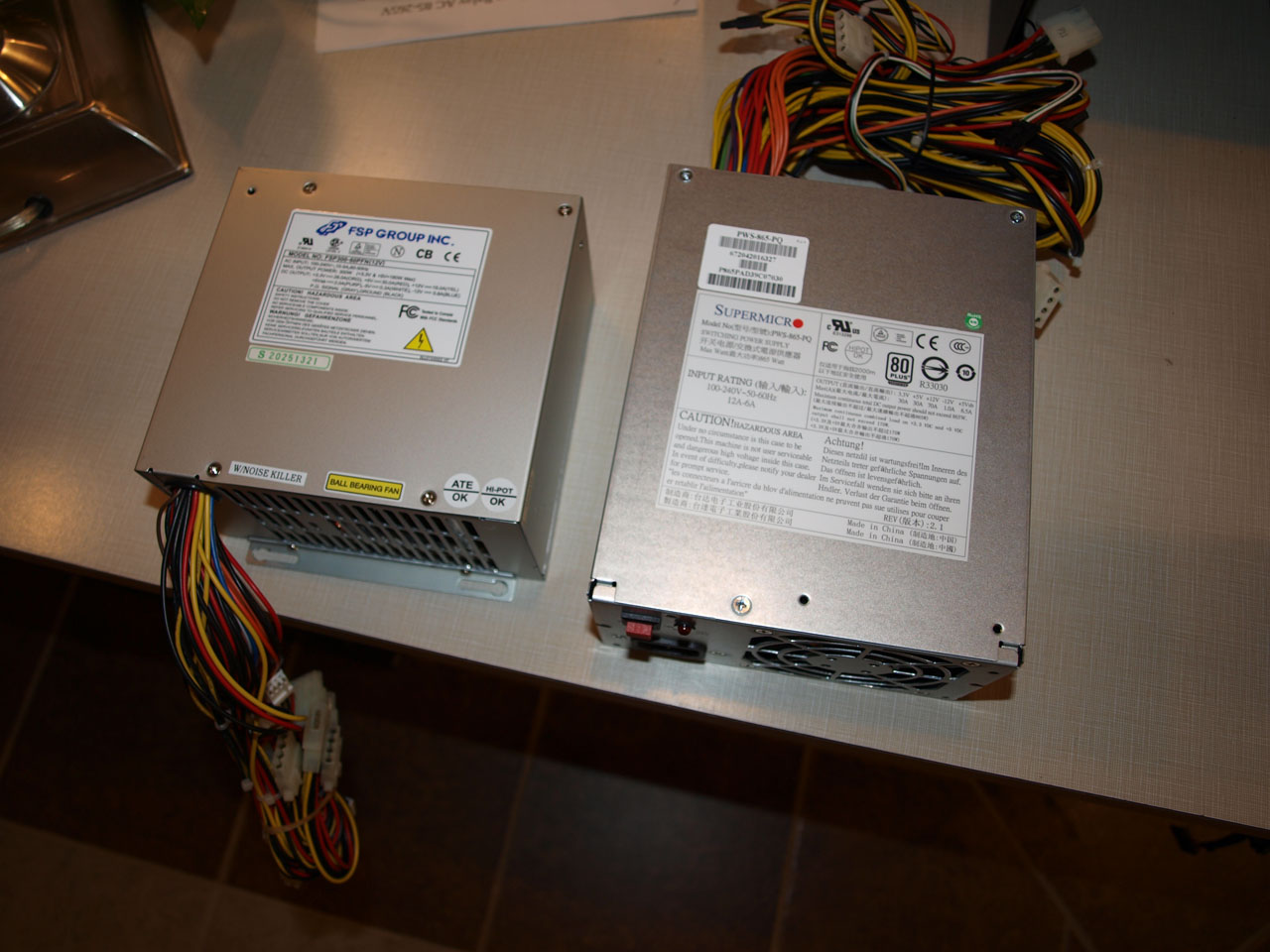

                                    Re: A Supermicro completely Shanghai'd!!

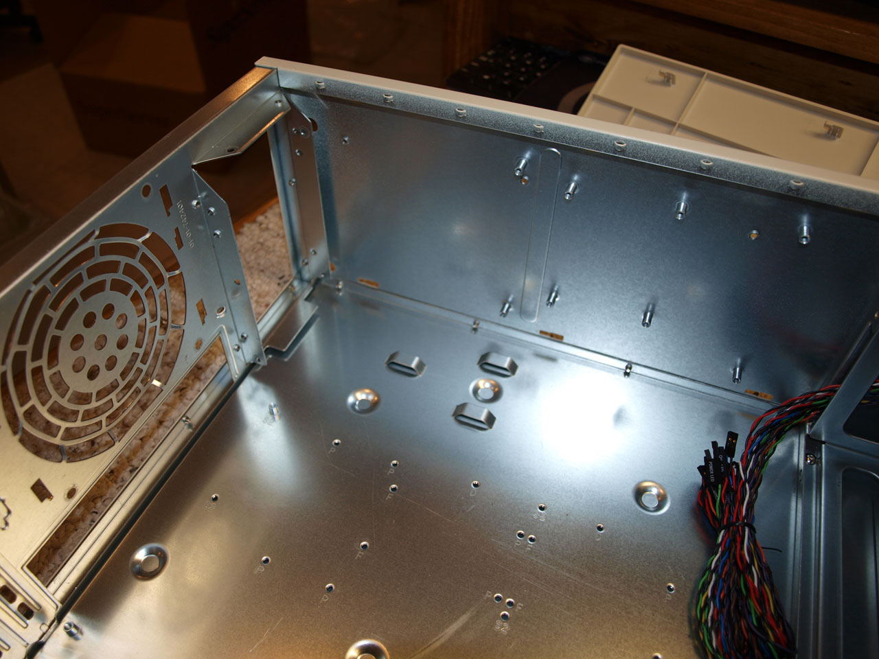

                                    ...and for that special case....if you looked at the pic in the first post, it was one of the clues... This was that $25 new-in-box score from the salvation army store back in March.

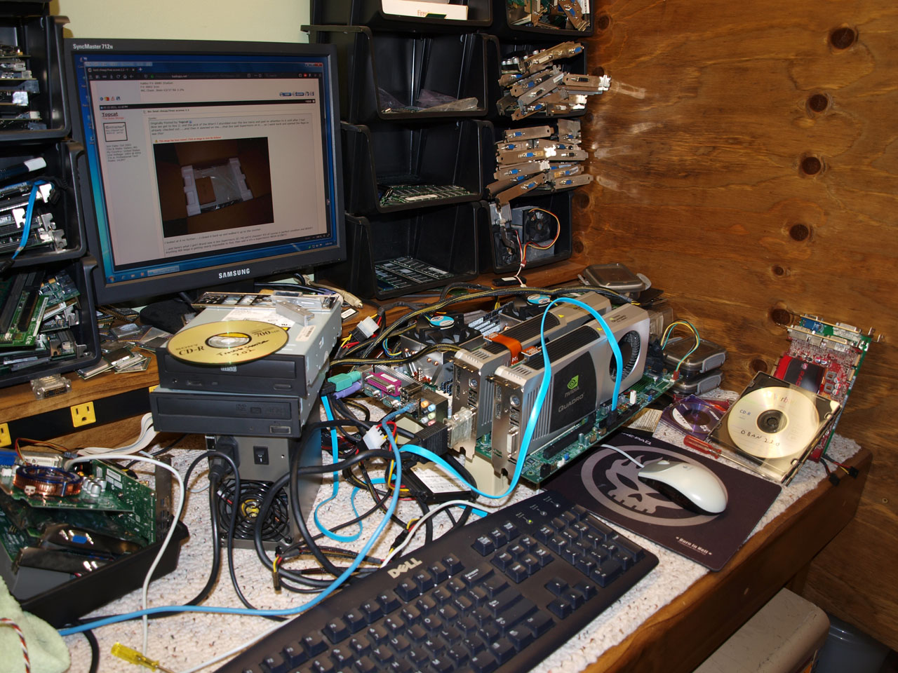

                                    For now, I'm going to run the pair of SLI'd FX5800's; they're 4gb each. Their GPU is basically a GTX 285 with a shitload more RAM. I'm still looking for the 'right' GPU combo....but haven't decided yet. It's maxed @ 64gb RAM and has the fastest quad core Opterons available for this setup (Opteron 8393 SE) @ 3.1GHz.

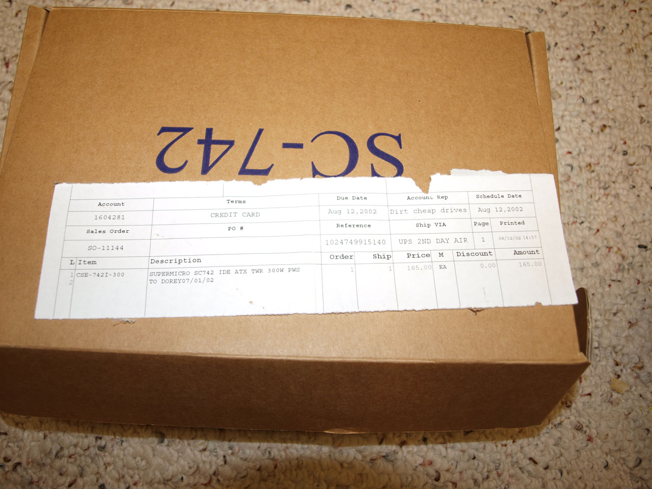

                                    I found part of the invoice in the box, I missed it before... $165 + shipping back in 2002.... Today, this style case is ~$400ish... Beige has been gone from SM's lineup since ~2008.

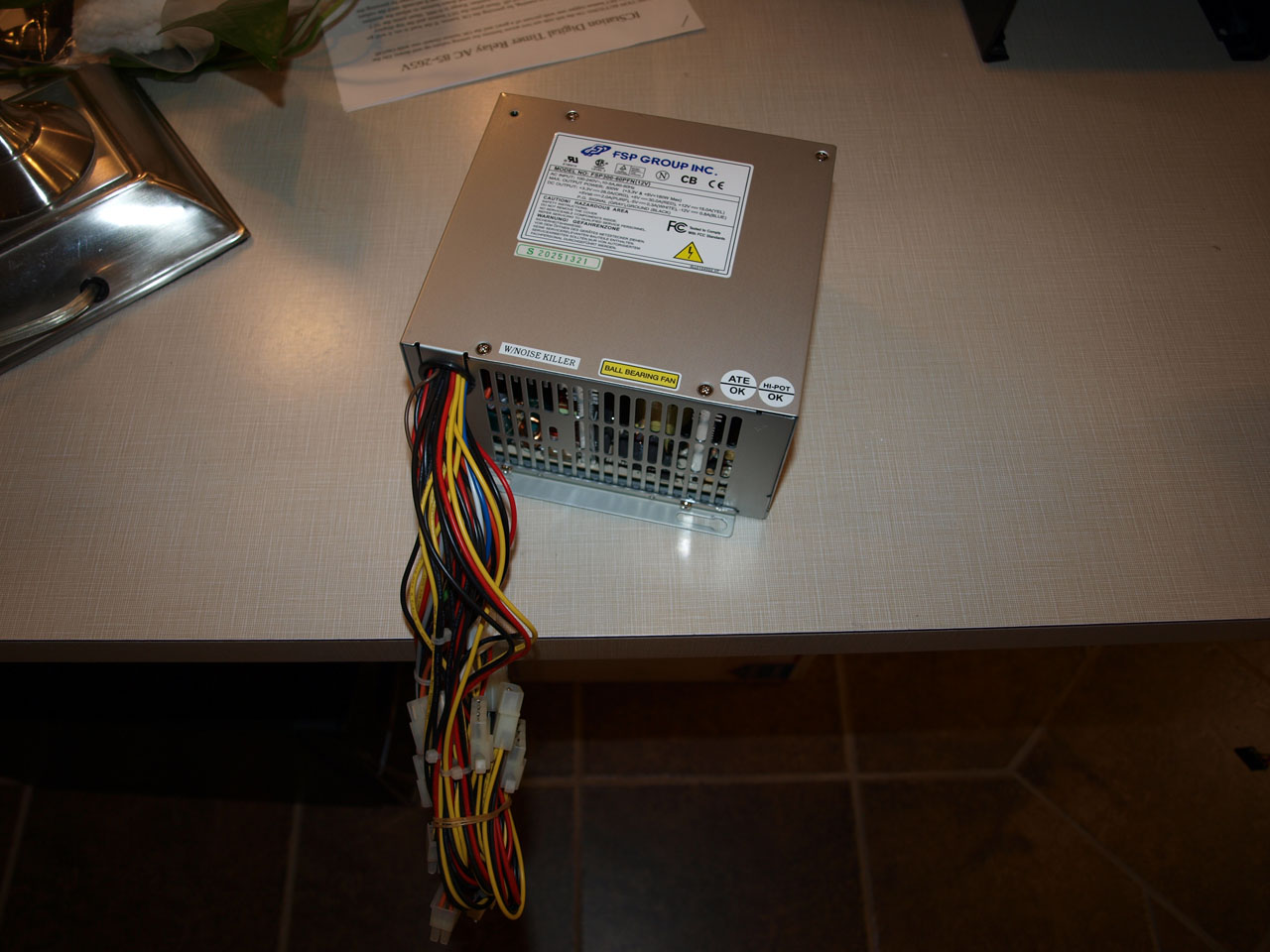

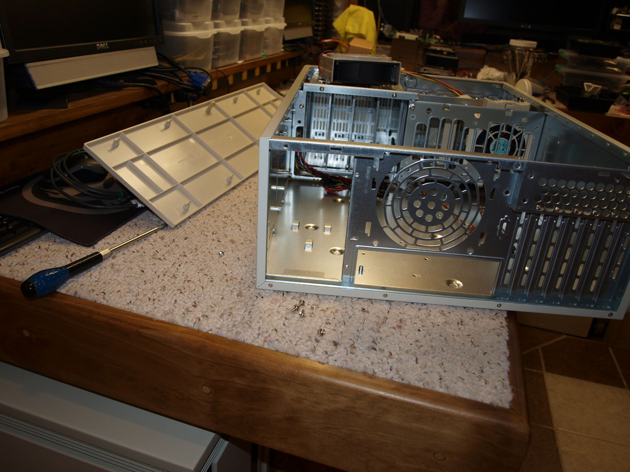

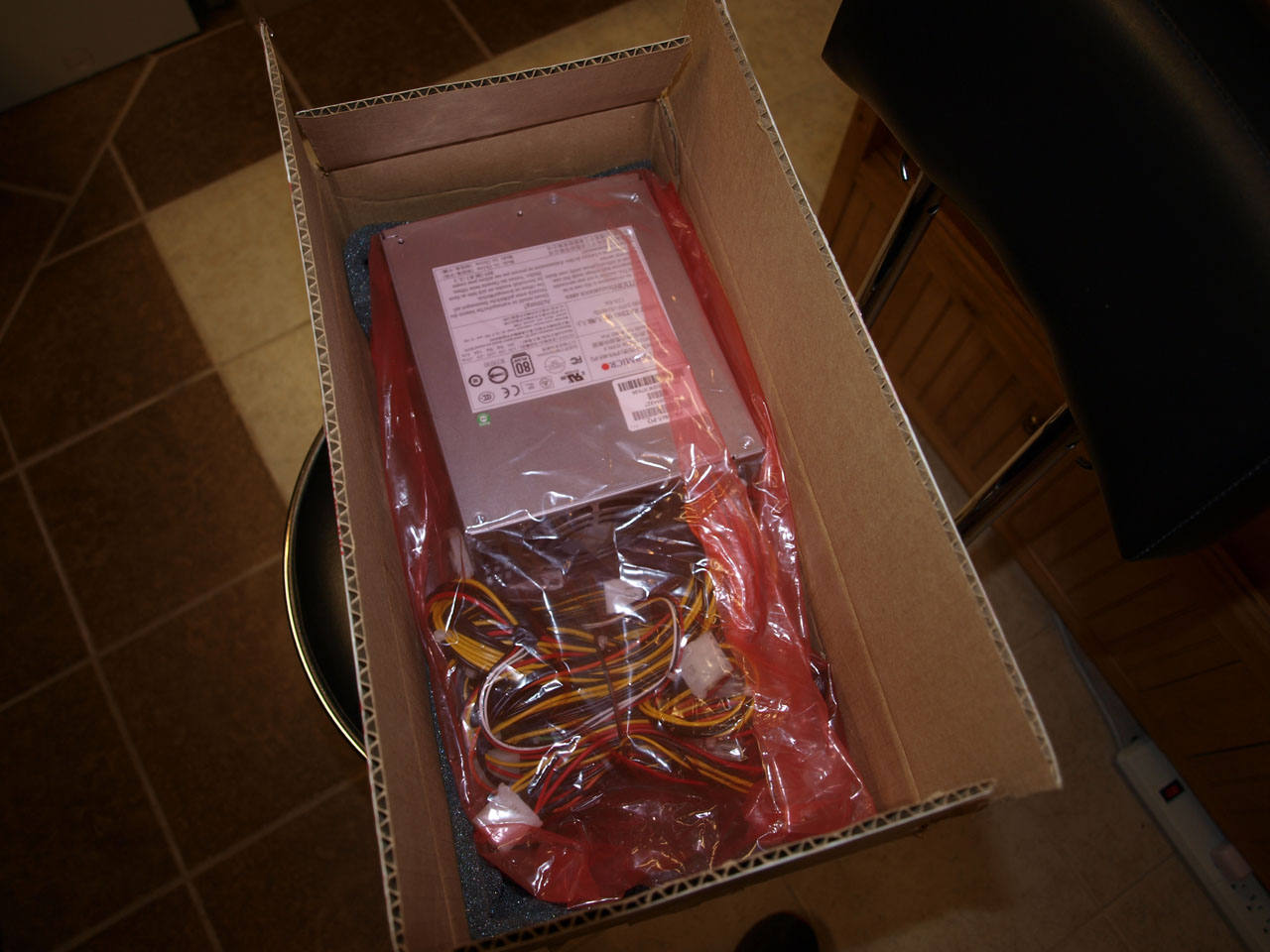

                                    First things first. That FSP 300w PSU isn't going to cut it. I'll save it for something else....
                                    Not terrible for its time....but I just don't think it up to the task for this power hungry build!

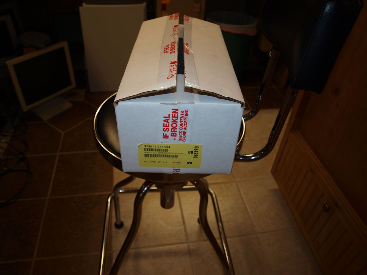

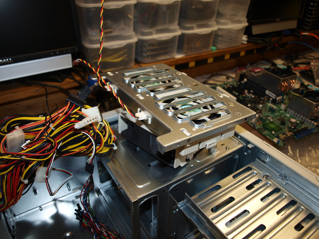

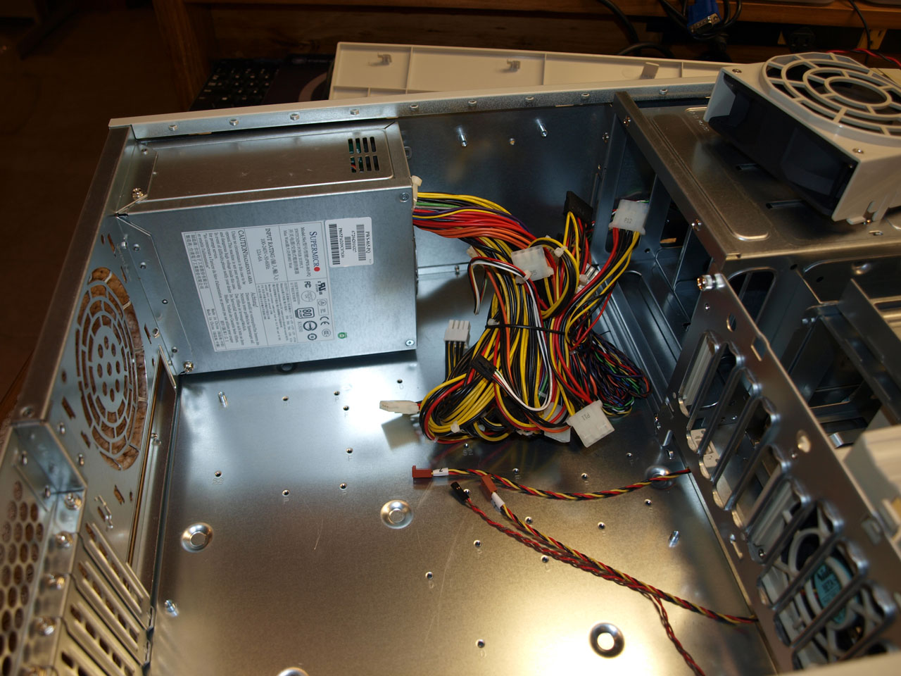

                                    I've had this in my spare pile for ages....it's time it got used. Supermicro PWS-865-PQ (yea, keeping it all in the family)...this one will get the job done!

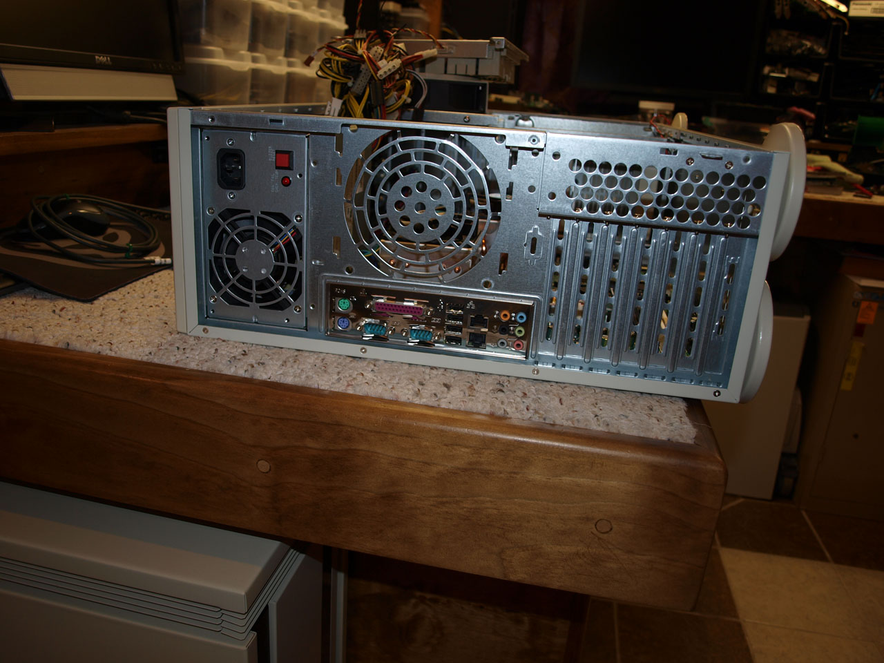

                                    Yeah....
                                    Fits like a glove.

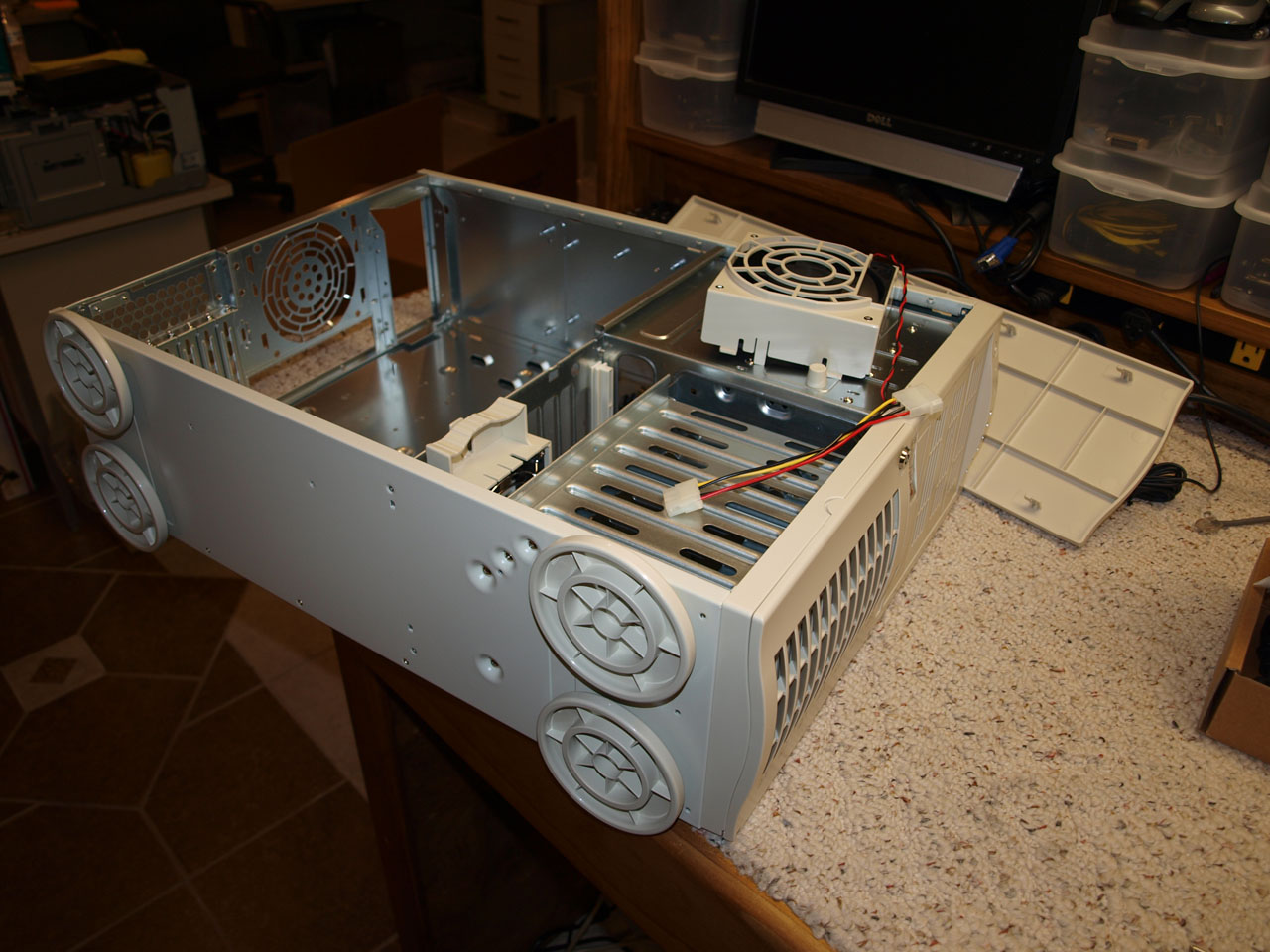

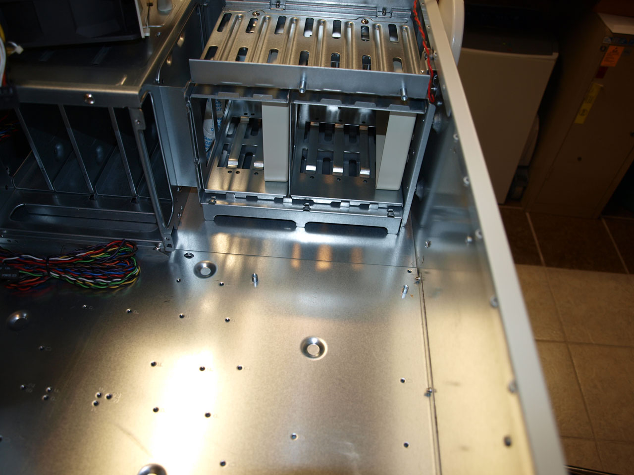

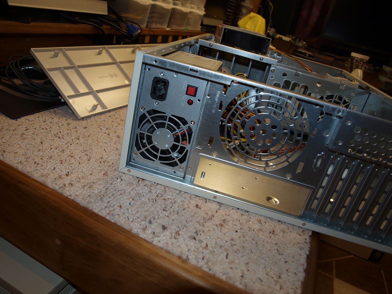

                                    This is the first of this style case I've worked with that didn't have the SAS backplane....HDD's are internally mounted.
                                    The midplane is completely removable. This makes installation of the motherboard and HDD's easy. The HDD trays come out the front, but the midplane being out makes cabling a lot easier!

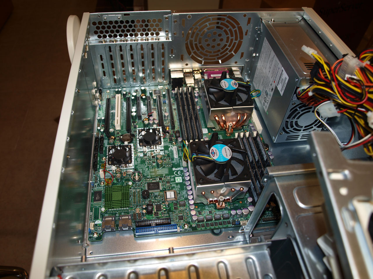

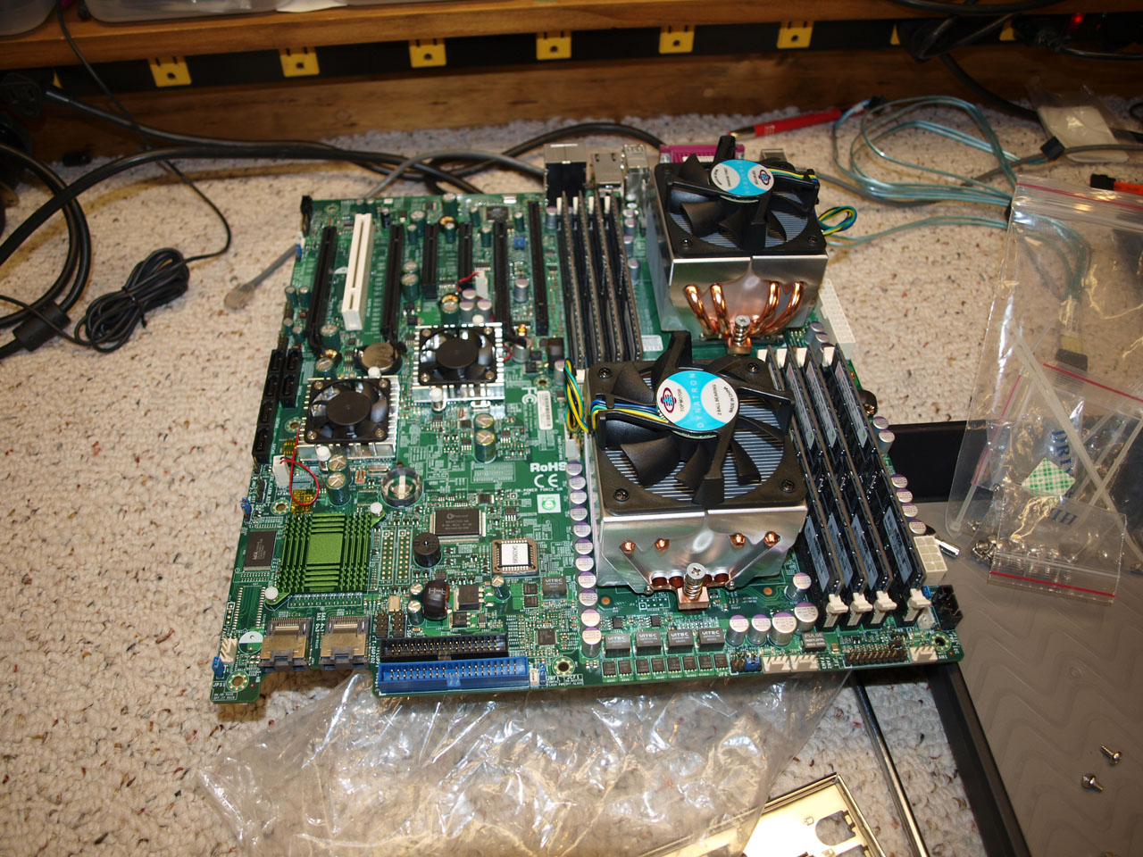

                                    Now for the $20 motherboard. The seller claimed 'used' in the listing....but it really showed no signs of use....No dust in anything! It had first-release BIOS on it and the protection caps are still in place on the mini-SAS connectors.
                                    Very beautiful fit!

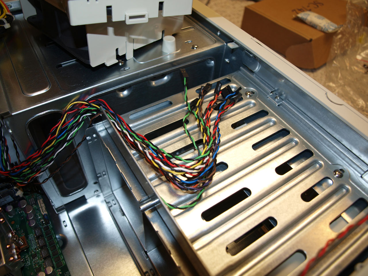

                                    This case is old enough that it didn't have Supermicro's front panel single connect interface for LED's and buttons.... The single connector & ribbon sure made cable management nicer....but I can still live with this. Nothing zip ties can't fix.
                                    That's about as far as I got today....more later!!
