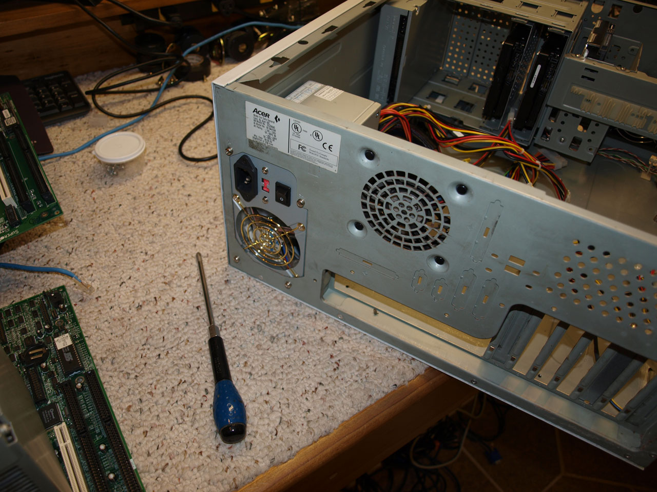

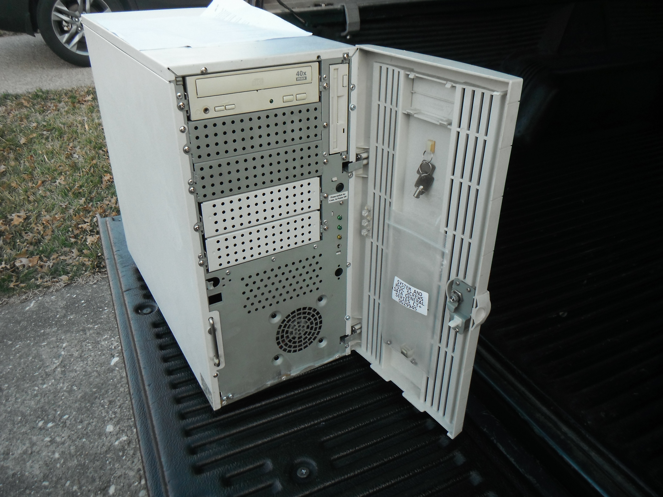

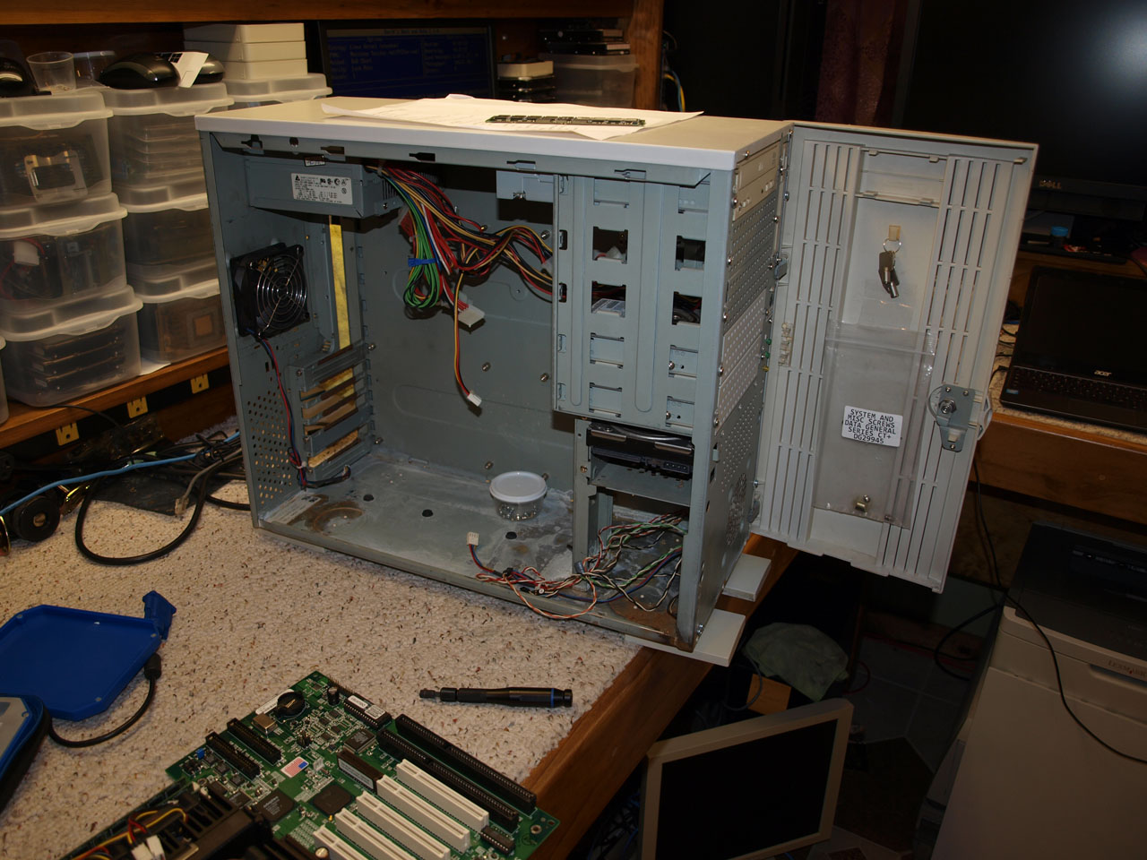

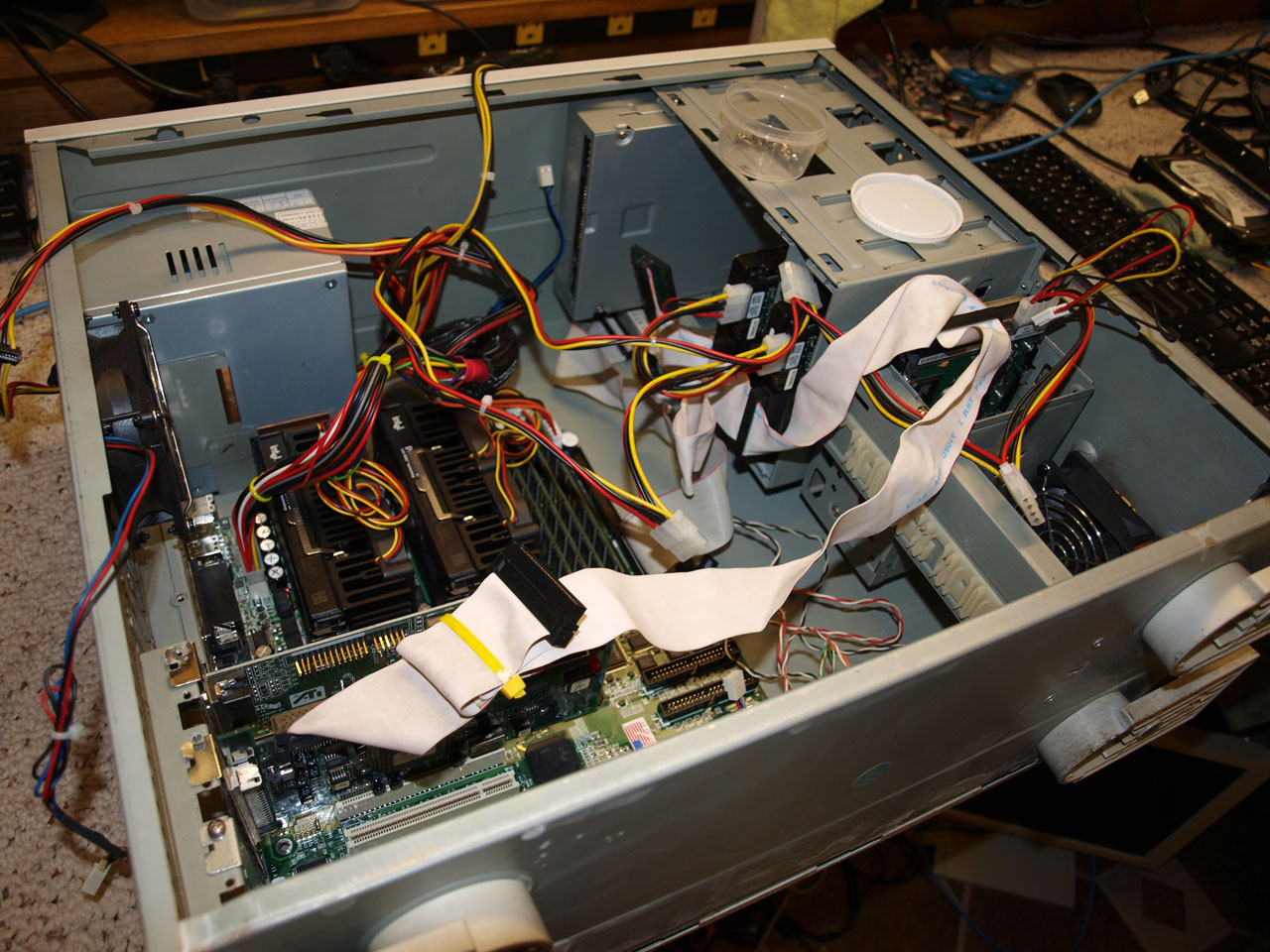

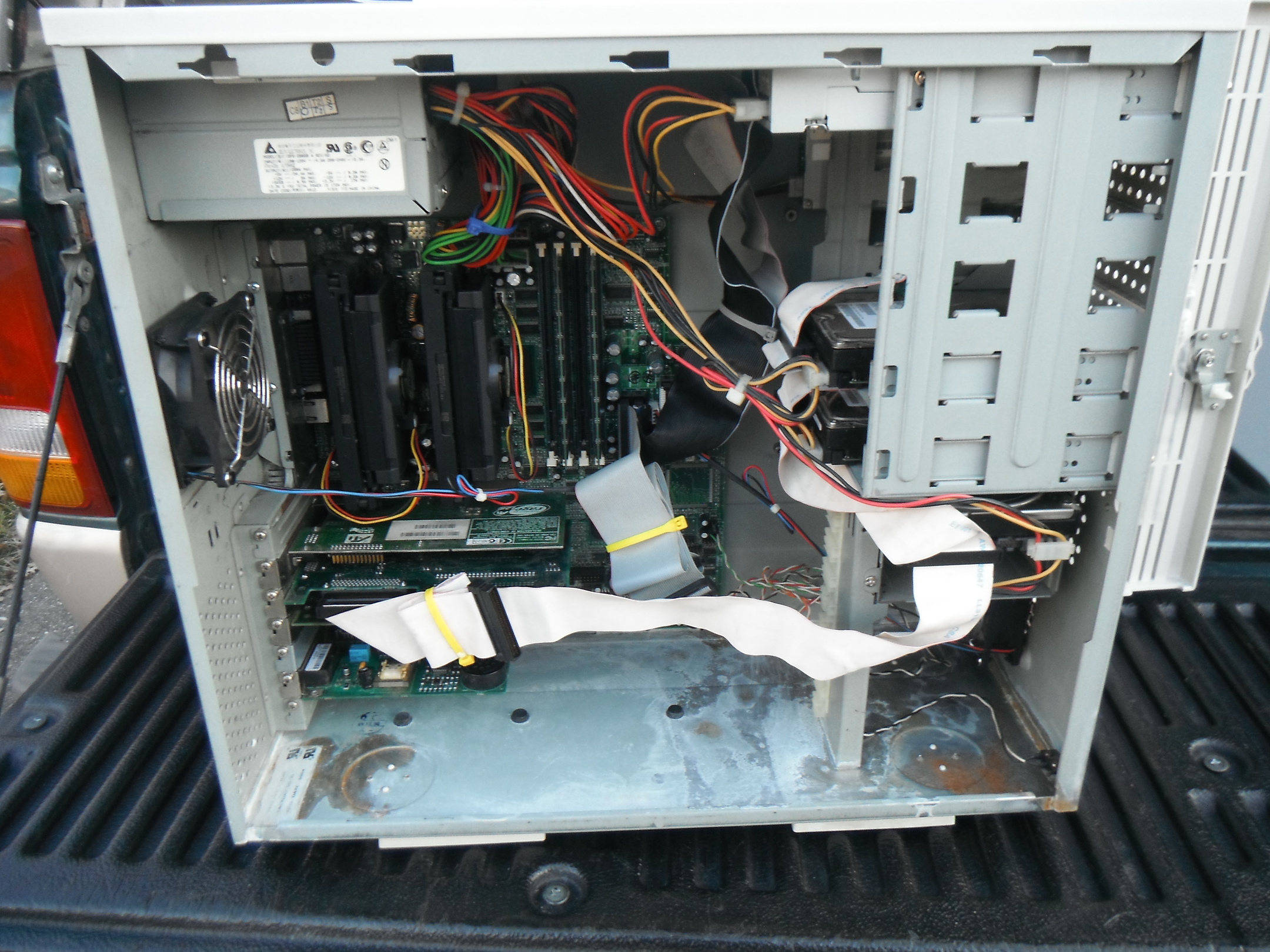

    This is a 1999 AcerAltos 1100 Server/workstation:

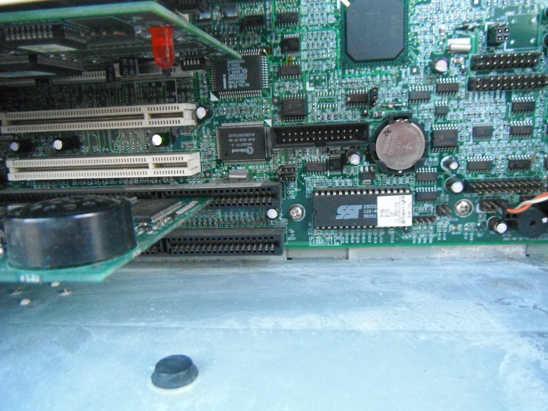

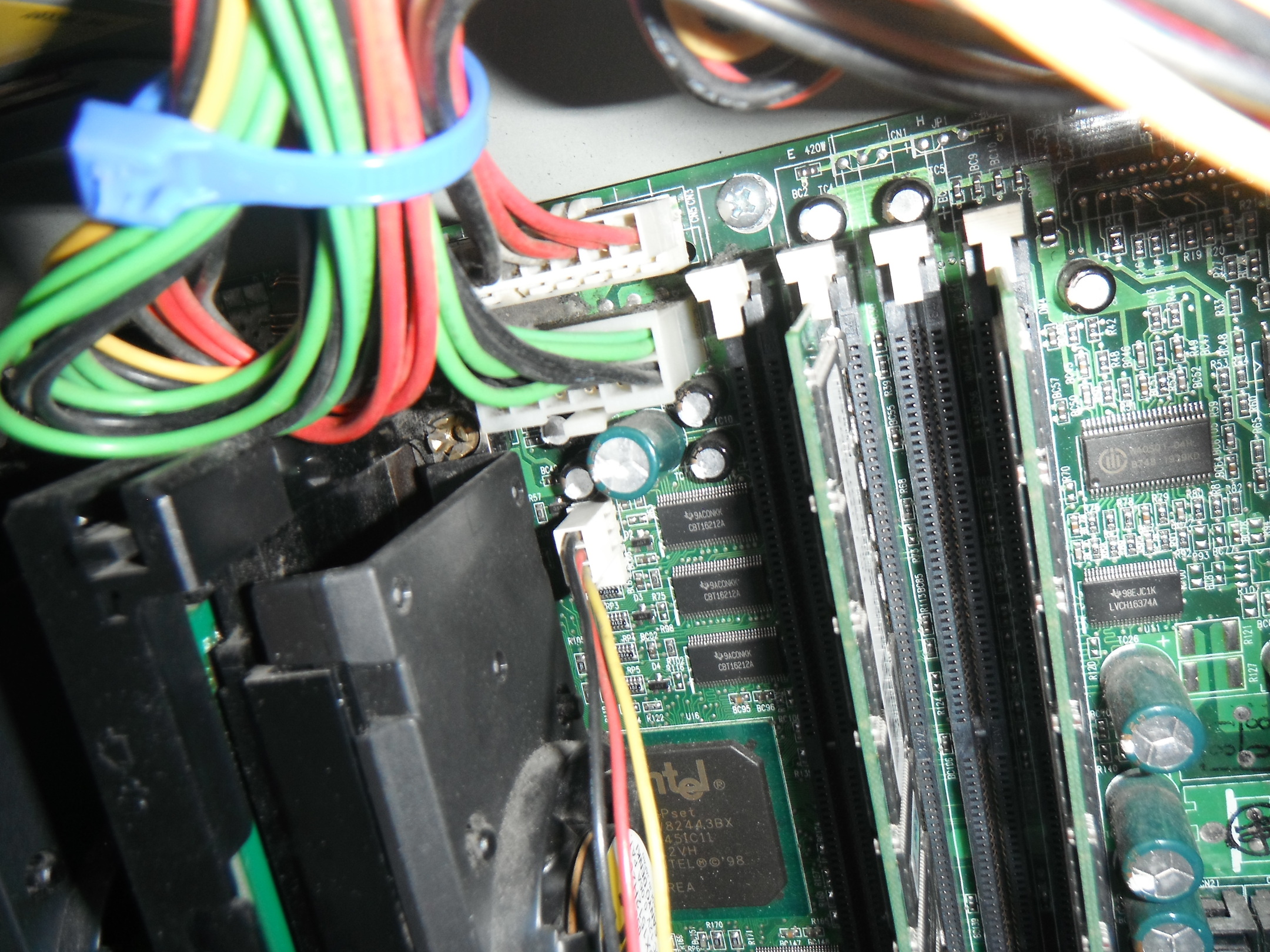

    This thing was bought in DOA condition... and I confirmed. Nothing's getting power... Looks like it had some water in the bottom for a bit:
    The board itself looks clean though...

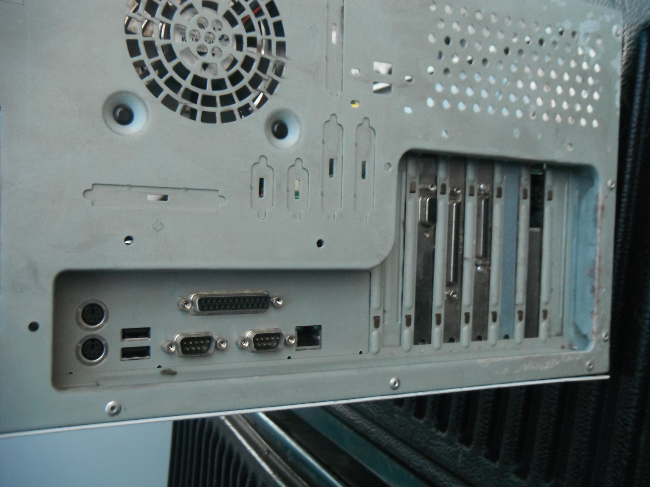

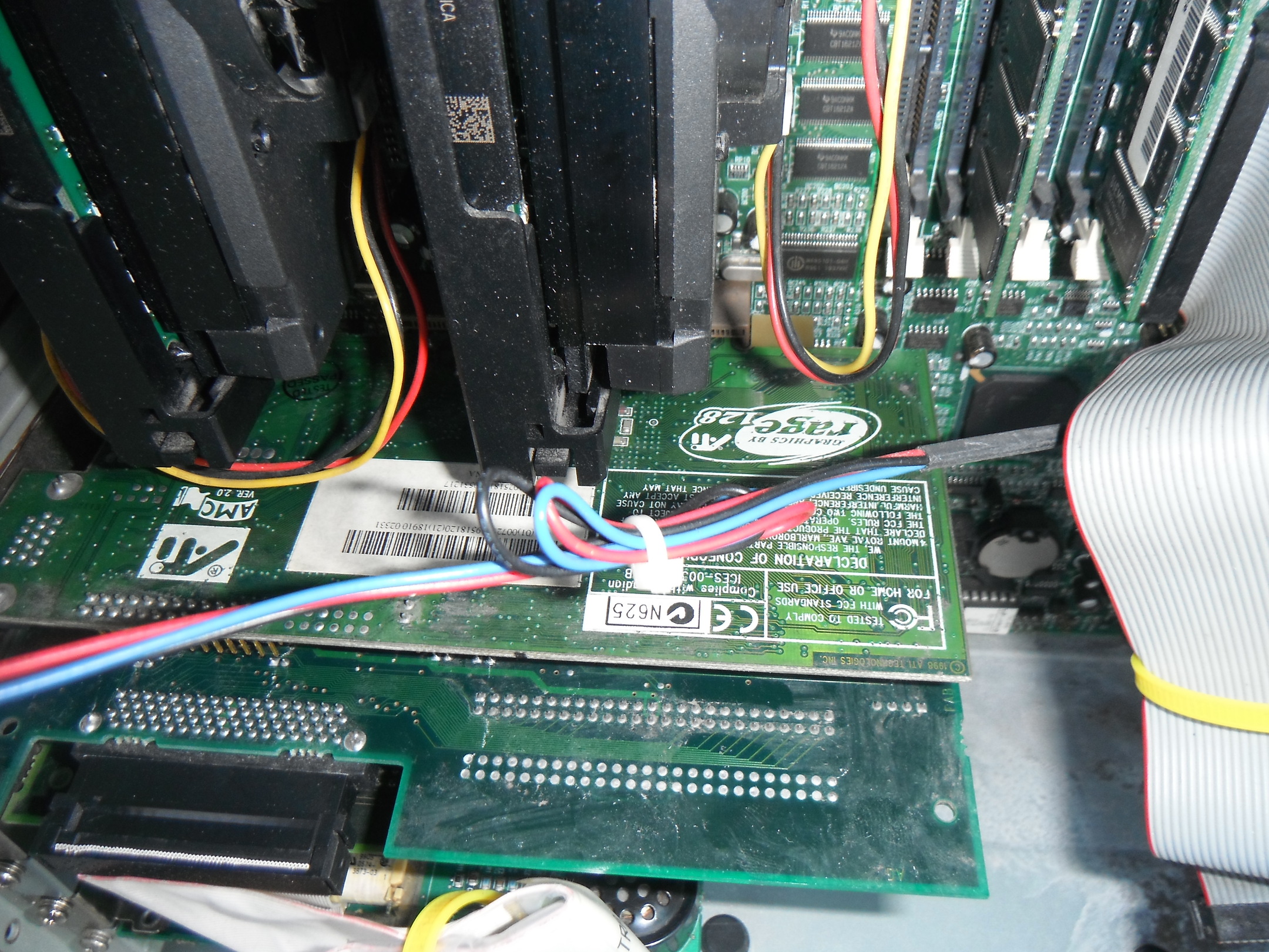

    Rage 128 GPU and SCSI card galore:

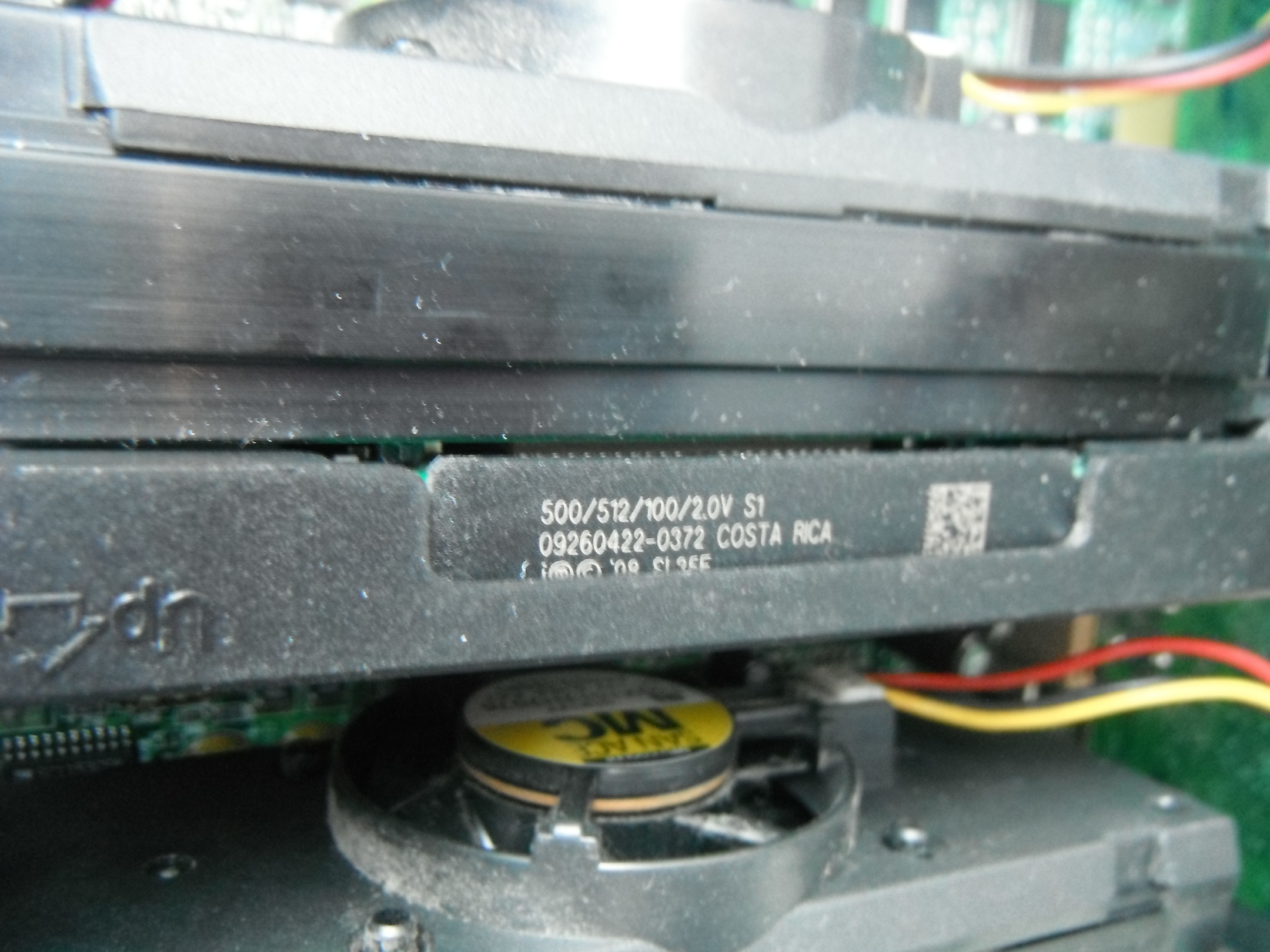

    500MHZ PIII Katmai's:
    ISA Dial-Up Modem:

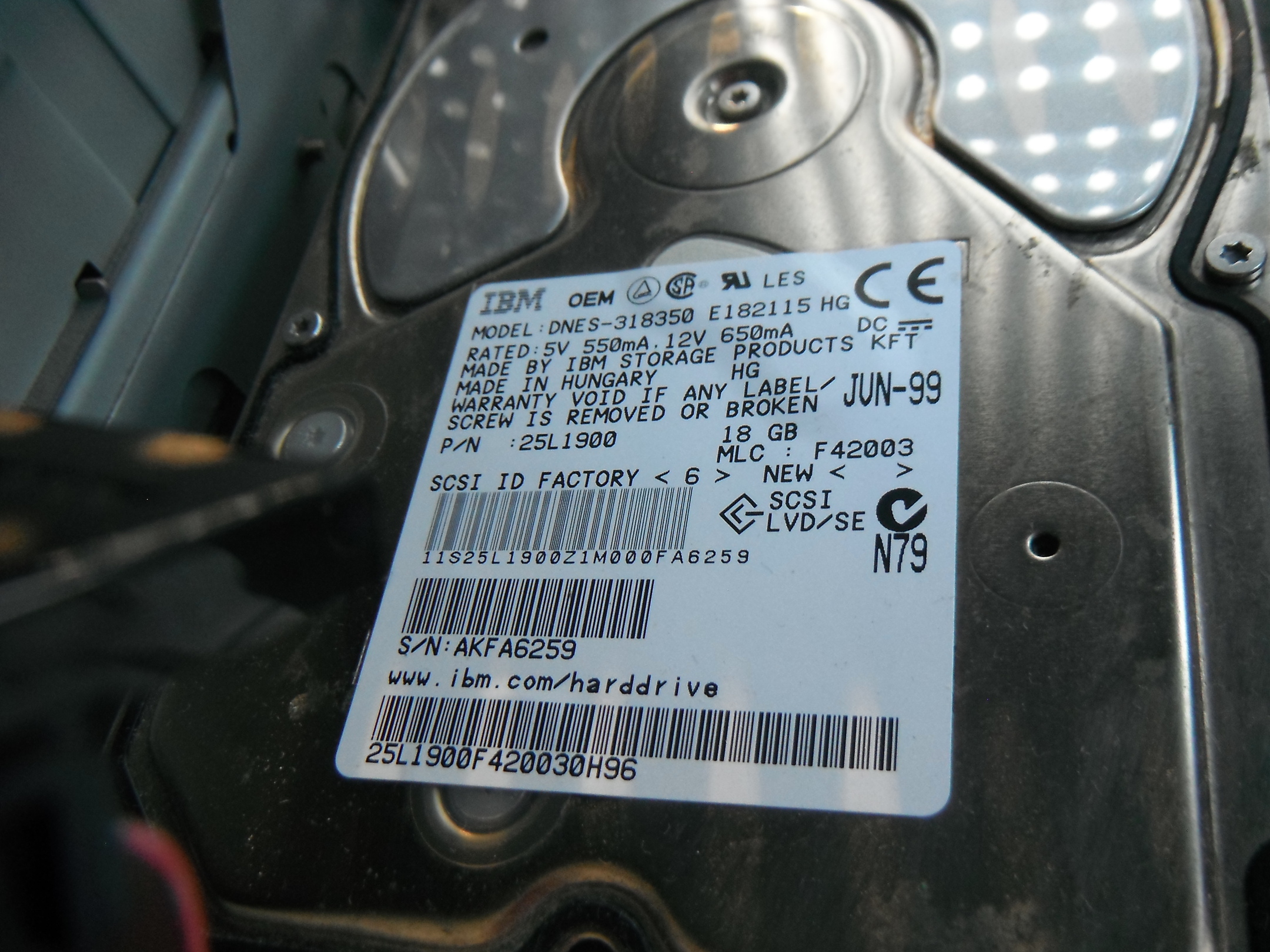

    One of the three SCSI HDDs:

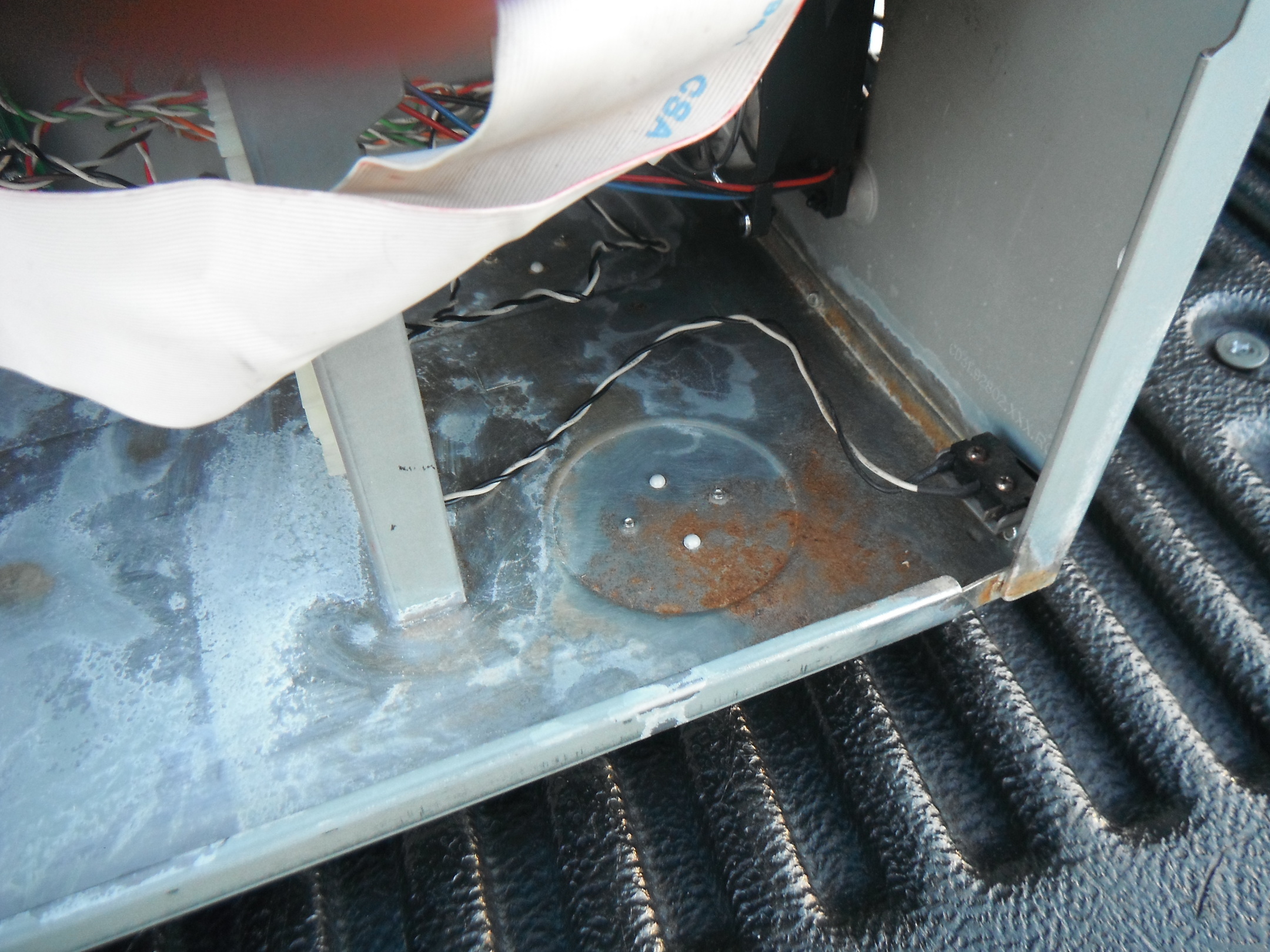

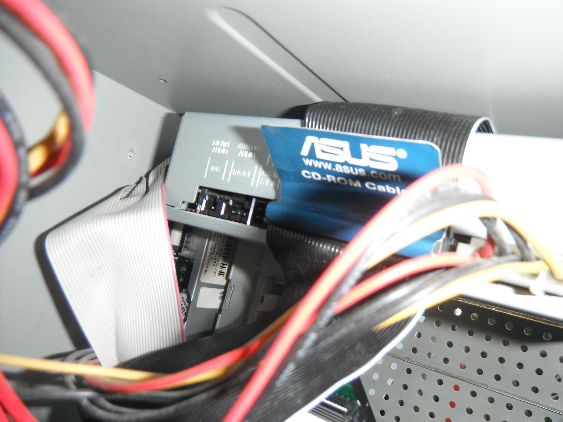

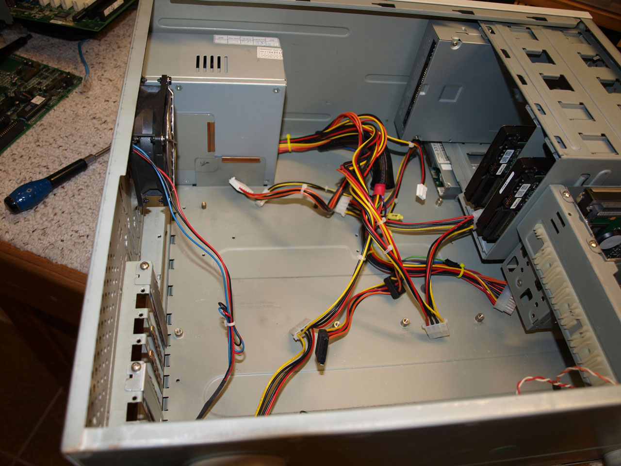

    There has been some "modern" hackery. For example, one of the ATA cables was bundled and went nowhere, and the other was one of these:
    Also, the fans are newer looking 3 pin deltas... but some bozo spliced on 4 pin pigtails. At least they used heatshrink.

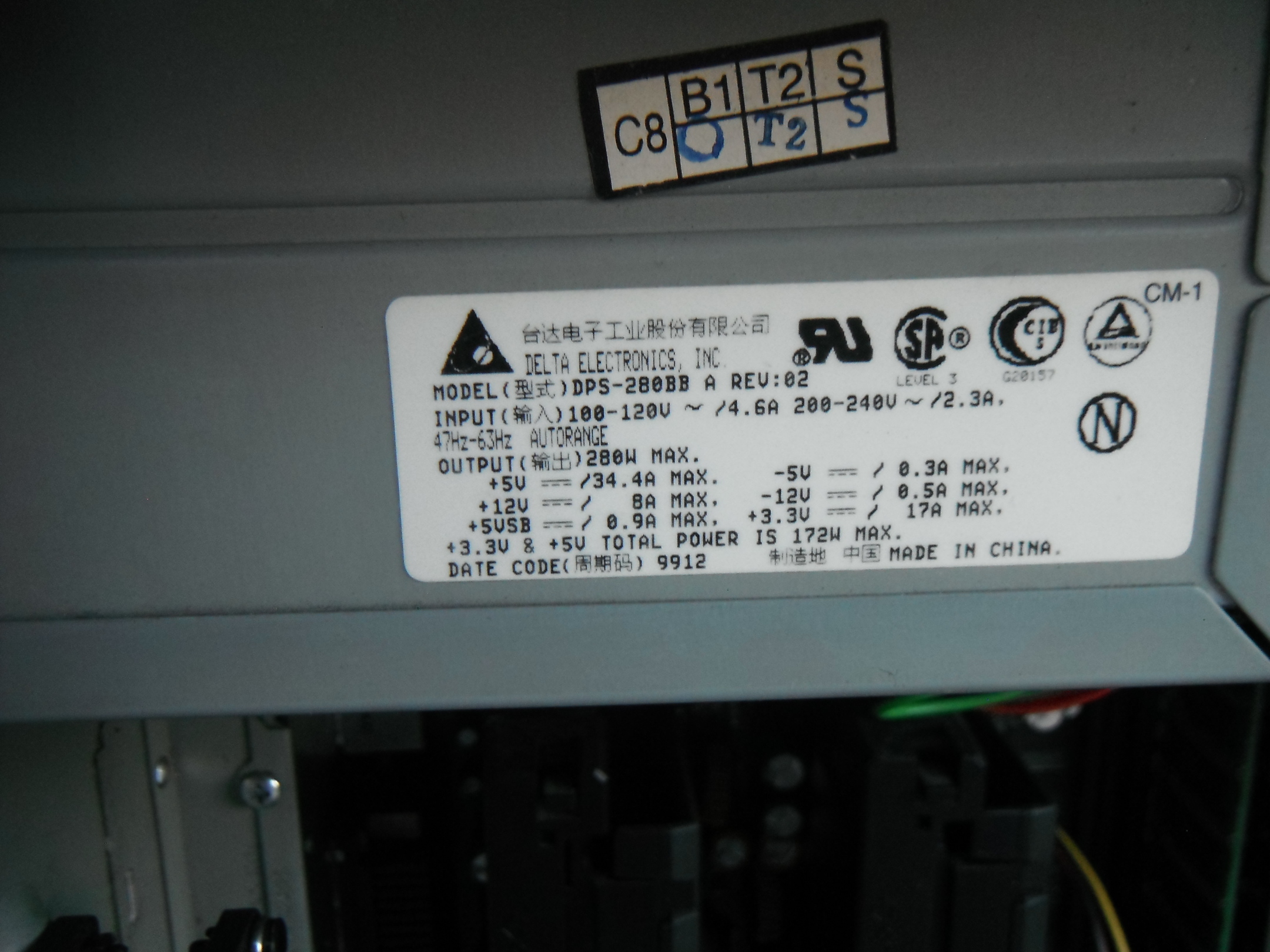

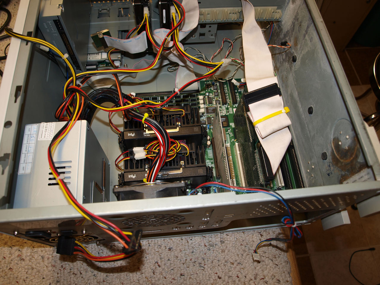

    The PSU is weird. Uses ATX/AT mounting, but the mobo connections are AT with aux plugs:
    The power button is soft-on... the aux plug (presumably) contains the 5VSB and power-on signals.
    Power supply is a nice & beefy (but seemingly dead) Delta 280W:
    The case will fit a full ATX board, provided the front edge is low enough to clear the 5.25 bays.

            The motherboard PSU connectors, look very transition-esque, more like I would expect during Klamath! (first-gen Pentium II)
            I would have thought that by 1999 and later in 1998, it would have been ATX on the motherboard!
            Instead, I see what looks more like I would expect on a 1997 motherboard.

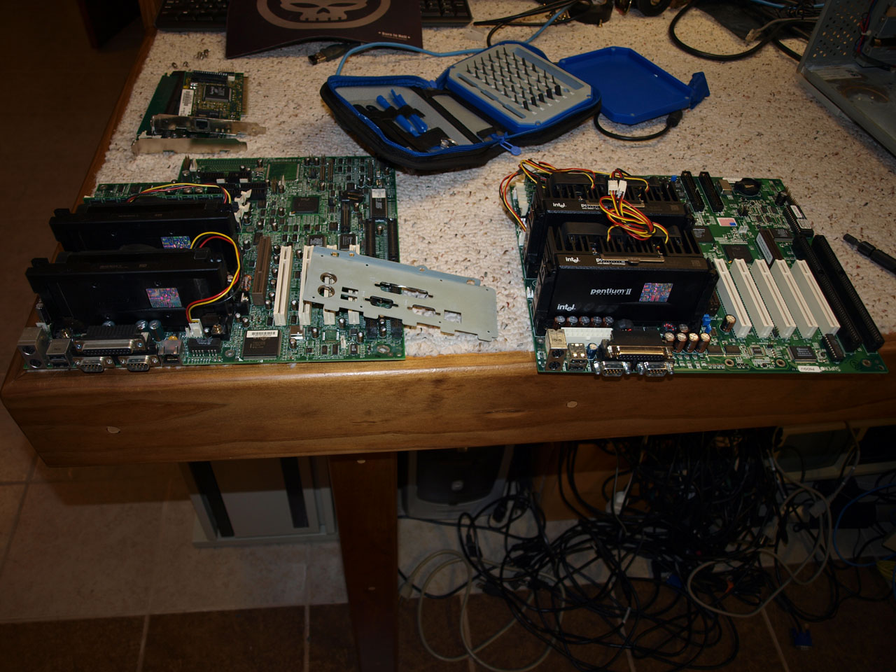

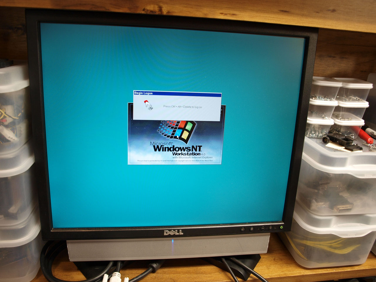

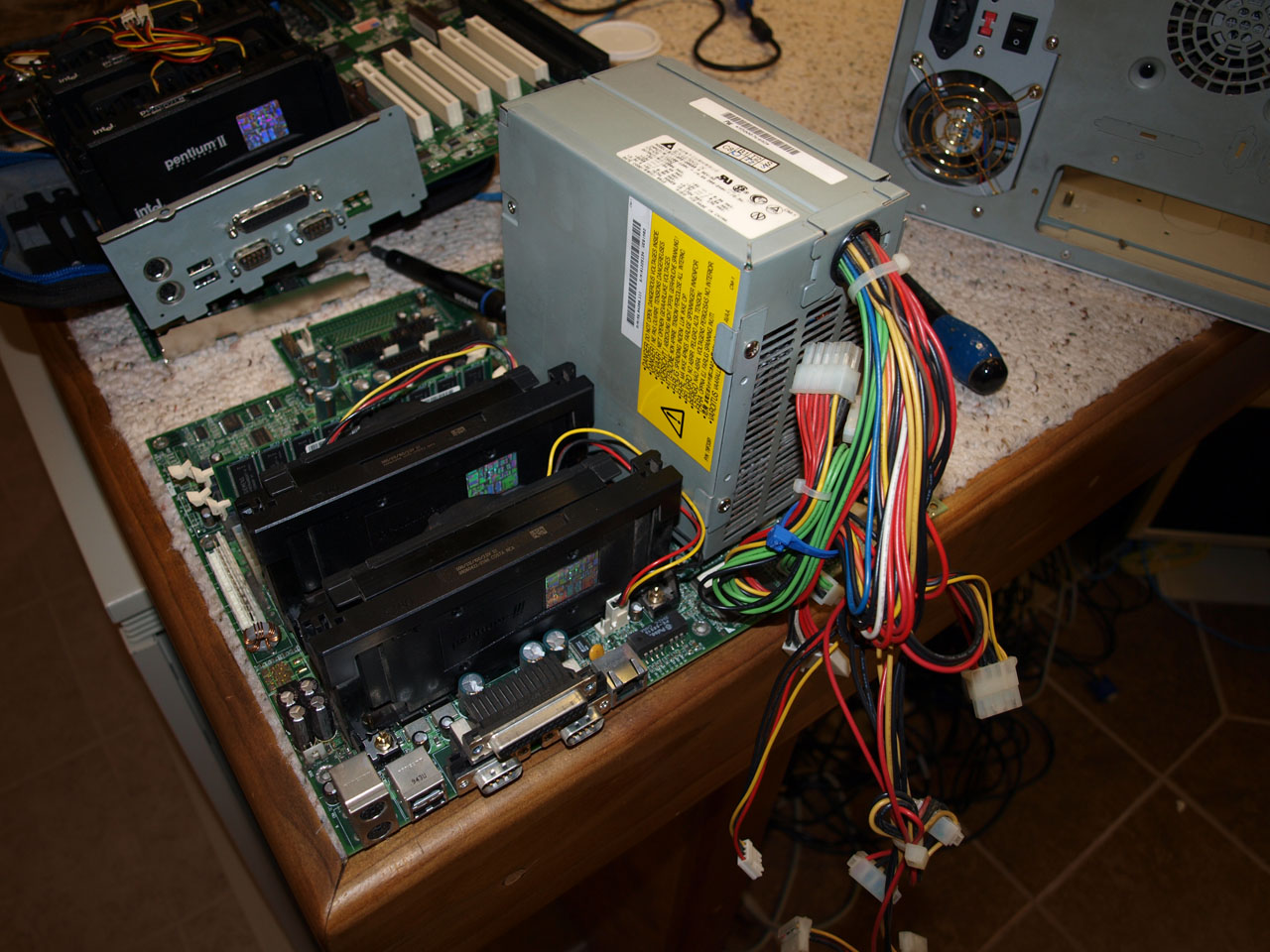

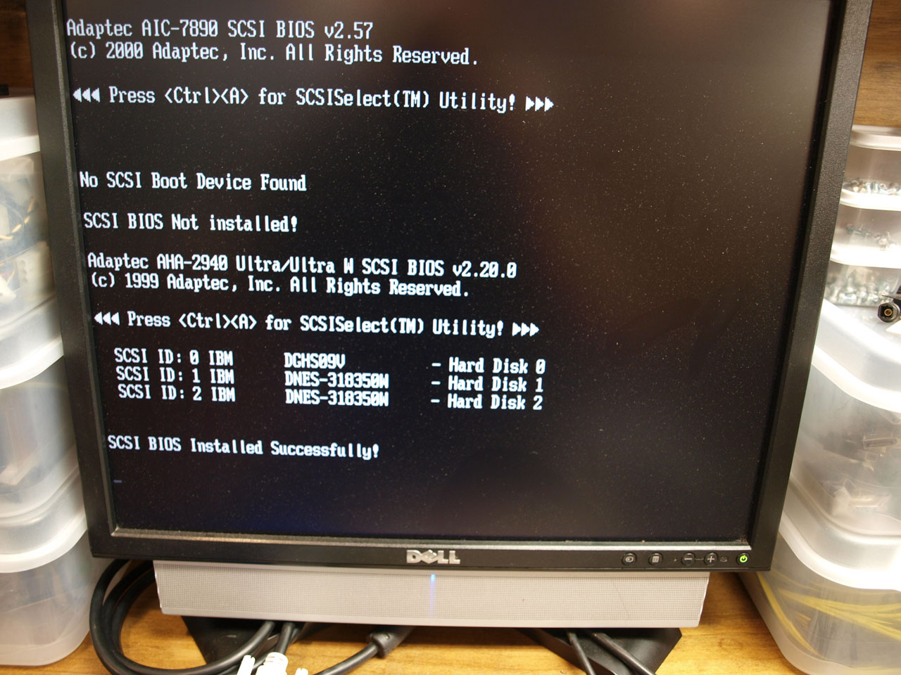

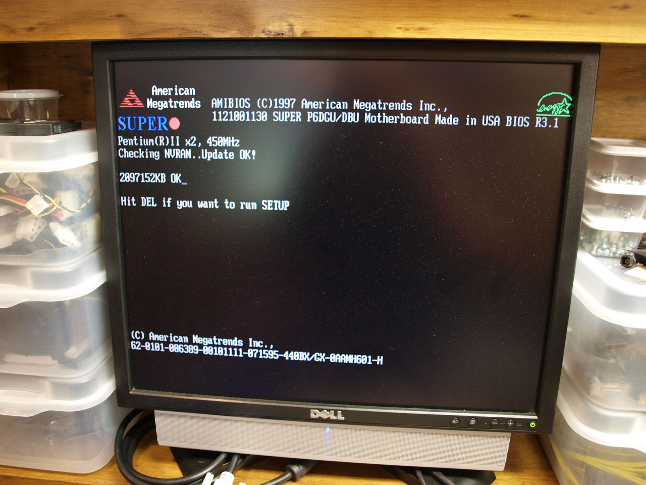

                          More fun to boot from it, and here we go!
                          The original board on the left and a Supermicro P6DGU on the right....nearly identical core hardware.
                          These boards have the same mount points are are the same size.
                          The weird proprietary PSU removed.
                          A freshly recapped PSU that a local shop gave me...
                          Dropped the board in.
                          This is a good start!

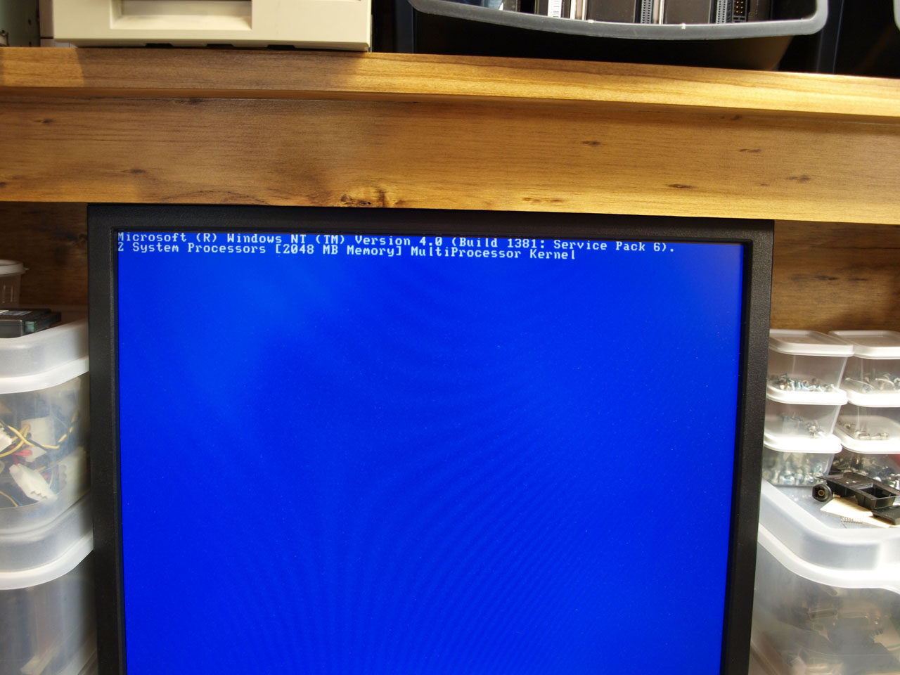

                          All the drives showed up.

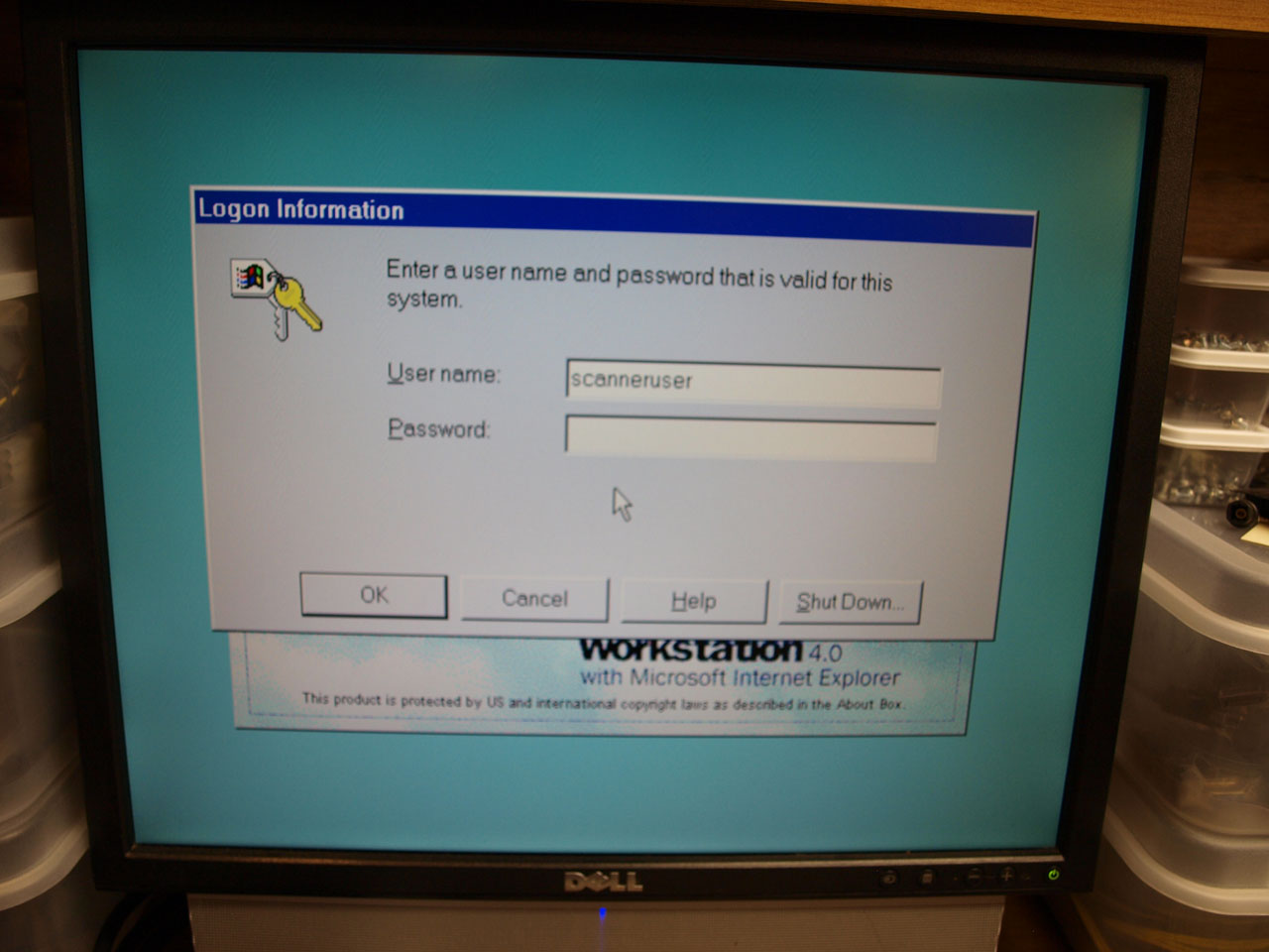

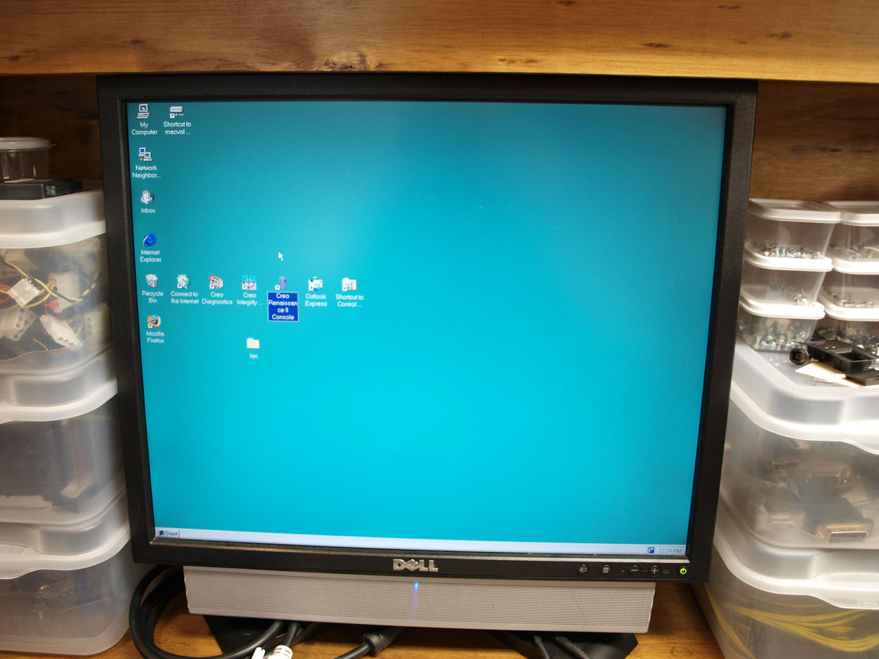

                          ...and here goes NT4 SP6
                          Well fudge....password.

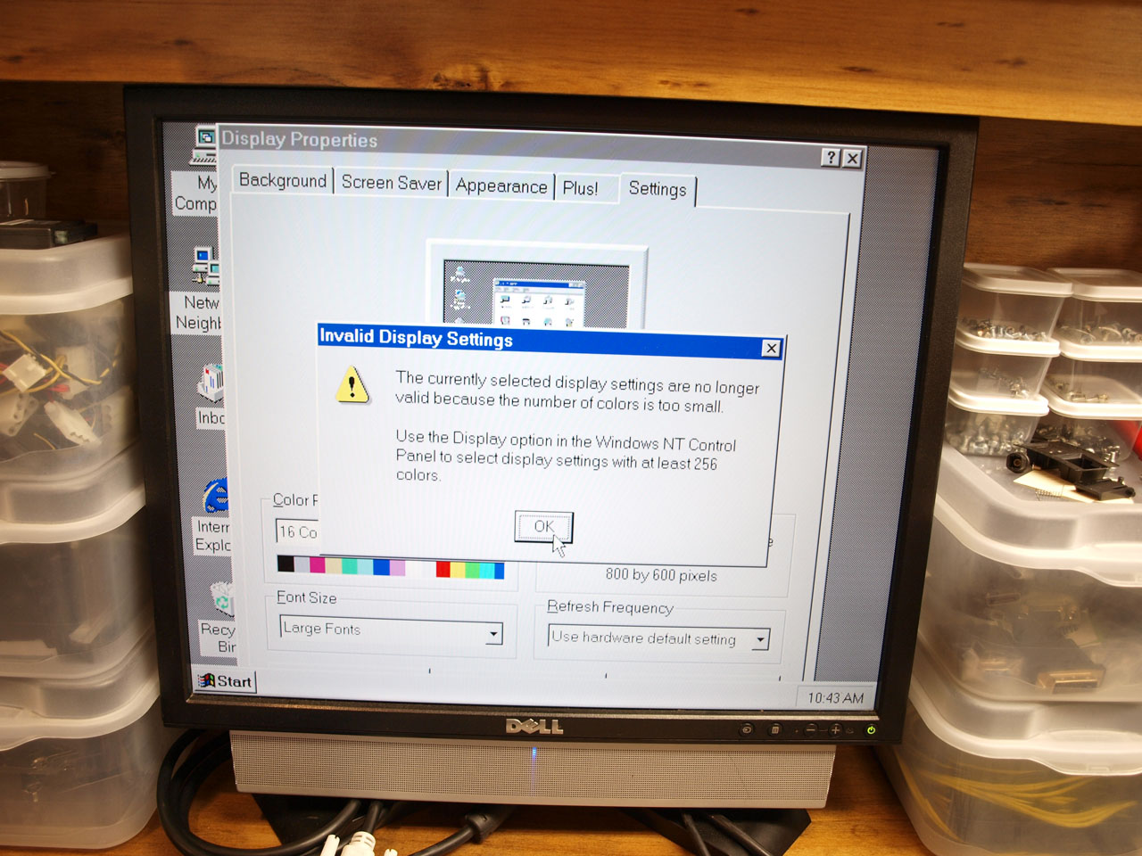

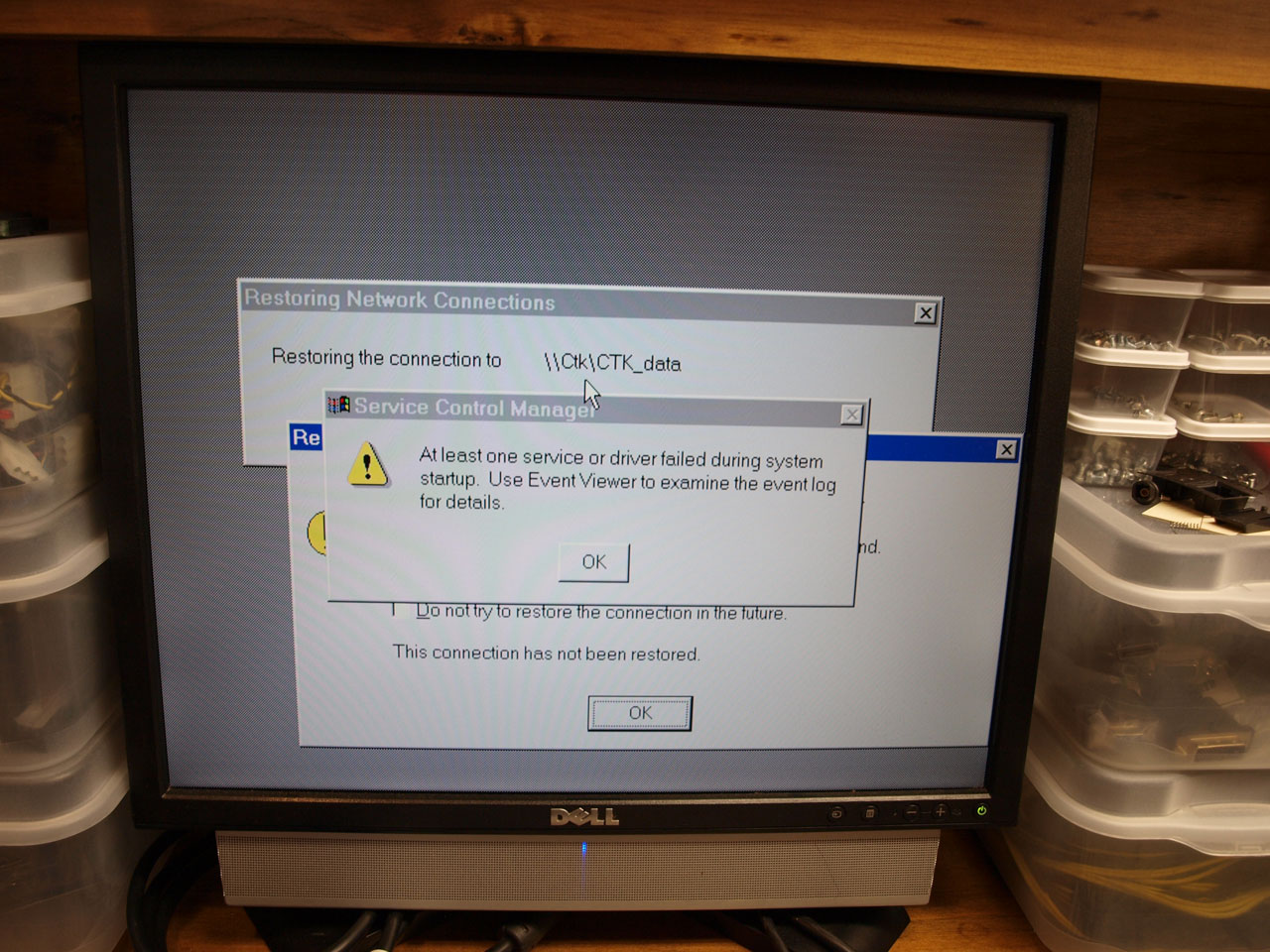

                          I rebooted it off another media and cleared the password. Of course a plethora of errors & unreachable network drive paths.
                          Reconfig'd everything. The old motherboard has an onboard NIC, this one doesn't....so I added one.
                          A few reboots later.....no more errors, in true color, and LAN working.

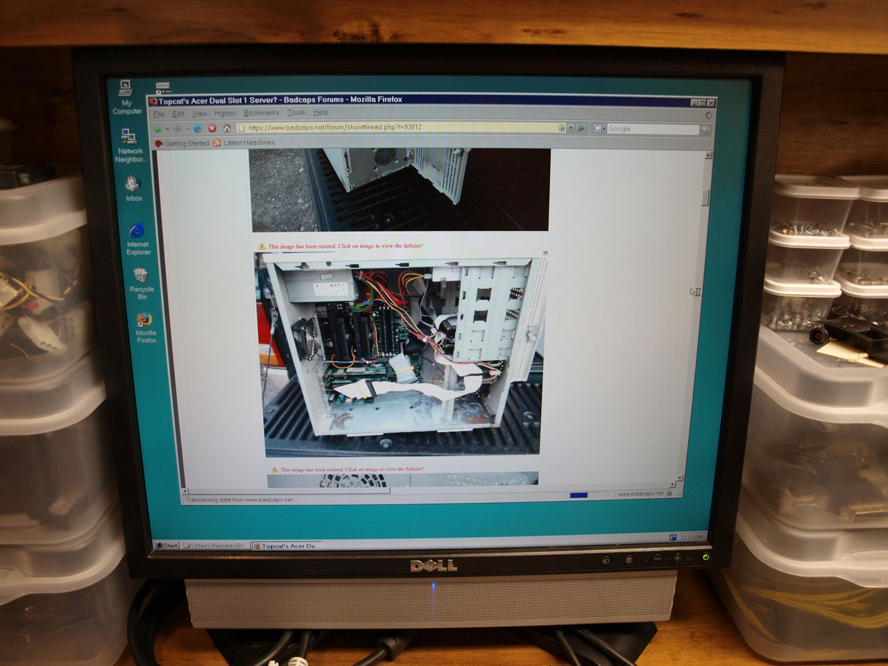

                          ...and like Al Capone's vault, there really wasn't anything to see. This thing was apparently a scan/print server. All data that it handled was stored on one of the network drives, there's nothing really on this machine except the software for some old world legacy scanner.
                          So I tossed FF2.0.0.2 on it and yay, BCN!
                          The upside, all the drives were checked & verified good, 2x 18gb and 1x 9gb. The 2x 18gb HDD's are in some kind of software RAID, NT shows it as a 36gb volume in disk manager; as a stripe array. Not sure how that was accomplished; as the controller doesn't support any kind of RAID functions whatsoever....so if NT4 supported soft RAID's, I never knew that....so I suppose I did learn something.
                          I still haven't solidified what I'll do with this thing.....but this case is screaming out to be a mega sleeper system!

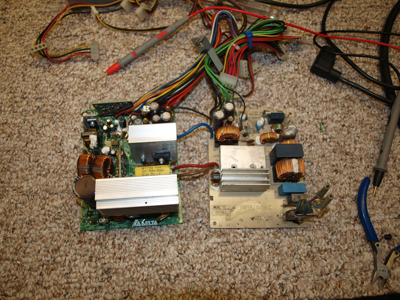

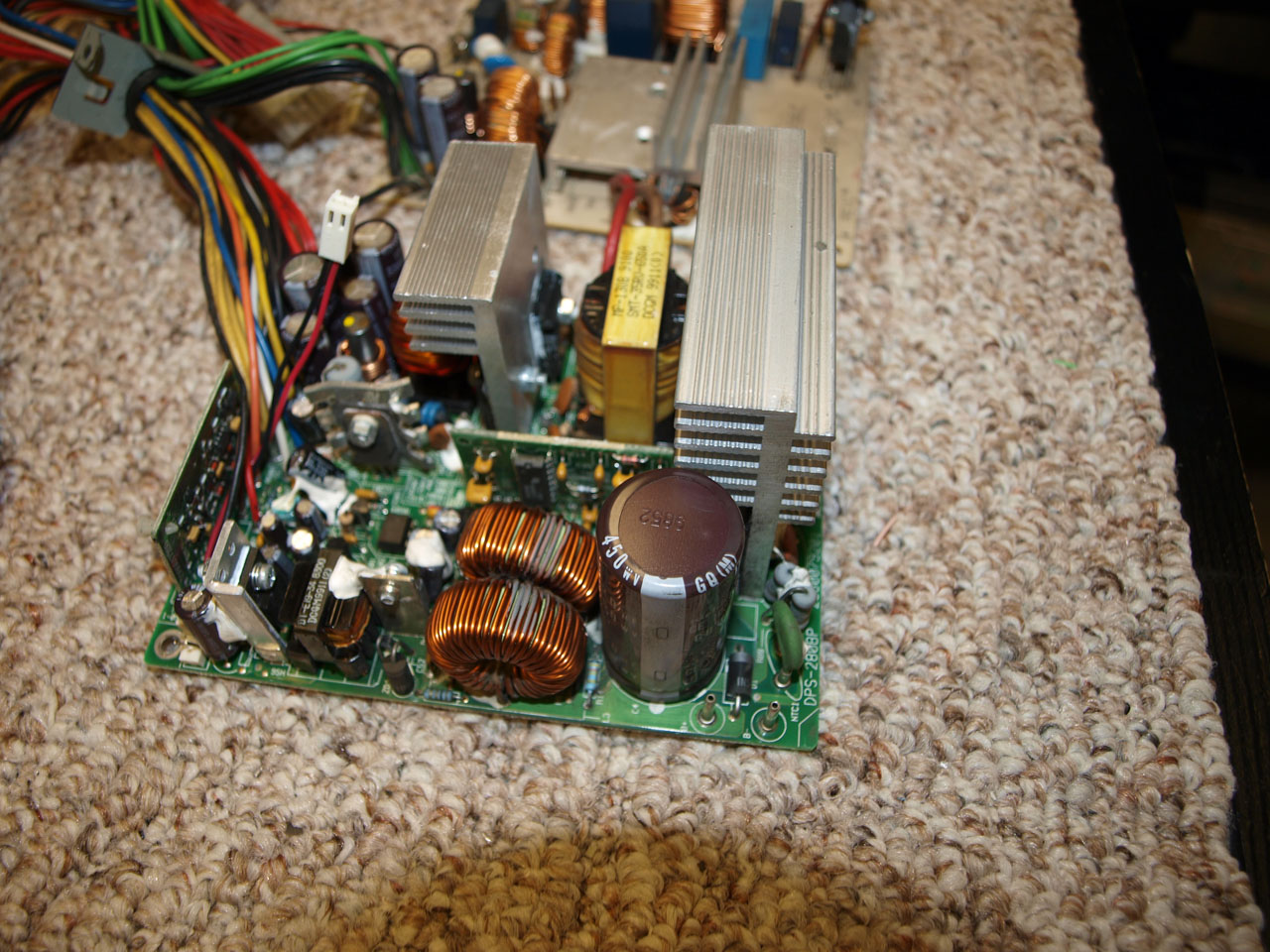

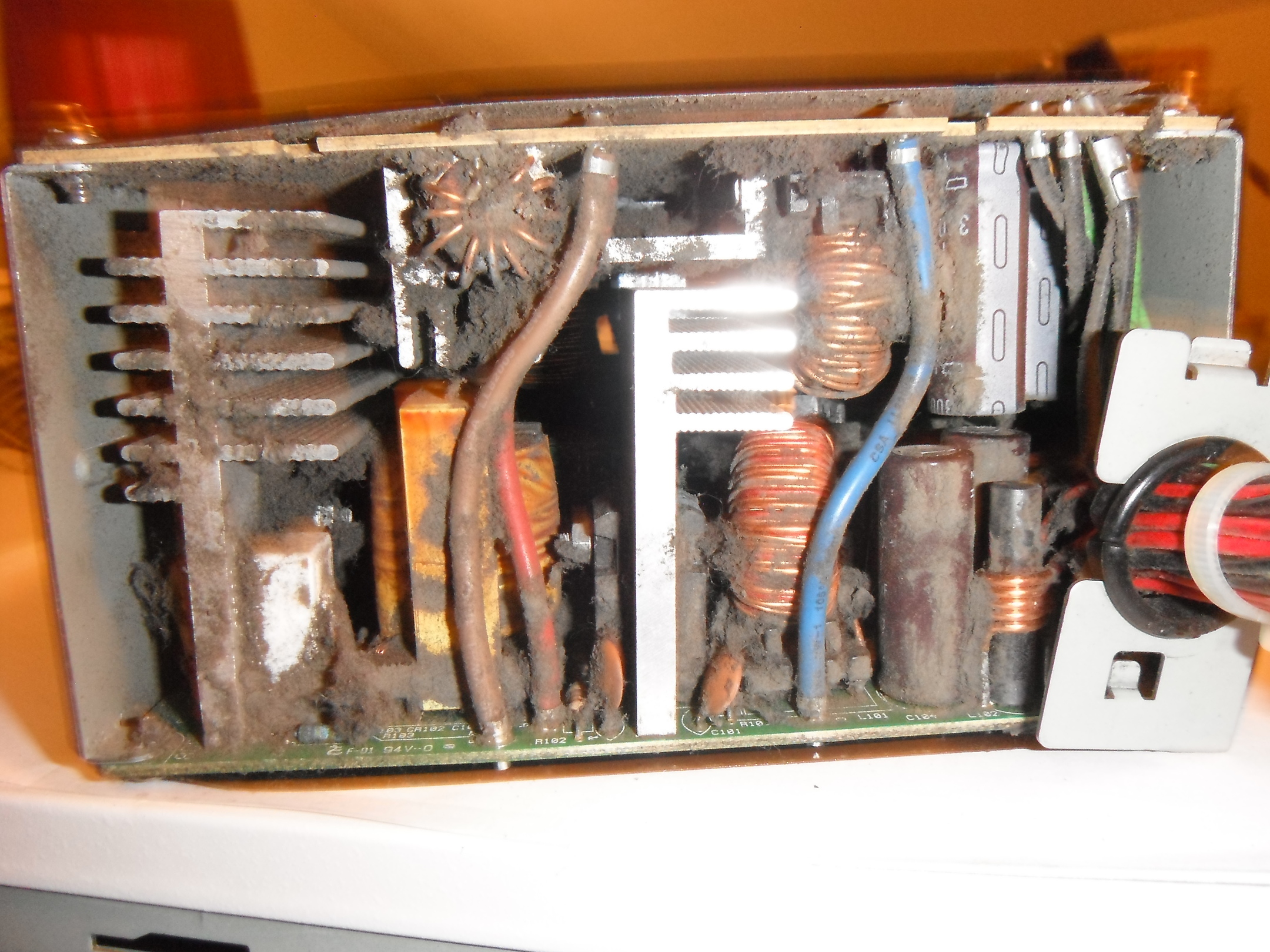

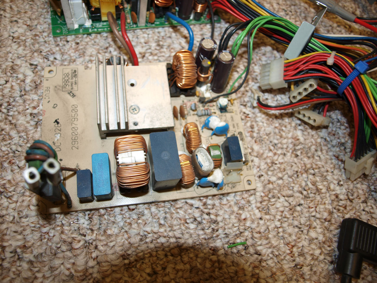

                            I'm still not 100% sure the motherboard is bad. The power supply powers up, has voltage in the primary (AT side is fed by DC voltage from the ATX side; read 107vdc)...but information on this PSU (Delta DPS-280bb Rev 2) is pretty much nill; such as pinouts, standby voltages, schematics, etc..... I have no idea what triggers it, it may be the issue, not the motherboard. I fired the board with an AT power supply, it did power up but did not POST, which is what led me to conclude the board was bad....but that may not be correct.
                            Here's a few pics of the PSU inside:
                            There is no voltages present on any of the PSU output pins.... Nothing was jumping out at me as being faulty. Logic tells me that the green wires in the smaller ATX connector would/should have a +5v STBY voltage, as that's the color code for this voltage on a normal ATX PSU, however there's nothing present. Yes, I did try it with a good CMOS battery in it; there were some systems from the days of yore that the CMOS battery provided the startup voltage until the PSU fired off and took over....but it wasn't the case here...so odds are this PSU is the issue and the board is good....
                                      Many power supplies have written text on the PCB showing what the wires are for, did you check for that?
                                      • Topcat
                                        The Boss Stooge
                                        • Oct 2003
                                        • 16959
                                        Re: Topcat's Acer Dual Slot 1 Server? - The Acer Altos 1100
                                        That would have been too easy.... Nothing of the sort on this one.
