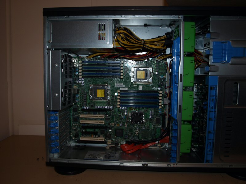

HMMM....What could this be.... ;) TC's first X8DAi Build!

865W. I opted to not get the dual redundant, as it's not as powerful. For a personal system, a redundant PSU isn't as crucial. If this were a server, I'd have gone for the redundant, absolutely.
This is the specs on the case/motherboard.
http://supermicro.com/products/syste...YS-7046A-T.cfm
I won't be using the onboard SATA RAID. I'll be using the SATA backplane with a 3ware 9650SE-8LPML 8-Port RAID Controller. The only true hardware driven SATA raid controller in existence. It will also allow me to use all 8 bays, instead of 5~6 if I use the onboard. This is the FIRST system i've built for myself since 1995 that wasn't SCSI.<--- Badcaps.net Founder

Here's the CPU's (pair of them of course):
http://www.newegg.com/Product/Produc...82E16819117185
Here's the RAM I got to start. I ordered 2 of these kits (6x 4gb reg/ECC DDR3 DIMM's). This gives me 24gb of RAM, and leaves half the slots open, so I can add 24gb more later.......
http://www.newegg.com/Product/Produc...82E16820161337
Hard drives will be:
2x 150gb Raptors in a mirror (boot and OS)
2x 1tb in a mirror for all my other crap.
The cost breakdown:
The supermicro barebones = $900 or so
CPU's = $800 or so for the pair
24gb of RAM = $790 or so
3ware 8ch SATA2 raid controller w/ backup module and batt = $600 or so
hard drives = $500 or so
video card (9600GT 1gb) = $200 IIRC
Opticals = dont remember how much they were.
Total cost = $3790 roundabout.....wowza...
Yea I know.... I overkill the hell out of my personal systems. The one I'm about to phase out was the same way 7 years ago, and now its old and slow. I'd rather have the horsepower and not need it, than need it and not have it. On top of that, I'll be using this thing for atleast 7~8 years.....and being my personal system, I don't want to mess with it. I just want to use it when I want/need it. I dont mind fixing other people's crap systems, but I absolutely can not stand fixing my own broken stuff...so overkill it is!!<--- Badcaps.net Founder
