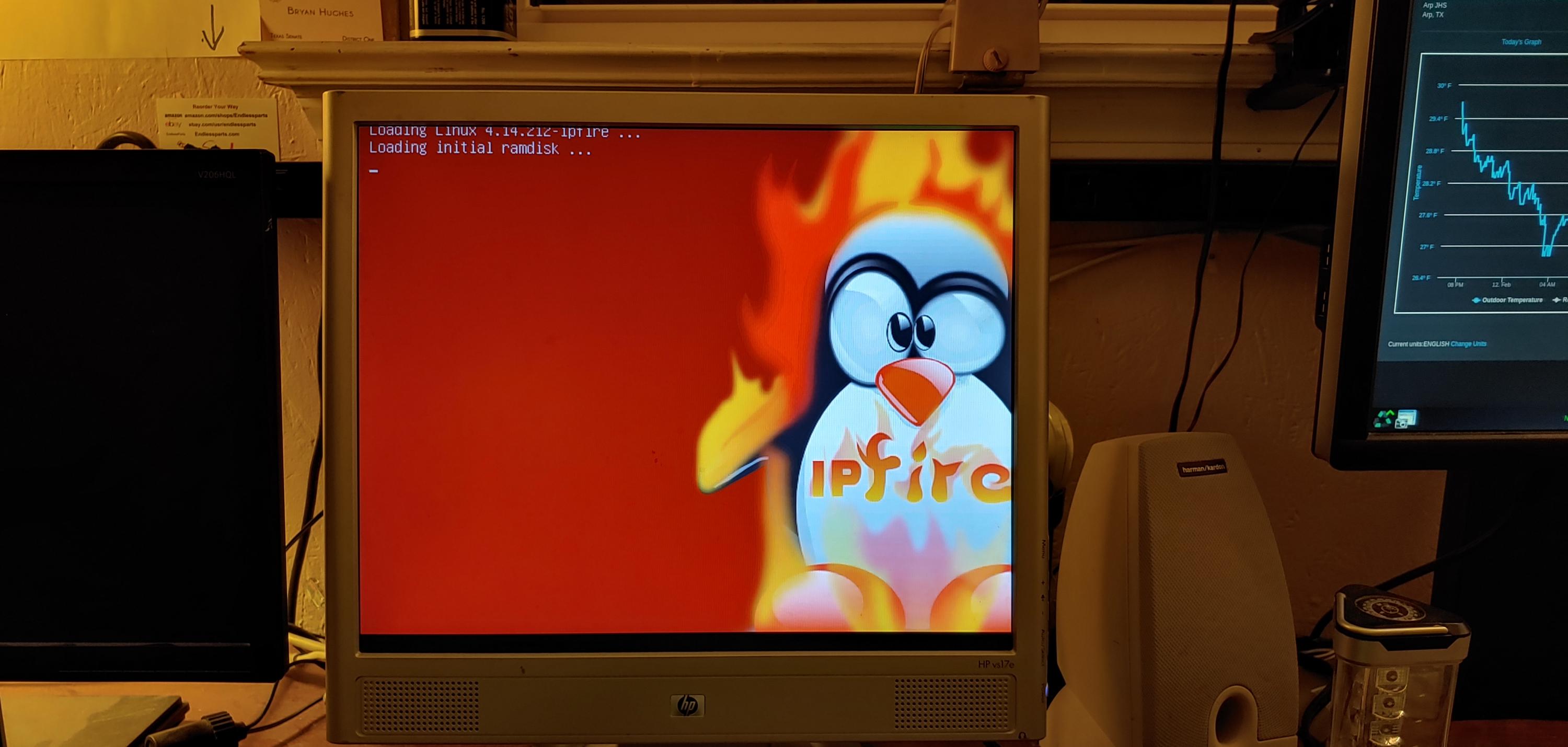

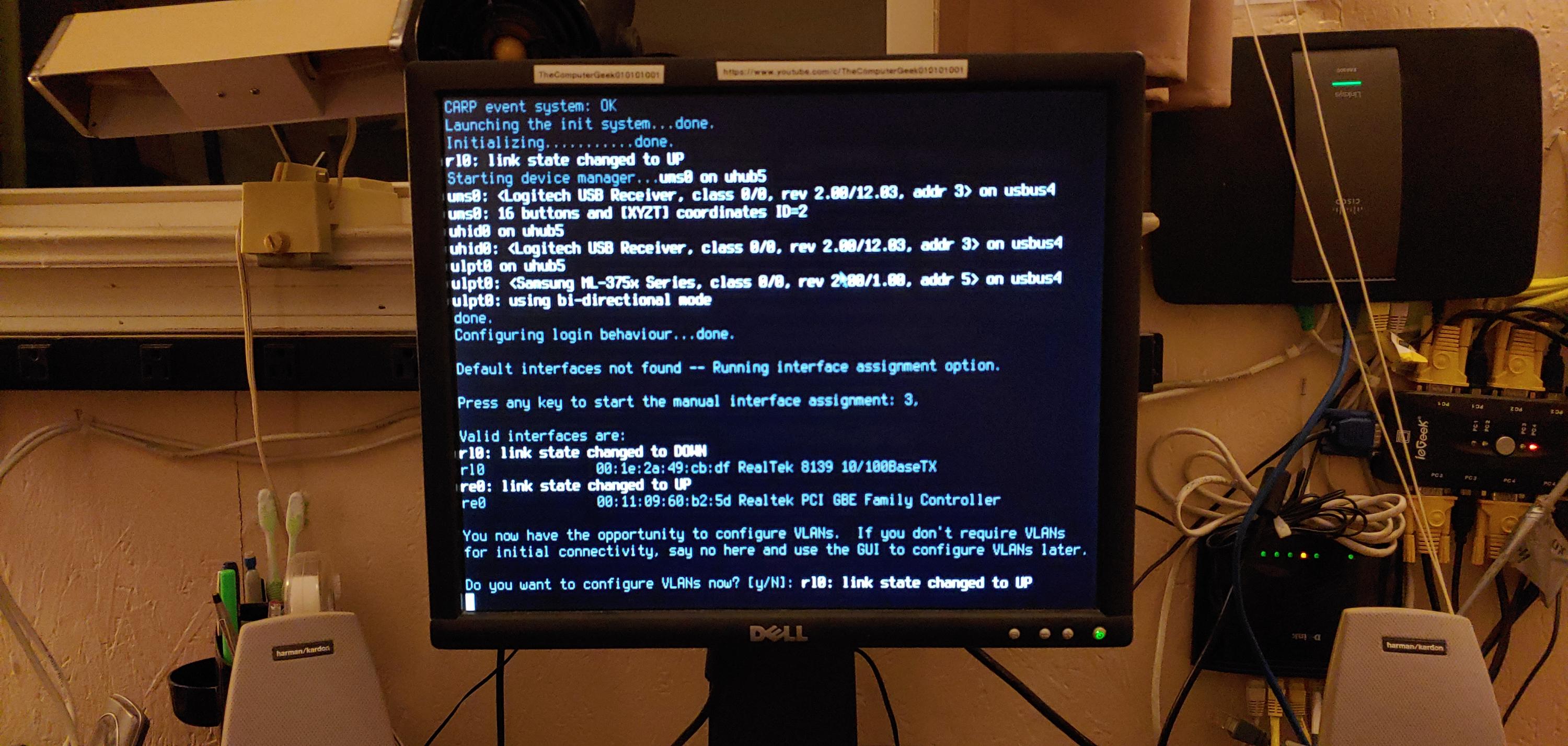

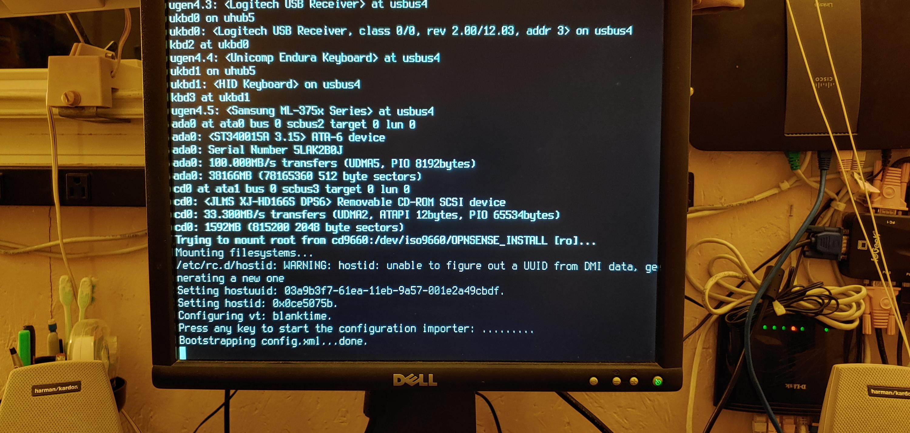

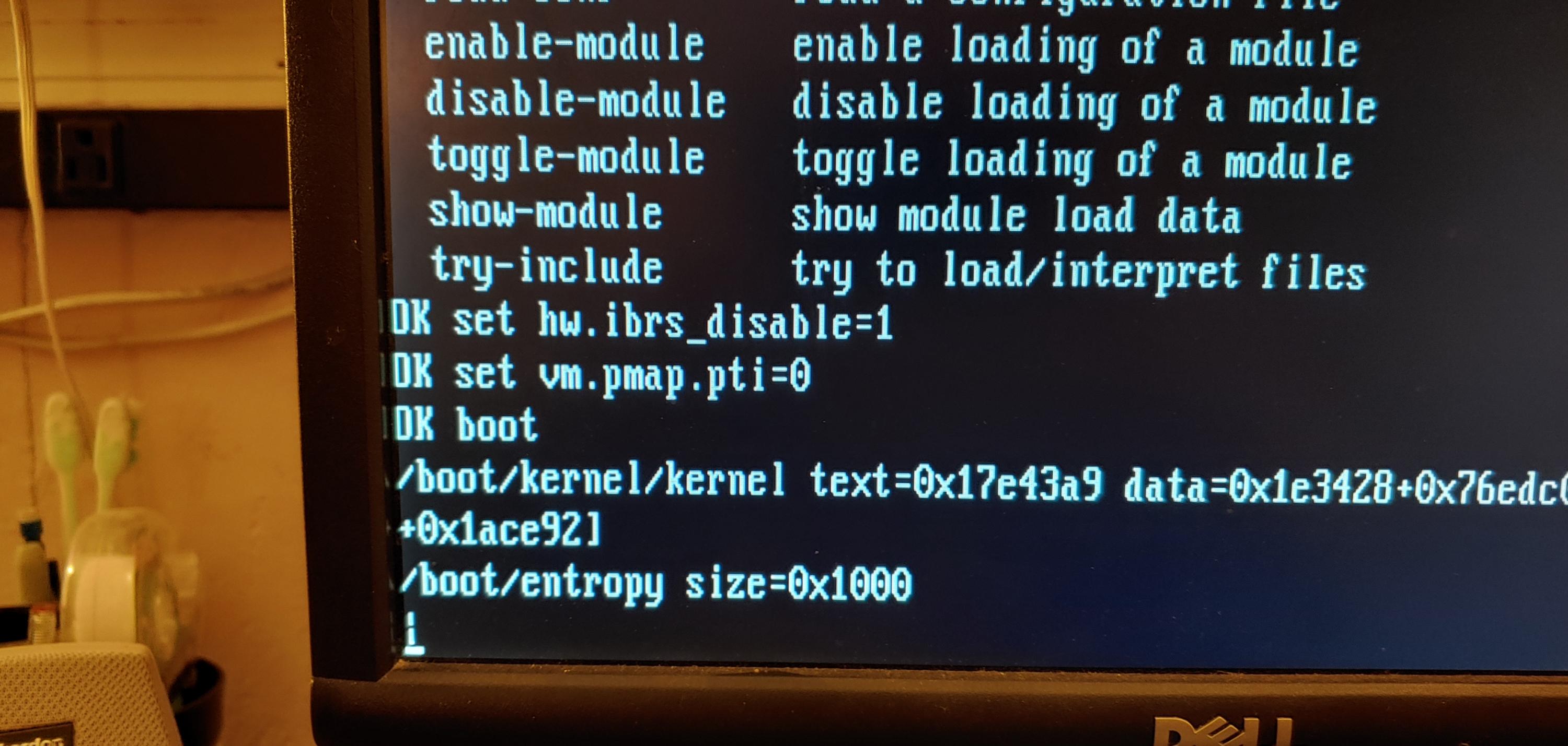

        A little bit more progress on the system yesterday. Trying to write the ISO to a flash drive was a complete failure. Never booted. So I had to break out the trusty old optical disc to get it to boot. Which is where that old, ragged-looking IDE ODD came in handy again.
        Hey, it's trying to boot!
        But it would kernel panic when trying to mount root. Some Googling determined that is was because KPTI (Kernel Page Tables Isolation) didn't know what the CPU was (likely because it's nearly 17 years old) and intentionally shut the kernel down.
        So I had to set a couple of kernel options. I couldn't do it via a USB keyboard as CD Loader doesn't initialize USB drivers this early in the boot process. Cue the trusty Model M:
        PS/2 works yet again. Let's try this:
        Disabling KPTI works like a charm on this old CPU.

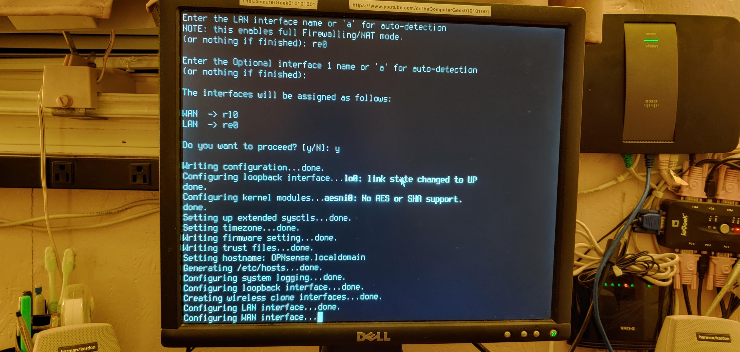

        I messed up the WAN/LAN assignments and tried to ^C/^D out of it. The system did nothing for about 30 seconds before crapping all over itself and rebooting. The screen scrolled with text for 10 seconds before abruptly resetting. Oh well, we'll try this again later.

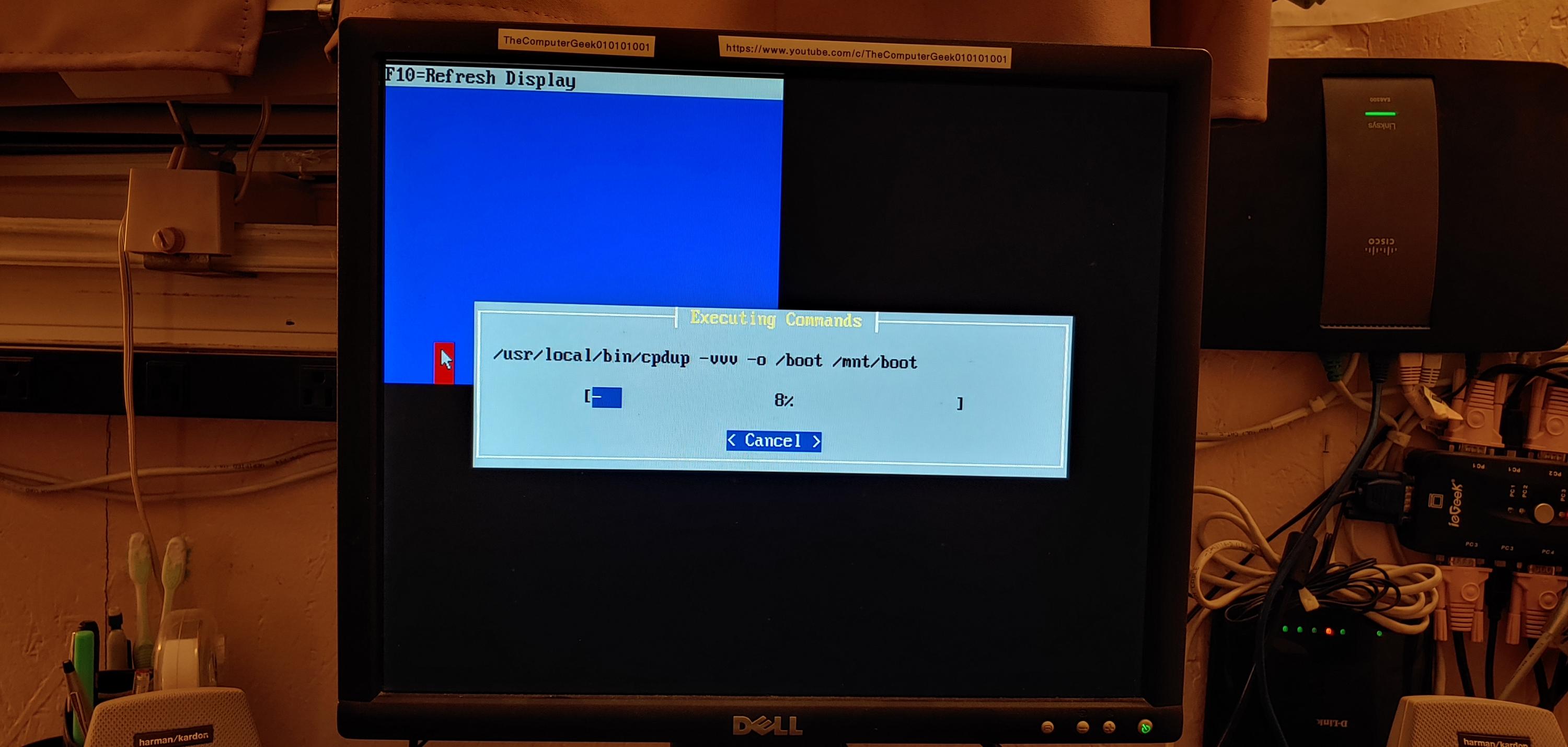

          Re: Repurposing a 2004 Athlon 64 system in 2021
          Got a little farther this time around. Hopefully we'll make it through the installation and be able to boot into a working system later today.
          LAN/WAN interfaces assigned correctly.
          12 minutes later... booted up and ready for installation.
          Installing.
          There's one thing that just simply cannot be conveyed through pictures. That's waiting on this system to boot or install. Booting took what felt like about 20 minutes from the time I typed 'boot' and pressed Enter to the time I got a login screen. The installation has been running for close to an hour so far with plenty left to go.
          Is this just my system or is it a characteristic of FreeBSD?

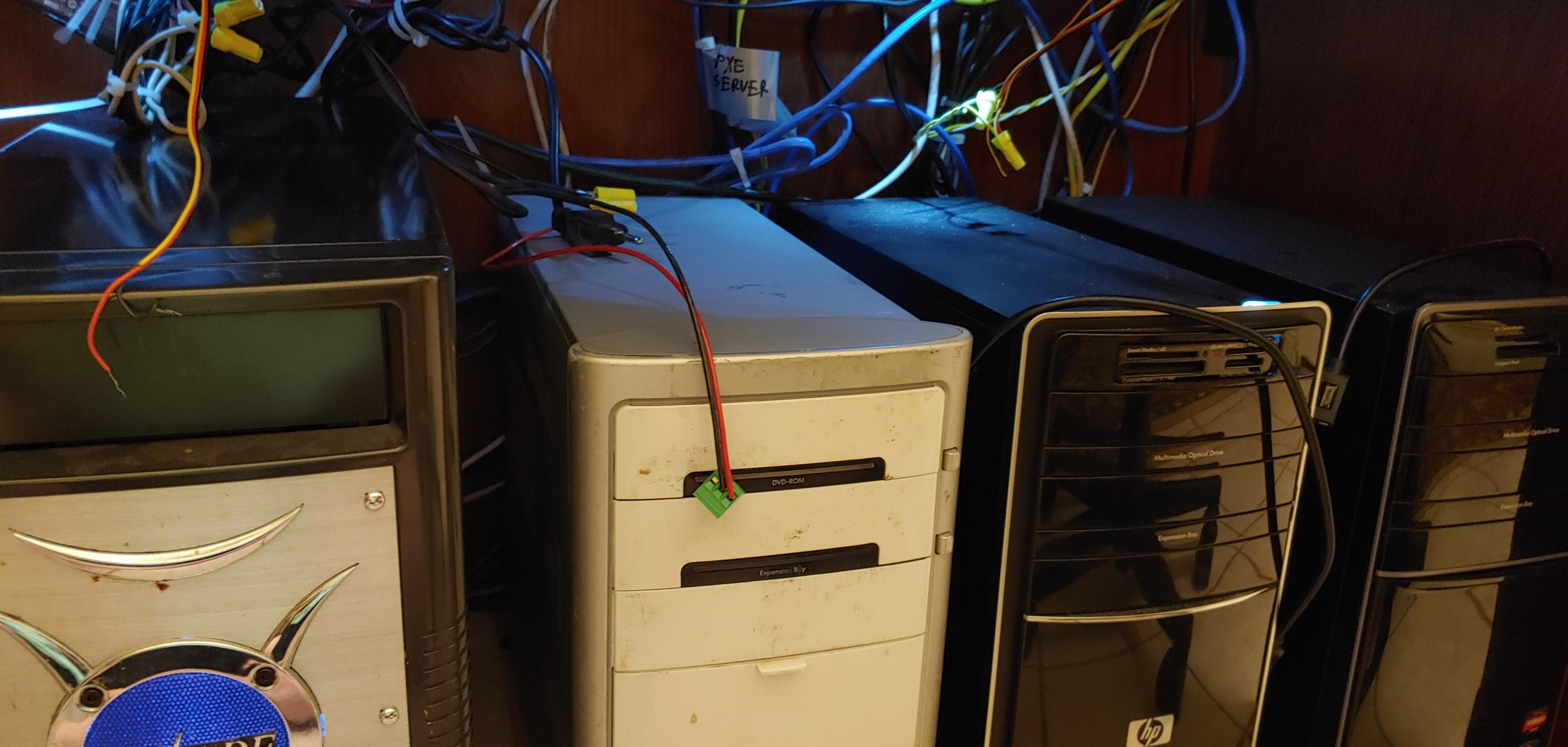

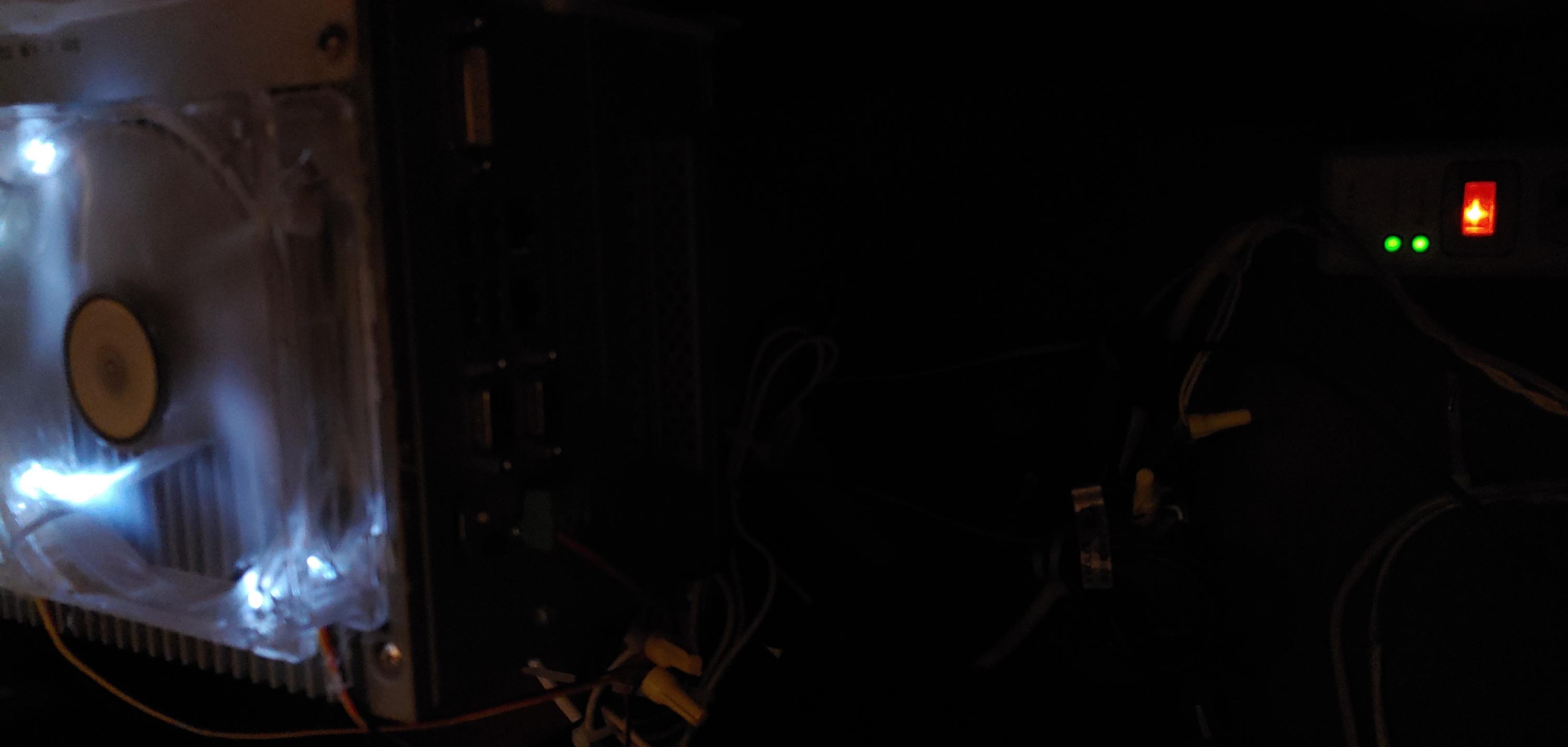

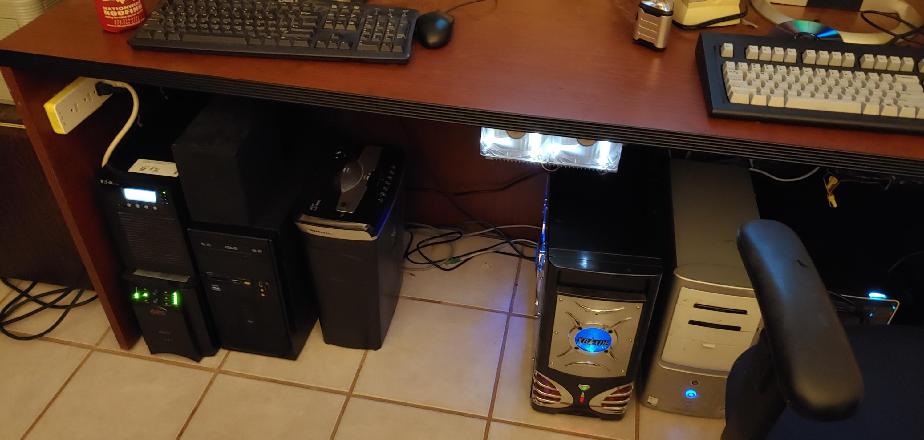

                  Been a little bit since I posted an update here. Been busy configuring the firewall system and getting it settled into it's new place, plus a surprise score. Cue inline pictures.
                  System in it's cubby hole.
                  New UPS, stacked on top of the APC Smart-UPS 1000.
                  UPS has the firewall system and the home network stack on it. Ooo, a real display!
                  Old firewall system still cold and dark. Will likely power it up one last time to DBAN it's HDD and MemTest the RAM to make sure it's still viable. Will likely pick it apart after that.

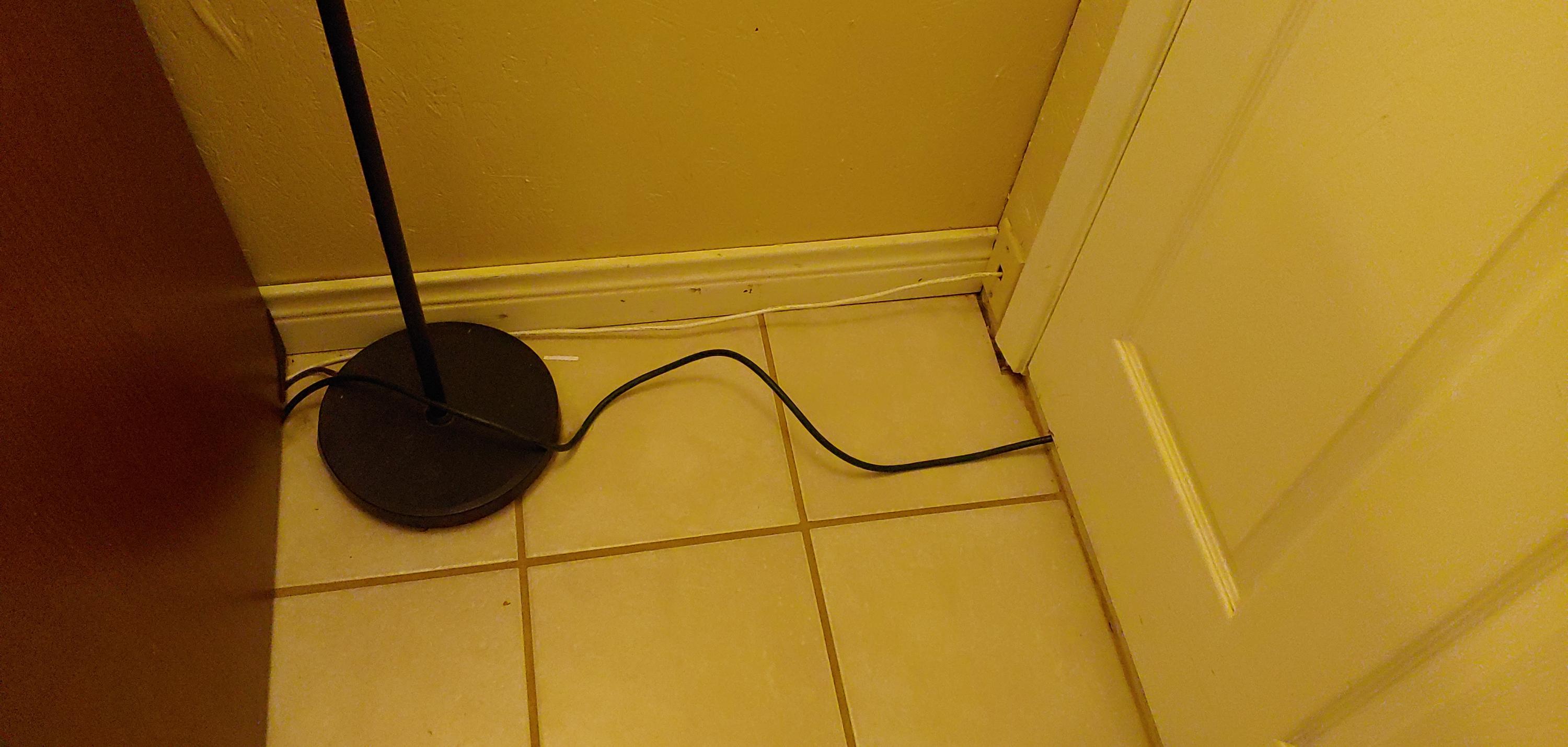

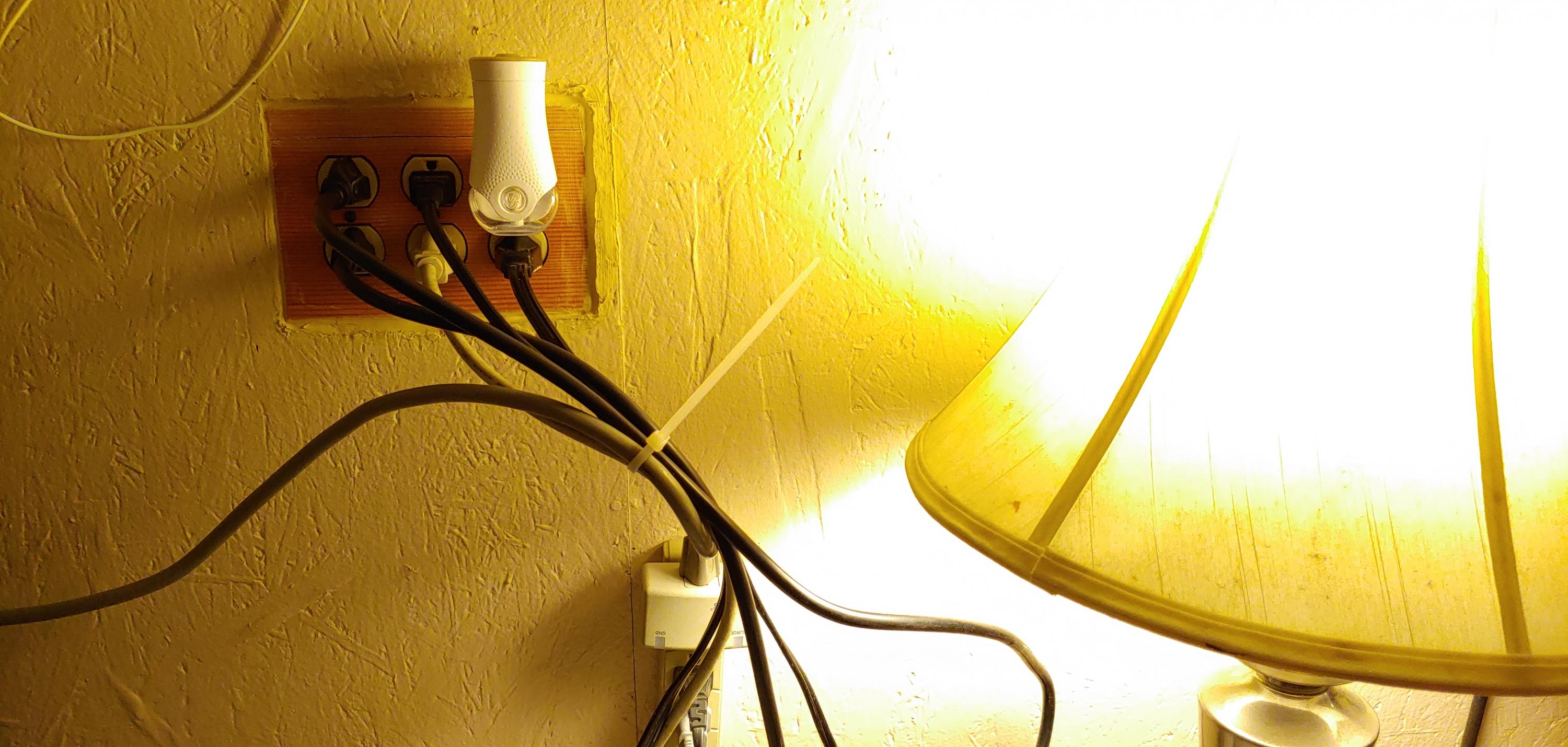

                  Extension cord to network/utility closet:
                  Network stuff:
                  Hey, cable management!

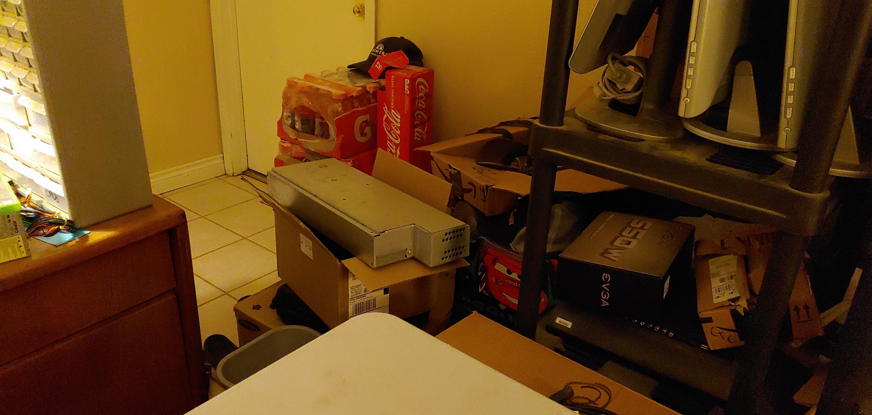

                  Stripped out carcass of the donor battery pack used to keep the Eaton Powerware 9130 alive. Detailed in the next post, which should be tomorrow morning.

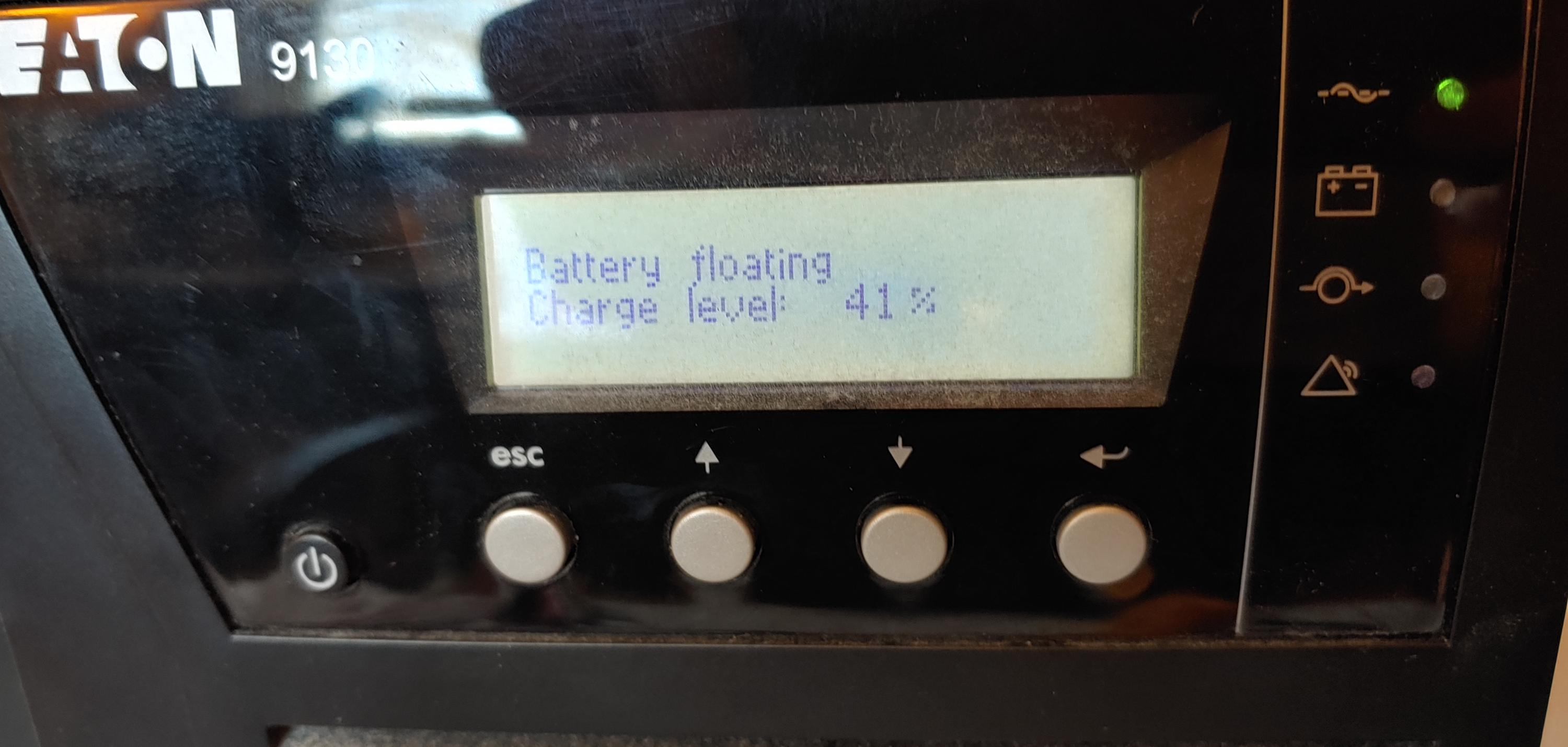

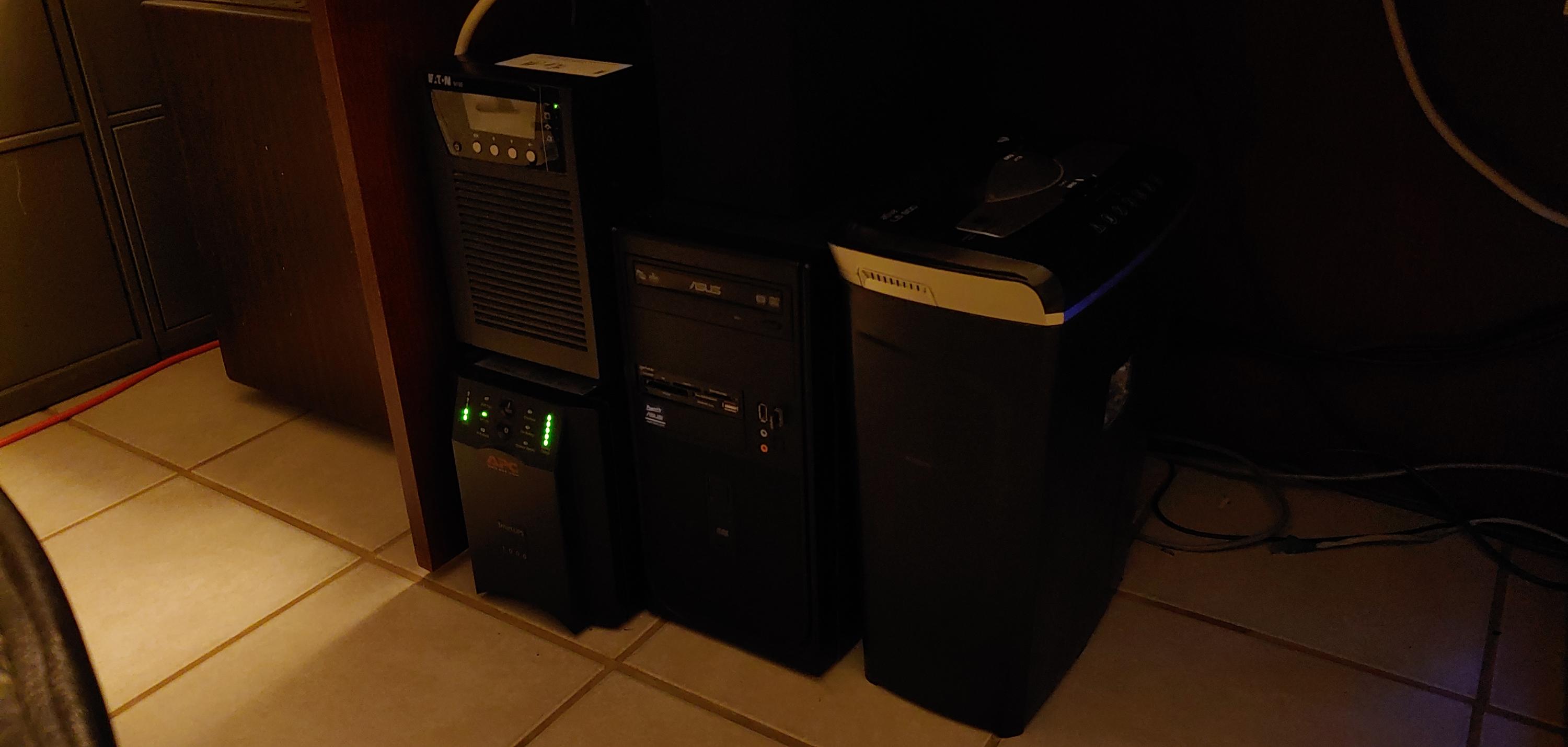

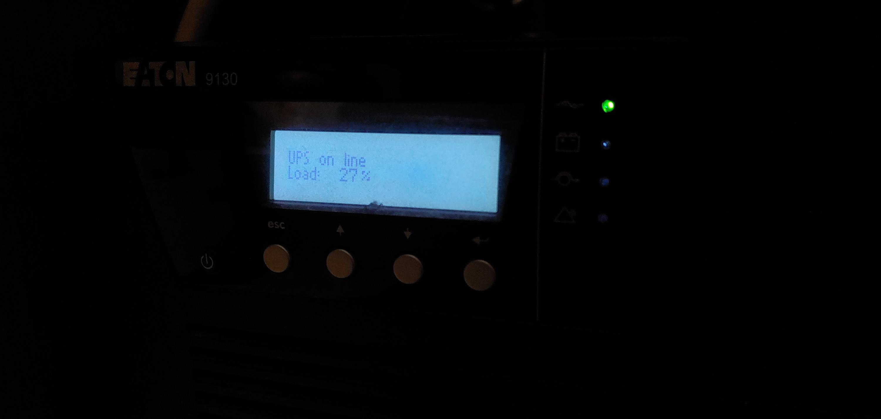

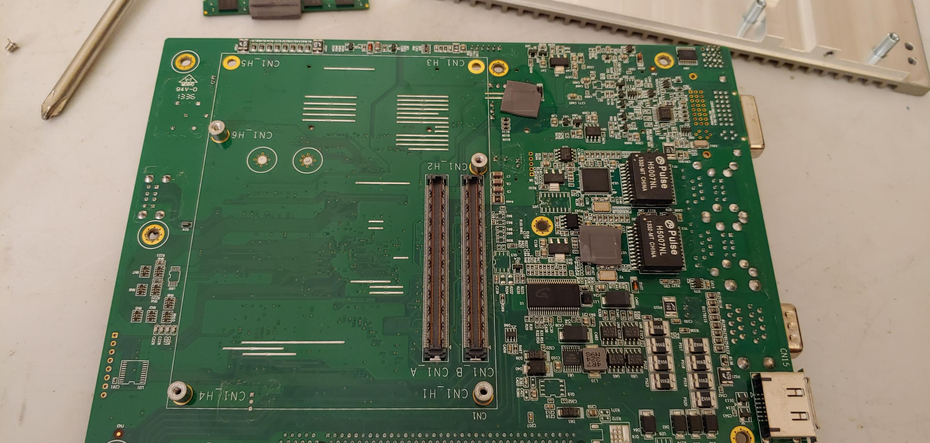

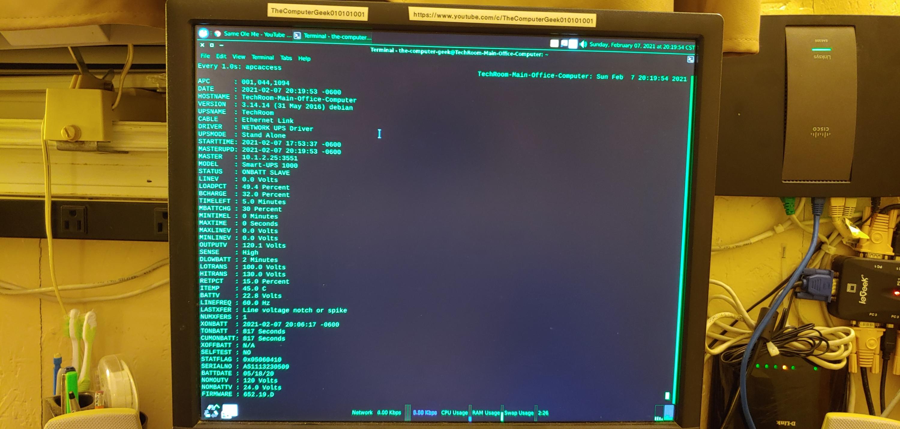

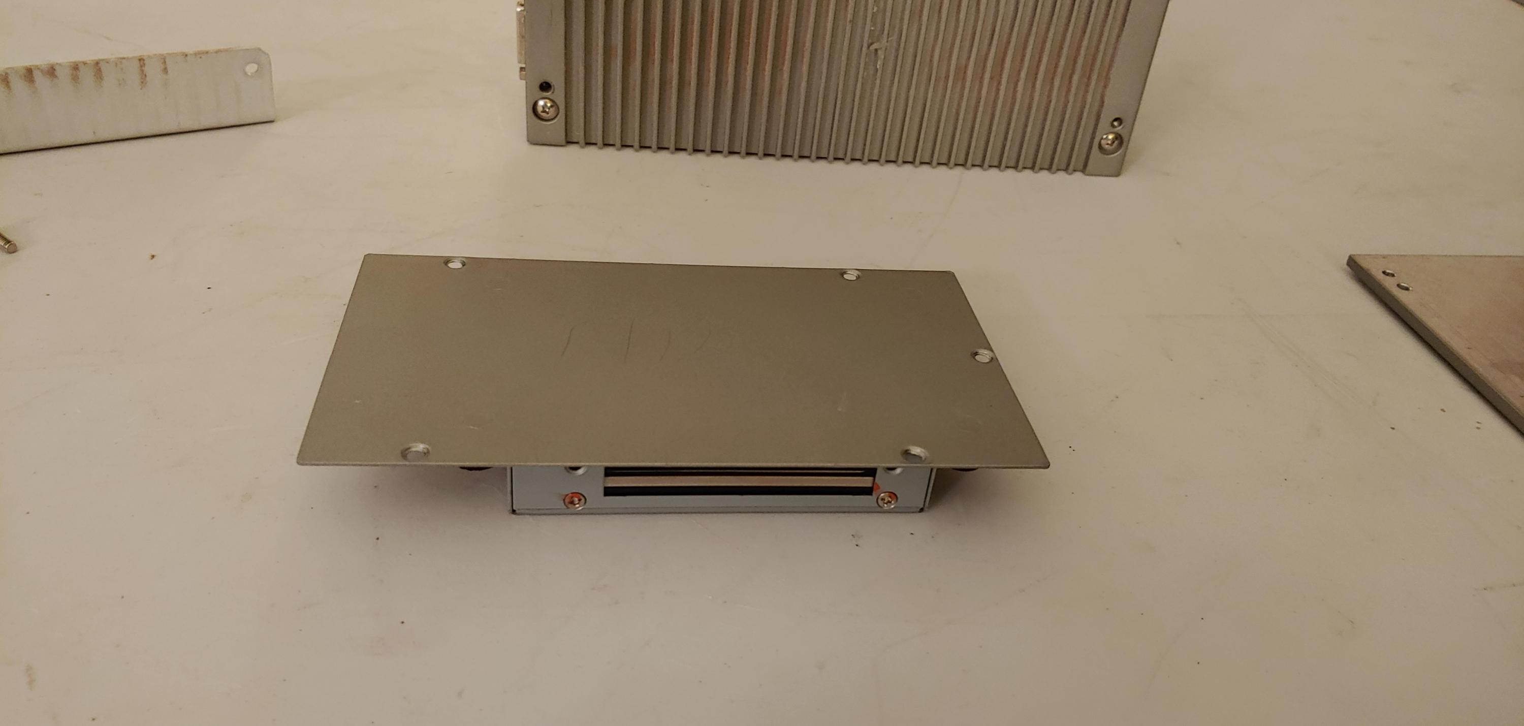

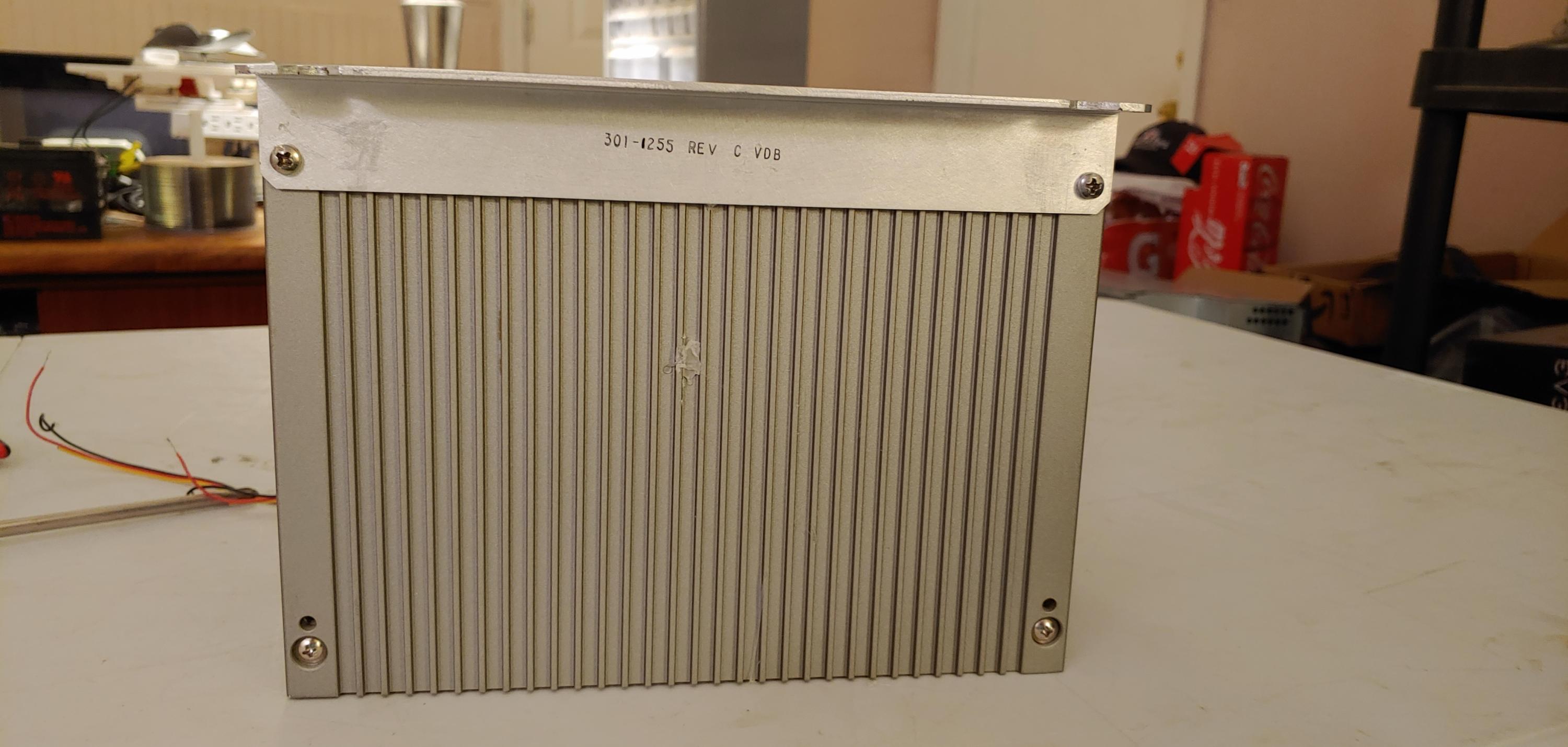

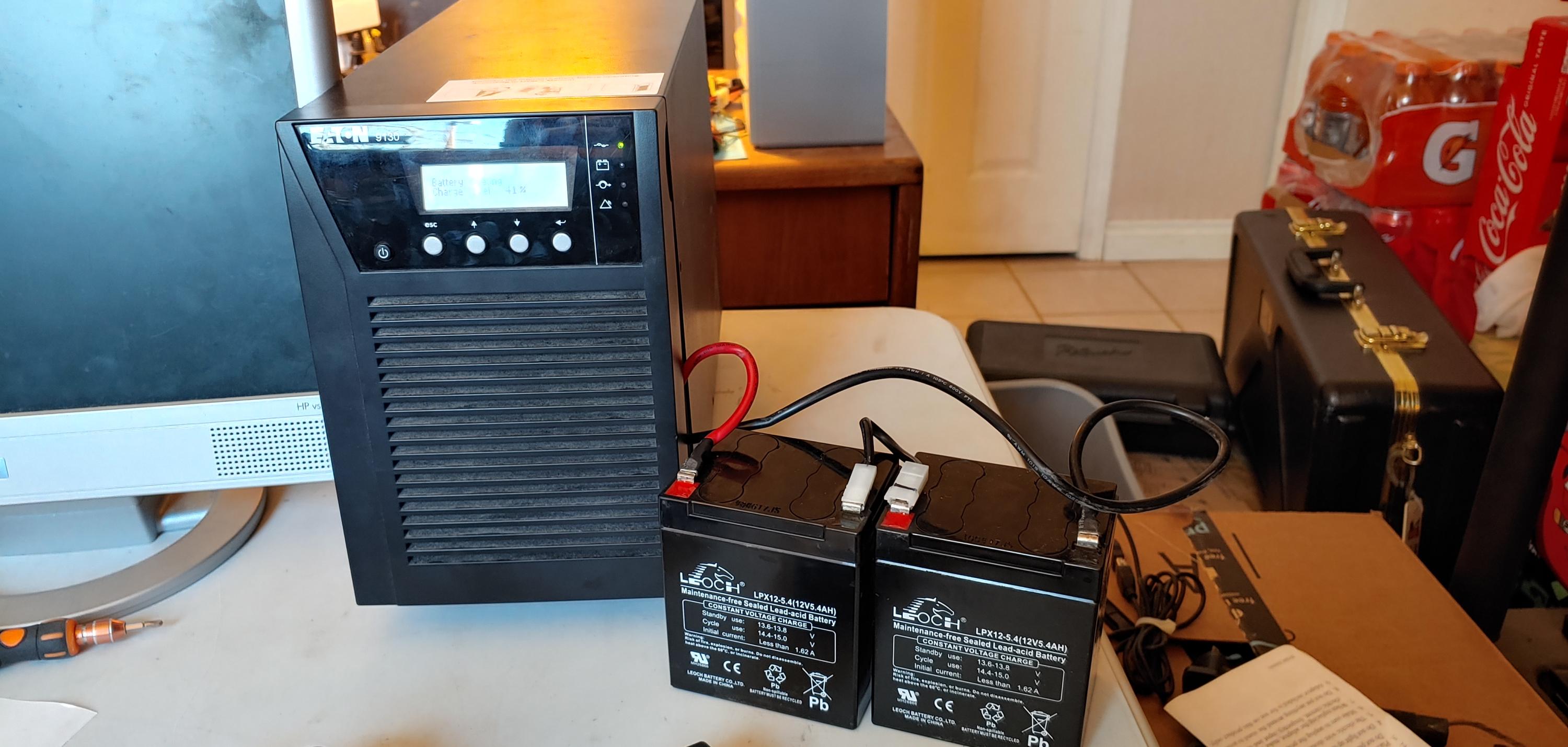

                    Here is the surprise addition to the Tech Room setup, an Eaton Powerware 9130 UPS. It uses double-conversion topology, which is the most exotic of the three common UPS topologies. Retail, I guess that this UPS was over $1000 new, as a comparable model from a supported lineup is more than $1100.
                    I got this UPS a couple of weeks ago with a completely shot battery pack. I had a known good APC RBC116/7 battery pack with no UPS to go with it. So I stripped it out for it's batteries, 10x 12V/5AH batteries. They were connected in series for a total of 120VDC/50AH. I paired them up in groups of 2, making 5x 24V/10AH packs. This is a little less capacity than the 18AH factory battery pack, but still plenty for what I need.
                    Jerry-rigged pack attached to UPS, UPS is happily charging the batteries.
                    Several days later... UPS integrated into the Tech Room setup with firewall system connected to it.
                    Performing a battery rundown test. IIRC, I did around 4 of these whilst correcting my APCUPSD configuration. The Eaton UPS is able to support the firewall system until it shuts down when the main UPS hits 15% battery charge. Then the Eaton UPS will support the home network stack for a while, either until the power comes back on or until it's battery pack is exhausted and it shuts down.
                    Another battery rundown test.

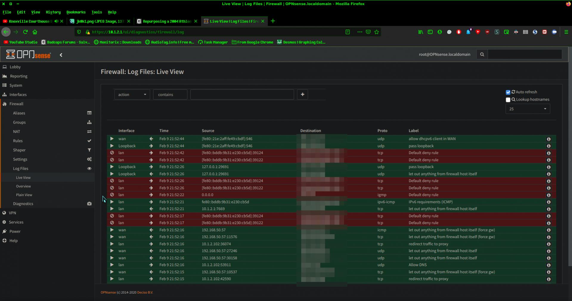

                    Finally, some screenshots of the firewall actually up and passing traffic.
                    This may be the last post on this thread from me until I send the motherboard in this system off for a recap. I may make another post here when I fully decommission the old firewall system.
                      Magic! Please do tell how you do this!
                      Uh no, sorry. Doesn't work that way sadly.
                      You can configure 10x 12V 5Ah packs to any one of these configurations (and others)
                      1x 120V 5Ah pack
                      5x 24V 5Ah packs
                      1x 24V 25Ah pack
                      1x 12V 50Ah pack
                      A 120V 50Ah pack would require 100x 12v 5Ah packs... and $#*(%)#@! I need 18V for my 1KVA UPS. Been without batteries for years now after the packs die one by one...
                        1x 120V 5Ah pack
                        5x 24V 5Ah packs
                        1x 24V 25Ah pack
                        1x 12V 50Ah pack
                        1) Have a friendly neighbor who works for a hospital and is able to sneak things out of there. He also got me a Samsung ML-3750ND laser printer (three of the things, actually), some industrial DB-9 cables, the Advantech UNO-3072LA industrial computer, and 2 APC Smart-UPS 1000 (SUA1000) UPSs. One almost burned up a year and a half ago, so I salvaged its transformer, pulled the battery pack, salvaged some internal wiring, and recycled the rest.
                        2) Ack, had a brain fart. Yep, series = higher voltage, parallel = higher Ah.

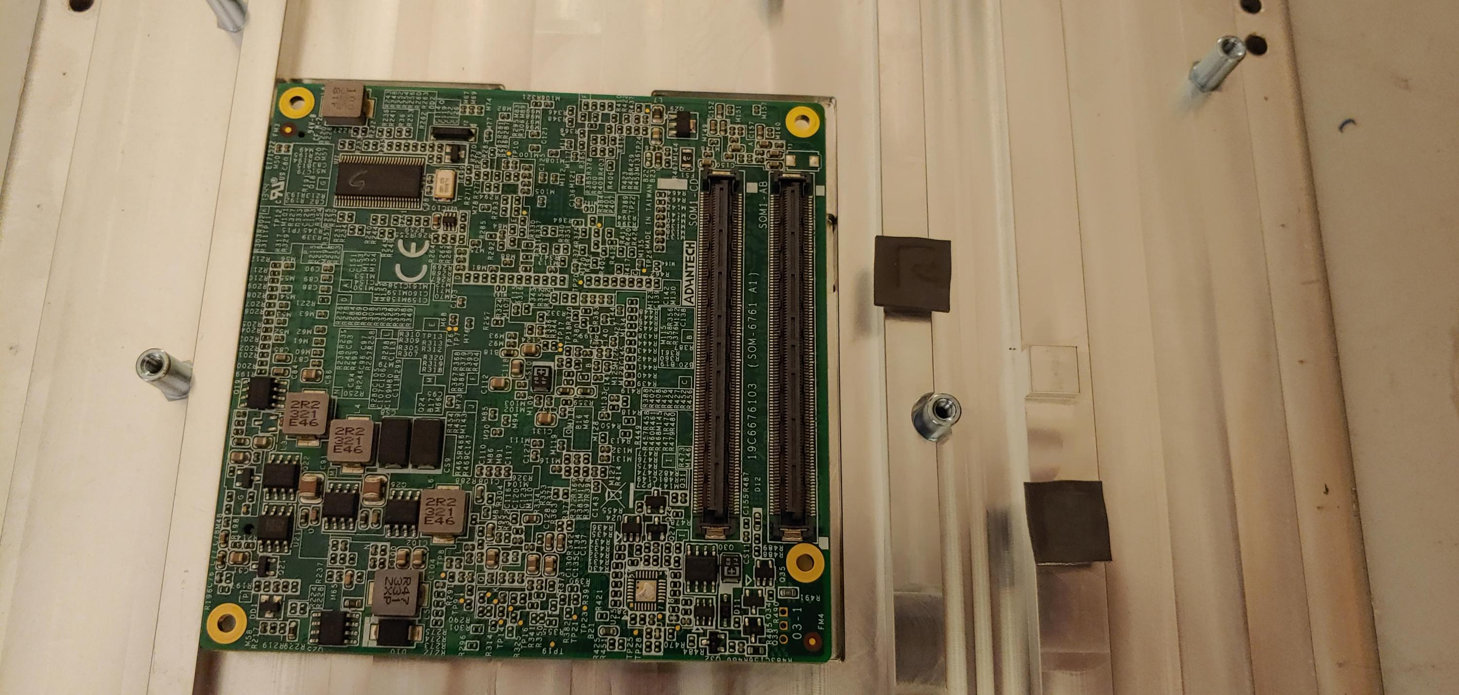

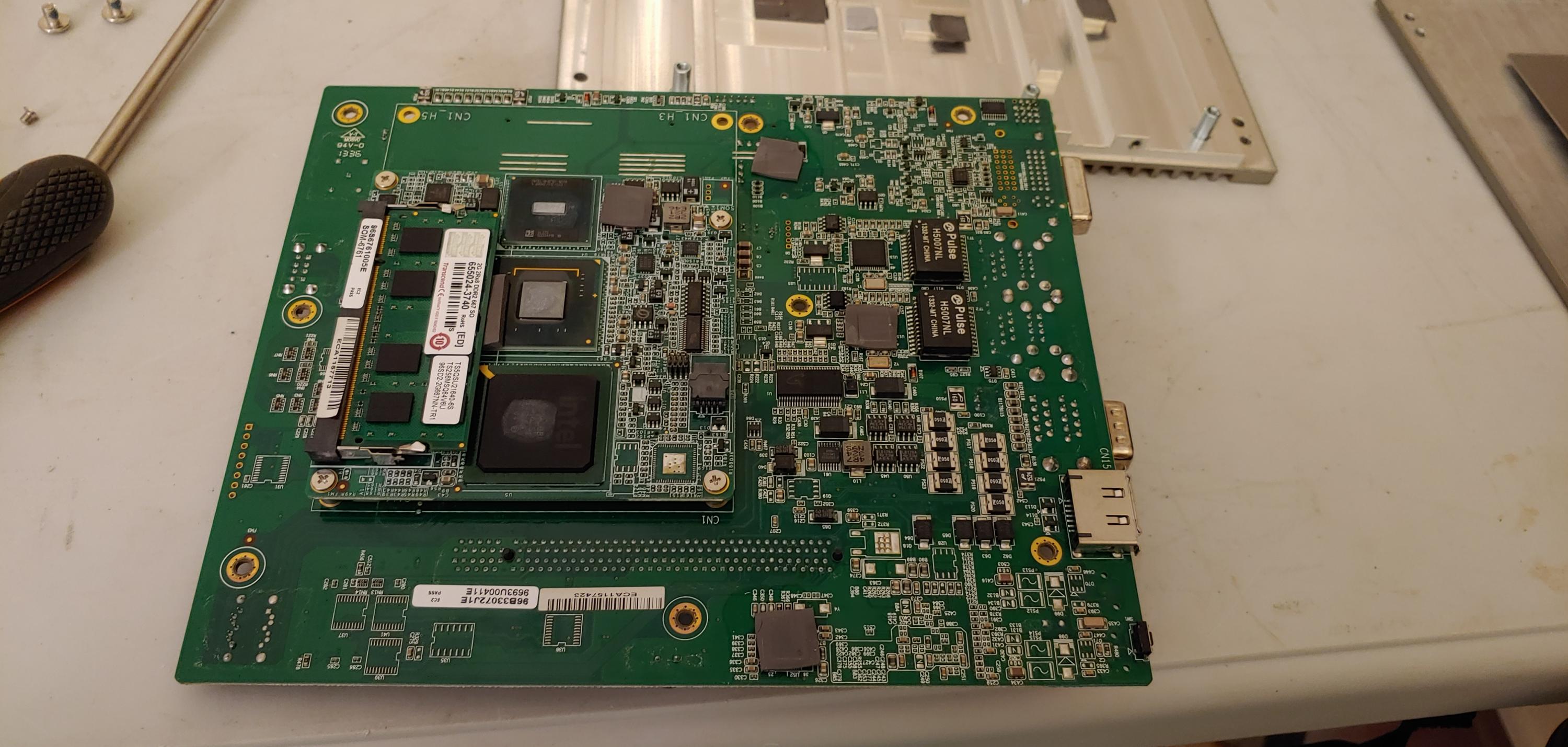

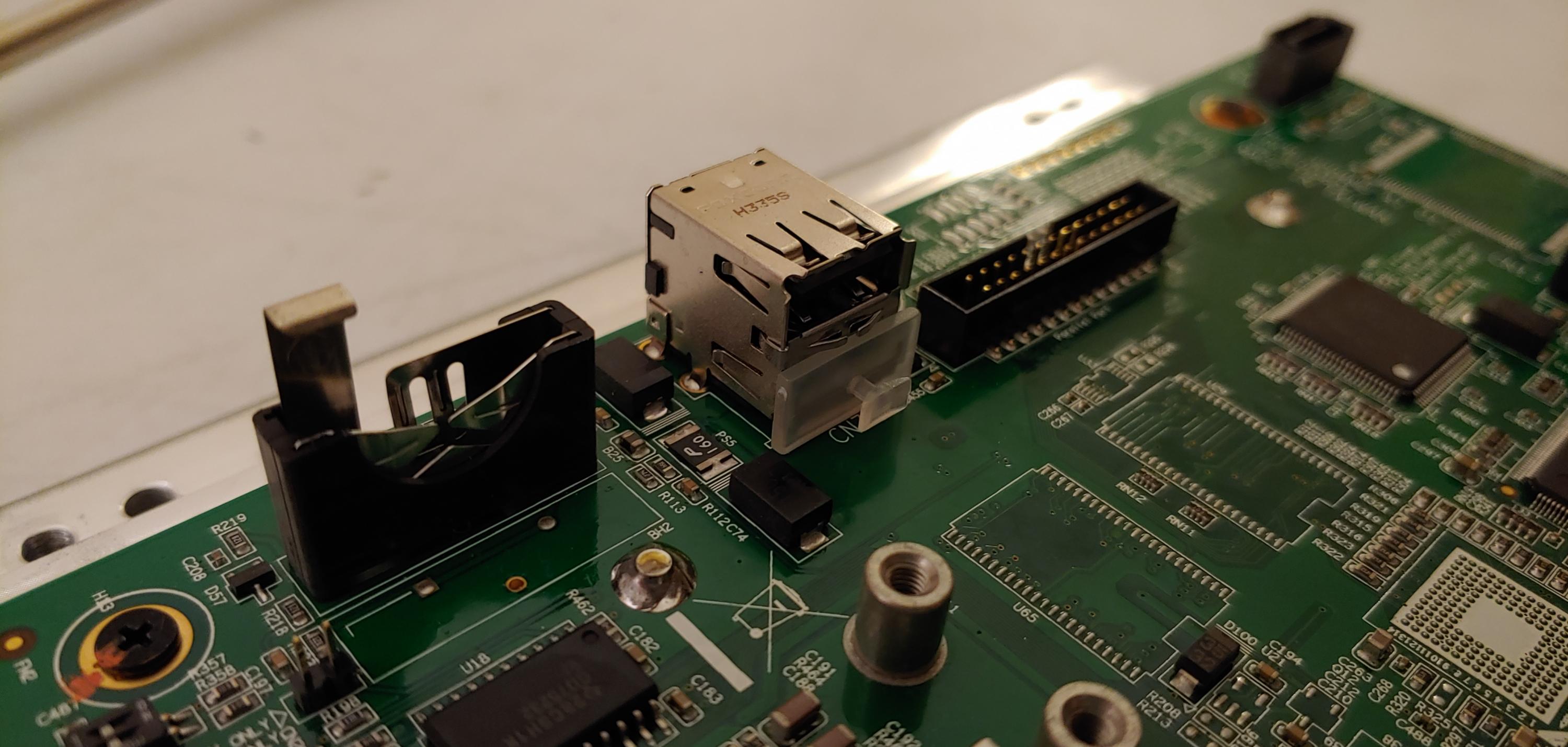

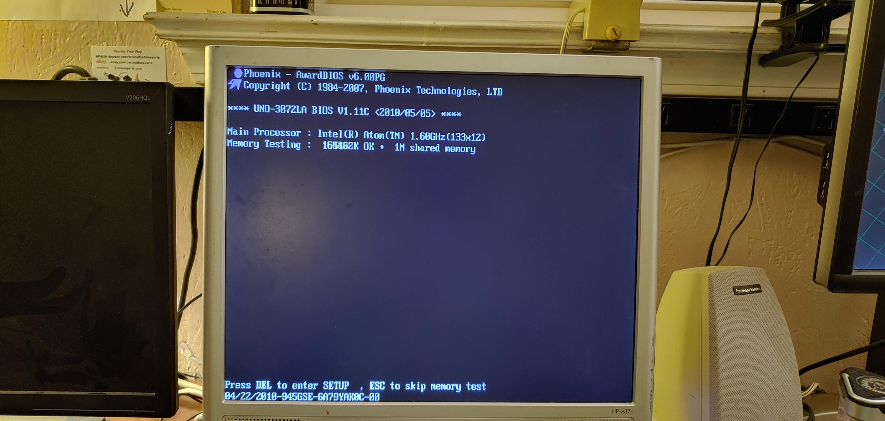

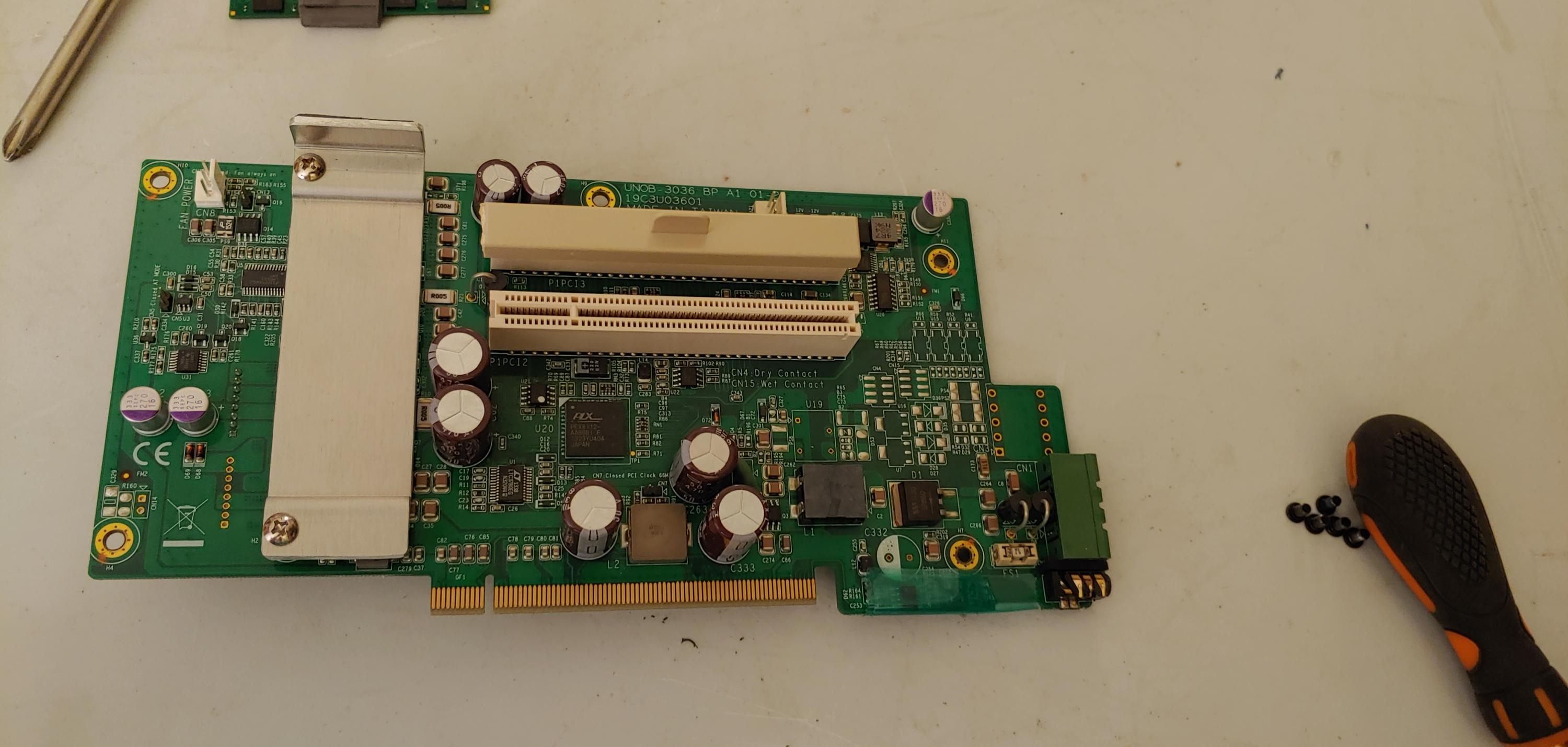

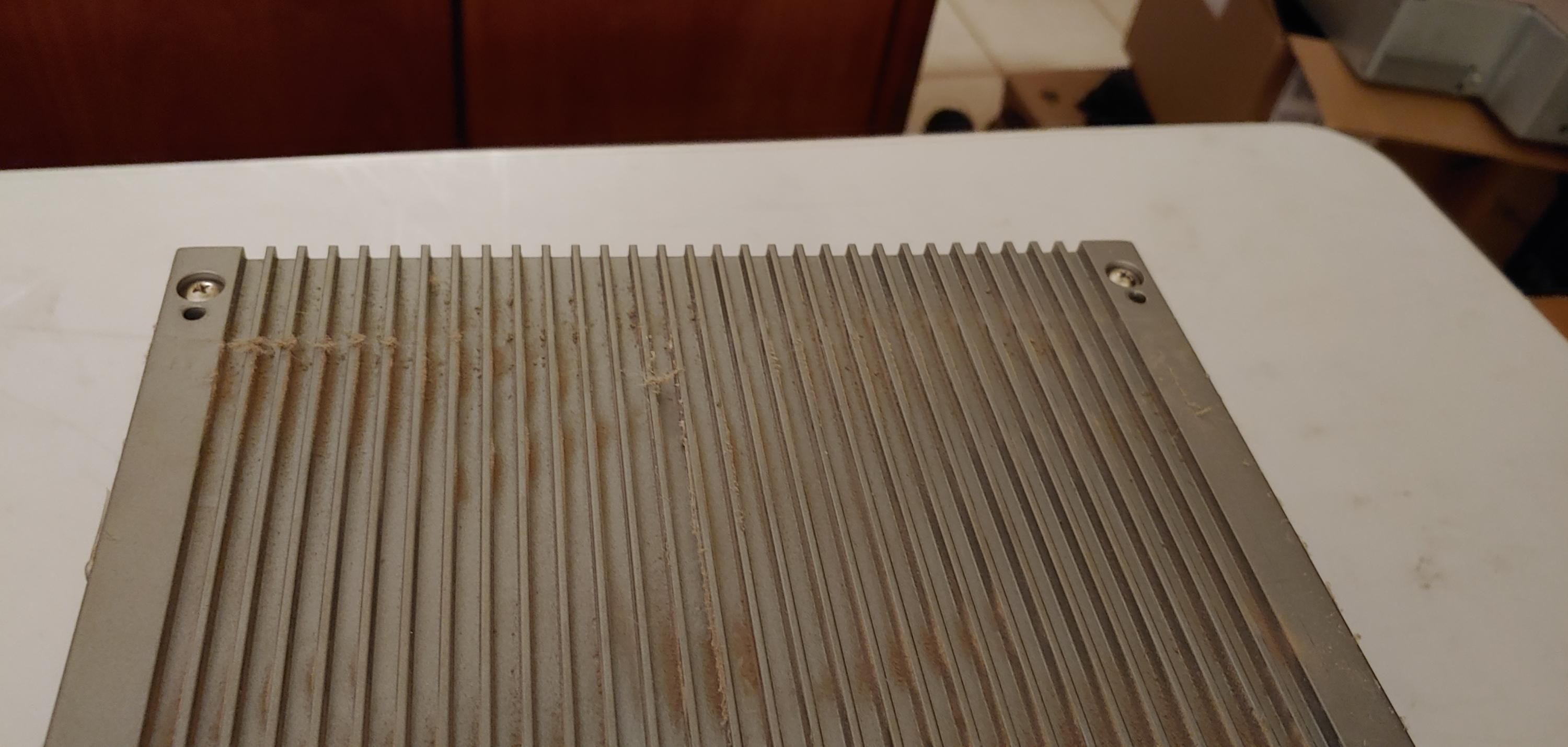

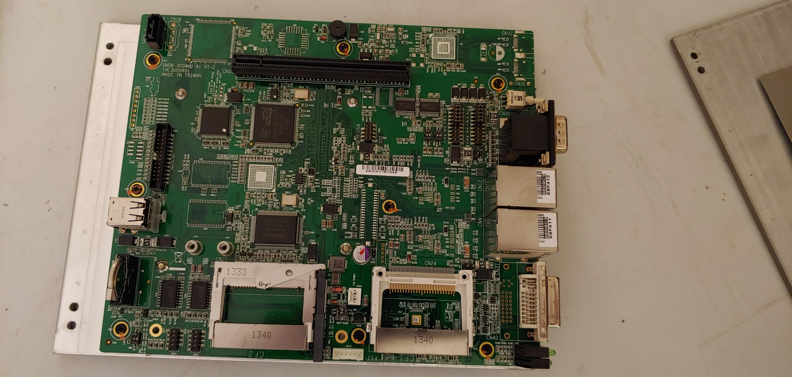

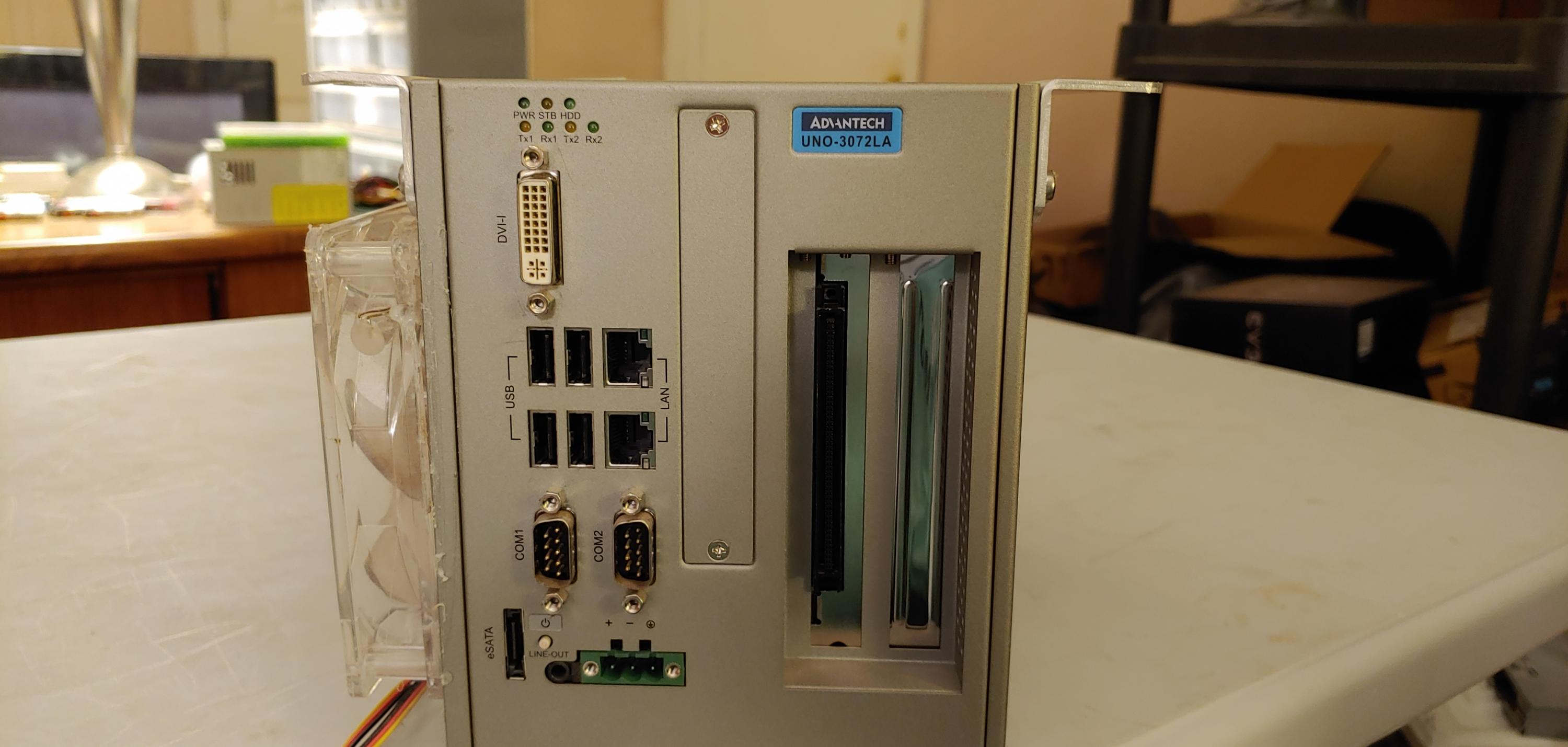

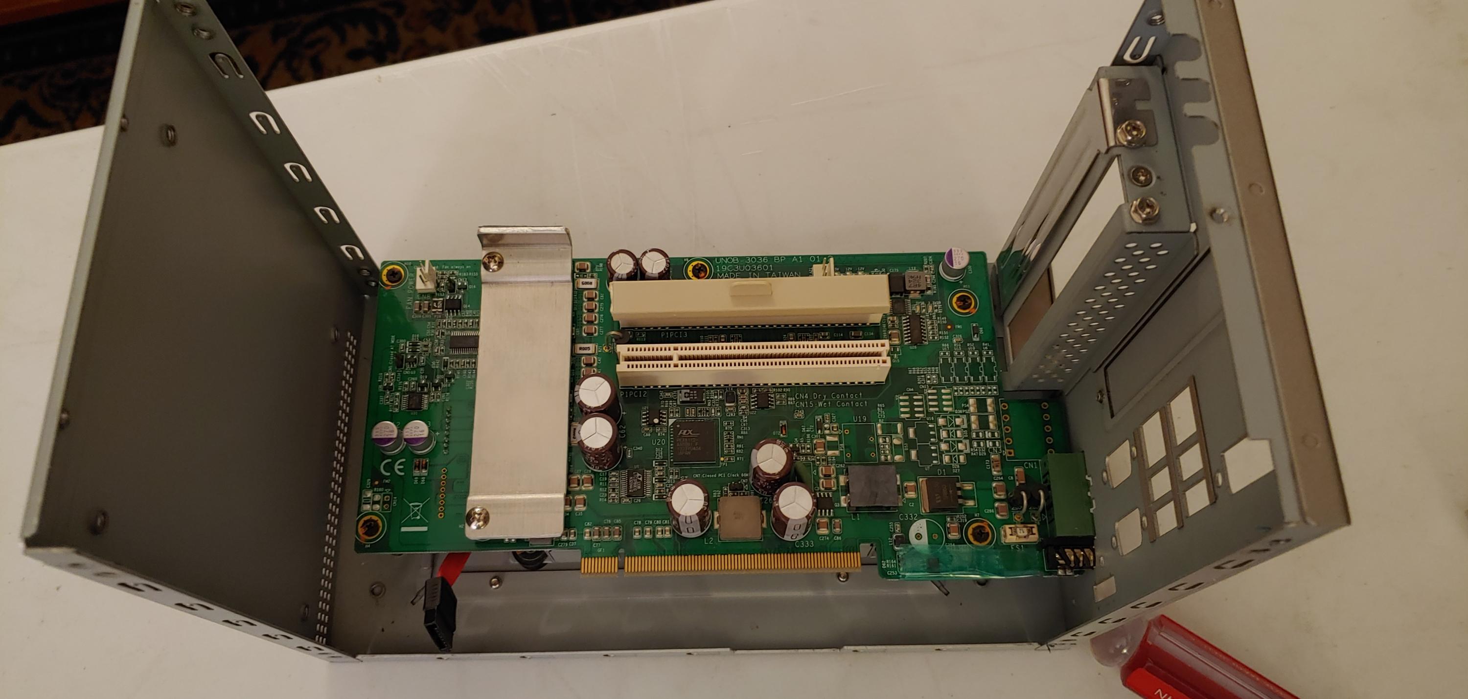

                              btw, software support for the Advantech UNO-3072LA? Because it's slow or because it actually doesn't run modern OS?
                              I'm still using an Asus eeePC 901A (netbook, likewise slow Atom N270)... heh heh heh...
                              and yes this does still run modern OS, SSE2 and all, just that it doesn't have PCI slots or more disk ports...
                              • TechGeek
                                Computer Geek
                                • Jan 2015
                                • 2254
                                #35
                                It has an Intel Atom N270 CPU, which is not 64-bit capable. Retired it because I switched to OPNsense, which requires a 64-bit CPU.

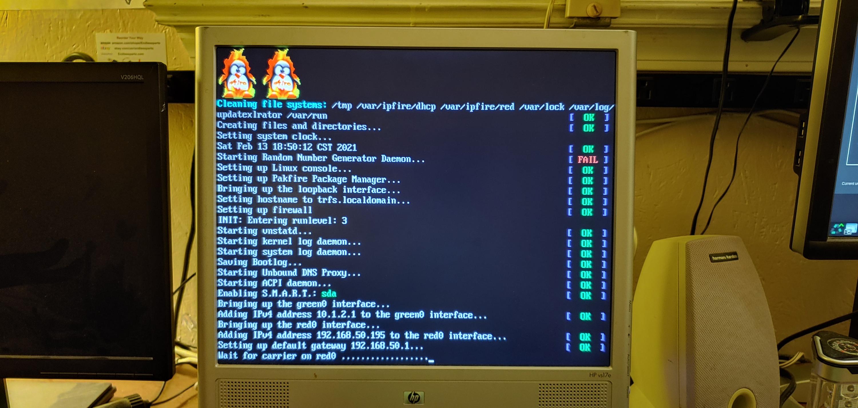

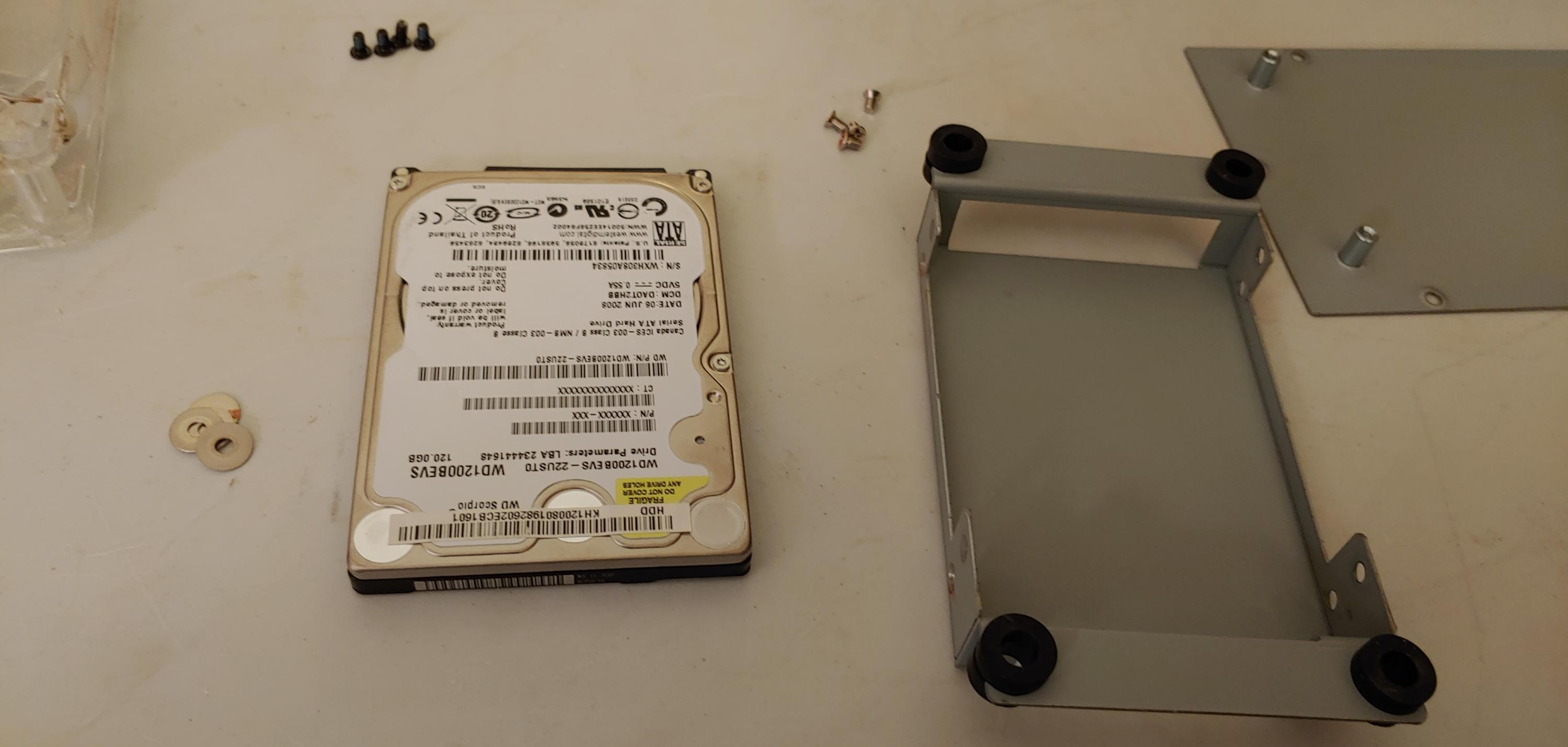

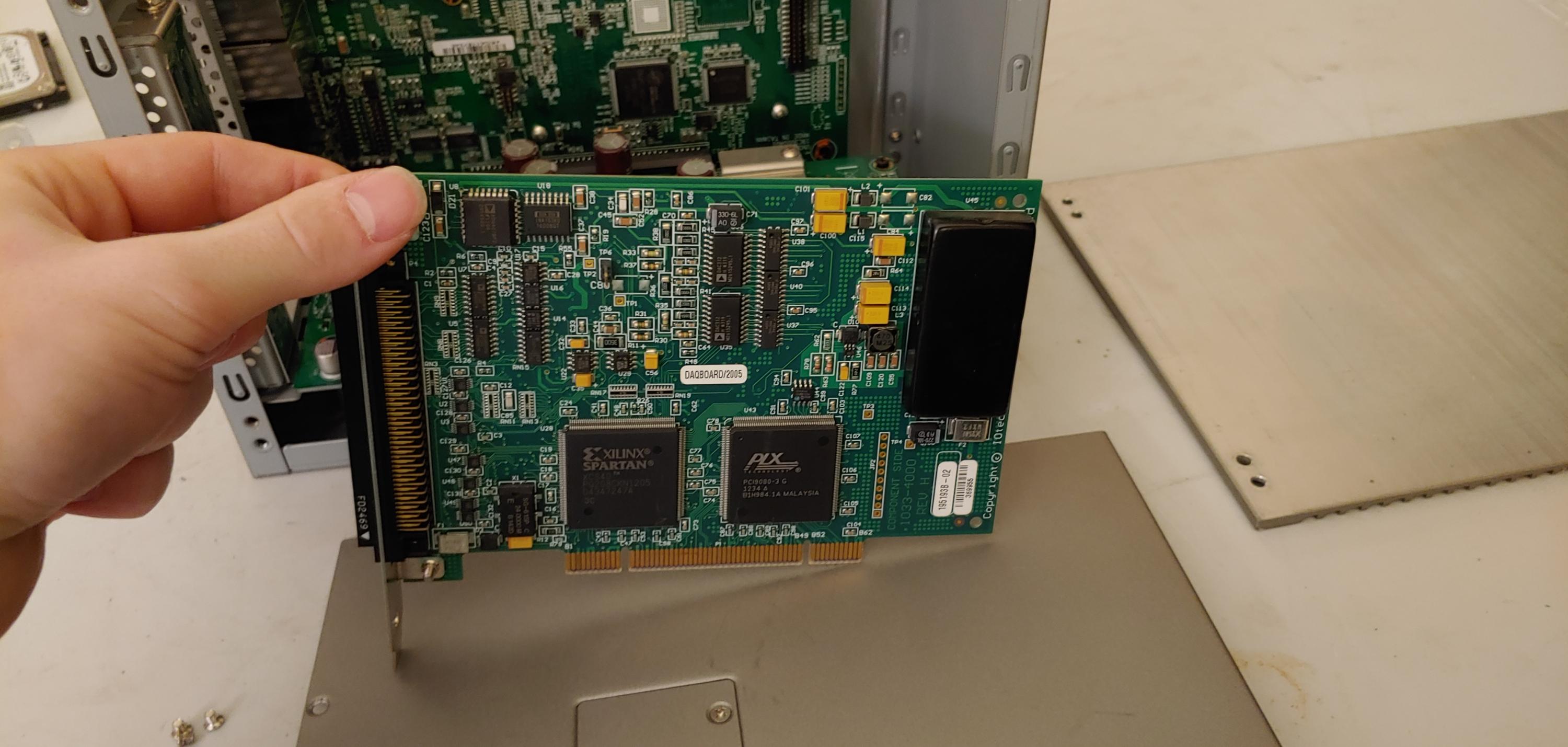

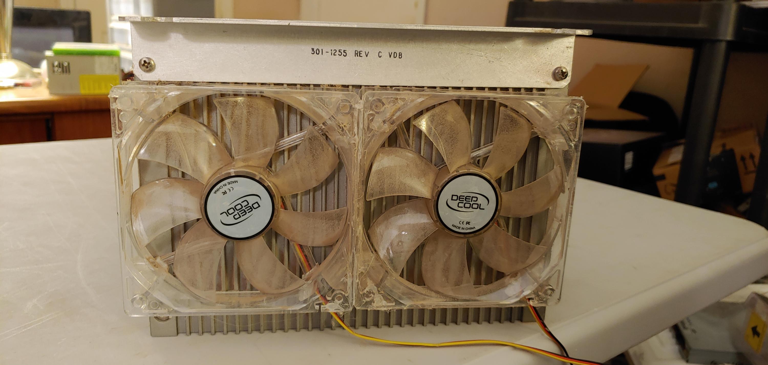

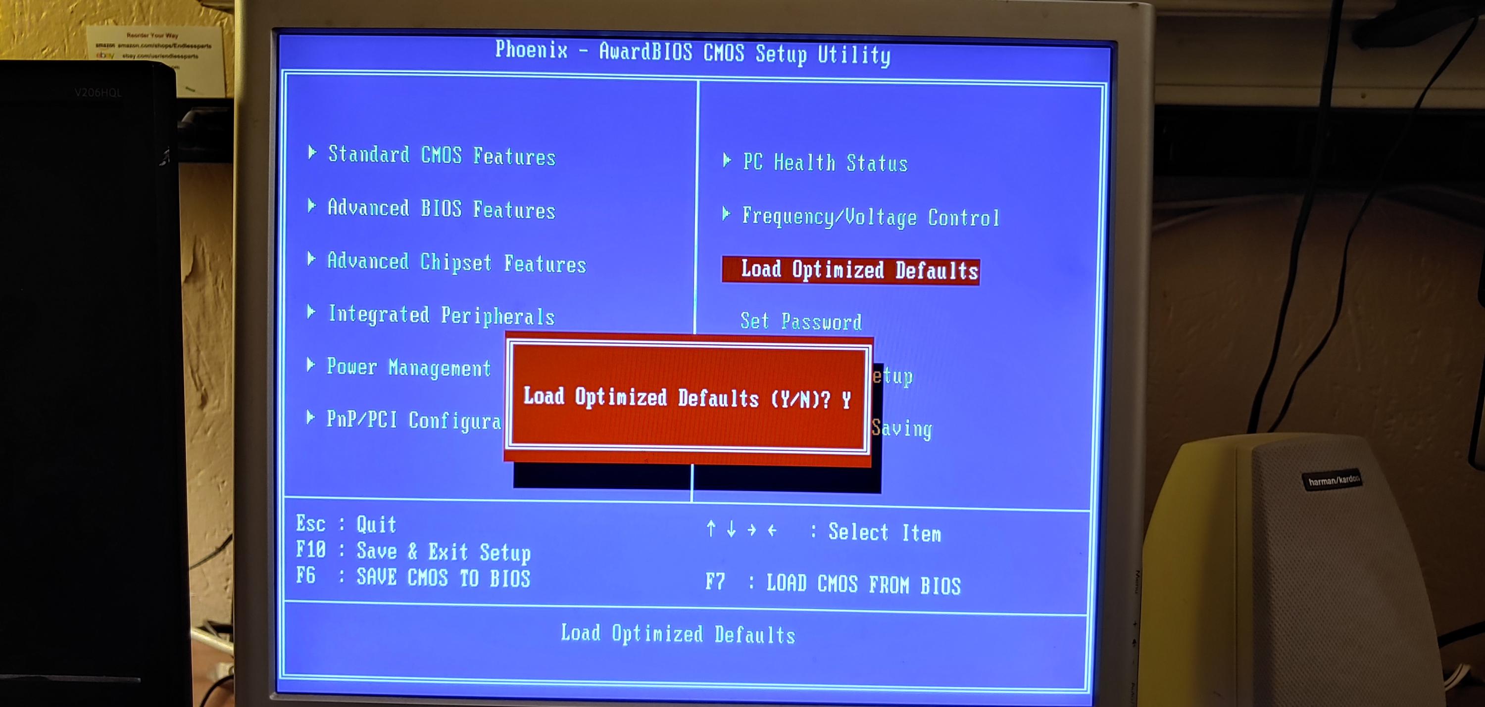

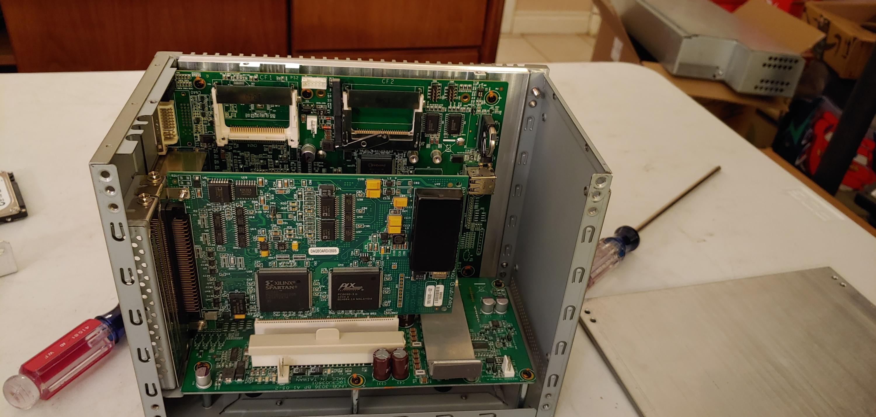

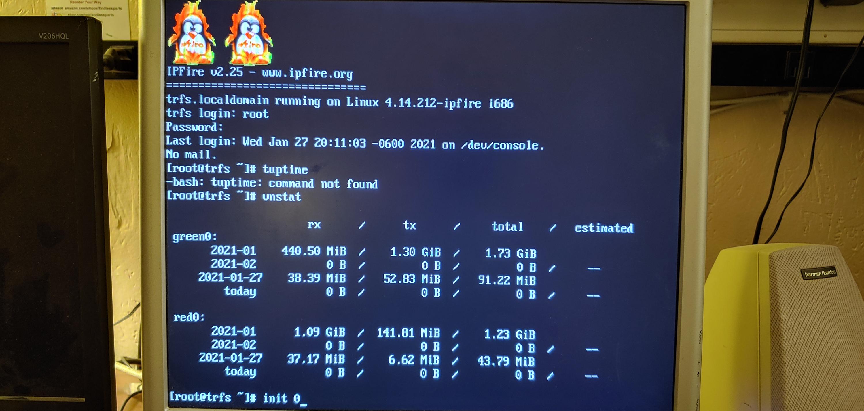

                                    Last night, I went and removed the old firewall system (and it's supporting hardware) from the desk. Cue the mass dump of inline images. We will certainly hit the attachment limit with this one.
                                    Temporarily attached a monitor and keyboard to the system.
                                    Power reapplied for the last time.
                                    Letting it do a full memory count. Takes about 5 minutes with 2GB of RAM.
                                    Booting into IPFire for the last time.
                                    Can't get a carrier if there's no cable.
                                    Last booted 16 days ago. This is the longest this system has ever been powered down in the more than 3 years it's been since it was placed into service.

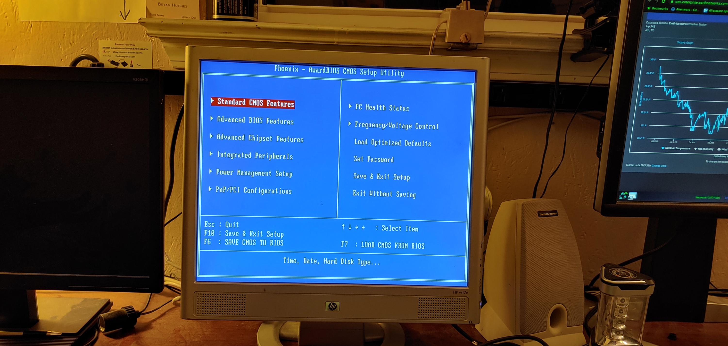

                                    Rebooted back into the BIOS to disable the password and reset to defaults.
                                    Password disabled...
                                    BIOS reset...
                                    ...and powered down for the last time. Also started disconnecting it's supporting hardware. Work lights are on so I can see better.
                                    Firewall system disconnected from power, power supplies disconnected too.
                                    Had to shut the current firewall system down and move it so I could get under the desk enough to dismount the old firewall system.
                                    System removed. Notice the dust. And that janky-looking mess in the back.
                                    Had to cut about a dozen zip-ties to get this out. This is the contraption that supplied power to it. 2 power supplies in parallel (complete with custom power cable) to supply enough current capacity to run it.
                                    Dust blown up top from the fans pushing air across the heatsink.
                                    Let's grab some photos before tearing into it. Here's the backside of it.
                                    Connector side:
                                    Fan side:
                                    Butt end of the system (No, I don't care about the product key, have fun with it):
                                    Fans removed. ICK!
                                    1st fan removed:
                                    2nd fan removed:

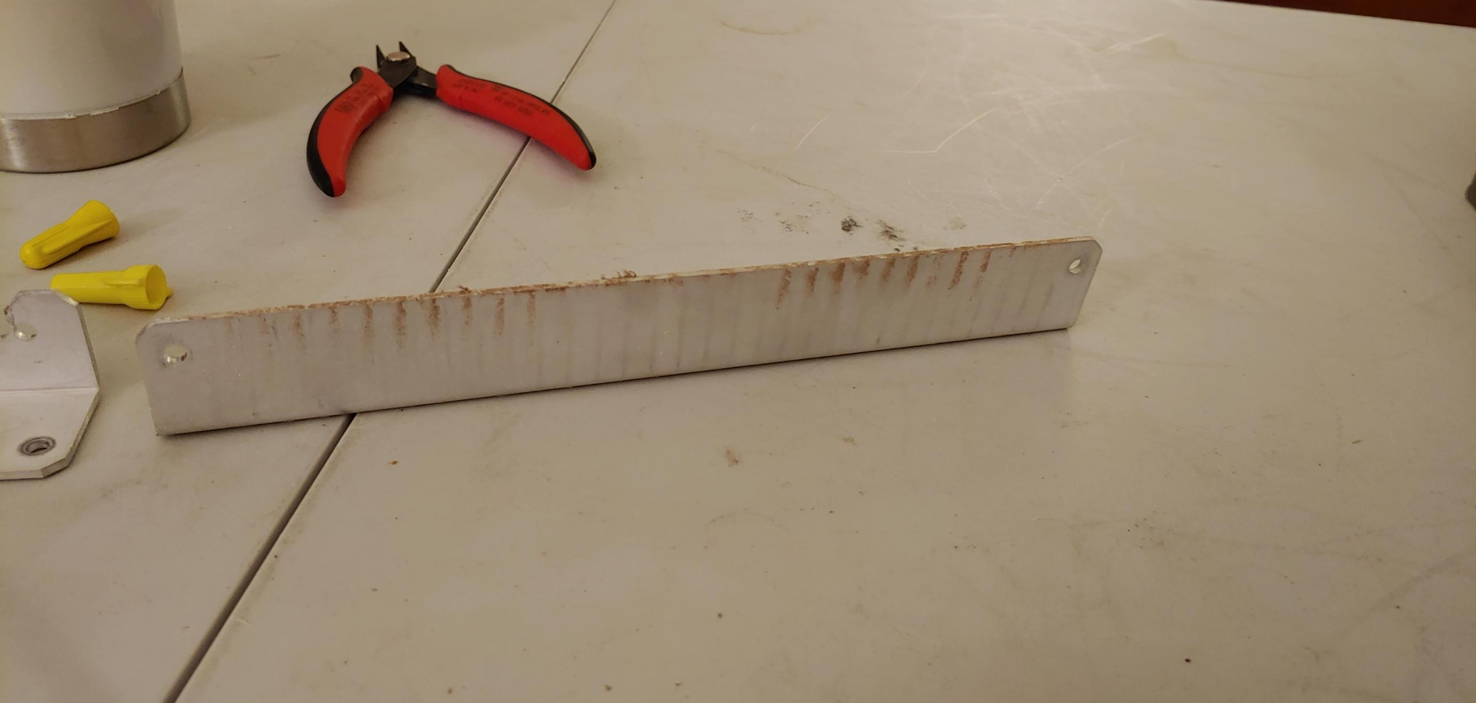

                                    Both of those fans are running low on oil and are in need of a serious cleaning.
                                    1st mounting bracket:
                                    More dust.

                                    HDD caddy removed.
                                    HDD carrier removed from mounting plate.
                                    And there's the attachment limit. More photos coming right up!

                                      HDD removed from carrier.
                                      Removed the top cover. I personally think that this is beautiful.
                                      A top-down view, assisted by 150W of incandescent lighting.
                                      Removed the data acquisition card.
                                      Motherboard removed. It's attached to the side of the case that had the fans on it, which kept this system at near room temperature. It's a major pain in the butt to remove and install, thanks to less-than-optimal design on Advantech's end.
                                      Here's what's left in the case.
                                      CMOS battery removed. Also, here's a couple of internal USB ports, which I find rather interesting.

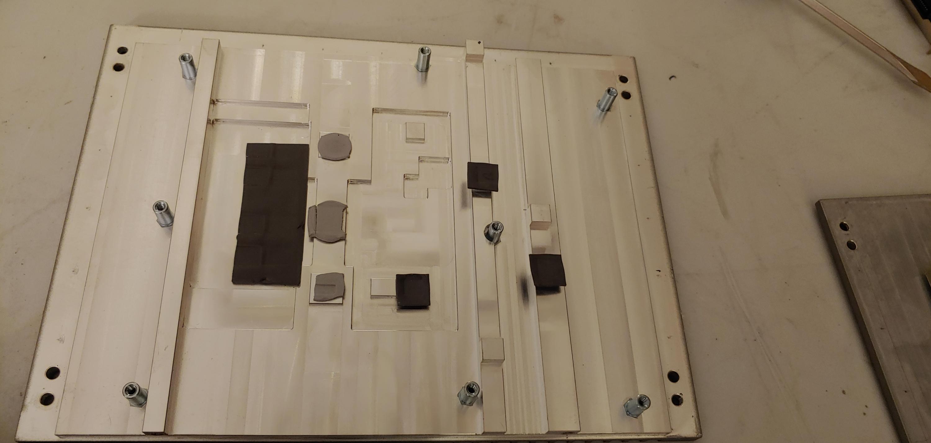

                                      Motherboard removed. Nothing like a heavy chunk of machined aluminum. Notice all of the silpads that heatsink the motherboard to the side of the case. It gets its power through the PCI riser board, which also doubles as a power supply.
                                      And yes, that's a removable RAM/CPU/NB/SB card. It interfaces to the motherboard with 2 400-pin connectors.
                                      2GB DDR2 removed.
                                      CPU card removed. HUGE amount of SMD componetry here.
                                      Power supply/PCI riser board. All Japanese capacitors here of Nippon Chemi-Con descent.
                                      Buck/boost regulators. Heatsinked to the case through this heatsink.
                                      Buttoned back up, sans CMOS battery, RAM, and HDD. One last look inside before it's closed up for the last time.
