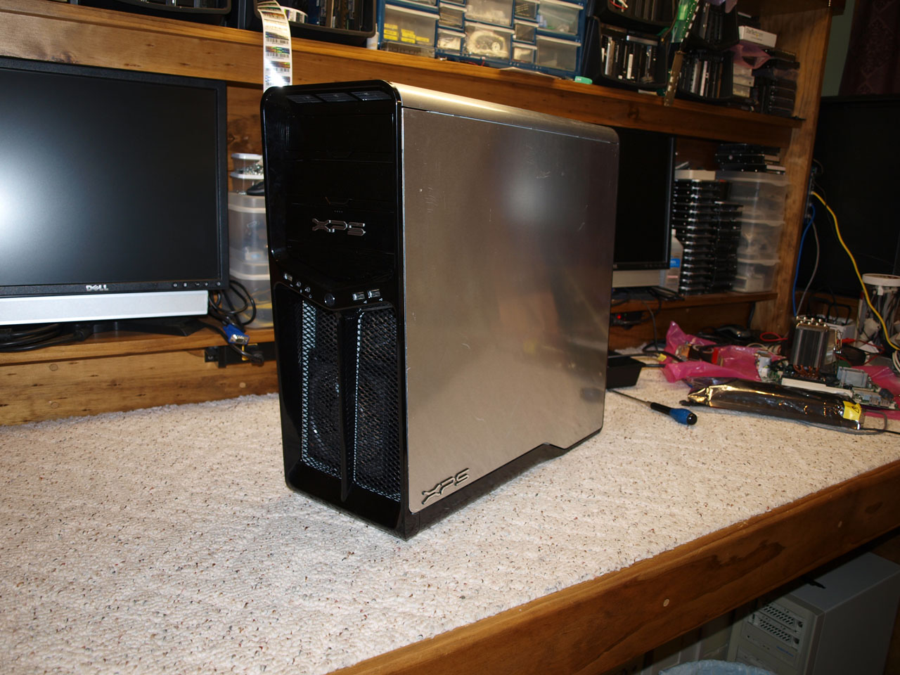

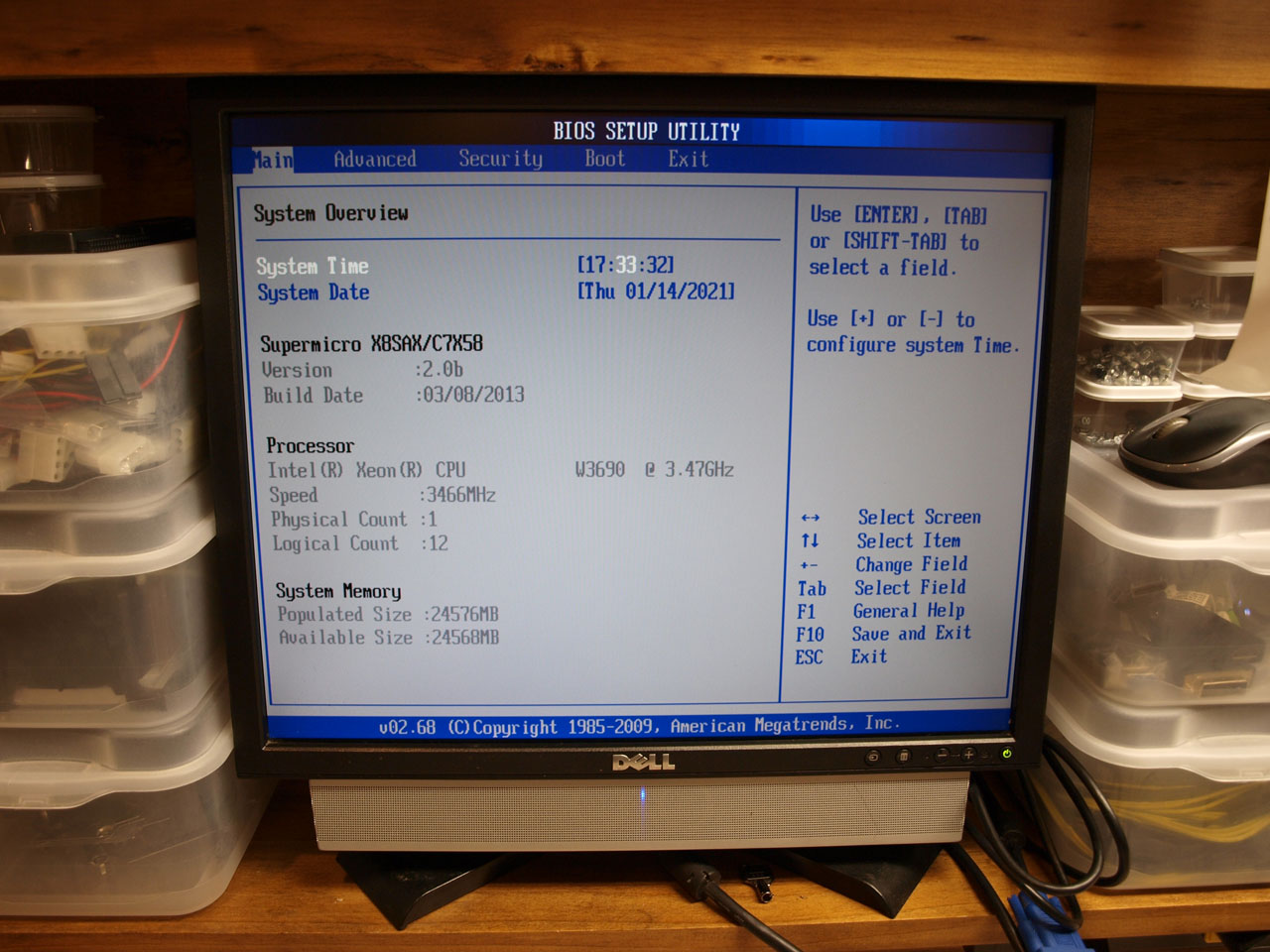

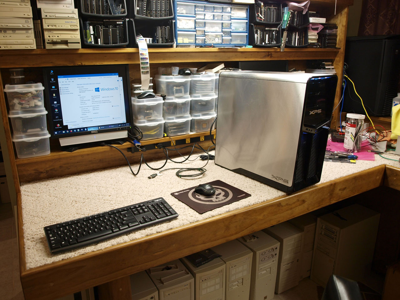

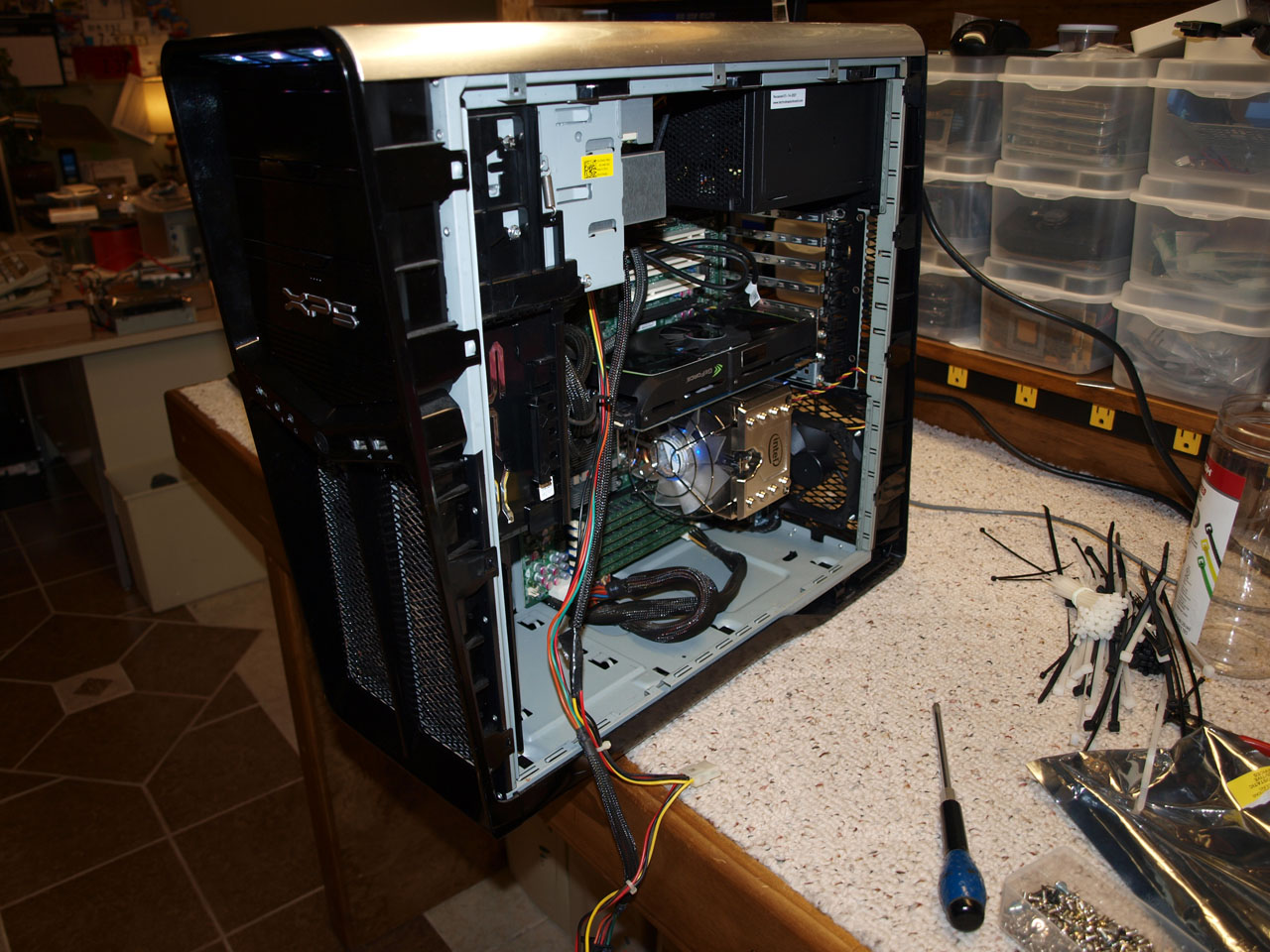

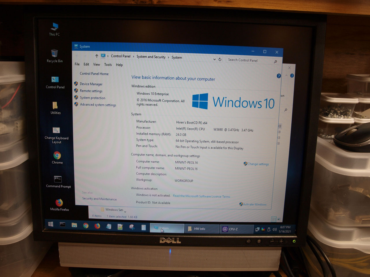

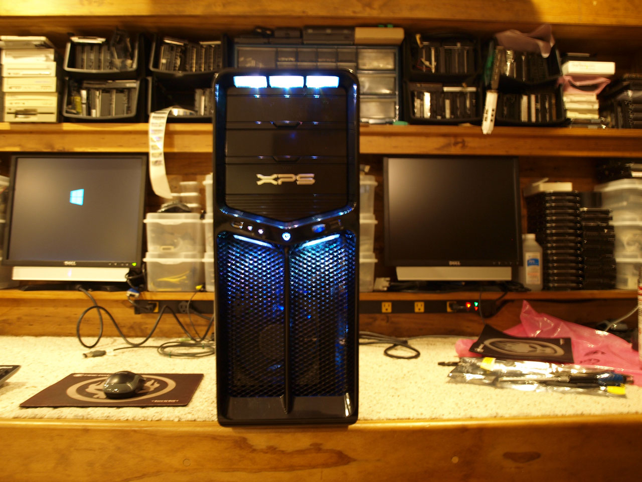

This was given to me today by a friend of mine.....he found it in some guy's goat barn, and rescued it with me in mind. You just can't buy friends like that!! Yes, it very much has the odor of a goat barn.....and a lot of dust! It will require the 'full treatment' as far as disassembly & cleaning. The HDD was missing, the card reader is missing, and the onboard NIC is dead. I did boot it off Hiren's and it did seem stable....but it's just a lame system. It will also need some new innards, it's an AM2; meh....but this is one I won't spend much on, so it'll be build with what I have on hand, which after evaluating my stash of more modern hardware happens to be a Supermicro X8SAX (from the "tree" a year or so ago). It's rocking a Hexcore Xeon @ 3.46 w/24gb DDR3; maxed out with CPU and RAM, x58 chipset....that sure kicks the creamcheese out of a dual core Athlon2 5600+!!
GPU at this point is undecided, not sure what I've got lingering around, but with a good GPU this would make a stellar workstation and even a pretty good gaming rig. I won't spend much on this, the only thing I plan to buy is a SSD...I wouldn't ruin this one with a spinner...

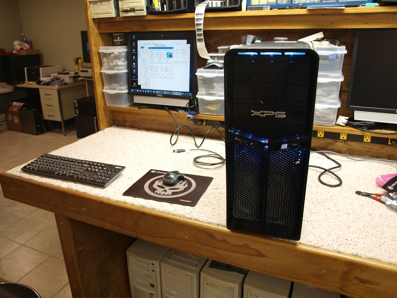

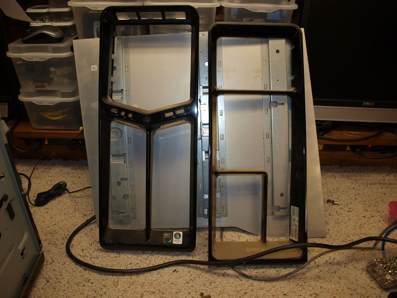

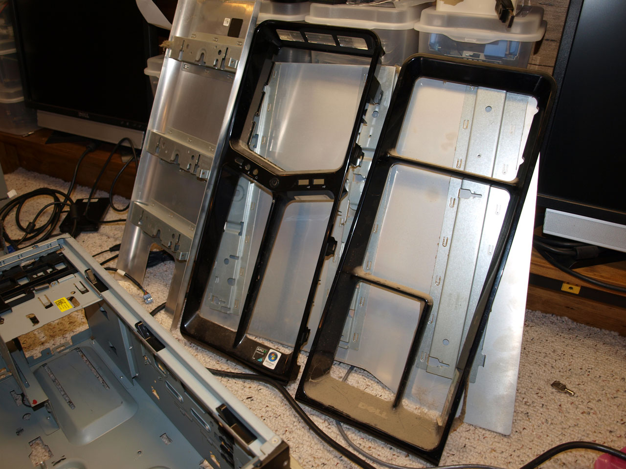

What intrigued me about this case was it's lighting, which was not overdone and was placed in practical places. Above drive openings and at the IO area. ...and here we go!!
Filthy!!

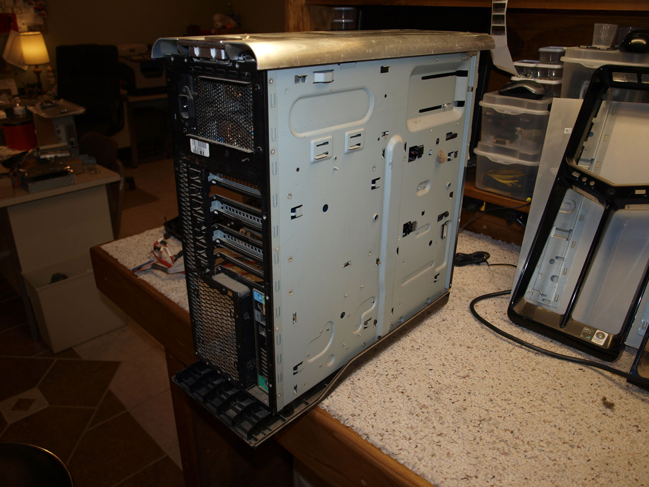

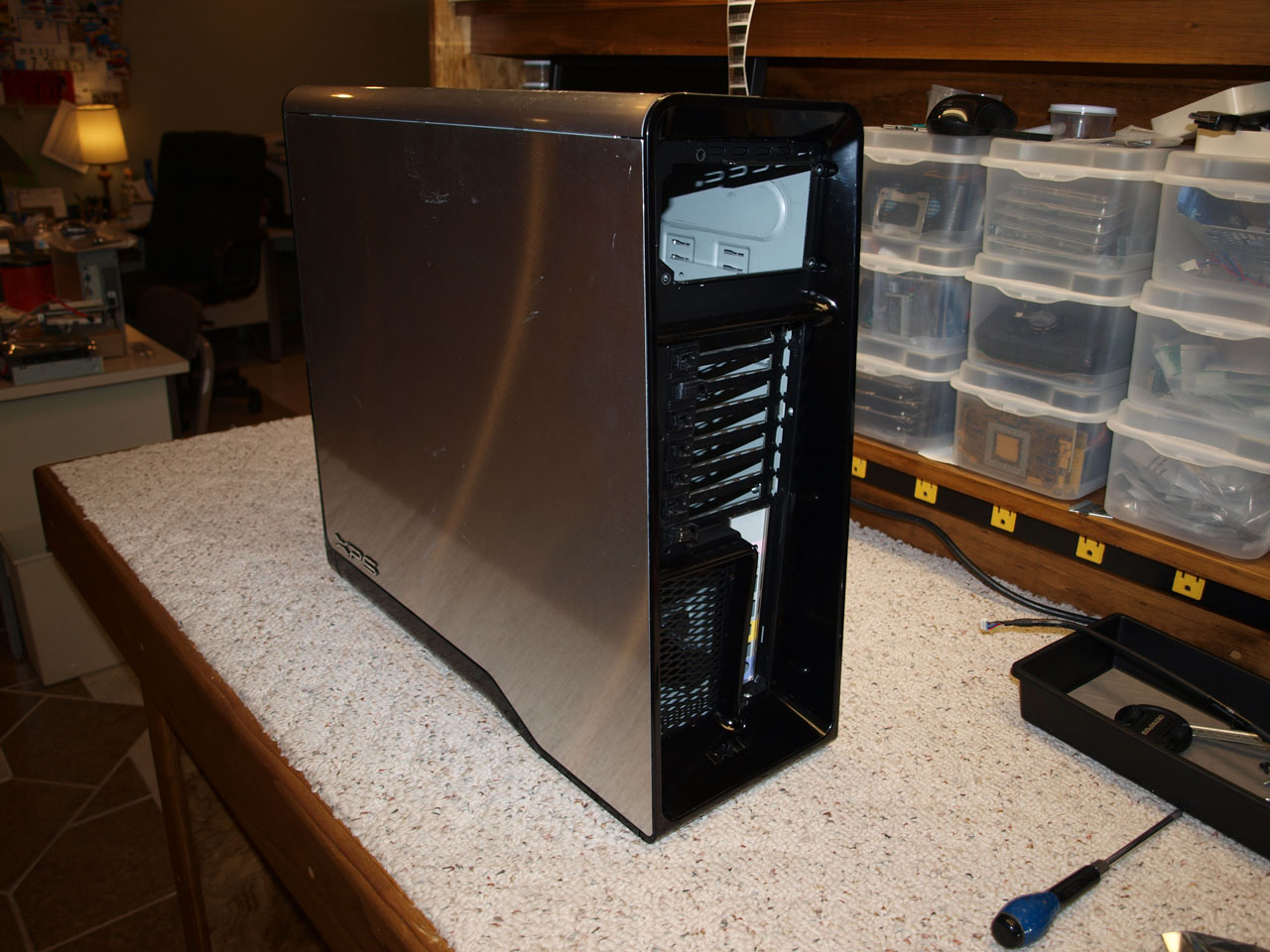

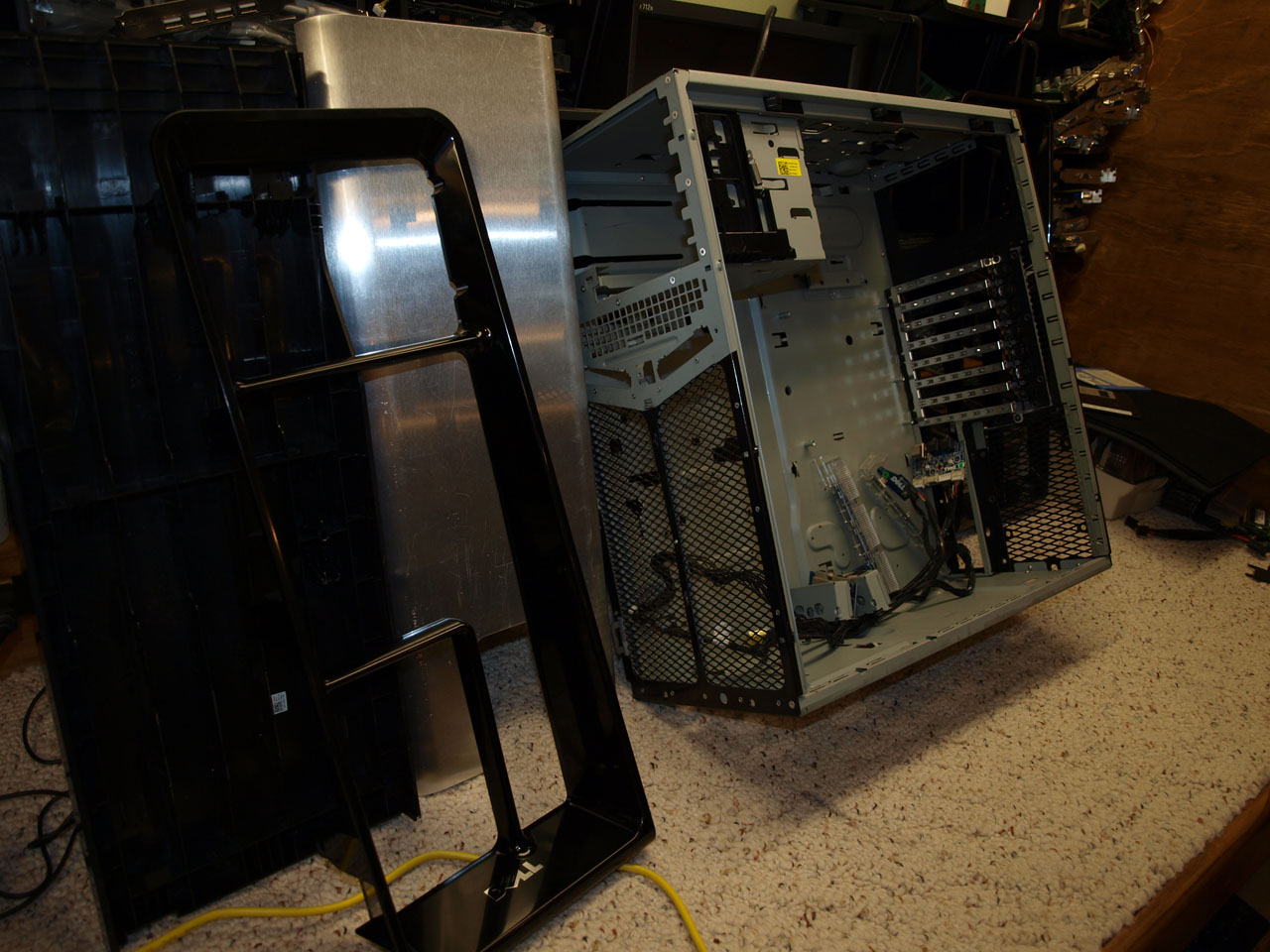

I've never seen one of these cases before....but very interesting.

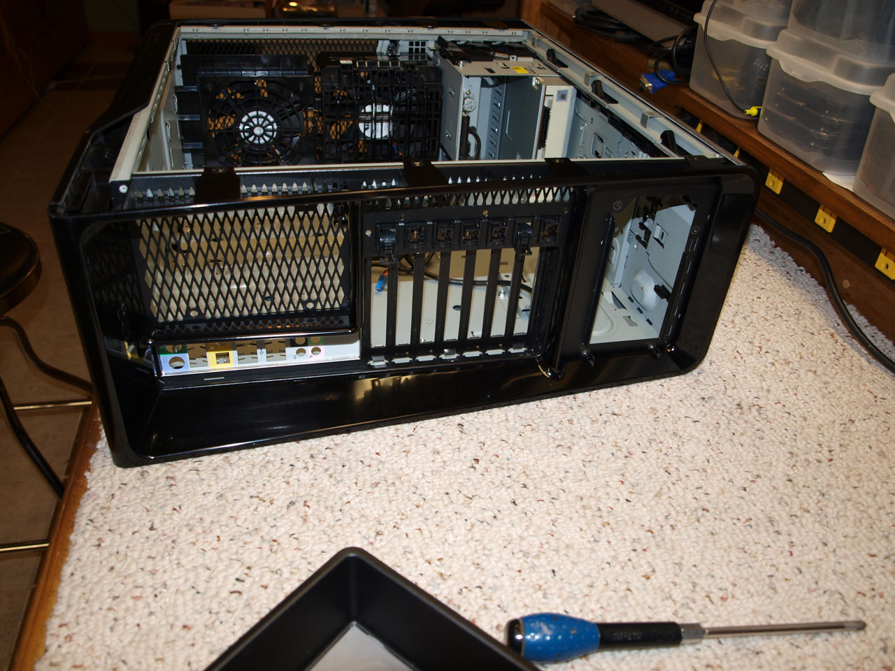

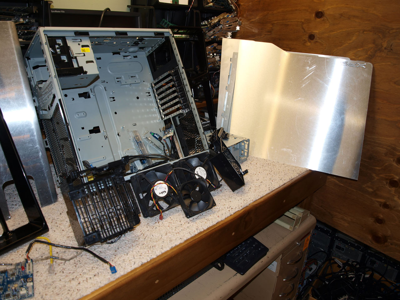

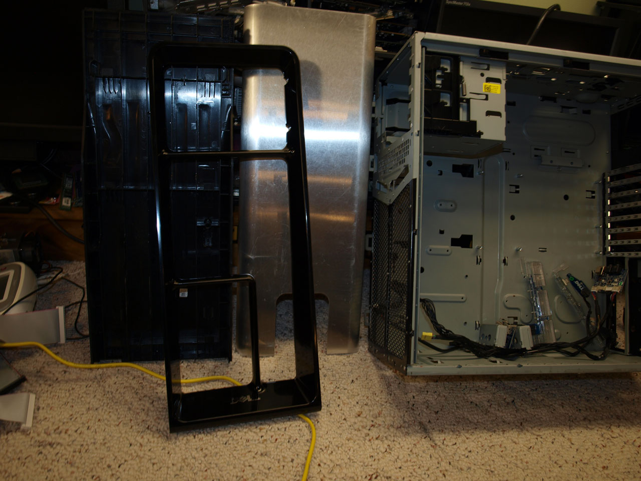

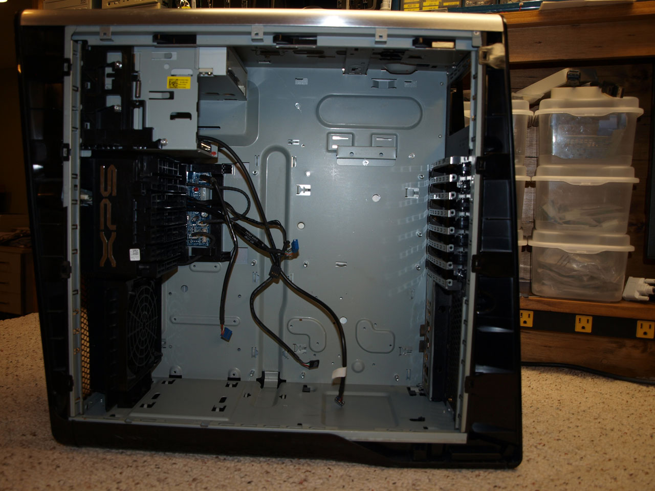

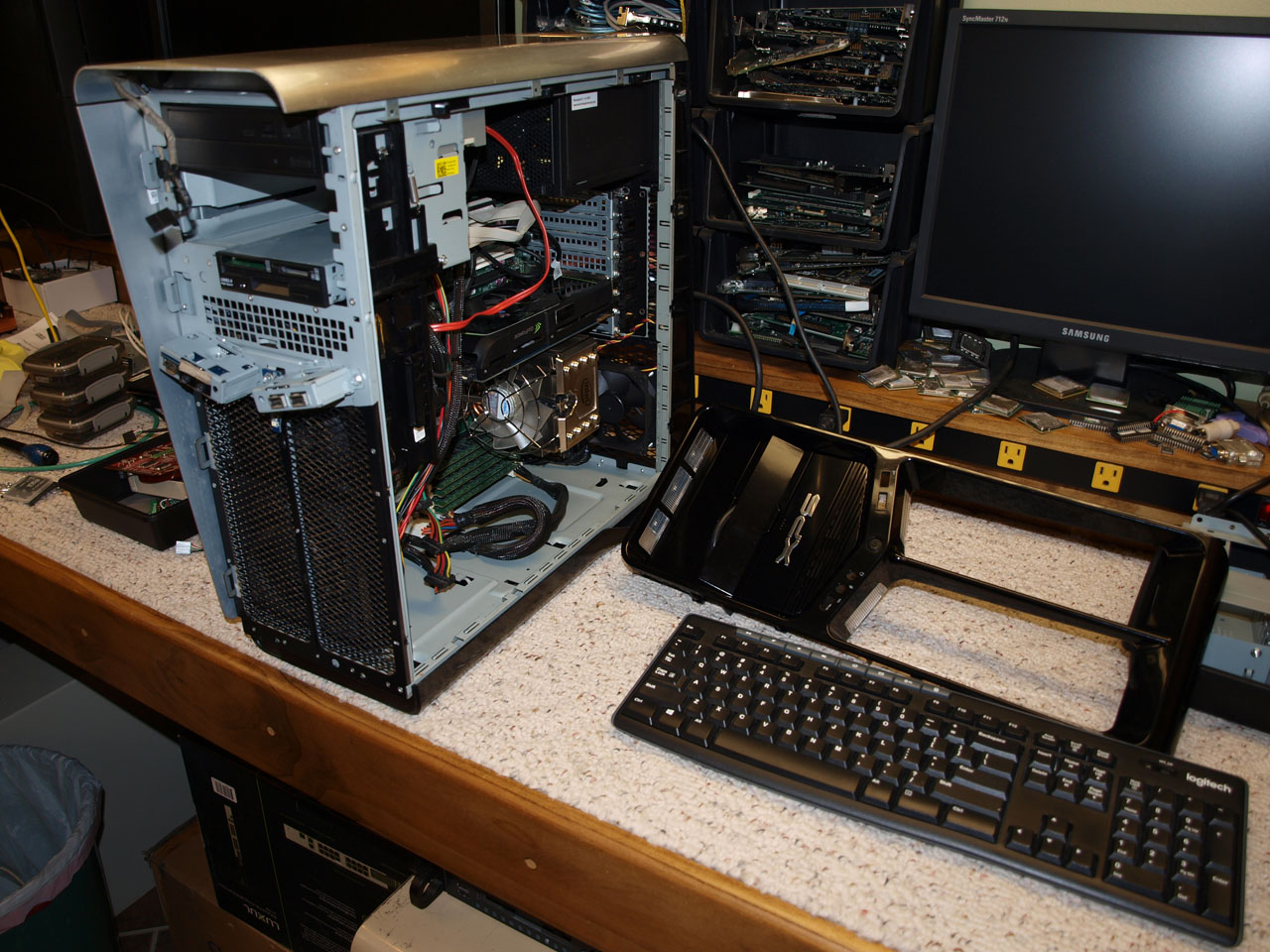

Now we get into it.... Time to take this thing apart.....

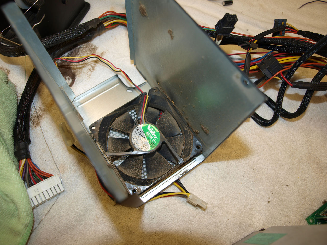

Even more filth:
Cob webs...

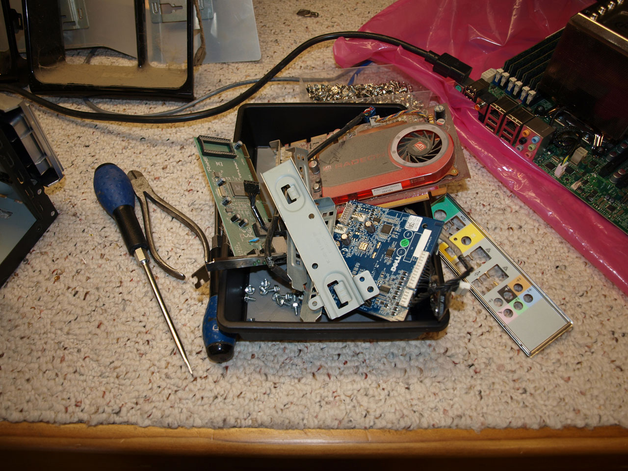

No idea what GPU this is.....don't really care either.

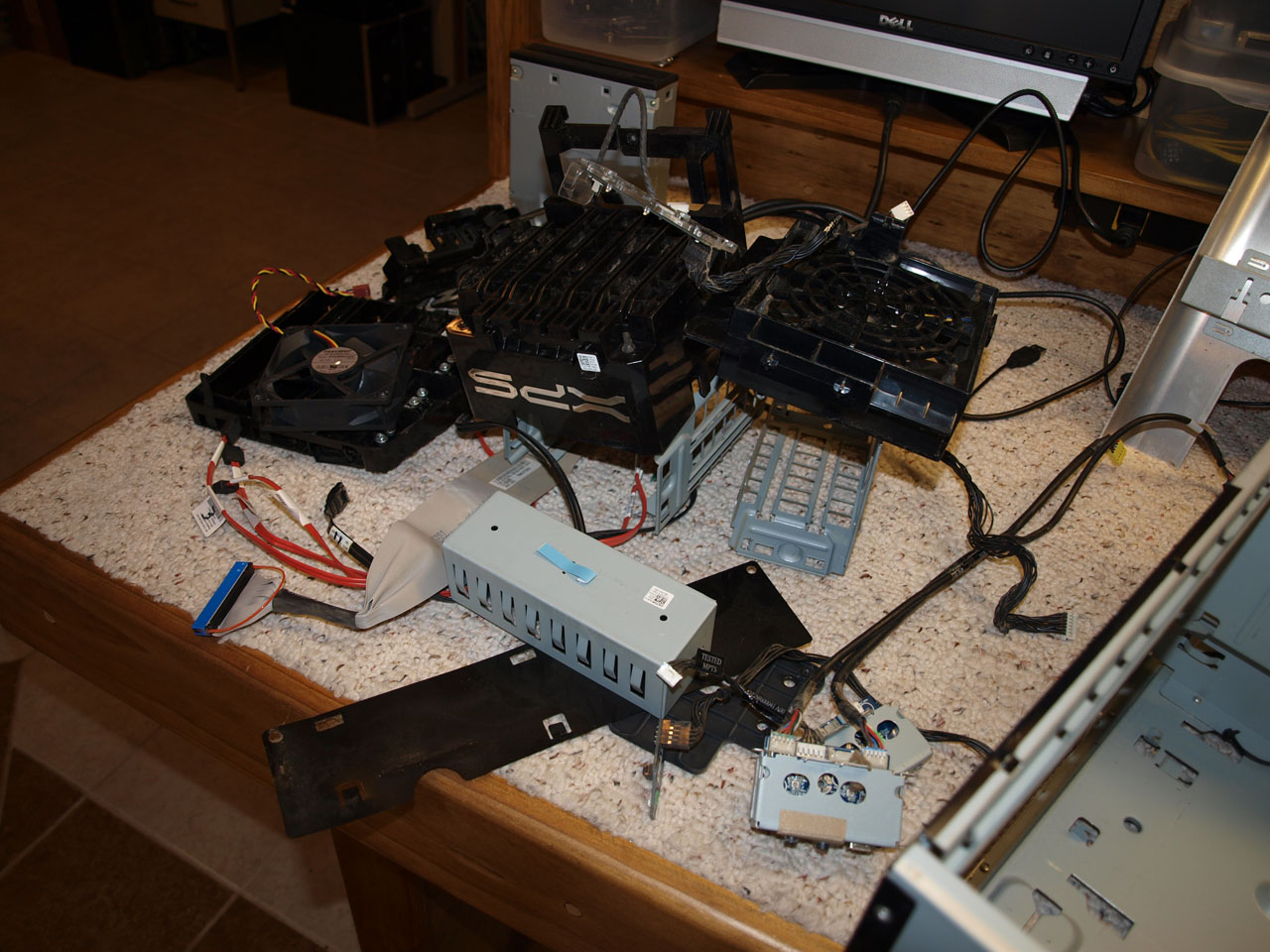

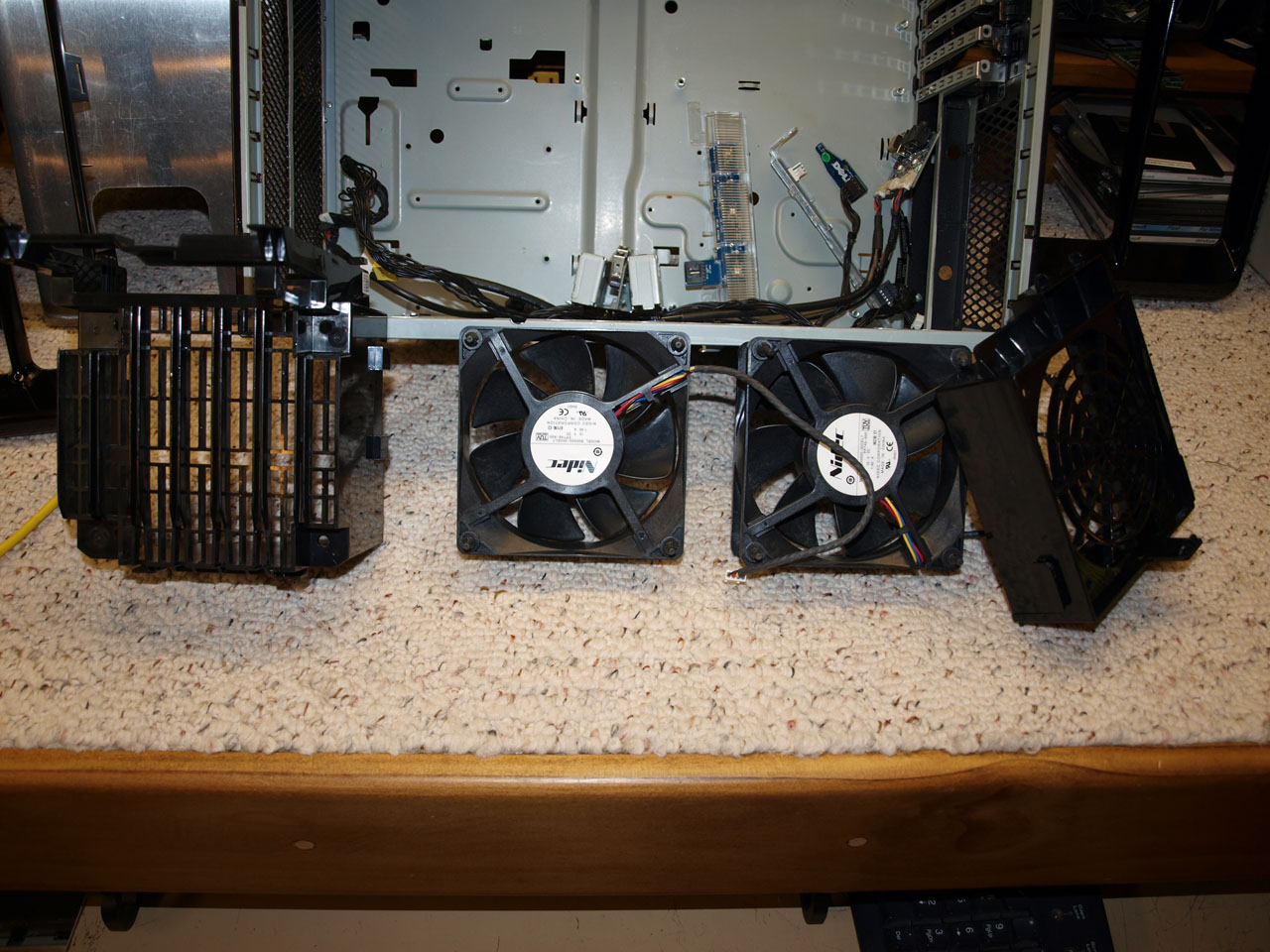

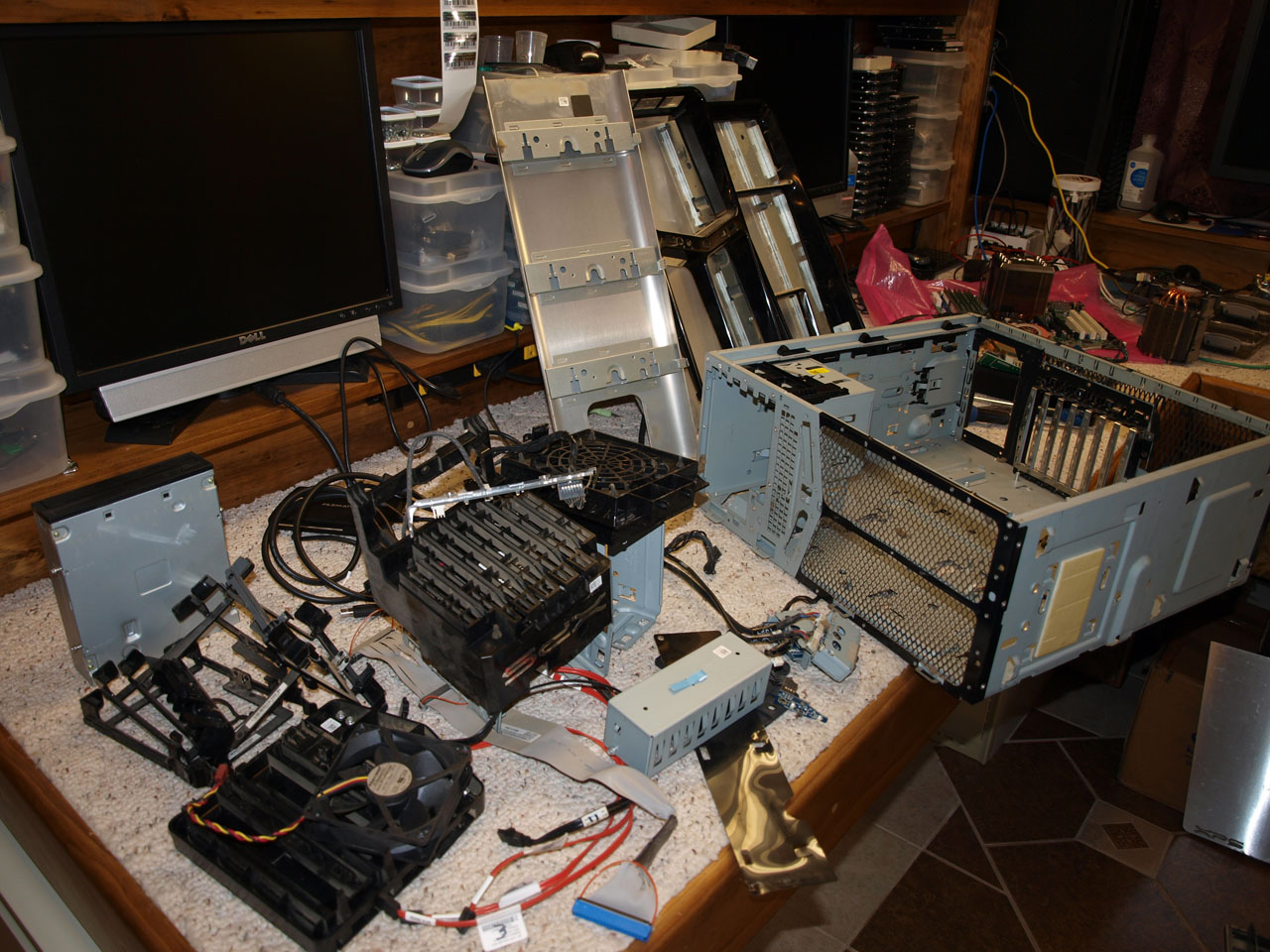

Pile starts....

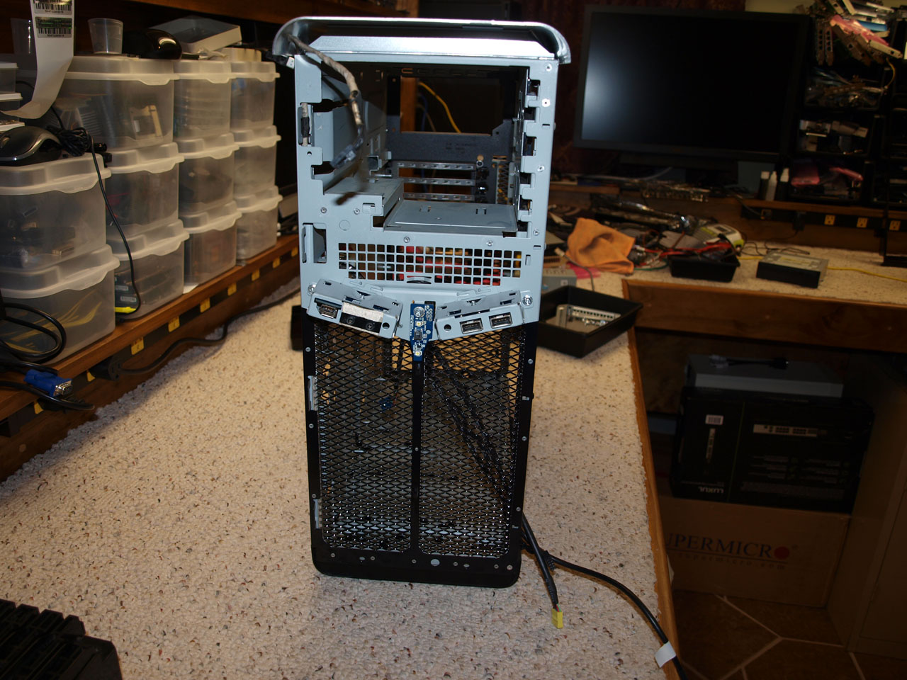

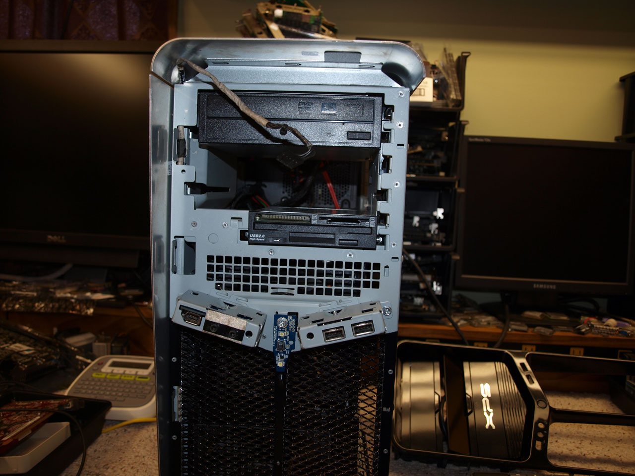

The lighting & front panel controller. Thankfully this isn't dependent on the motherboard for anything. Just give it power and it works, so any modifications will be minor or nill.

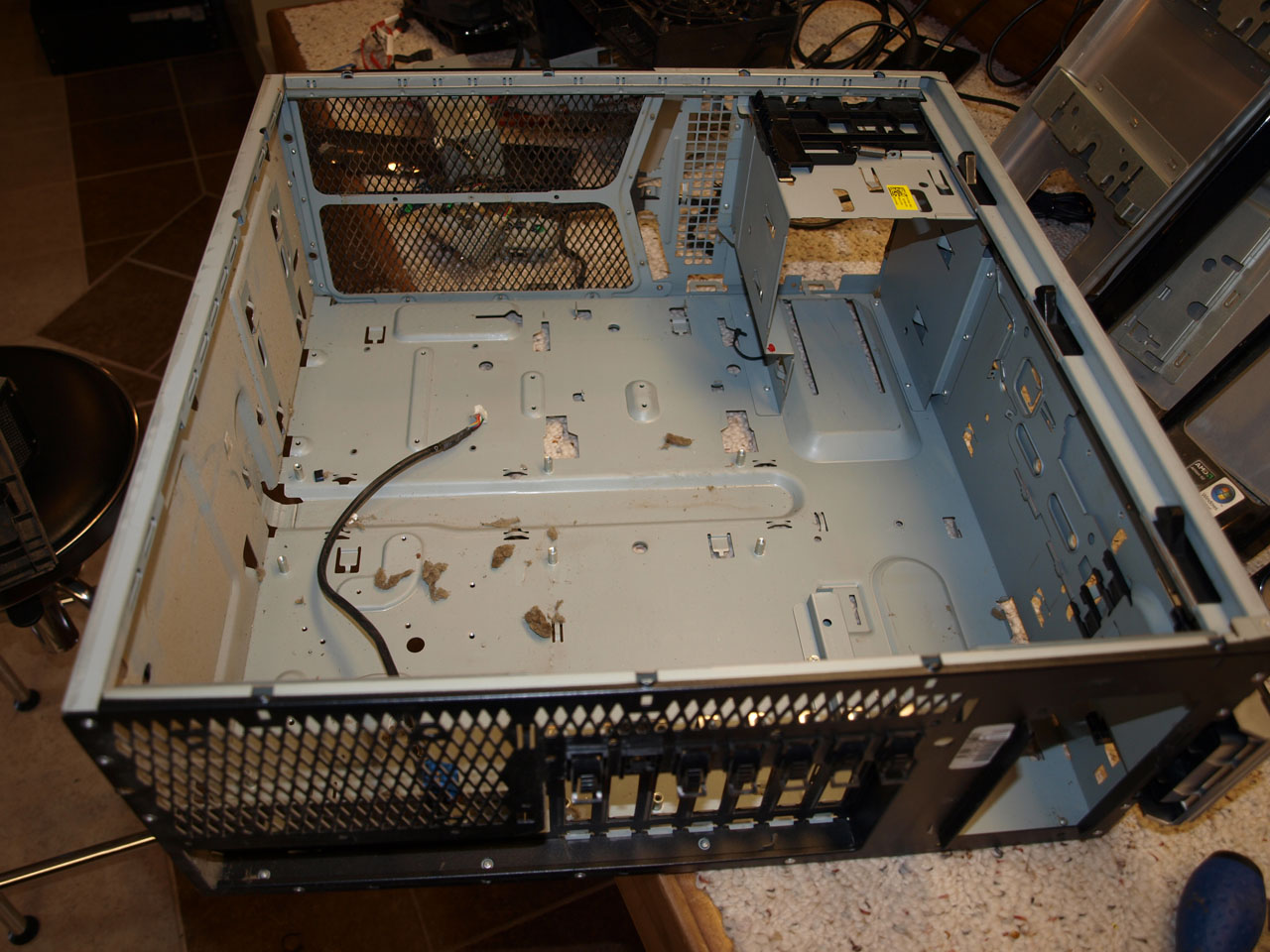

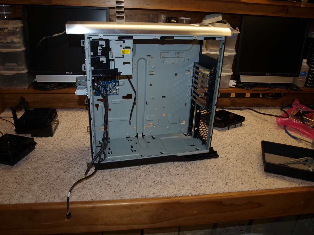

Now the motherboard removed....

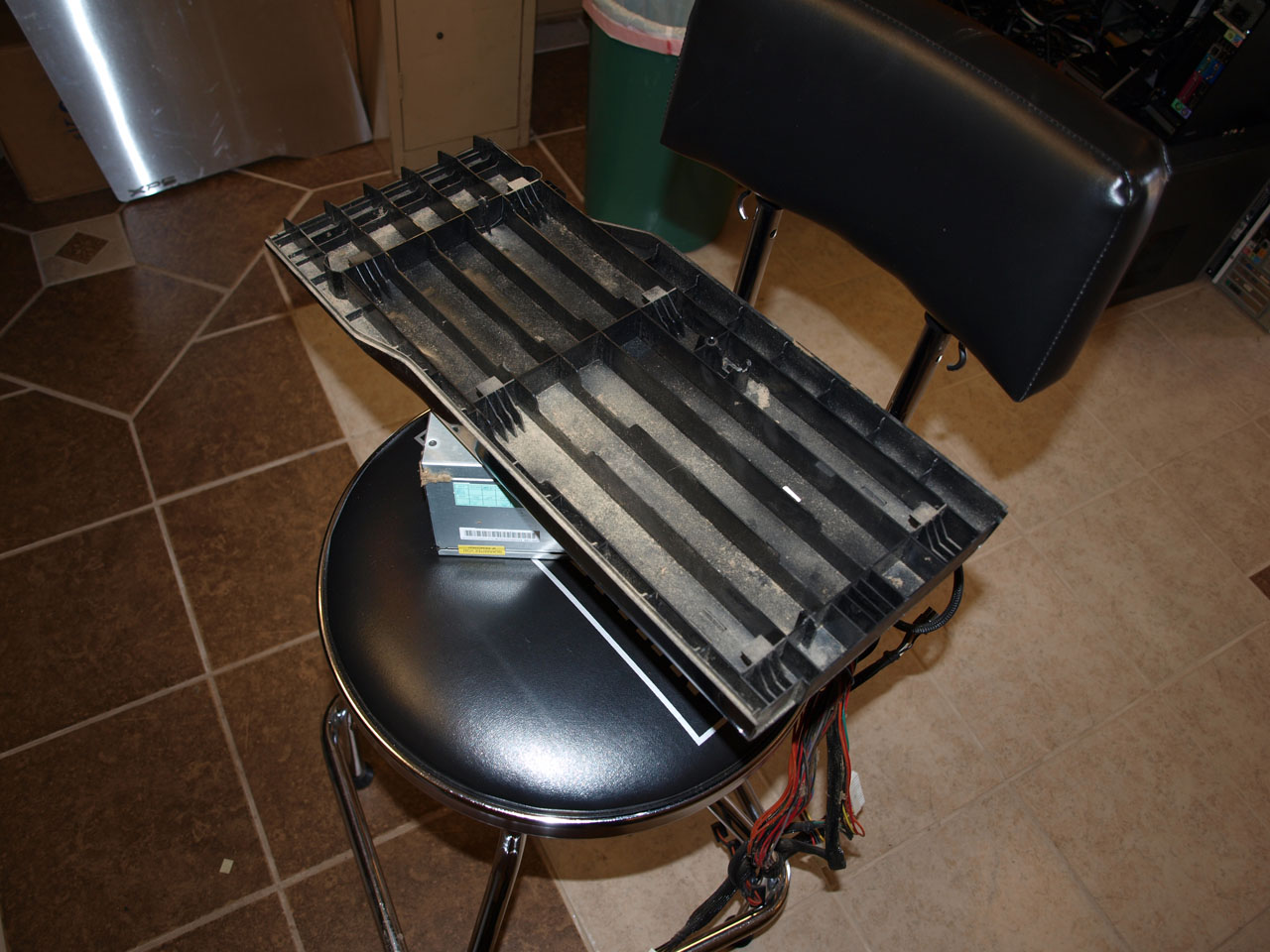

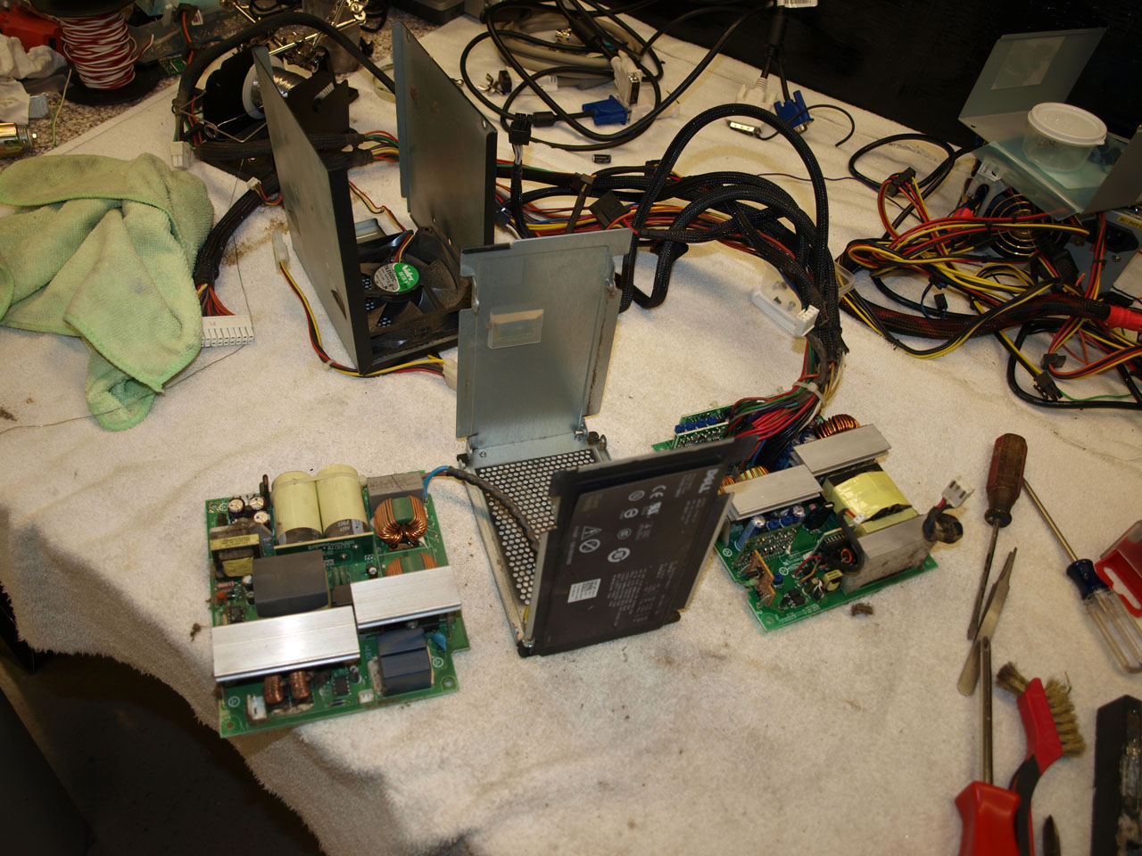

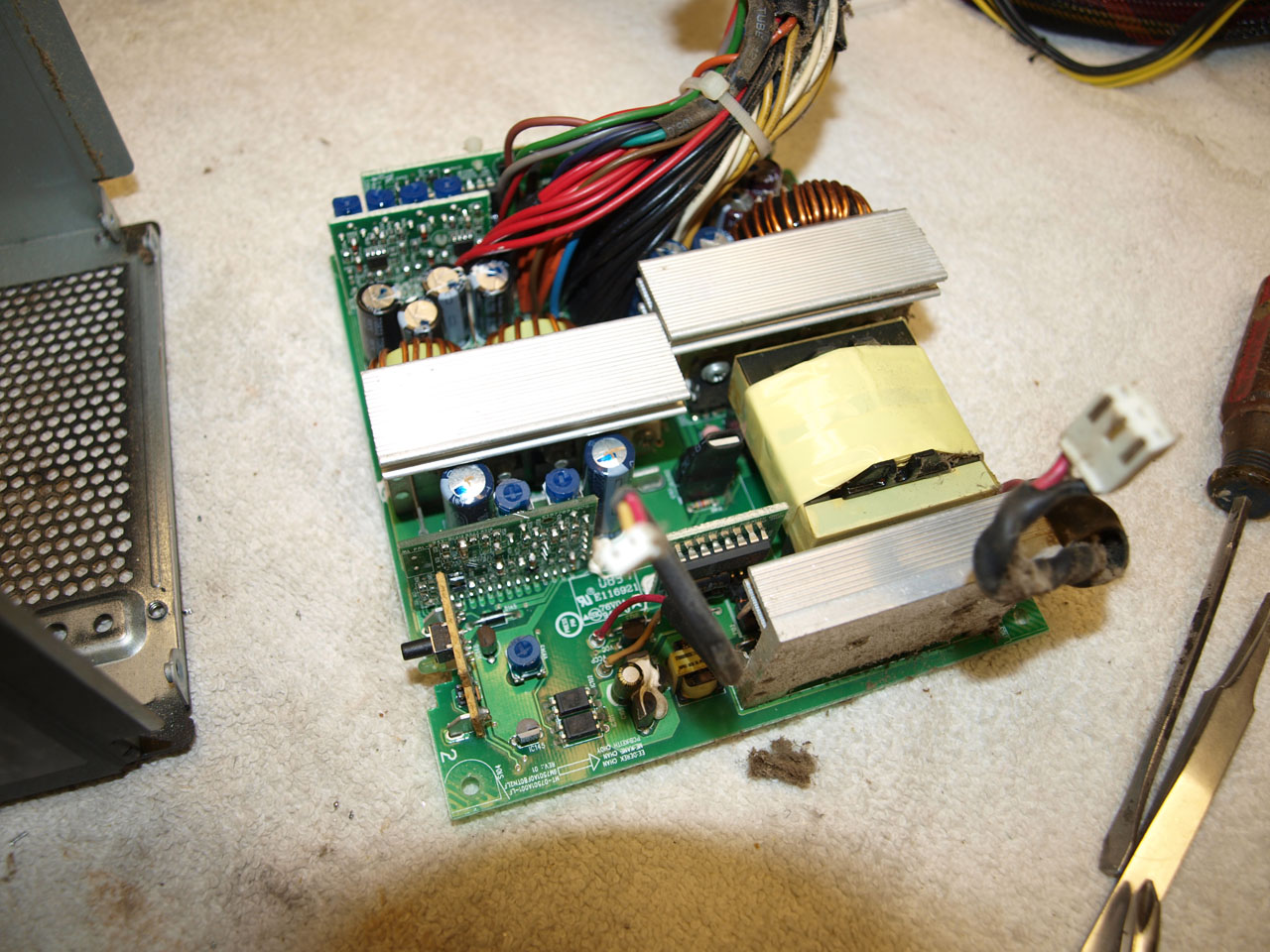

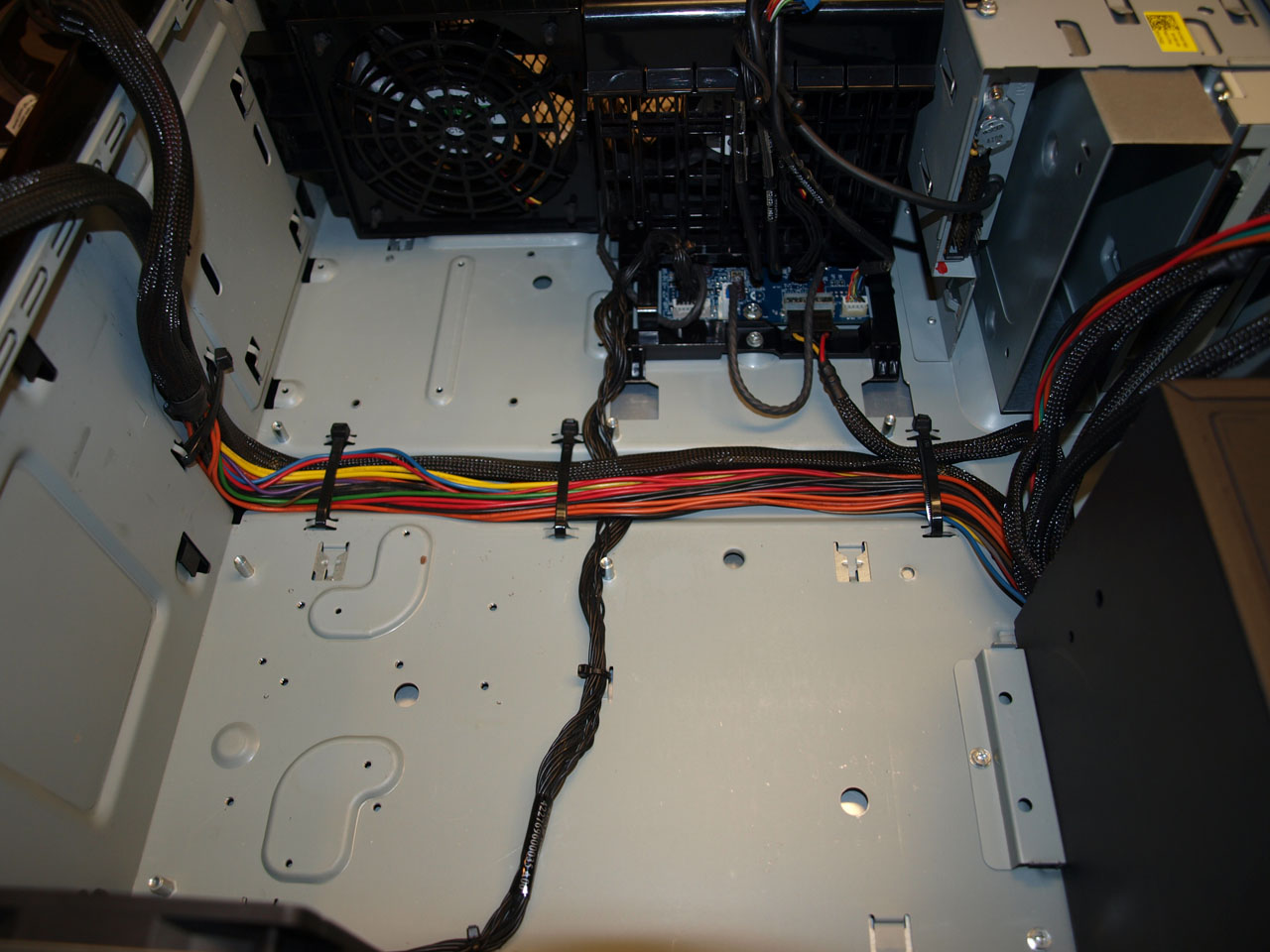

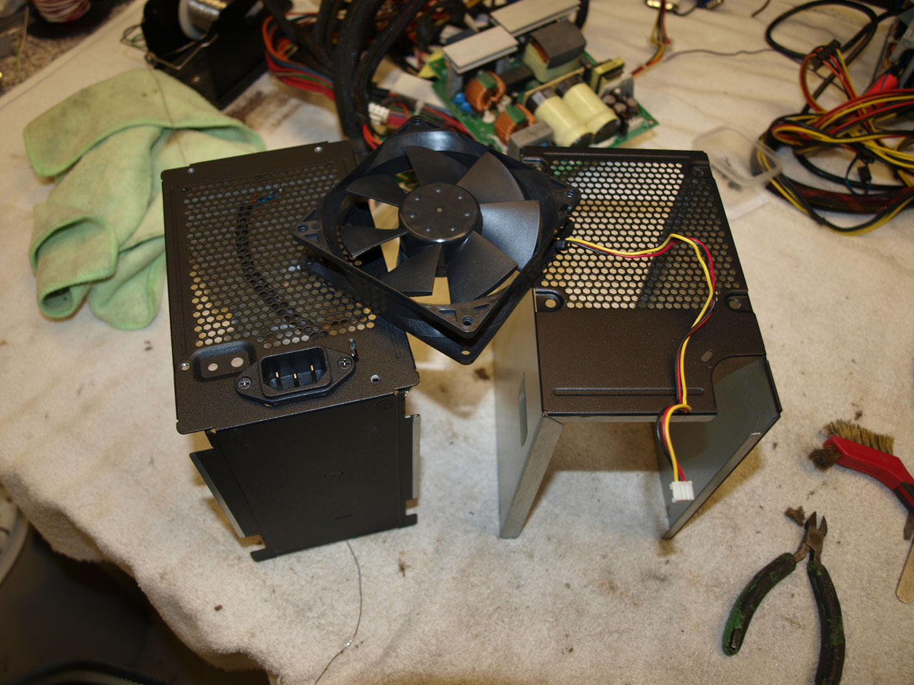

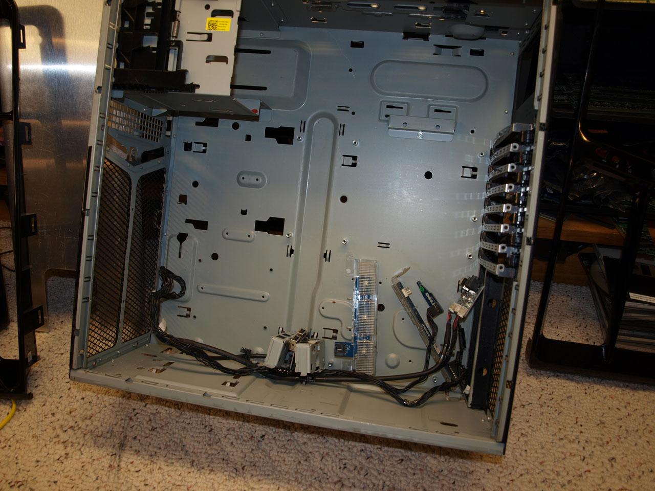

Clever design with that wire channel under the motherboard, but it'd sure be a PITA if you ever had to replace just the PSU!
Motherboard Removed.

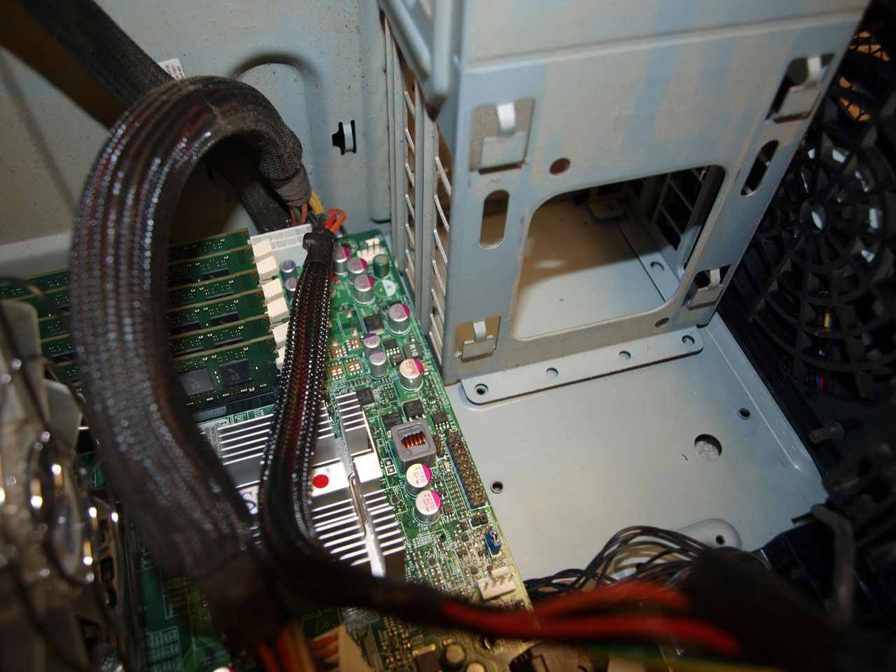

CPU stuck to the sink and the backplate...

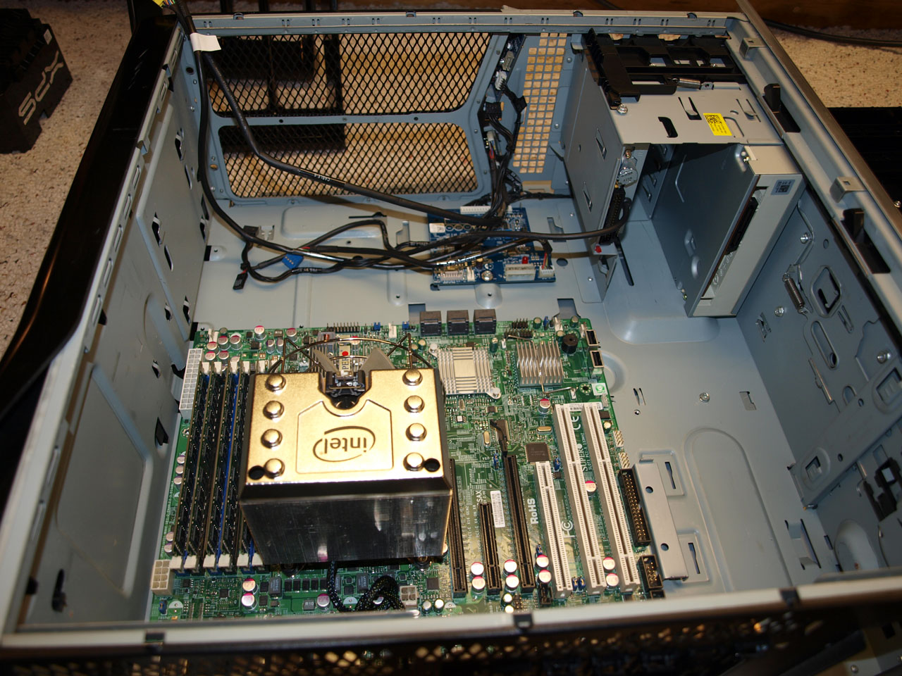

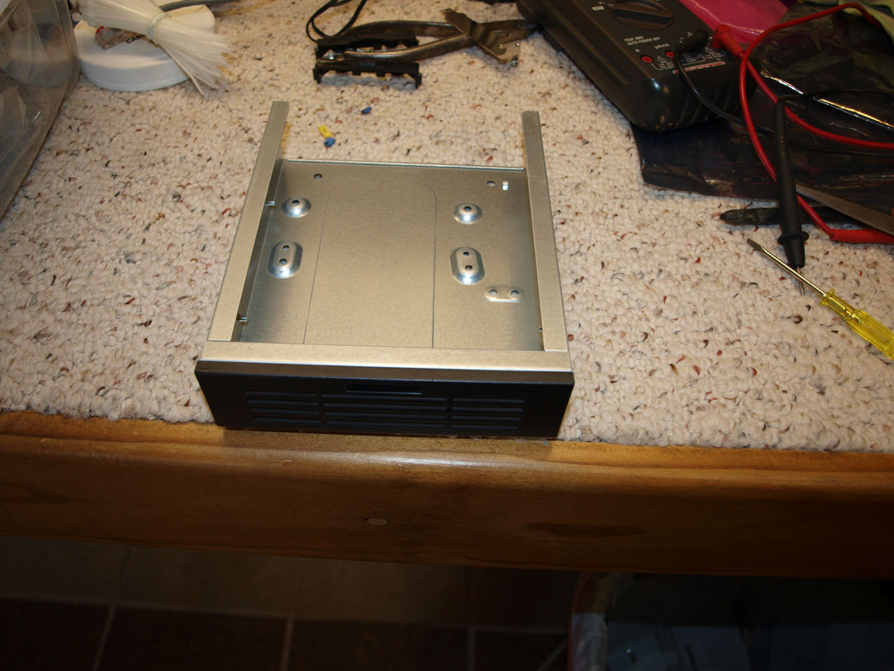

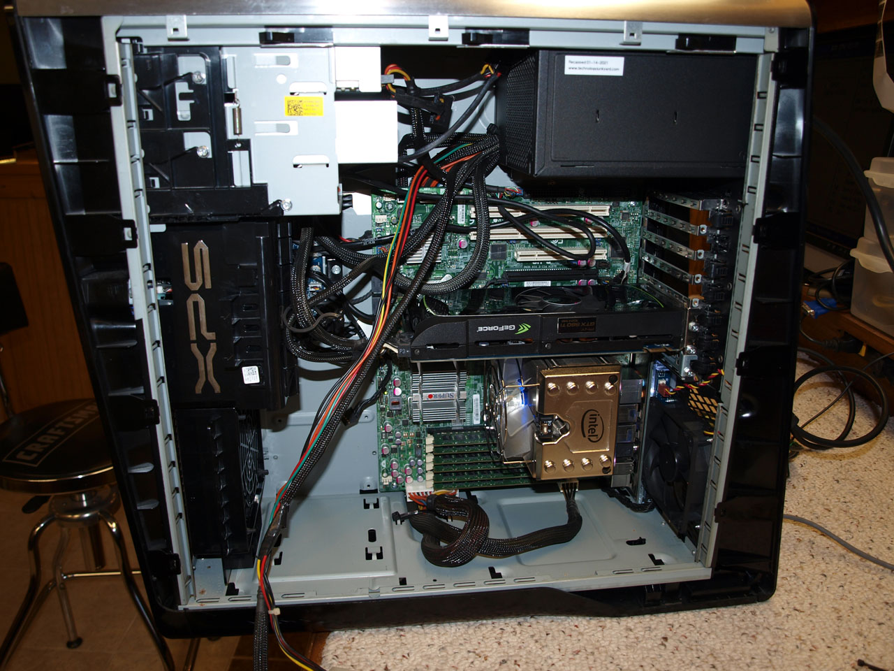

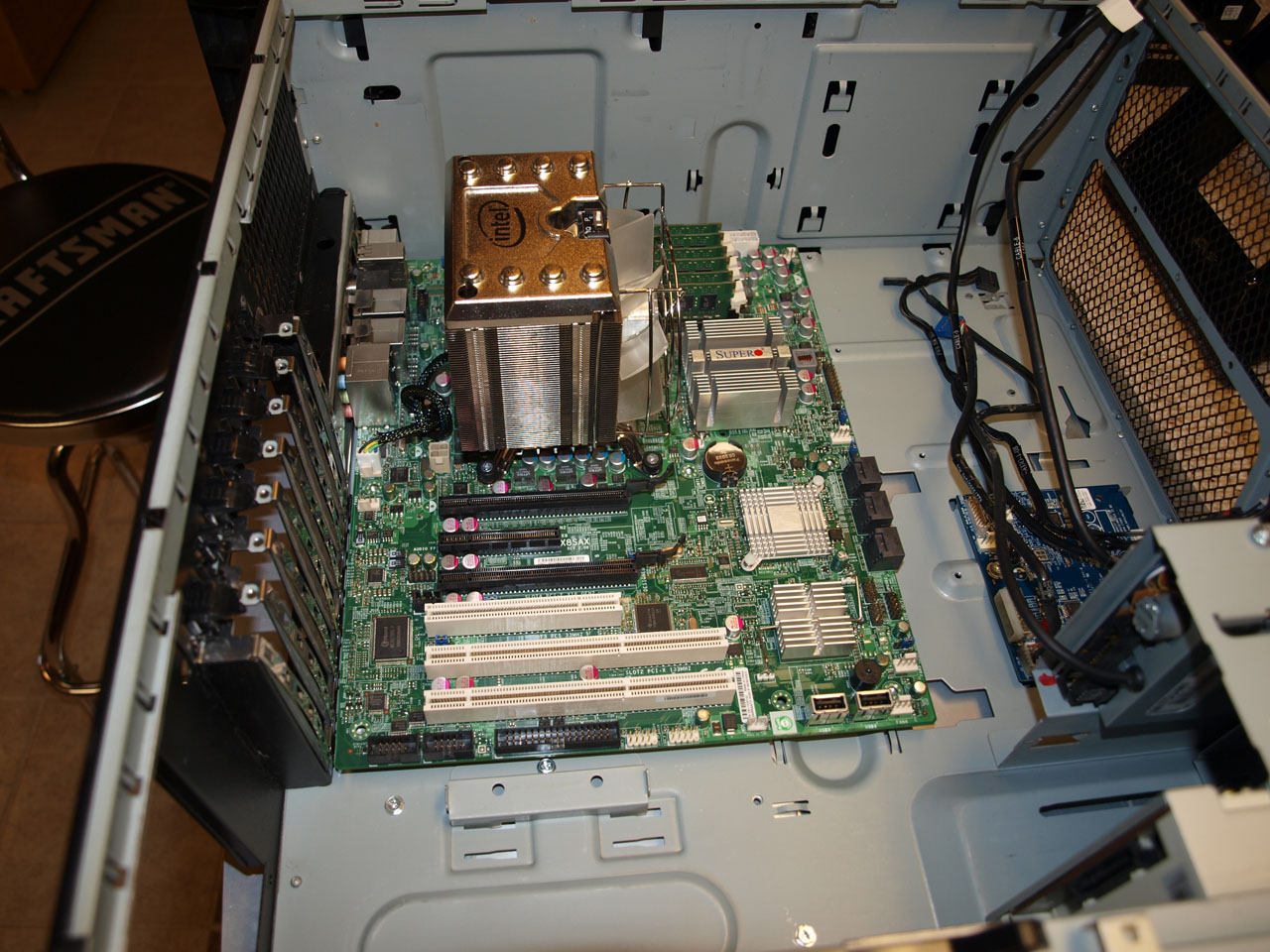

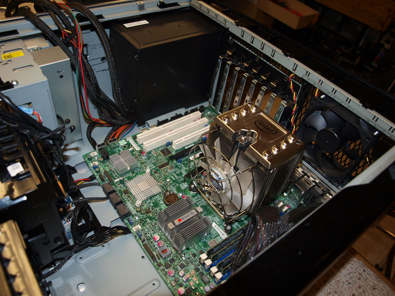

Test fitting X8SAX. The board is ~3/8" longer than the original, which clears everything just fine except the HDD cages. It will have to be modified, but the mod will be very minor.

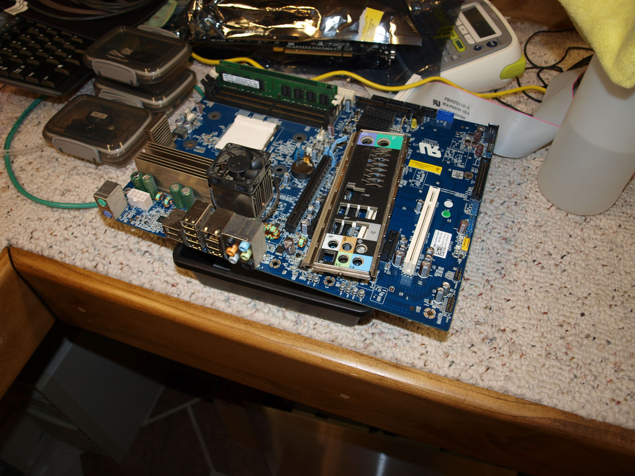

This board works, but the NIC is dead. It had a PCI adapter in it....probably see if I can offload it somewhere for cheap.....but otherwise it's probably scrap.

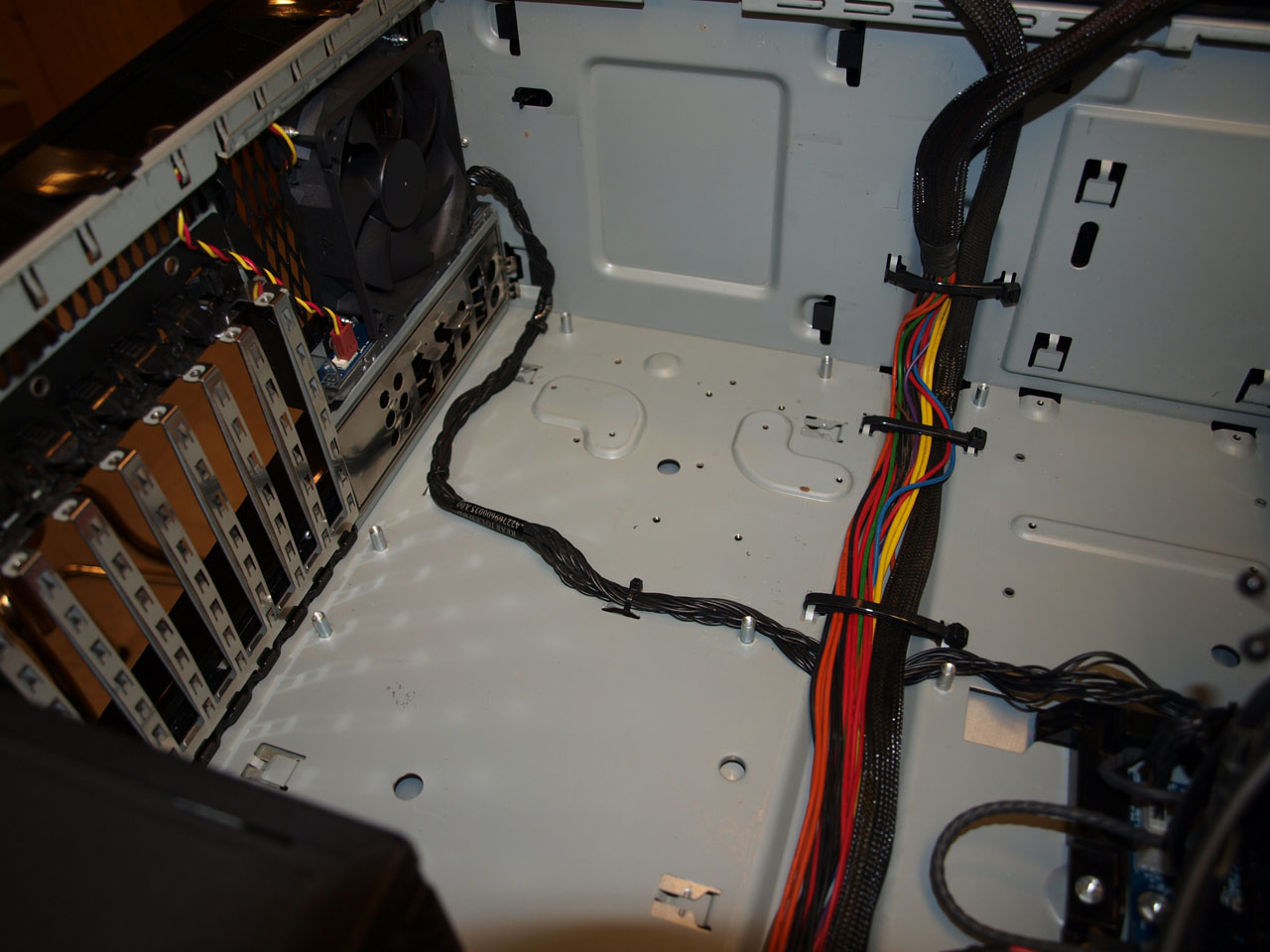

Cover off the wiring channel.

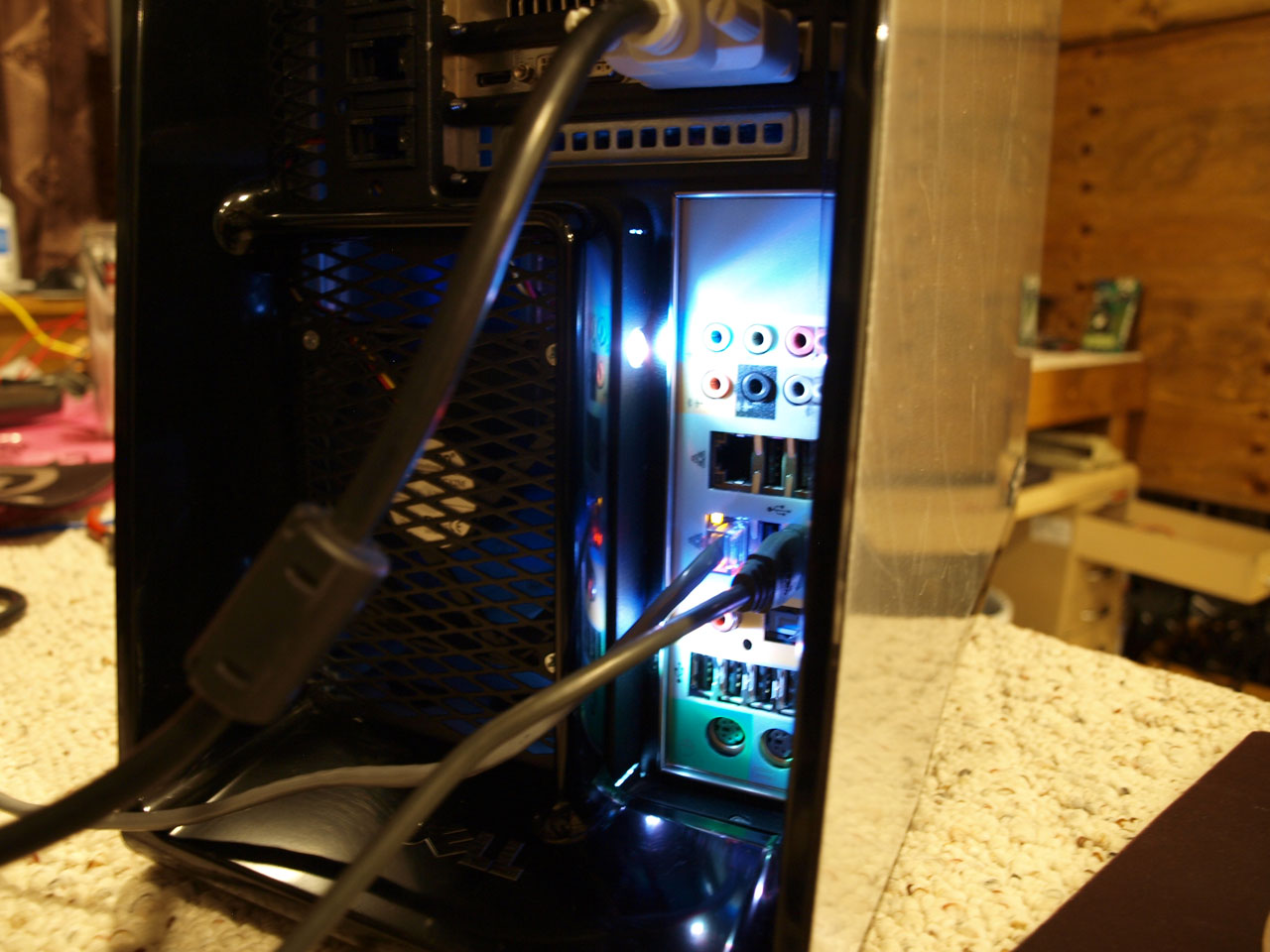

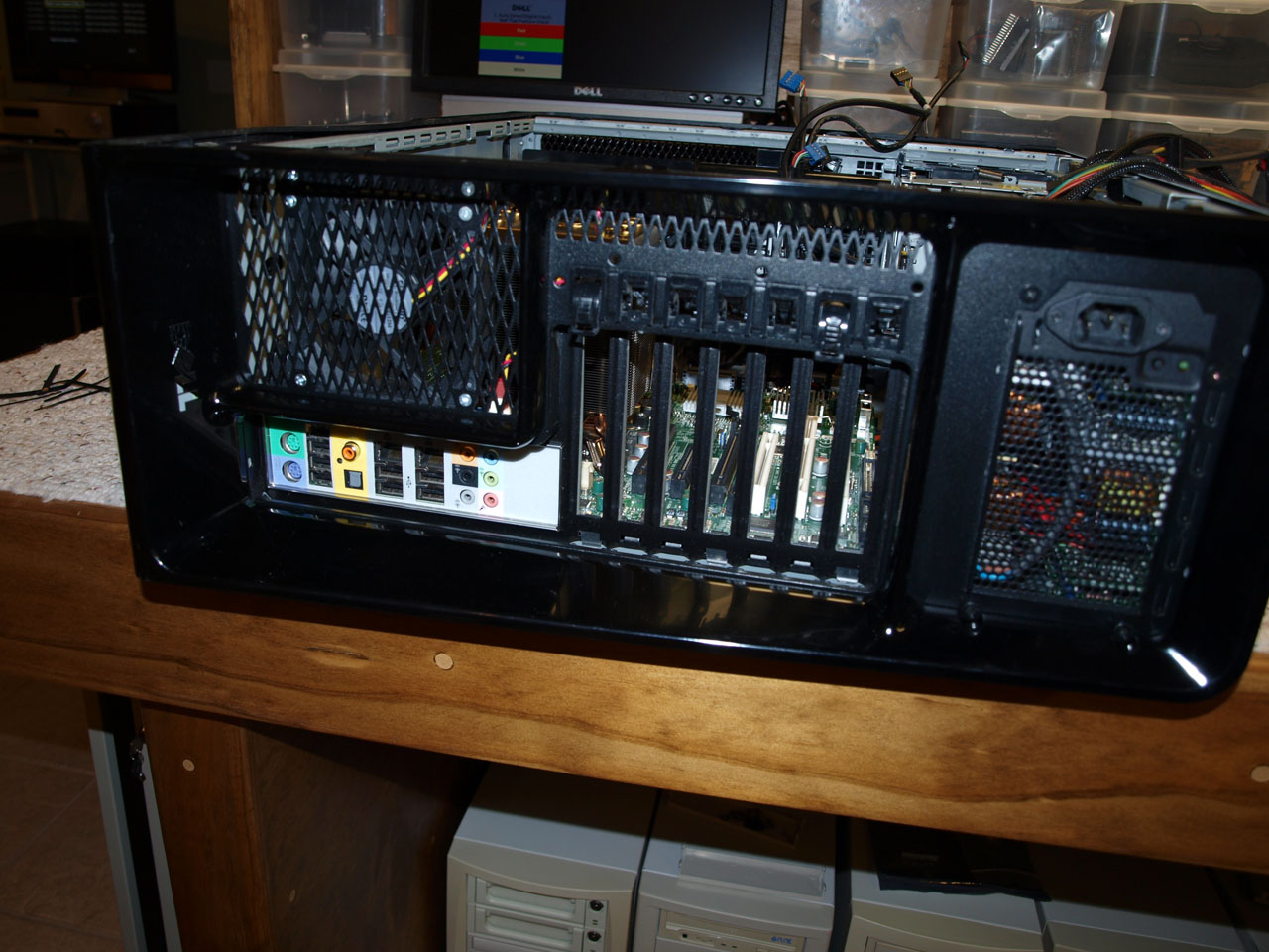

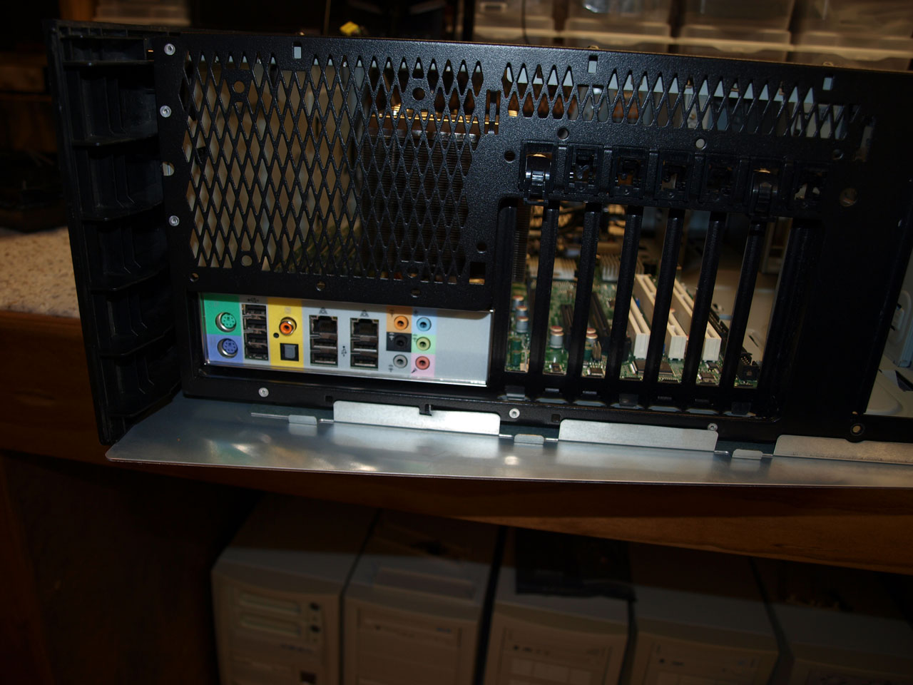

IO shield area lights; otherwise a standard IO. A couple standoffs will have to be modified, but overall the mods to the case will be very minor.

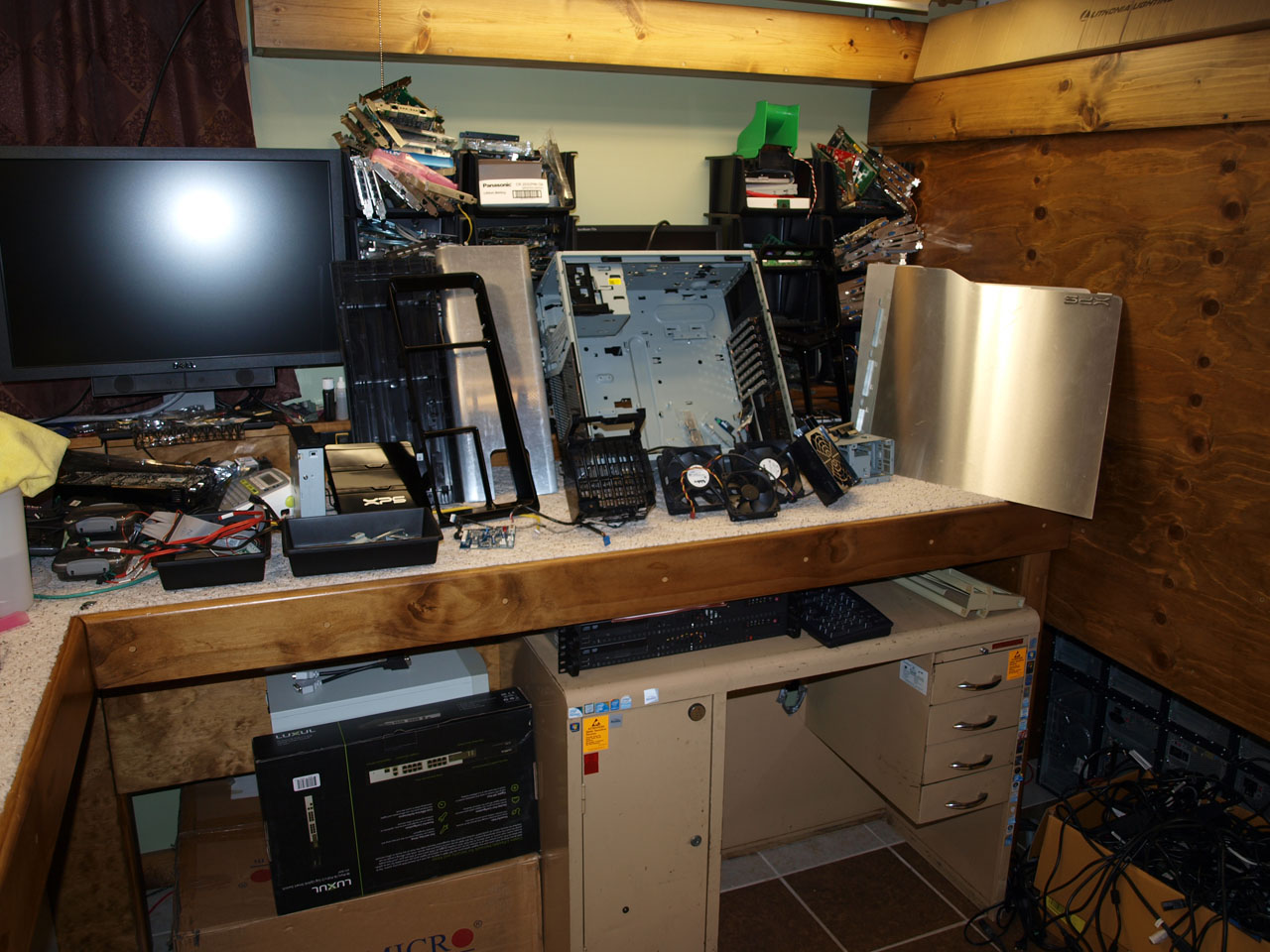

...and this is where I'm leaving it today.....chowtime!!
More later.

GTX560TI 1gb.
