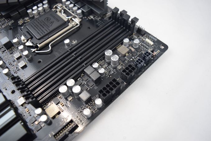

                      An Asrock ATX12VO motherboard.
                      An entire VRM on the motherboard. I have trust issues with SO double package mosfets, and this has plenty of them
                        Re: Intel introduces ATX12VO spec eliminating 3.3 and 5v
                        that kind of looks like an xbox-one
                        wait till a fet shorts and you have to work out which one and actually replace it!!
