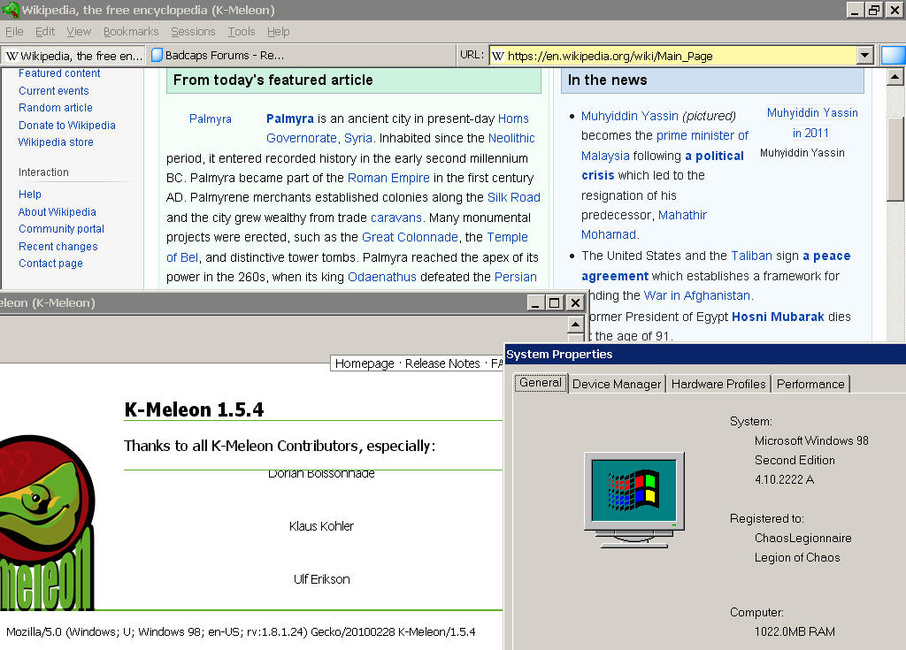

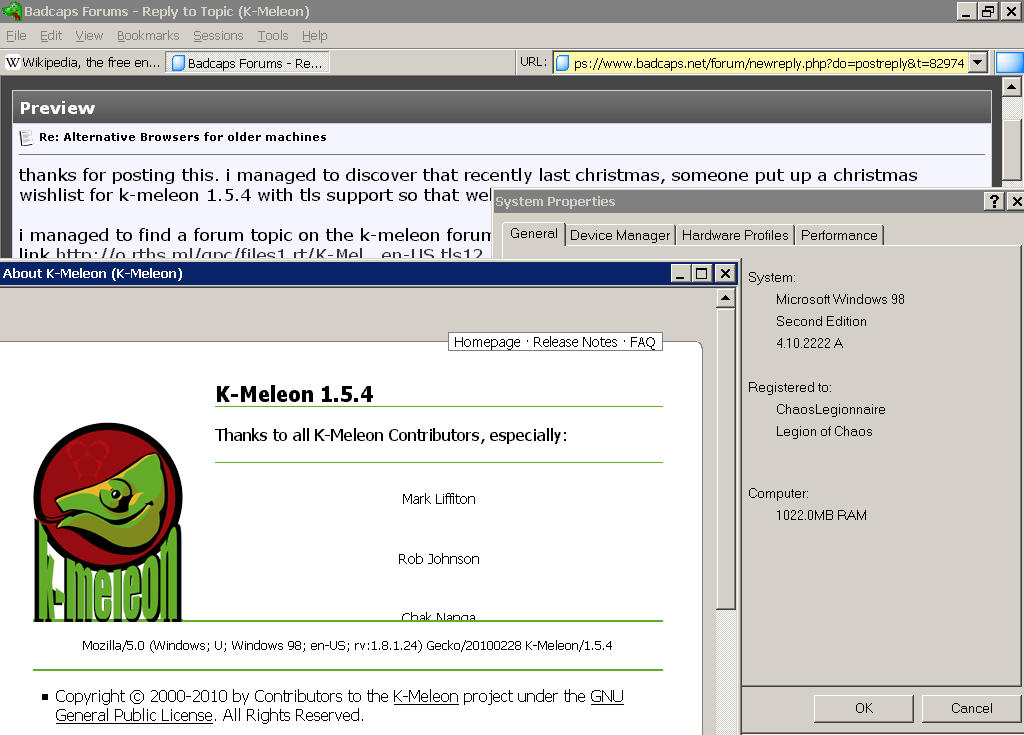

                              thanks for posting this. i managed to discover that recently last christmas, someone put up a christmas wishlist for k-meleon 1.5.4 with tls support so that web 2.0 is accessible again on win98 machines.
                              i managed to find a forum topic on the k-meleon forums to download this k-meleon 1.5.4 with tls. here is the link http://o.rths.ml/gpc/files1.rt/K-Mel...en-US.tls12.7z
                              im now using this to access both bcn and wikipedia (both require modern encryption) with no issues. please view the attached images. thats really nice! tho some webpages still dont display correctly but its fine. rock on!
                              of course, im posting this msg from k-meleon 1.5.4 in win98se.
