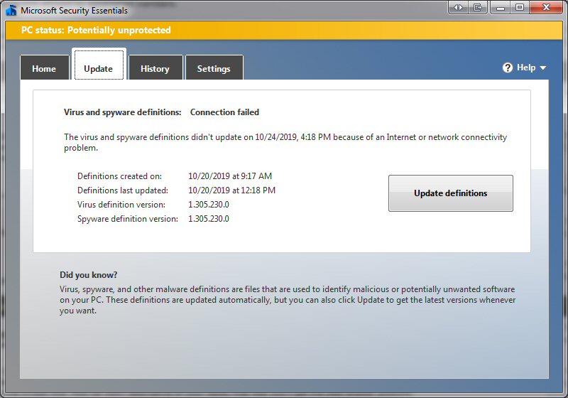

    M$ Security Essentials (MSE) Stopped updating 3 days ago....
    ....with network error (the network is fine), on all systems in my fleet.... No clue as to why. All Win7 machines. Even attempting to do manual definition update does not work...

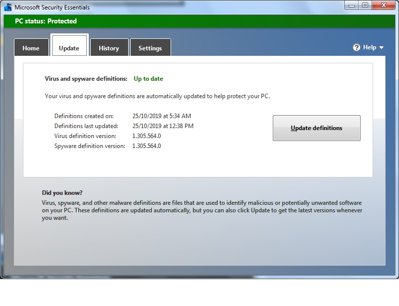

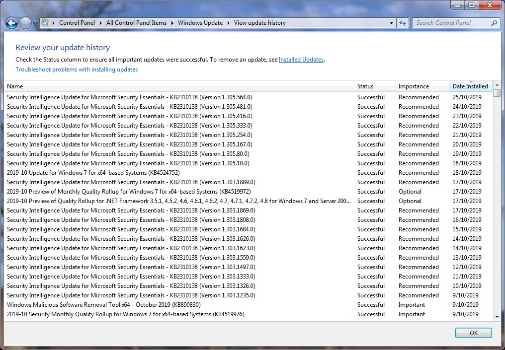

    Re: M$ Security Essentials (MSE) Stopped updating 3 days ago....
    Just checked a couple windows 7-64 pc's and MSE is up to date 10/24/2019 : def_ver: 1.305.553.0

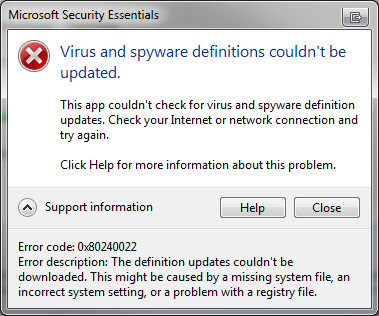

      Here's the errors I'm getting:
      It seems to download everything, but when it goes to the install portion, it shits the bed with the following.
      Here's the info:
      I called a friend (out of state) and asked if his was working, he was getting the same errors I am.
        I think the fault could be with windows root certificates and not mse, Check that error code on line.
        Can you manually install the definition update? from here: https://support.microsoft.com/en-ca/...or-microsoft-s

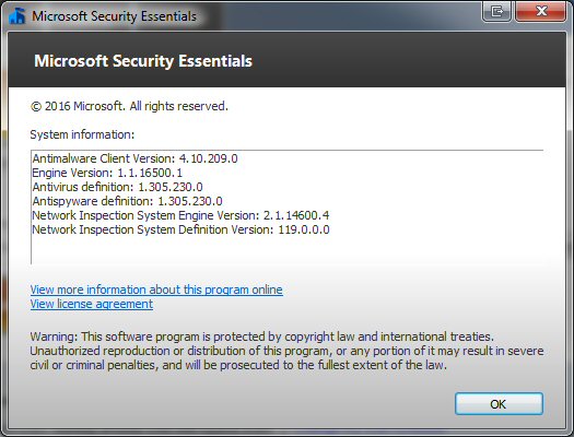

            Working OK here
            Have you installed other updates? - if not, who knows what dependencies may be involved
            Here's my details, couldn't work out how to get Info pic you've shown

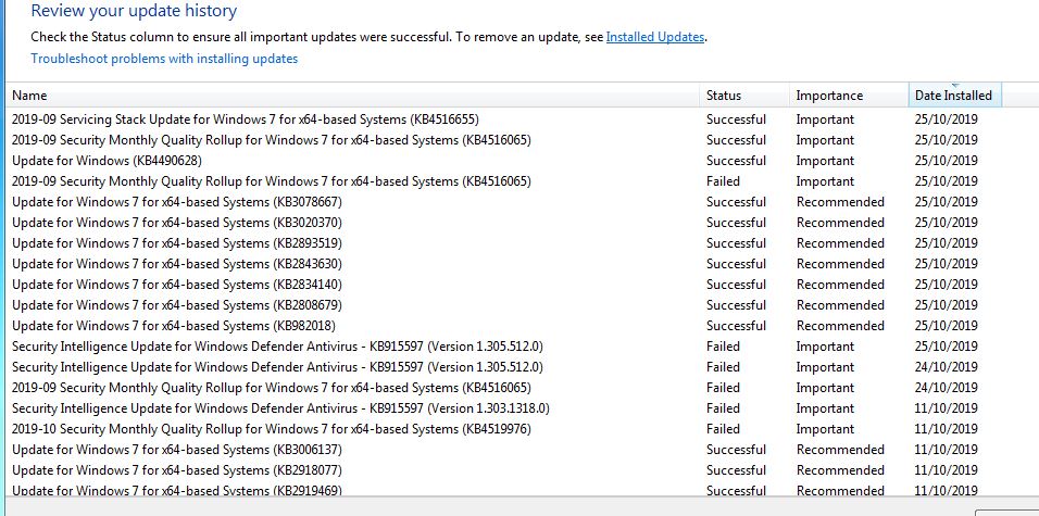

                    Windows Update is SHA2 only from now.
                    You need to patch the system, but make a backup first.
                    I had to recover a system that installed the August monthly rollup because that patch broke UEFI boot in Win7.
                    A workaround was to have KB3133977 already installed, or the "Win7 post SP1 rollup" patch KB3125574 which includes it.
                    This should be fixed in the currently available patches so backup and try to patch...
                        The security rollup (KB4056894) fixed it. I really thought I had the rollup installed, it contains the 'wannacry' patch.....but turns out I only installed the standalone for 'wannacry'....that's what threw me, I thought I had the necessary patches installed....well silly me!!
                        Thanks fellas!
