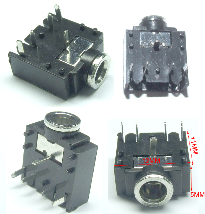

                        Oh well, the jacks are indeed 5 physical pins, 4 needed (the ones at the base).
                        I've been on and on about this (and still am, mind you), since I really don't have enough time on a single moment to stay and think this thoroughly. Hence the long period of time of me on-and-on-ing.
                        It's what it is. If you don't like the fact that I cannot allocate more than 10-15 minutes daily to think about electronics, ask my school system for a curricullum and for the schedule of a 10th grade student.
                        I don't want to comment on politics on an electronics forum, so I'll answer your question the best I can:
                        • Every single one of the 3.5mm female jacks I see in computer cases nowadays are completely plastic, with nothing grounding the male jack. Once I take a look inside them, I find that they are N-O, meaning the pins in the center (10 and 11 in the picture linked below) are disconnected from each other, meaning there is nothing returning to the soundcard when a male jack isn't plugged in. When plugged in, they make contact and return 5V
                        • Every single one of the 3.5mm jacks I've bought have the pins on the side (2 and 3 below) connected to the pins in the center (10 and 11 below), meaning when a male jack isn't connected, they return the sound they receive back to the soundcard. When a jack is plugged in, they don't make any contact.
                        Both of these designs have a pin for GROUND and 4 other pins below that GROUND pin for audio and jack detect systems, just as in the picture linked below.
                        Both look like seen in the image attached, only difference being that the N-O jack has that circular tip made from plastic, not from metal.

                        • eccerr0r
                          Solder Sloth
                          • Nov 2012
                          • 8701
                          Re: How ca I use an SPDT 5V relay to reverse NC switch in 3.5mm jack?
                          Ahh I see now with that picture, these are the standard NC jacks one would buy. The key issue I'm worried about is that the NC jacks are not isolated, what you want is a NO jack that's isolated - the standard "HDA" jack, apparently.
                          I still don't understand how you got around the problem that these NC jacks are part of the signal path. Adding a voltage source will short out the normal function of the signal pins. Unless you chose to keep left or right channel unconnected? Is that how you did it?
                          If I ended up with this dilemma I'd probably end up with some complicated circuit to detect plugin (if the drop >0V most likely), or there would be a toggle switch somewhere on the chassis and forget about autodetect...heh.

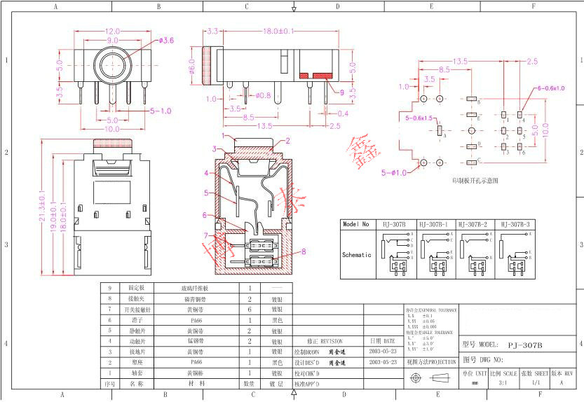

                            • R_J
                              • Jun 2012
                              • 9551
                              This may not apply here. I am only suggesting this:
                              In the past I have used a PJ-307 jack, this jack uses a seperate switch that is not connected to the audio signal, it is available with either a spdt or a dpdt switch that is located at the rear of the jack
                              It can be connected as either N-O or N-C if the plug is inserted or not
                                It is a possible solution, but what made me suddenly go to an Arduino solution is the fact that the N-C jacks return audio, while they should return 5V. Couldn't this cause issues? Intermittent "connected/disconnected" problems?
