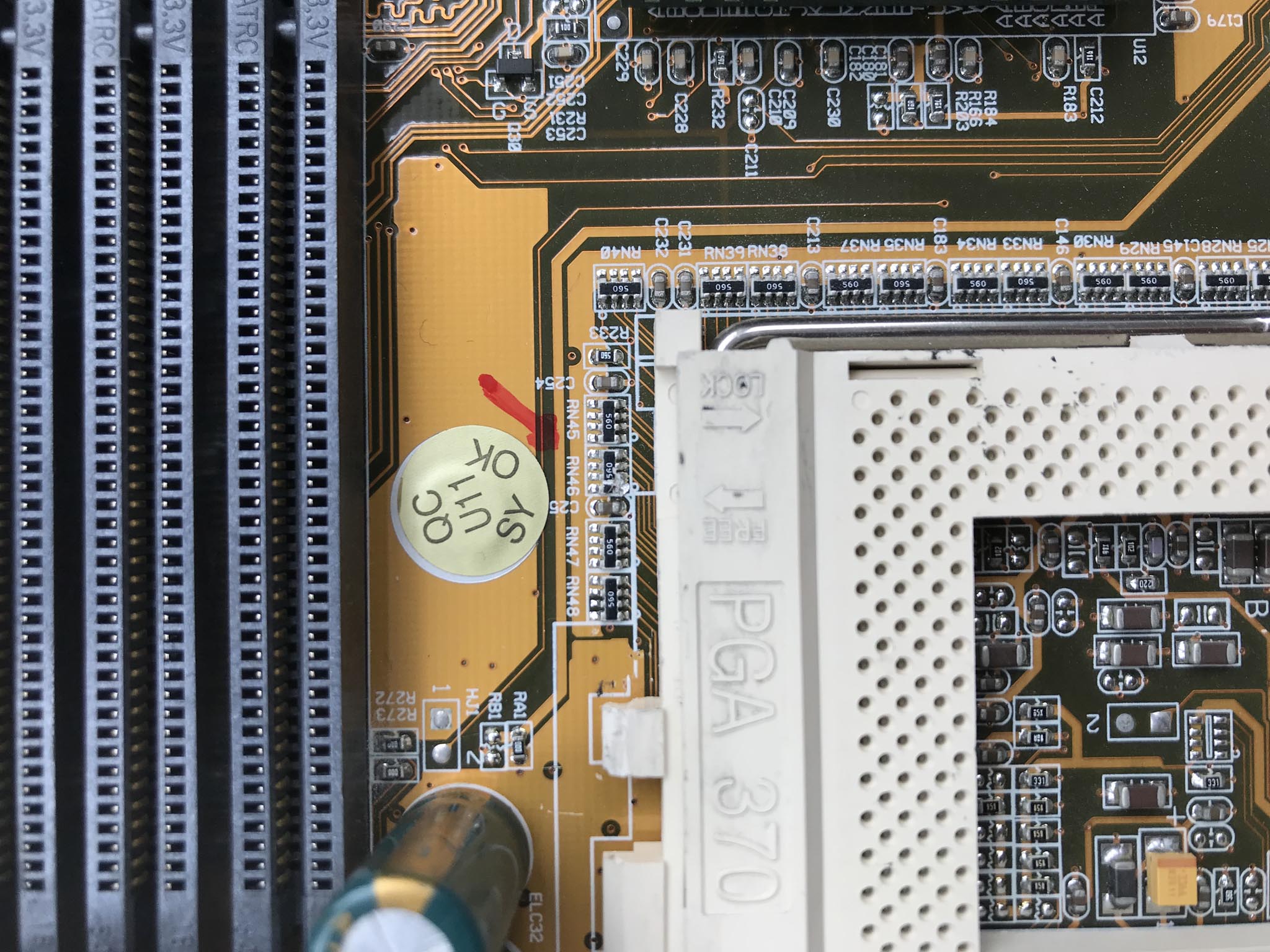

                              - A SOYO SY-TISU socket 370 motherboard.
                              It looked good and no bulging caps. Given the age and the brand of caps (Wendell), I expected at least some would be bad, so I started making a cap diagram for the motherboard. In the process of doing so, I discovered why this motherboard was likely marked as "not good":
                              ^ That's a damaged SMD array resistor for you. :|
                              Looks like whoever was trying to install the CPU heatsink "slipped" they screwdriver and damaged that resistor. The CPU socket clip on the other side also has a good chunk missing from it. I imagine the clip wasn't placed all the way on it, so it gave out, letting go of the retention spring... which then caused the damage on the other side.
                              I looked through my scrap pile of boards and PCBs and found a similar SMD array resistor, rated for 33 Ohms per resistor. But I damaged it during removal. Moreover, as I wasn't sure if 33 Ohms would be too low (considering the original one was rated for 56 Ohms per resistor), I chose to do the repair a different way.
                              Yup... that's four individual SMD resistors to the rescue. I know... but it worked! They were more or less the right value too, measuring about 60 Ohms each (came from an Xbox 360 motherboard - these are usually found around the memory chips.) Moreover, it was easier to do this repair with the individual resistors, because I could use my soldering iron instead of hot air. I did initially try hot air with my KADA 852D+... and just ended up melting/burning the side of the CPU socket with no other results (did I ever mention I ffffuu... HATE using hot air? )
                              Anyways, after doing this ugly surgery, I tested the motherboard with a 800 MHz P3 CPU from my HP NetServer E800. It worked first try with no hiccups!
                              Not only that, but this motherboard has really good OC and voltage control options: unlocked multiplier, unlocked FSB, and choose any voltage from 1.1V to 2V!
                              Just as a test, I messed with the E800 MHz CPU in there, and the board POSTed fine with it overclocked to 844 MHz and under-volted to 1.575V.

                                As for the Soyo, nice score. Be sure to recap it. With new caps, you have a nice OC board right there, Soyo's boards were quite known for that. I still have my 6BA+IV w/ HPT366, recapped with Rubies and sporting a 650MHz Coppermine (original Slot package, not Slotket)

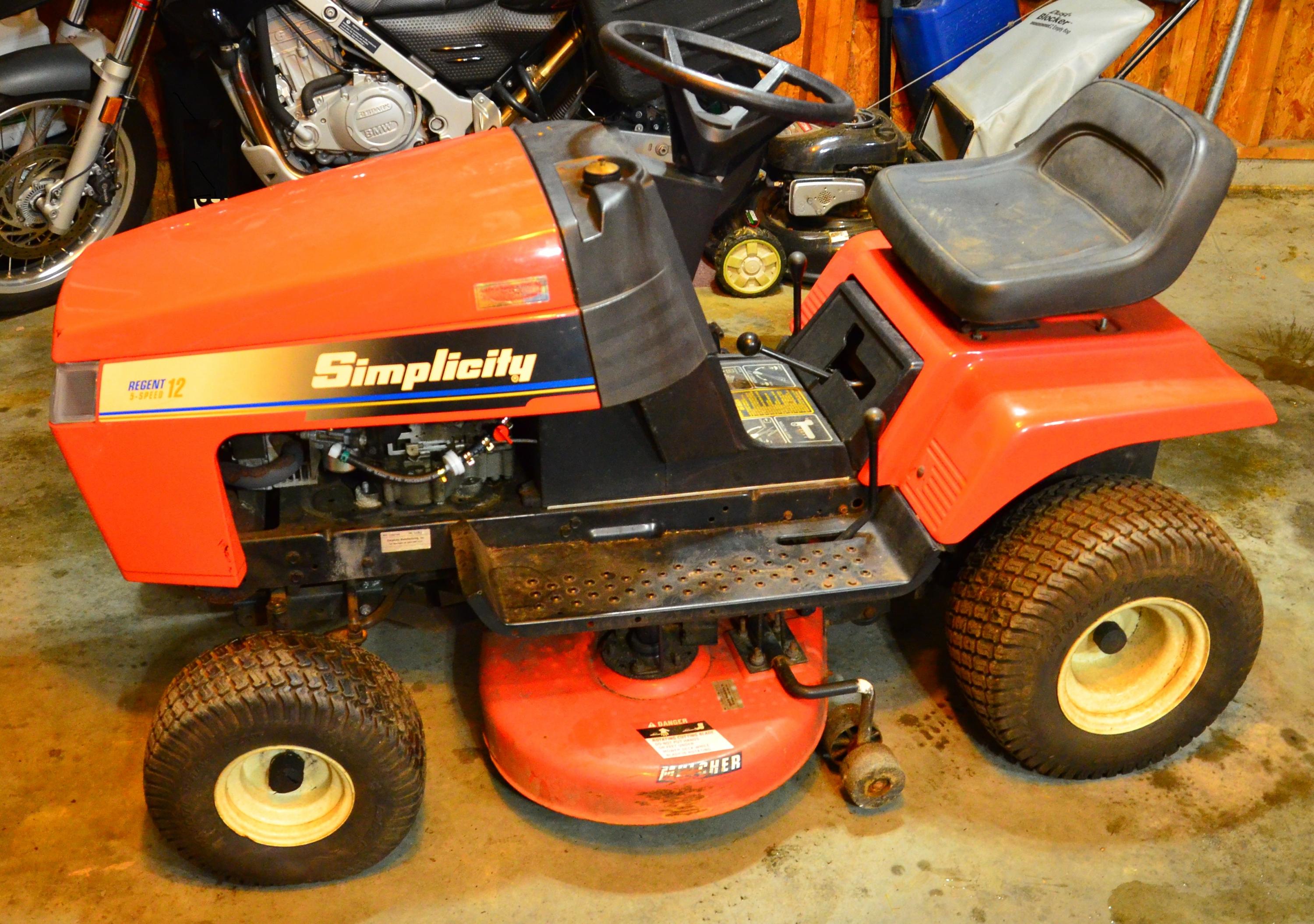

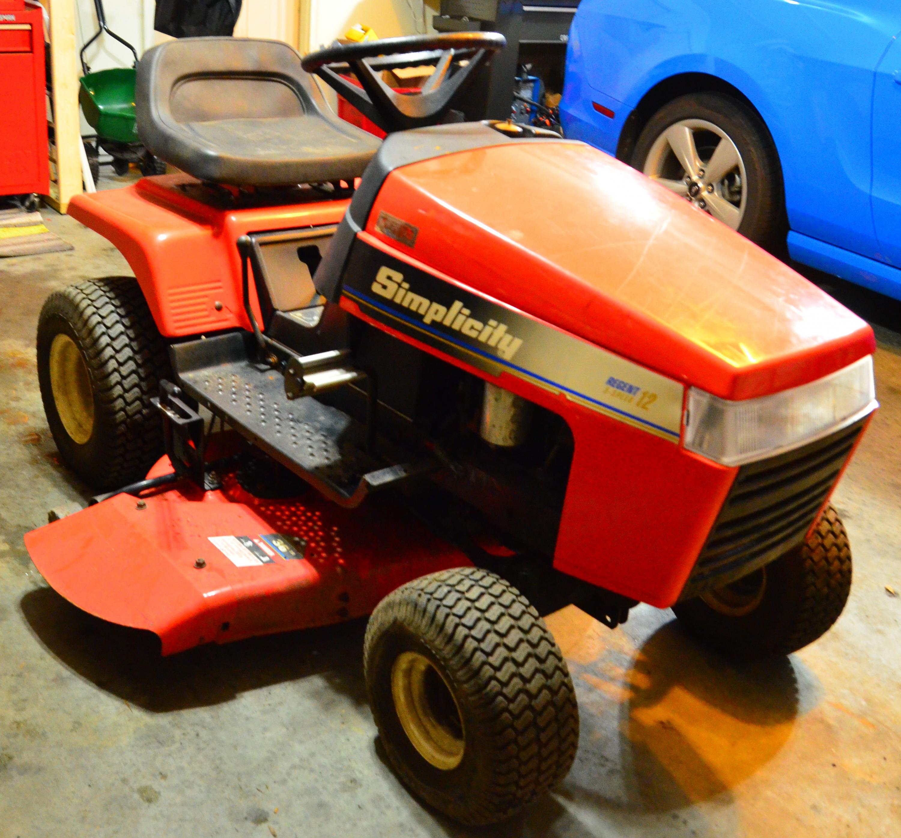

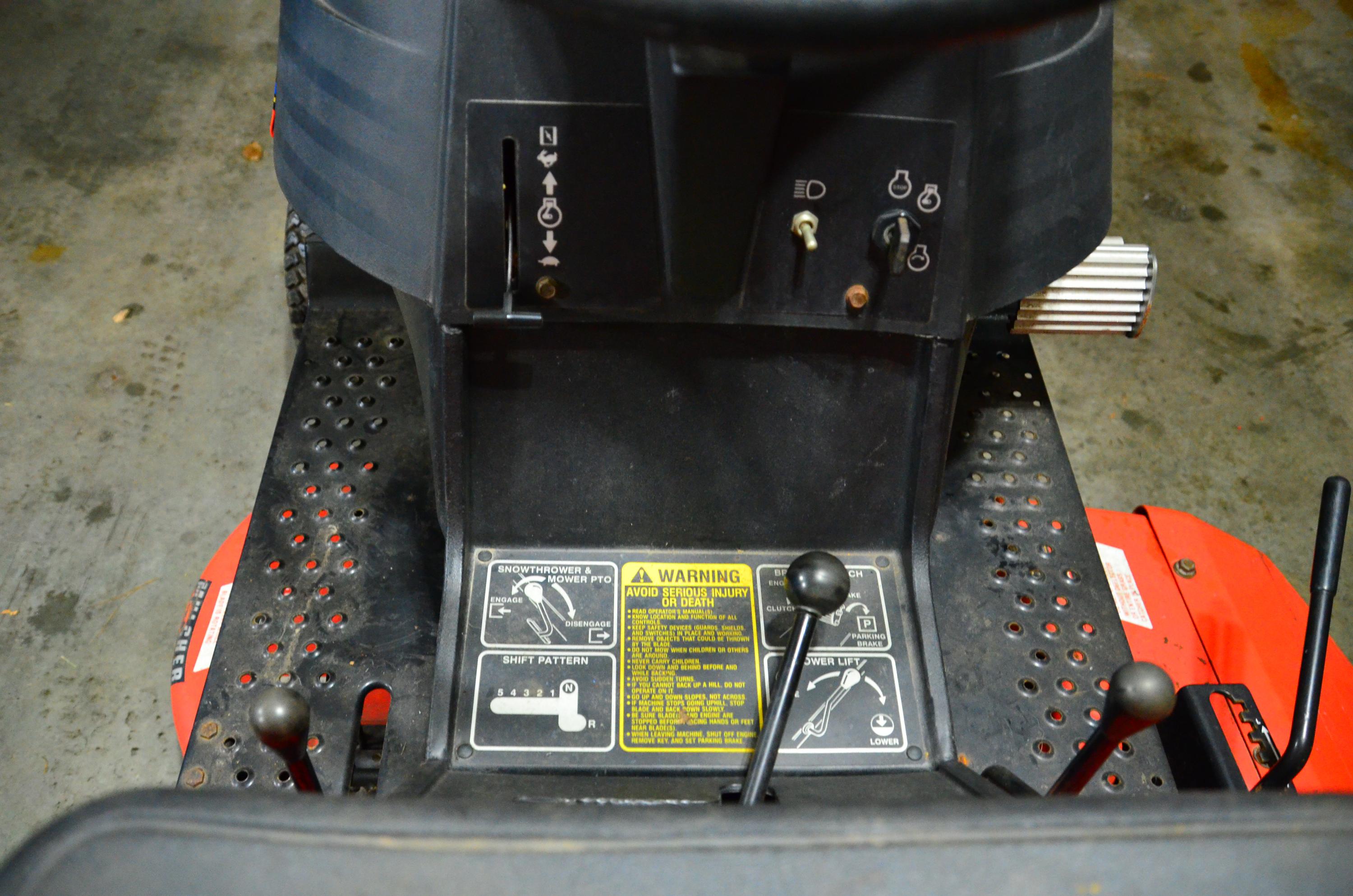

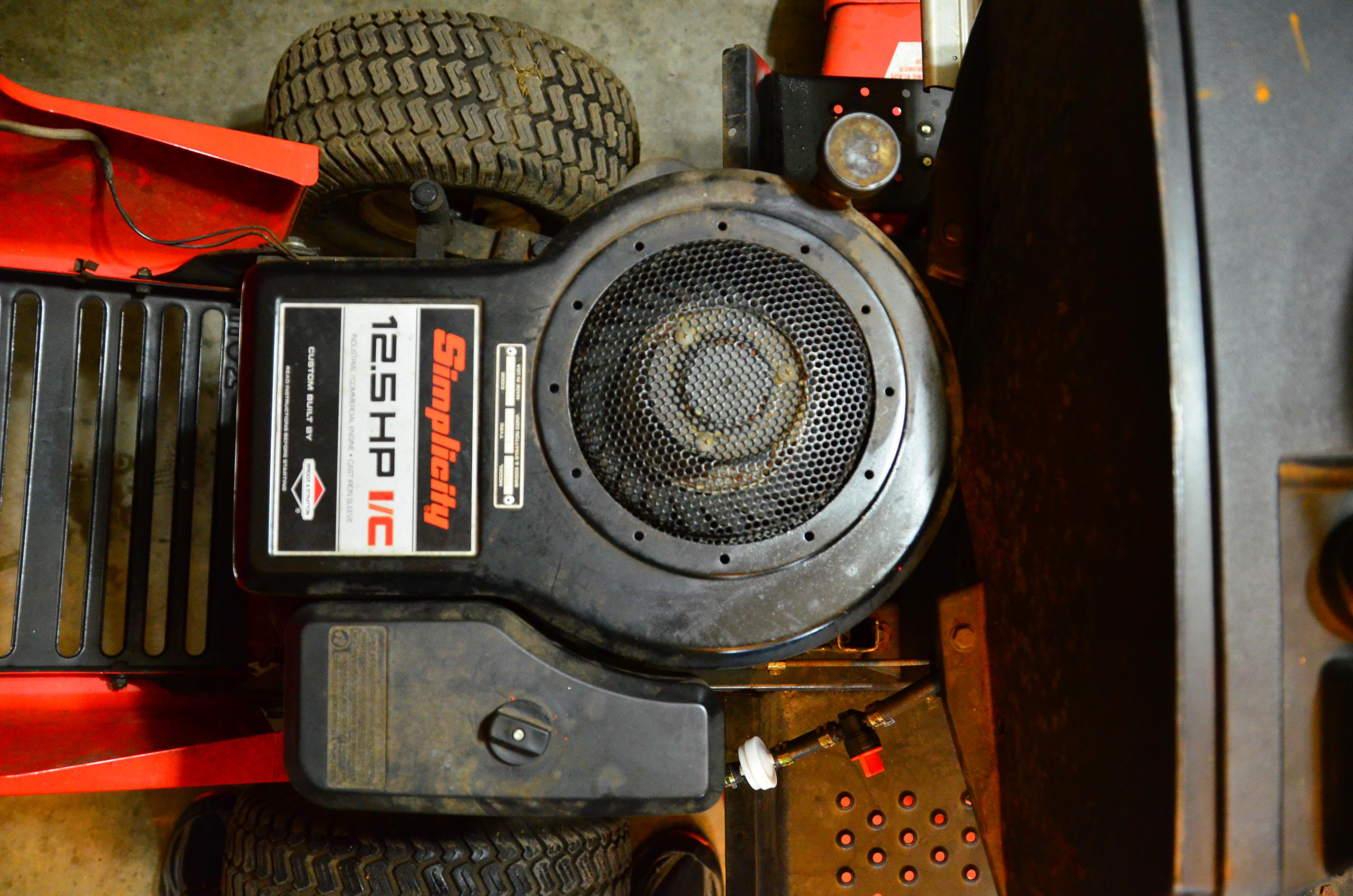

                                  Not exactly electronic, but still a good deal. I picked up a Simplicity Regent 12 Lawn Tractor for $60 (because what better time to buy lawn equipment than the middle of winter). It needed a new battery and carb (and I replaced the fuel line, fuel filter, air filter, spark plug, changed the oil, and added a fuel shut off while I was at it), but runs great now.

                                      I can't even begin to tell you how many boards I received for repair with stab wounds on them from this kind of mis-handling.....people are stupid.... I've never stabbed one in all my years and many hundreds of ZIF sockets used...
