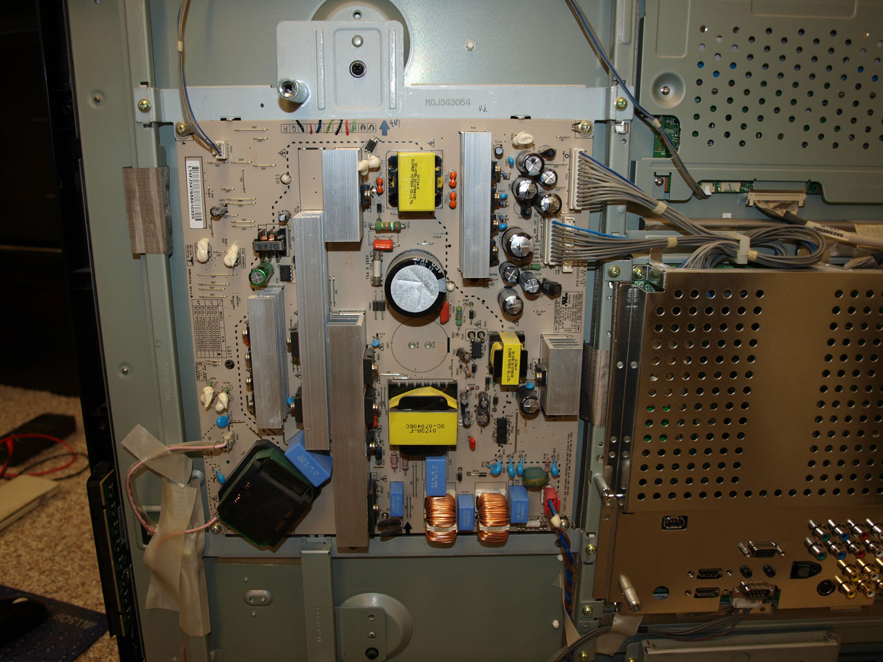

                    Originally posted by Topcat
                    given a LG 37" TV and some dell vostro desktop PC. I don't know anything else about them yet.
                    Computer is done & working. Latest BIOS on it and reloaded. Not going to upgrade it unless I find something laying around....I'll just re-home it as it is, clean install of Win7.
                    The TV was as expected...bad caps in the PSU....
                    Recapped.
                    First testing....
                    The culprits....
                    ...and done!

                    • BigTroll
                      • Sep 2010
                      • 1317
                      • LAMBDA SOND
                      #4110
                      Recapped.
                      First testing....
                      The culprits....
                      ...and done!
                      Nice Restore! what brand were the badcaps? I blew the picture up but still couldn't tell. TV seems to have nice contrast and doesn't look washed out.

                      • alandicade
                        • Nov 2019
                        • 9
                        • Aland Island
                        #4111
                        looks like samwha but i could be wrong
                        • Topcat
                          The Boss Stooge
                          • Oct 2003
                          • 16955
                          #4112
                          I believe you are correct. I'll have to dig one out of the garbage to be sure, but I think they are.

                              I thought the same thing at quick glance at the POST screen.....but when I looked, it turned out to be an e7300; 2.66/1066fsb C2D....darnit!
                              I put one under the magnifier (the print is small), and they are indeed Samwha.
