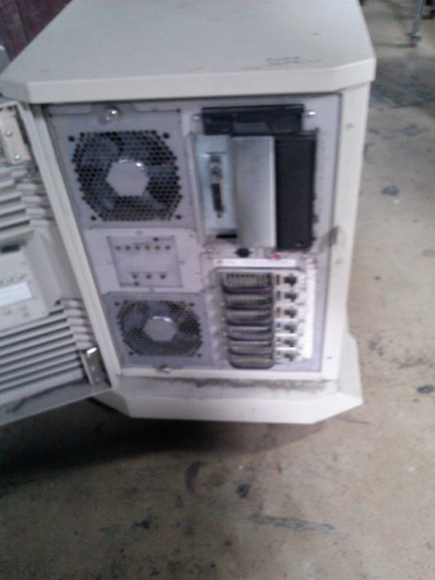

              • Curious.George
                • Nov 2011
                • 2305
                • Unknown
                #3847
                [Apologies for the shitty photos... need a real camera to see what I'm shooting, not a phone!]
                The ultimate beige box? Wouldn't work for a PC, though (count the number of card slots it supports!)

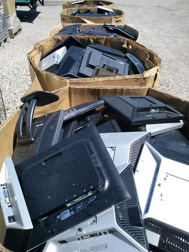

                • Curious.George
                  • Nov 2011
                  • 2305
                  • Unknown
                  #3848
                  Monitor graveyard (can't tell from the photos but these are Gaylords -- 4' cubes)
                  • Topcat
                    The Boss Stooge
                    • Oct 2003
                    • 16956
                    #3849
                    Kinda sad actually....

                    • Curious.George
                      • Nov 2011
                      • 2305
                      • Unknown
                      #3850
                      Yup. But, there's only so much space to store things (as there's more coming in, every day).
                      And, even at $5/ea, there's not a big enough market to absorb all of the discards we're faced with! <shrug>
