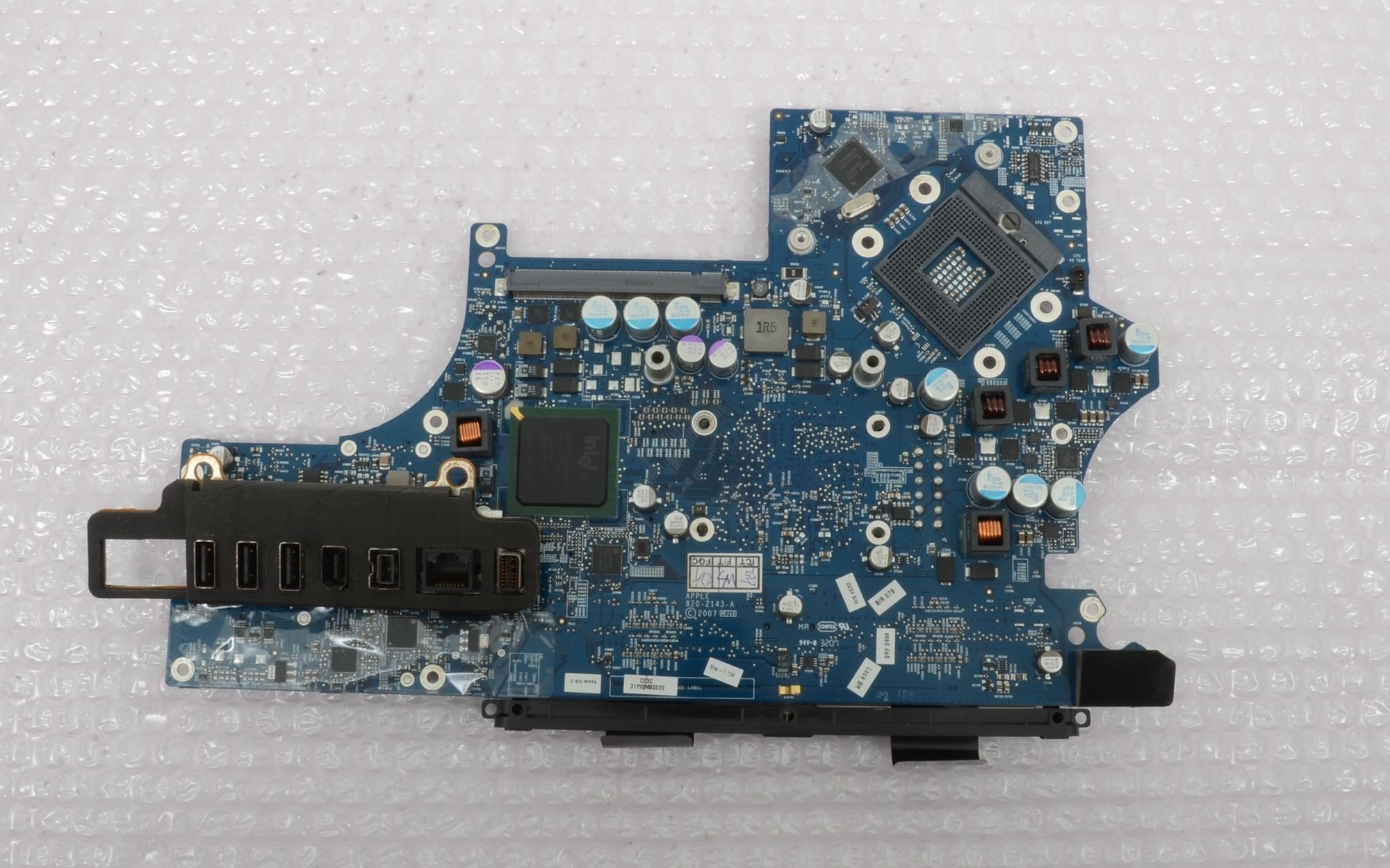

    20" Imac Early 2008 (A1224)- $10. Has the meh 2Ghz CPU and a measly 1GB of RAM, but I've already sourced fresh RAM. Everything works too.

      Those were horrible for GPU chip underfill issues, and of course bad caps. Make sure you take it apart and check it.
        IIRC it's AMD/ATI based, not Nvidia. Also, I thought the roasted Imac caps were a G5 issue, not an issue with the Core2 and later units? I'll take a look, but I do not follow.
        https://en.wikipedia.org/wiki/IMac_(..._Aluminum_iMac
        Edit- it's actually a mid 2007 model. Radeon 2400 XT, 128mb. No underfil issues with those, right?
            I think it was more faulty ROHS solder....I've seen them both fail. They usually POST to garble or don't POST at all. They were victims of bad caps though. The G5's were worse, but there were lots of these that came across my bench.
              All modern (and even not so modern) ATI and nVidia GPUs are affected - but some more than others, of course (GeForce 6k-8k series series were the worst, along with X1k and HD6k and newer from ATI). In my experience, the Radeon 2400 and 3450 are probably the most robust fairly modern GPUs that ATI put out. Of course if Apple did a piss-poor design on the cooling, you can expect even these to fail after some time. But in general, the HD2400 and HD3450 don't have any issues.
              That aside, what would be the use for an old Mac like this? I know that with the same PC-equivalent hardware (Windows), it would still make a decent PC for browsing and will run the latest versions of FF with Windows 7 or newer. But from the limited experience I've had with Macs, it seems like they can't take the latest OS (and for that matter limited in terms of what browser you can put on it?)
                  Looking at pictures of what the mainboard supposedly looks like, it appears to be all polymer caps (more akin to a laptop board). Obviously the power supply isn't going to be, but looking at the PITA this thing is going to be to pull apart (and that I don't have any suction cups handy), I'll wait until I find another cheap T9300/T9500 CPU before I dive in.

                    They weren't overwhelmingly lytic like the G5, most polymer....but the few they had were killed by heat. Usually a couple 1500uF 6.3v 10x12 and a couple 680uf 16v 10x12. either KZJ or MBZ.
                      Were they from the Polycarb imacs or the Aluminum ones? Or were you send raw motherboards? What's supposed to be the board for mine (looks correct) is attached, looks to be 100% poly.
                      I screwed up again... apparently these things are picky eaters when it comes to RAM and cannot run DDR2-800. I stuck some of such (pulled from a laptop not in use) to test, and no, at least one module needs to be 667 or else it will not POST. Already ordered memory too ... oh well, I have uses for such. At least both pairs of RAM were only $9.63 per set. Try, try again...

                        Hmm, dont think i've seen that particular board. As for a processor, you should have a mobile C2Q from another experiment....
