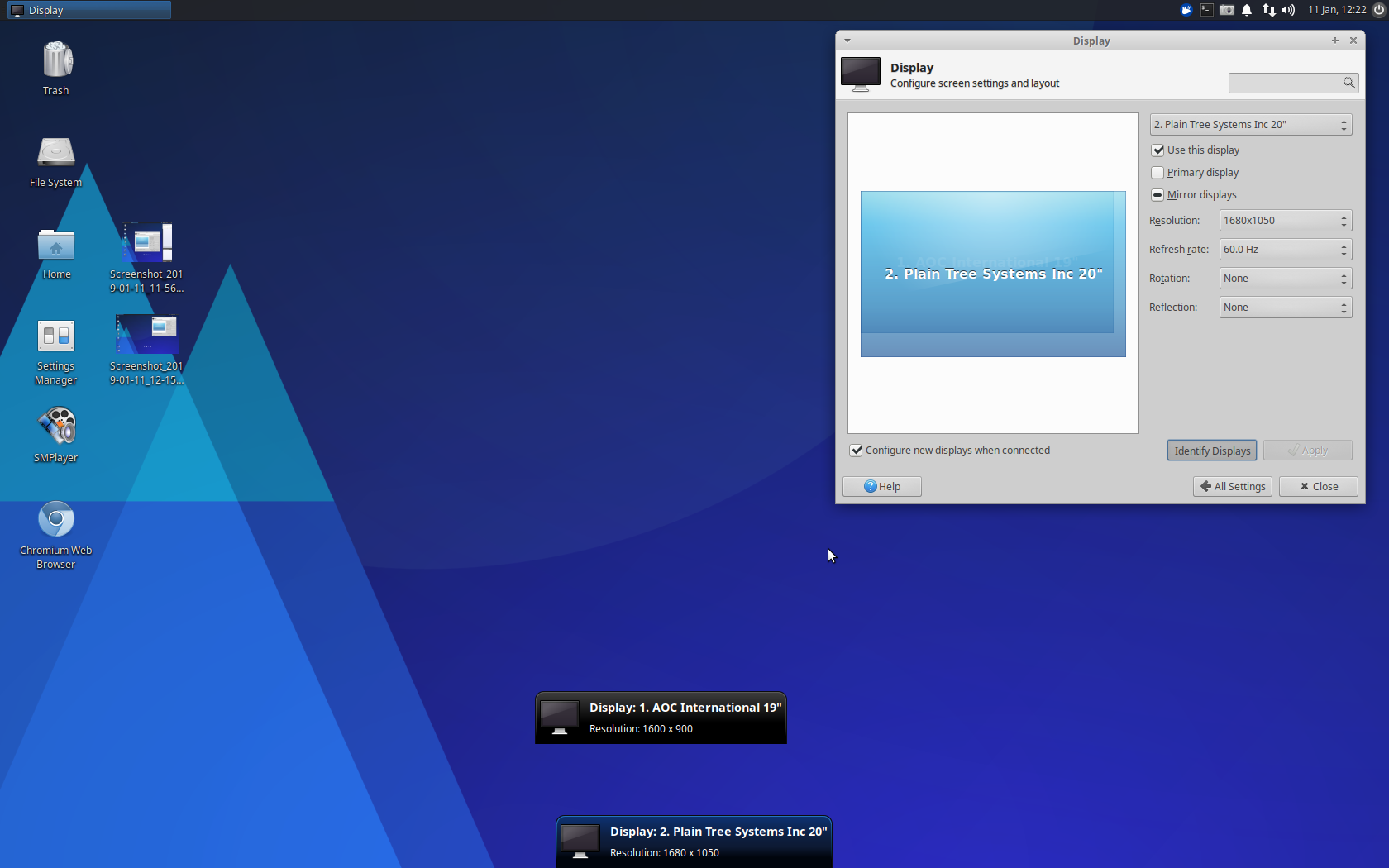

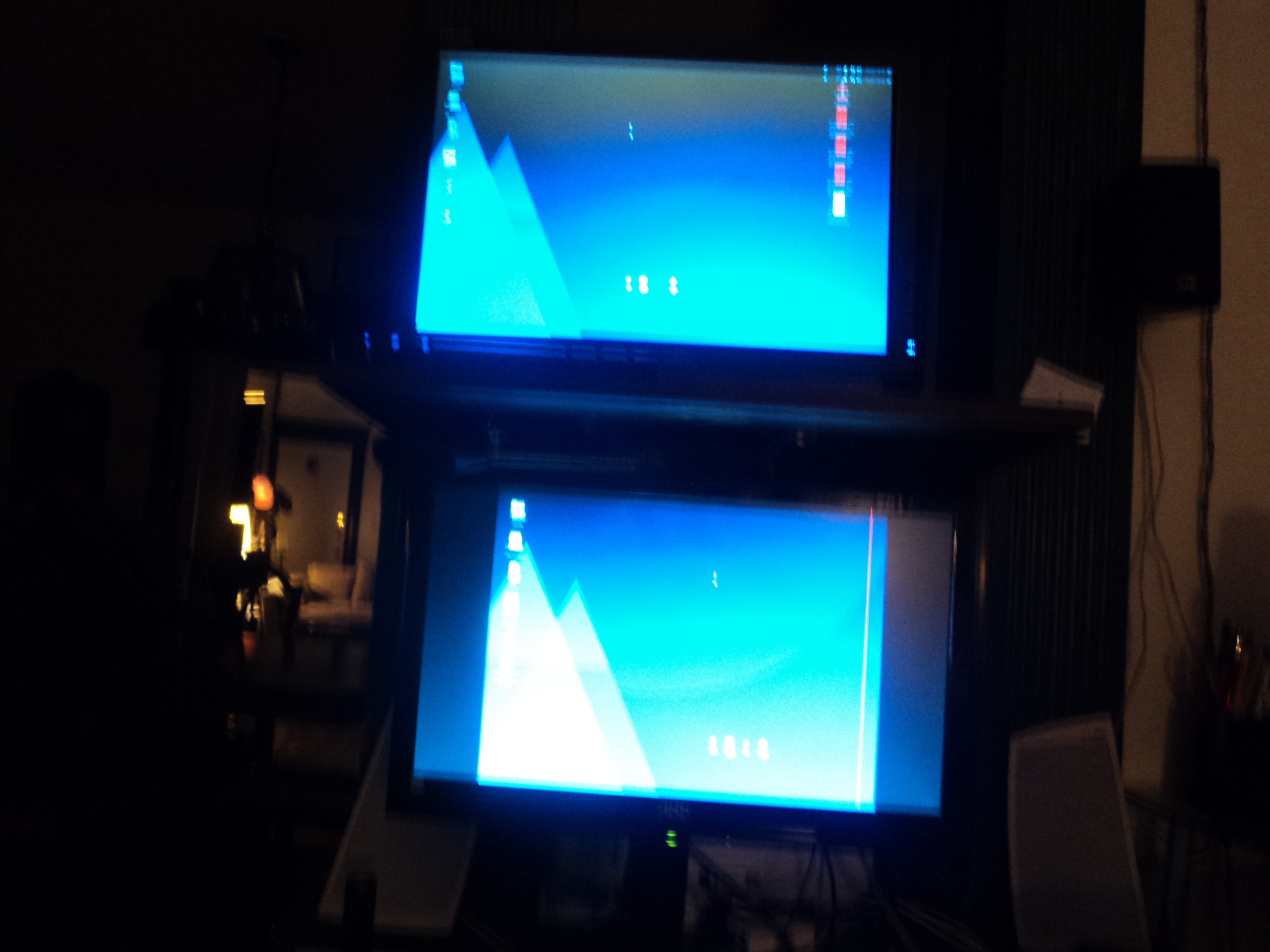

      Thanks R_J; The max resolution of the Top 20'' Display that gets the right full screen
      1680-1050 and the bottom 19'' screen max resolution 1600-900 this one is the one that cuts on the sides,if i change to any other lower resolution on to screen it does good but the bottom one will not have the right centered screen.

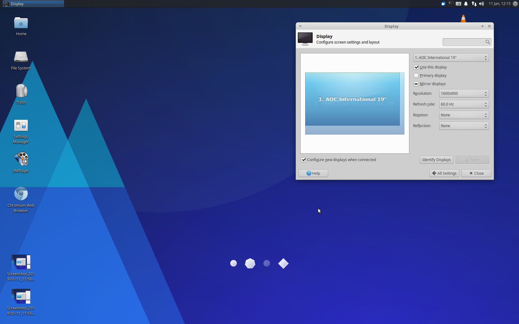

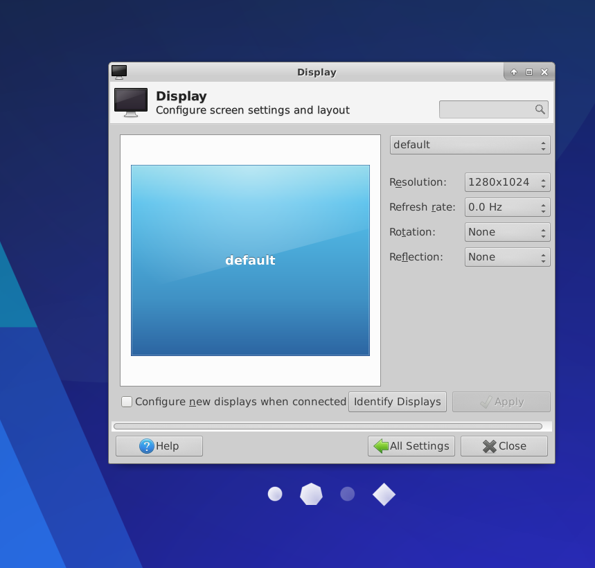

          Again thanks R_J; when i set resolution on 19'' AOC display to 1600-900 i get this see pic attach;

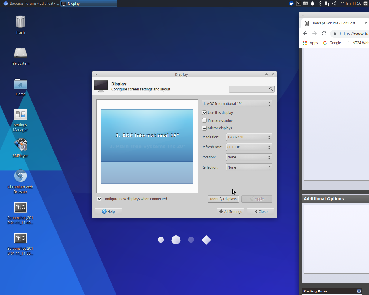

            Now with 1600-900 resolution i can see the full screen but on the bottom screen is cut off about 5 inch and on the right side about 2 inch,if i lower resolution it gets worse

              [QUOTE=ivtec; hi guys Now with 1600-900 resolution i can see the full screen on the monitor settings after some struggle it was presented to a mode like wide screen sign ,it was hard to see it because all controls are in a weird place that are not very well marked ,thanks

                make the smaller monitor primary and the larger secondary.

                    Hi R_j as soon as you responded here after i had it working on both displays with resolution 1280-1024 0.0HZ ,which0.0HZ is weird since only resolutions under that show up on both displays with no other options and none work right even screw the graffics so much so i have to reboot,and the interesting thing is everytime i reboot it goes to a screen; ''see pics'' a log in with name and password witch i put in and it goes nowhere,then the only way i can go to my desktop is if i do Xubuntu GNU grub recovery mode,this Xubuntu 18.04 is giving me headaches with these 2 monitors

                      Ok guys i went the hard way which was reinstalling Xubuntu 18.04 and now it is working right set both monitors 1280-1024 75hz and seems both are set right now,keep my fingers crossed.
