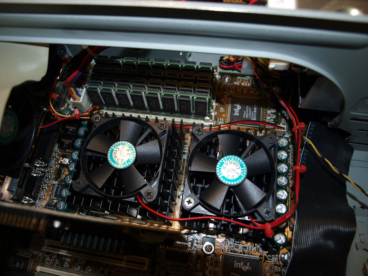

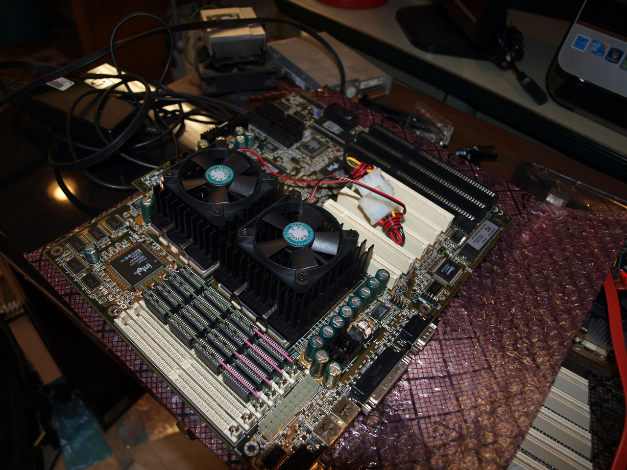

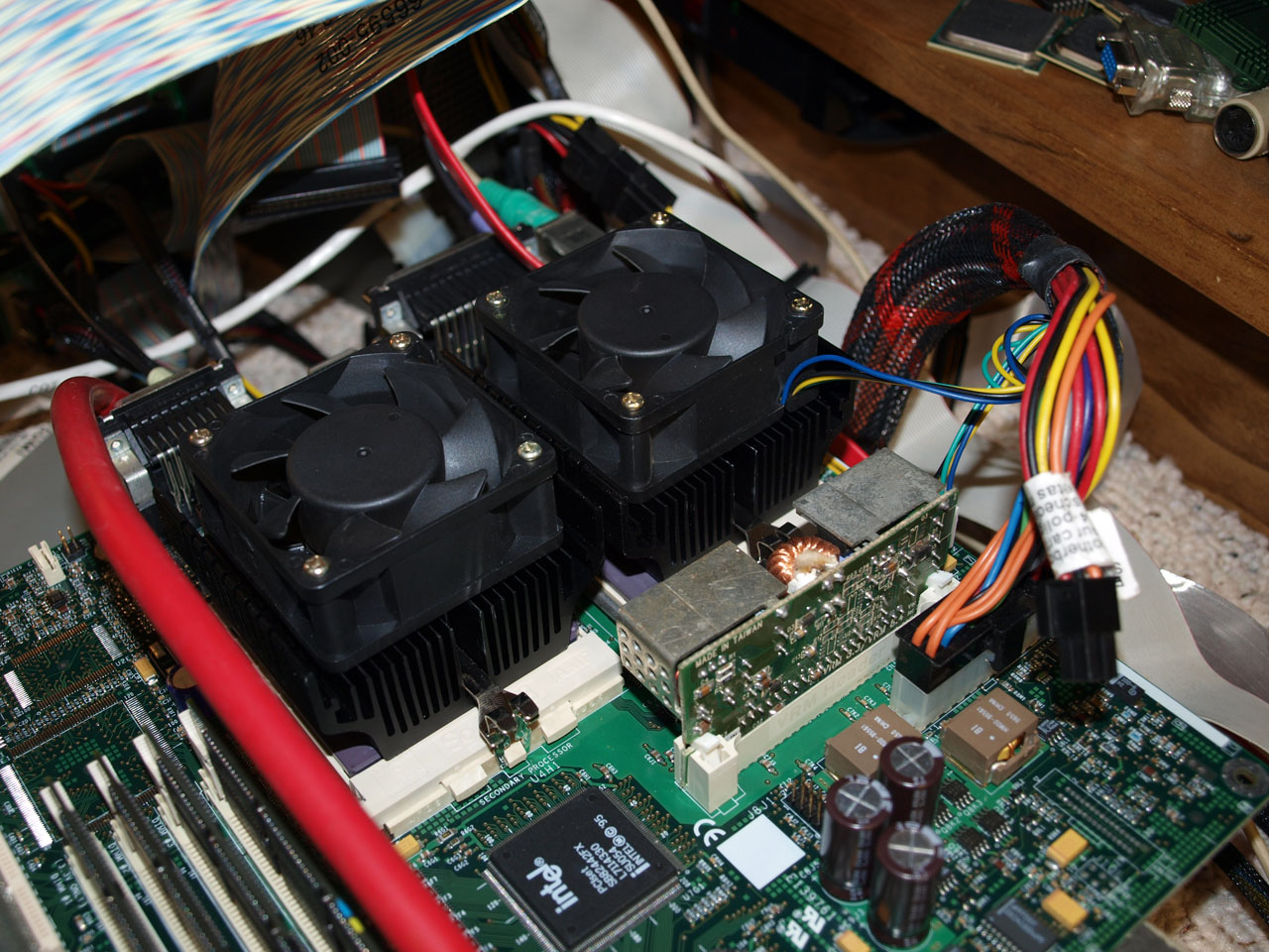

            Finding the sweet spot slowly. Put bigger fans on the CPU's of the PR440FX, since it has headers for them on the motherboard...
            ...and a closeup of that famous VRM:

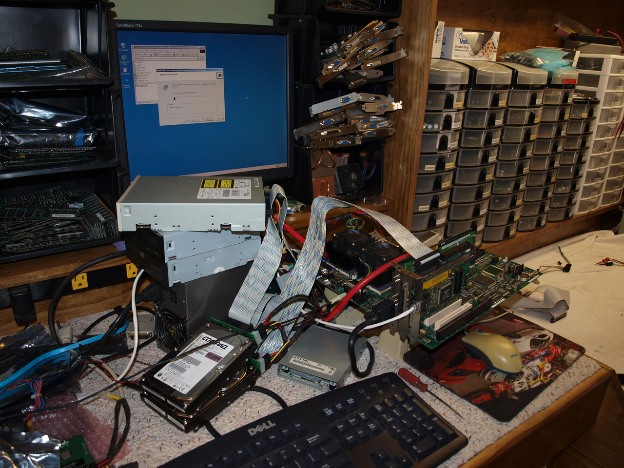

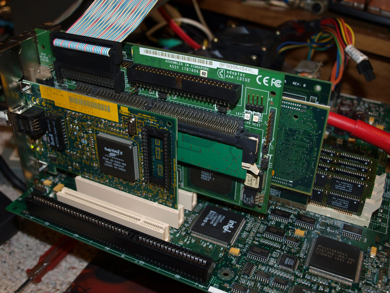

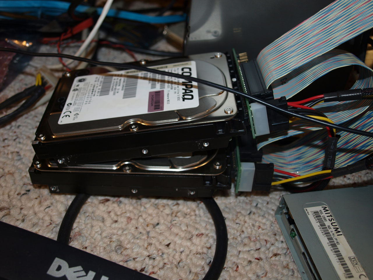

            Testing an adaptec aaa-131u2, a controller that can be a little fickle with older hardware....but it worked without issue on this board.
            2x 36gb 10k RPM drives in a mirror. I normally stripe them.....but I just didn't this time....
            majorgeek's 'unofficial' SP5 for Win2k installing...
            The MSI MS-6107 fanless sinks got the fans originally on the PR440FX, since this board doesn't have fan headers on the motherboard.
            This time around I also went down to FF3.6.27, as its far happier with this lame old GPU....it actually functions very smooth, all things considered with this all-around gutless system! More when the GPU's get here.

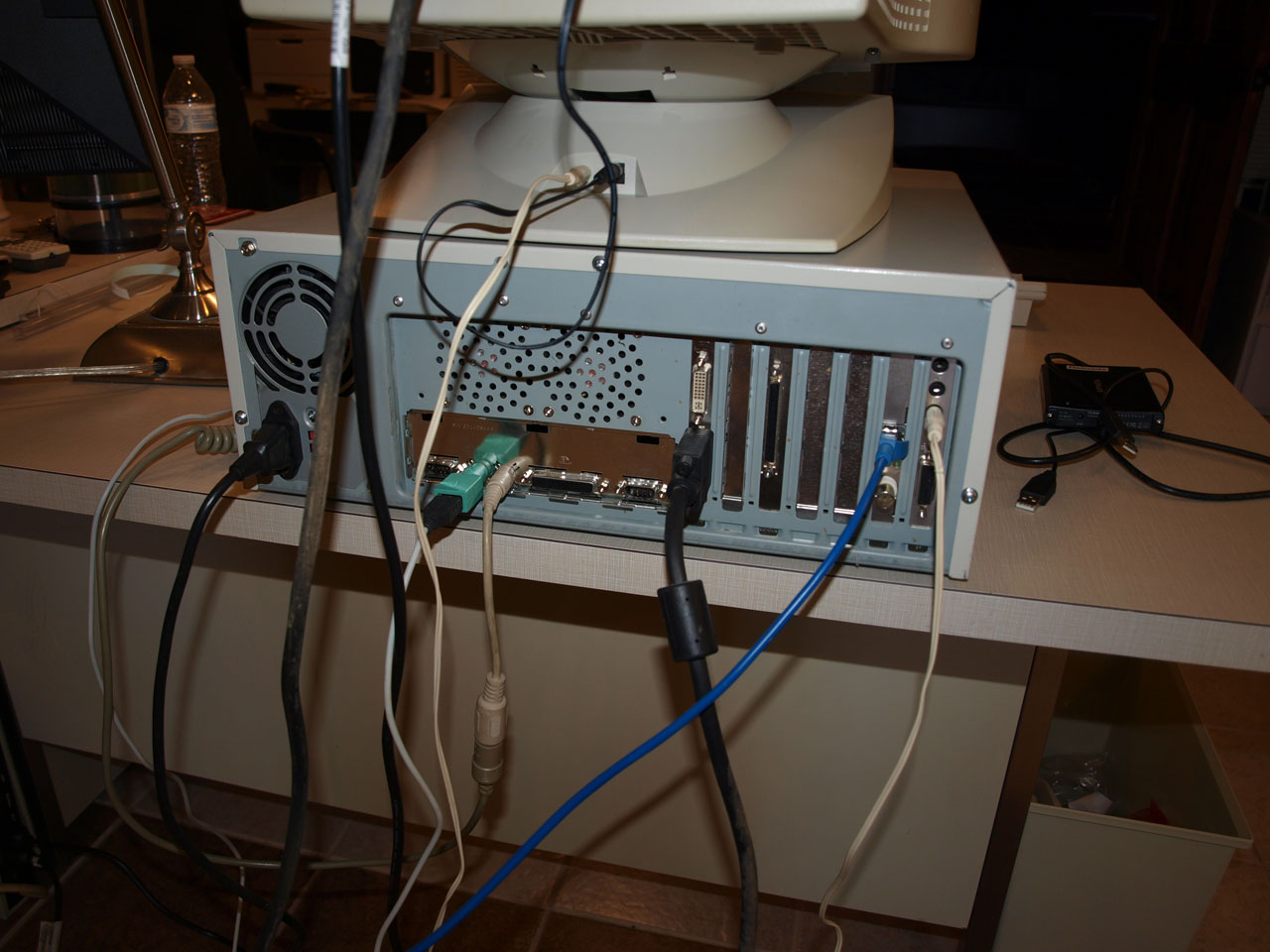

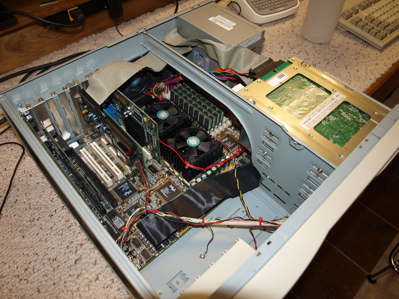

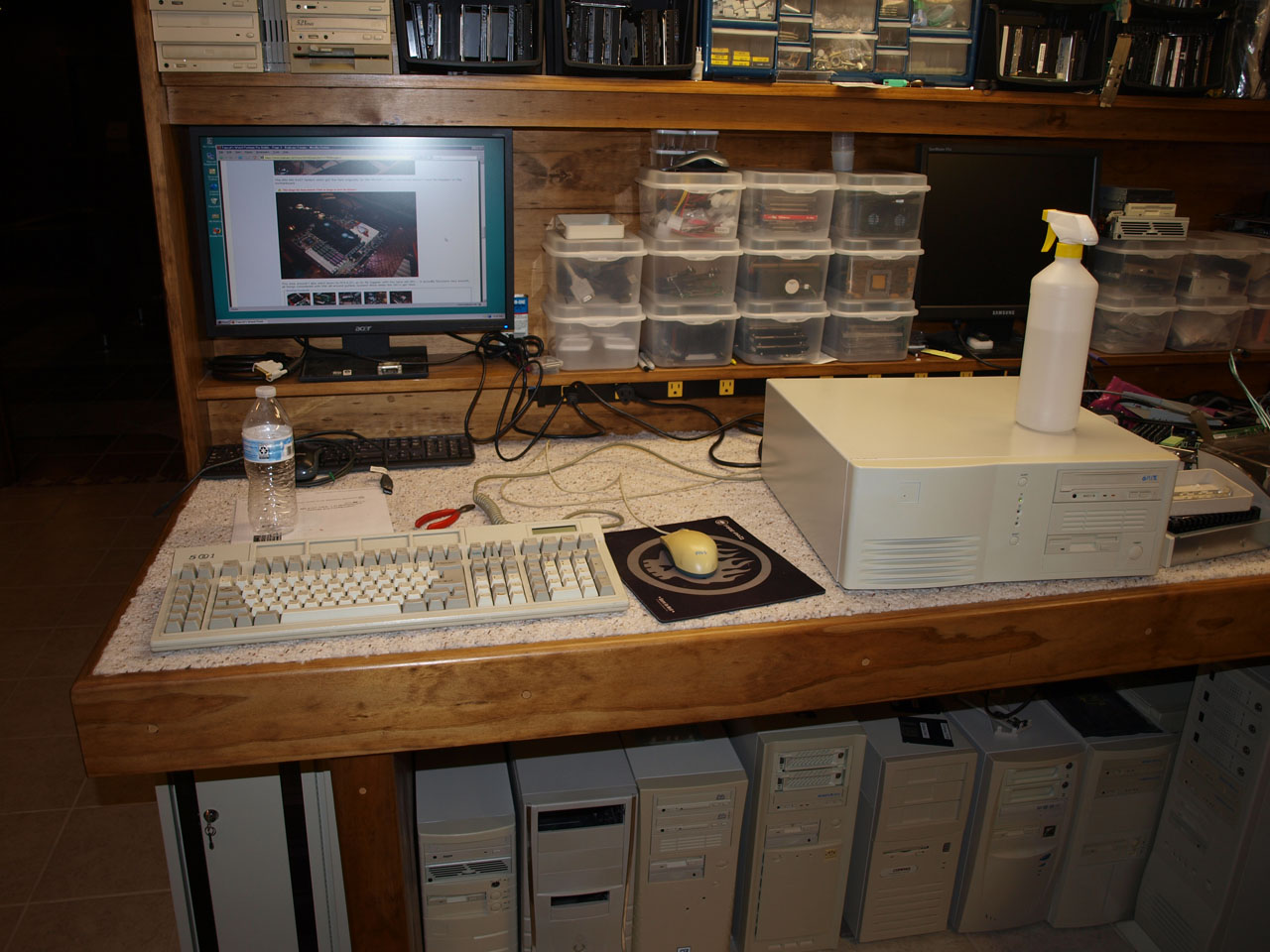

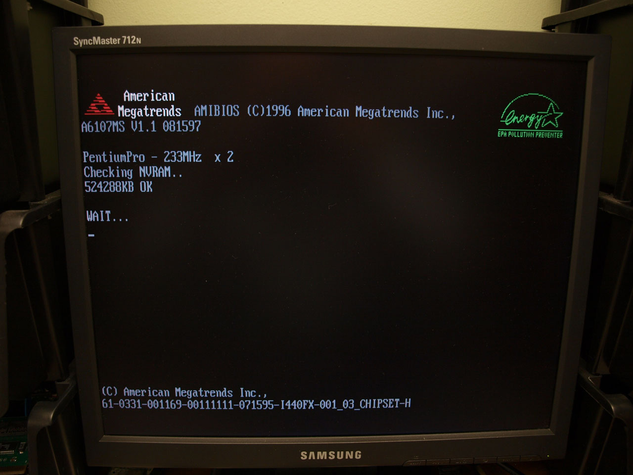

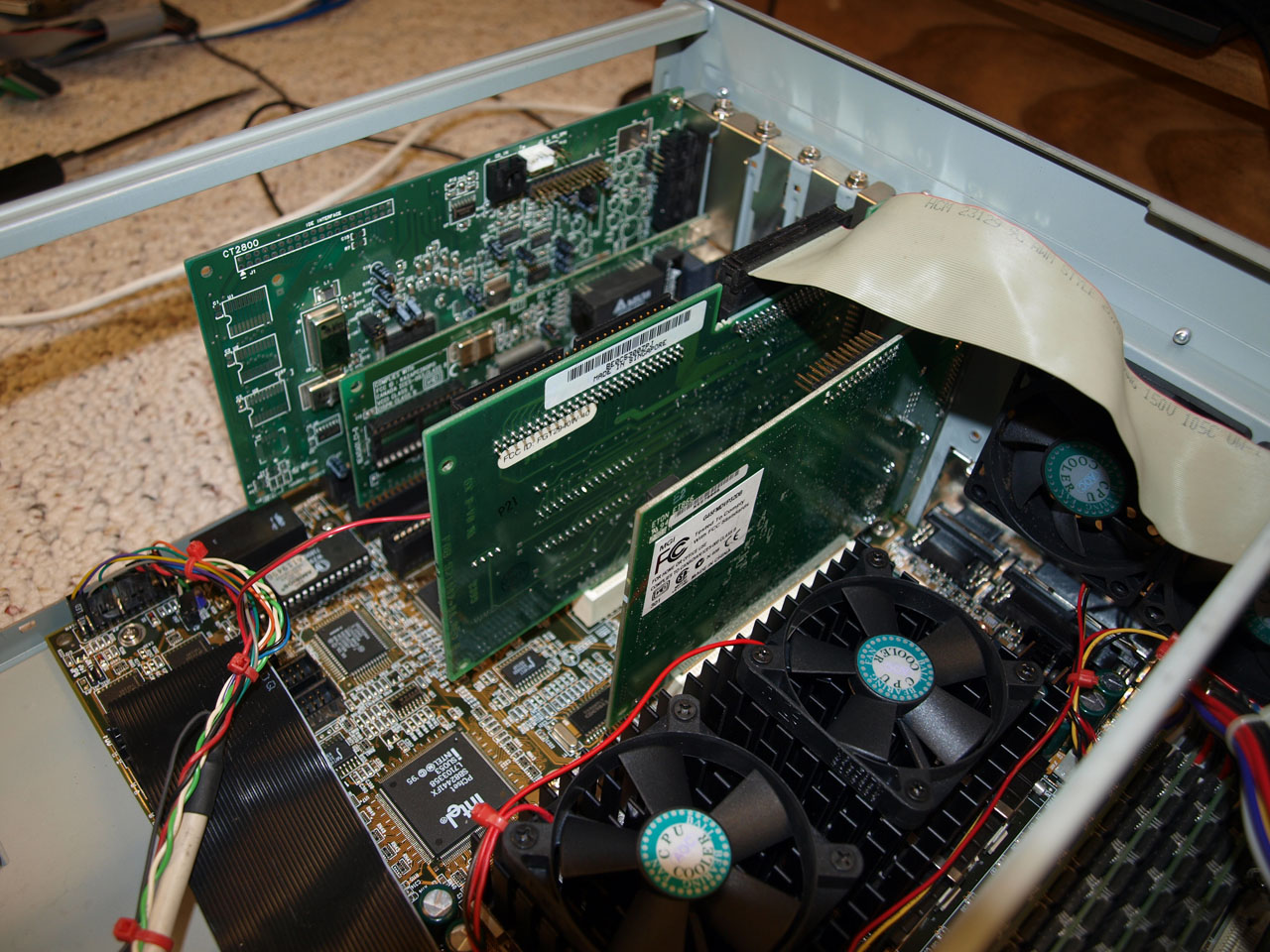

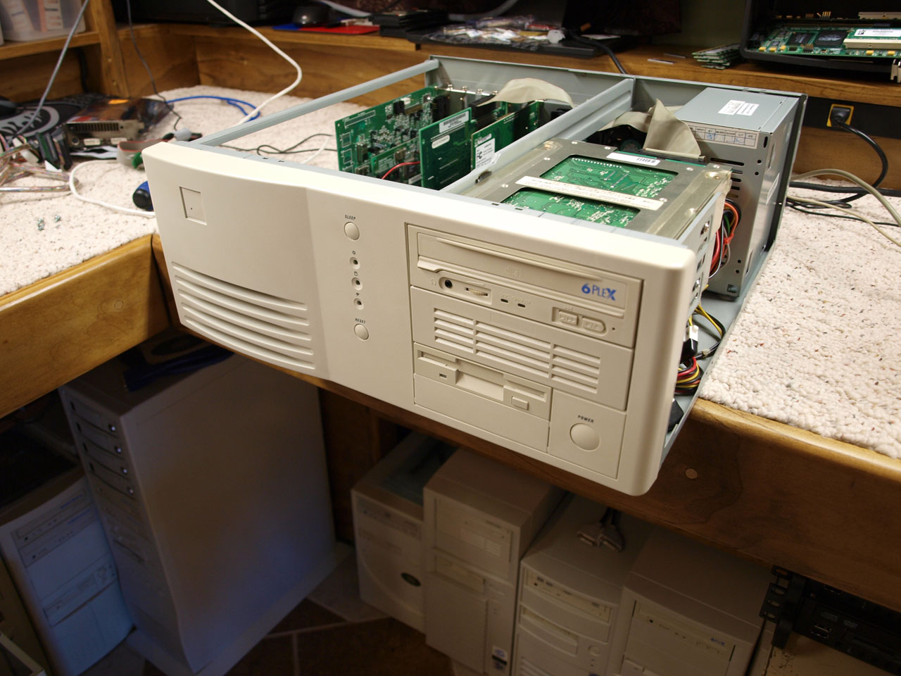

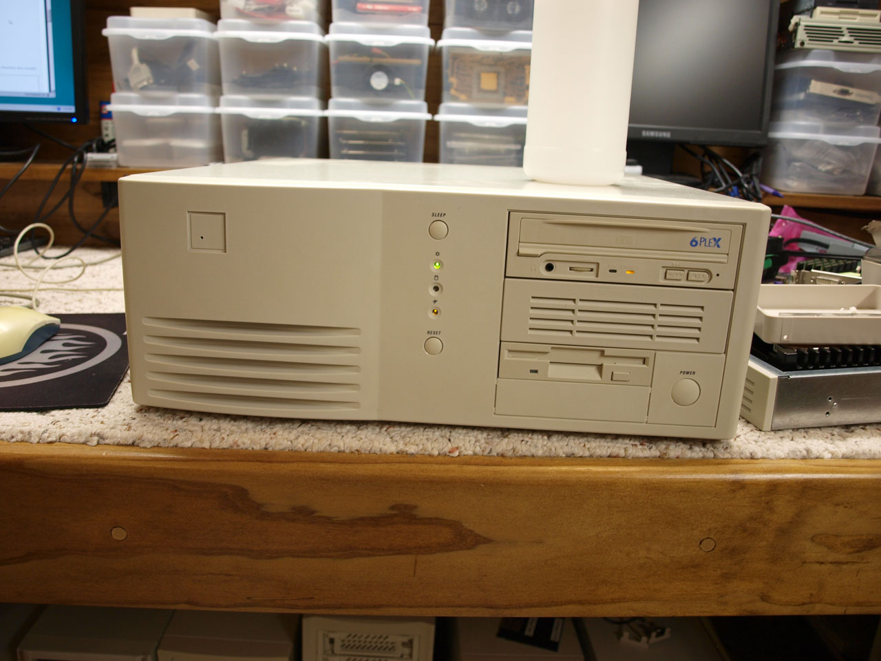

                              Ok, a few pics to wrap up one of these builds....
                              Innards!
                              Nice old desktop style beige case that I had a sleeper build in at one point....but I thought this was a far better build for this case!

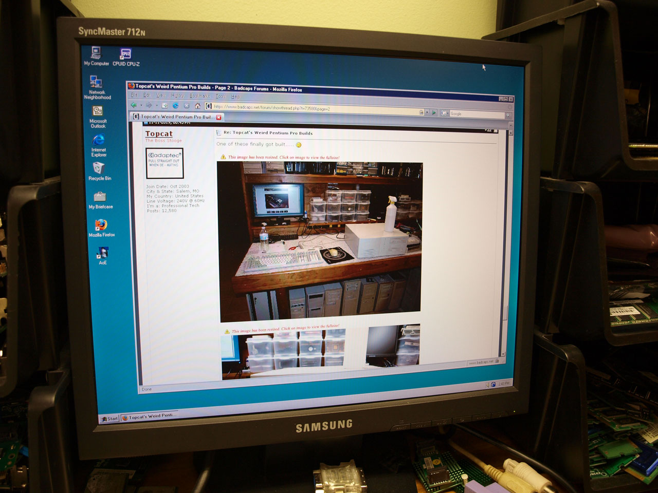

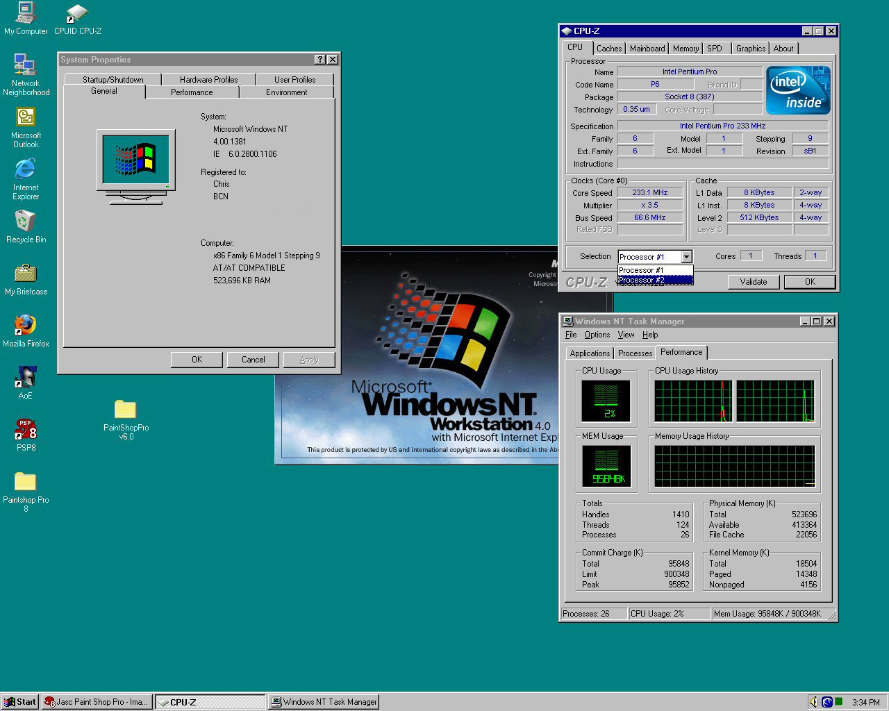

                              POST screen
                              Gotta love NT!
                              Not sure when I'll get around to the other build.....but atleast one is finished!

                                  It would be interesting to see what games it can handle from that era and how well.
                                  I find it funny how in CPU-Z, there is absolutely nothing under the "Instructions" field. Not even MMX!
                                  Truly an amazing museum piece (and functional, at that), showing how far CPU architecture and design have moved in ~25 years.

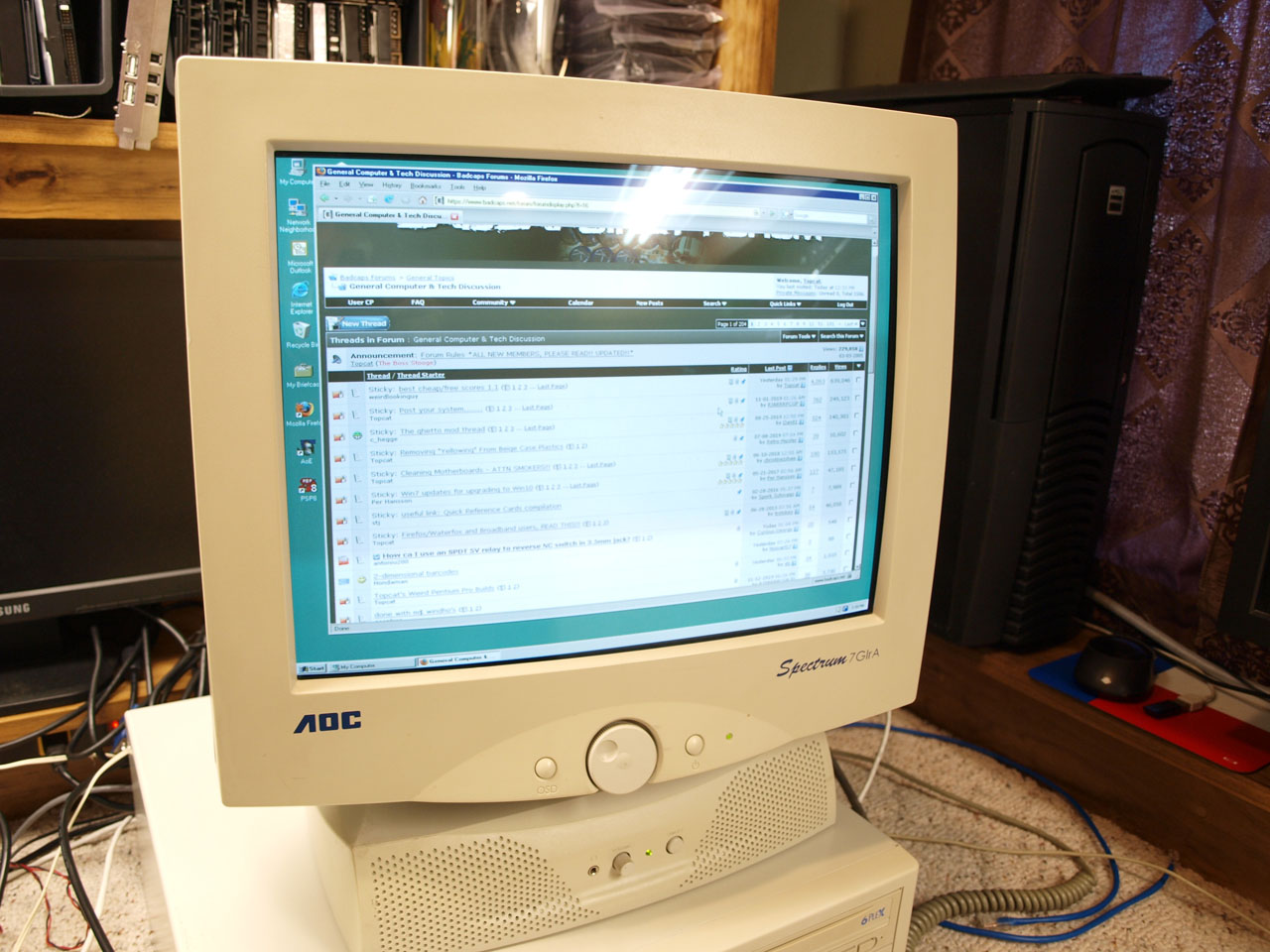

                                    ...and this build got a little more 'retrofied' today.....in ways you'll appreciate! Pics coming soon!

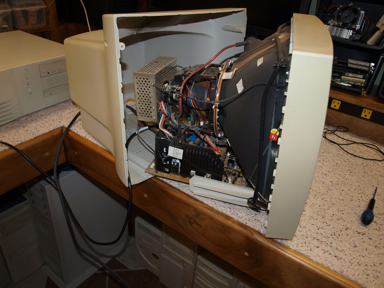

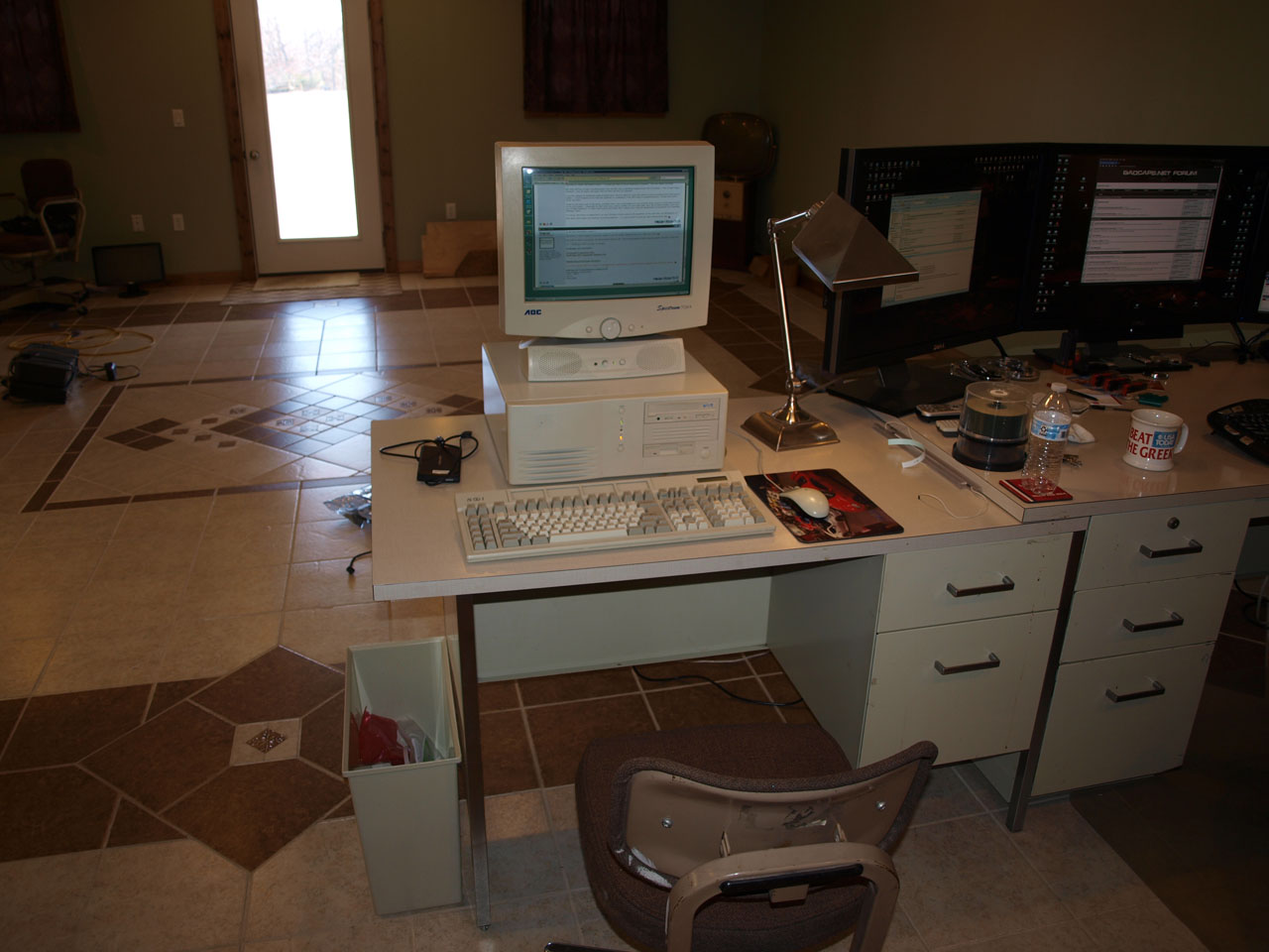

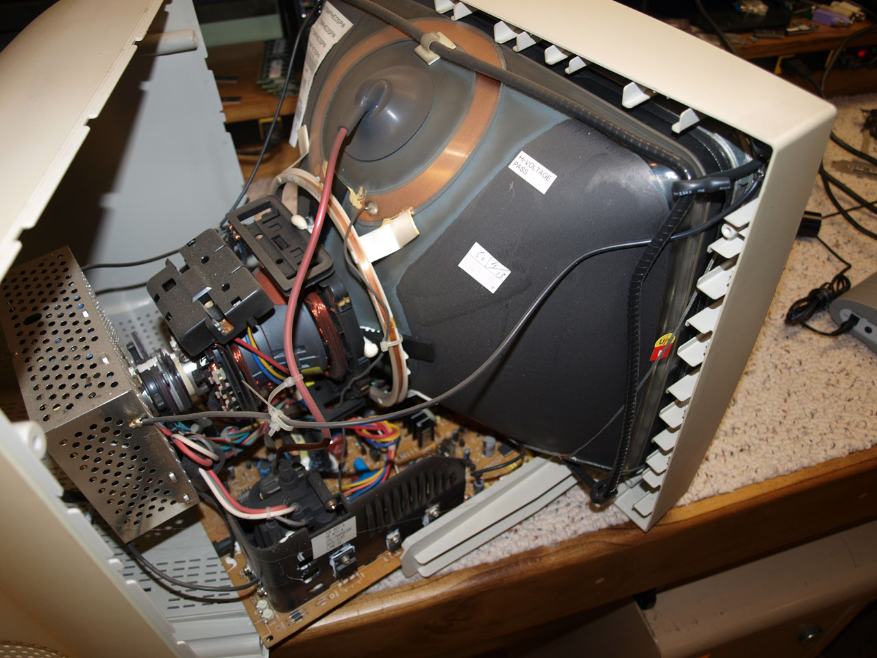

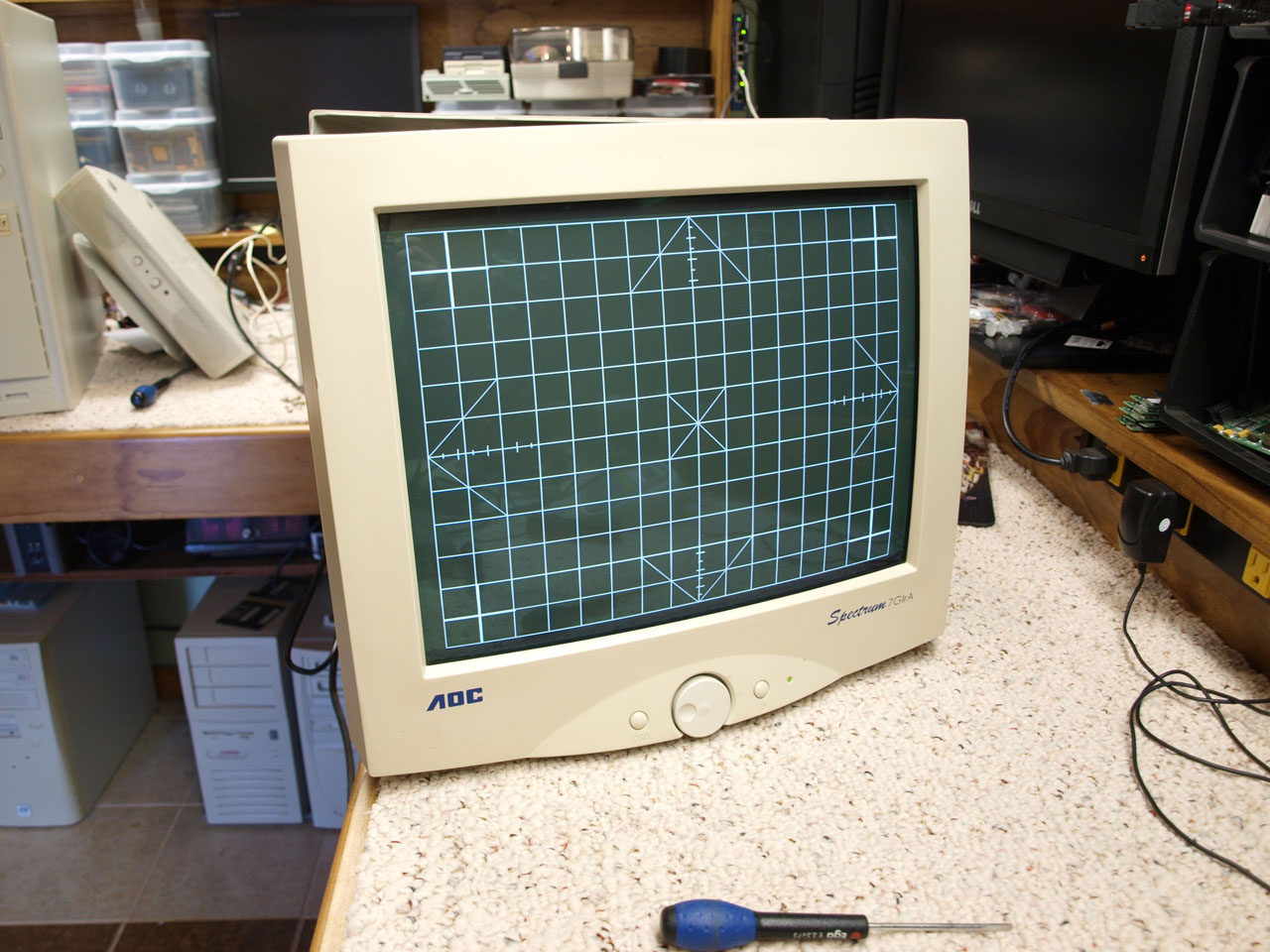

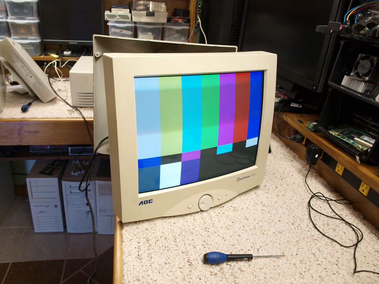

                                      Something that's been sitting in the attic for a while....After letting it warm up, it was a little out of focus and dark....I let it run a good hour to make sure everything was reformed & up to temp...
                                      Cracked open!!
                                      Diddling around with the screen control and brought it back into focus.

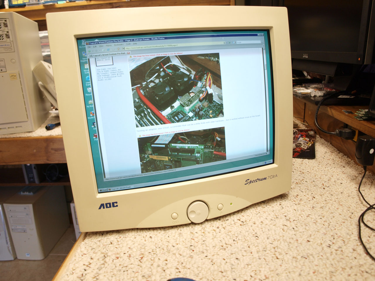

                                      I forgot how difficult it is to photograph a CRT monitor....and this is @ 85Hz refresh! ...but for all of you who make fun of my old test equipment!!
                                      Much better.....but LCD > CRT...but to keep everything period-specific....
                                      Back together....but still doesn't photograph well.... That's 1280x1024 @ 85Hz. It will do 1600x1200 @ 75Hz, but for a 17", that's just too high (things are way too small).
                                      So much retro awesome!!
                                      Of course a butt shot...
                                      This build is just a cool one!!
