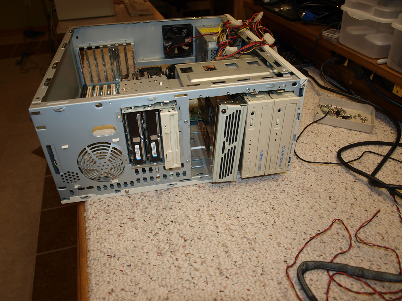

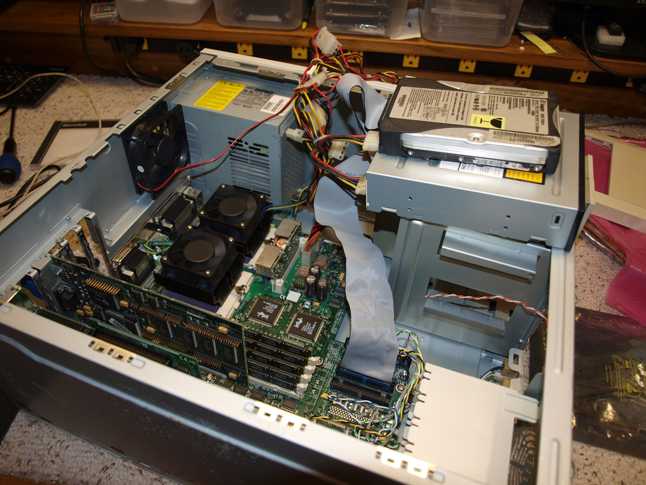

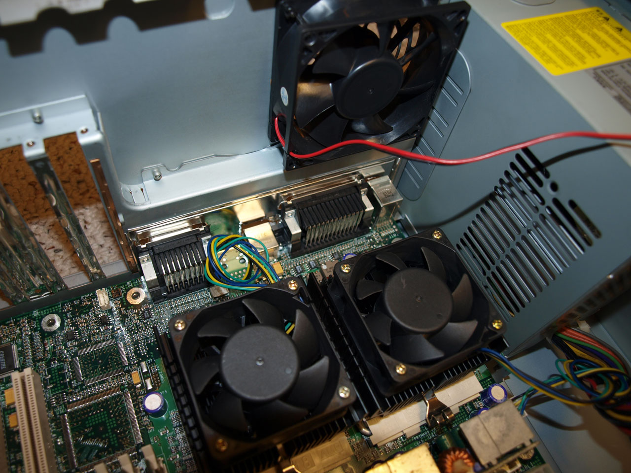

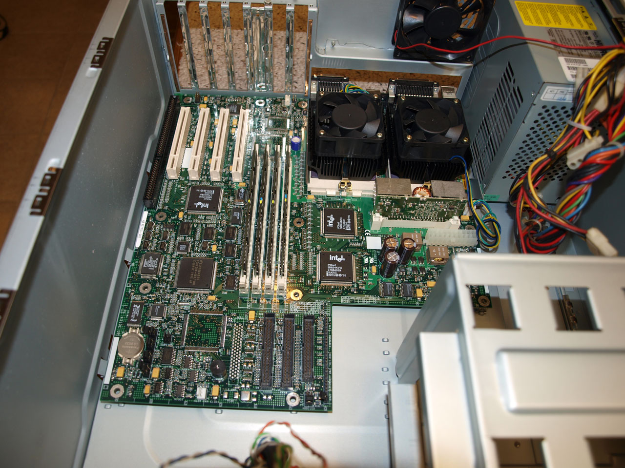

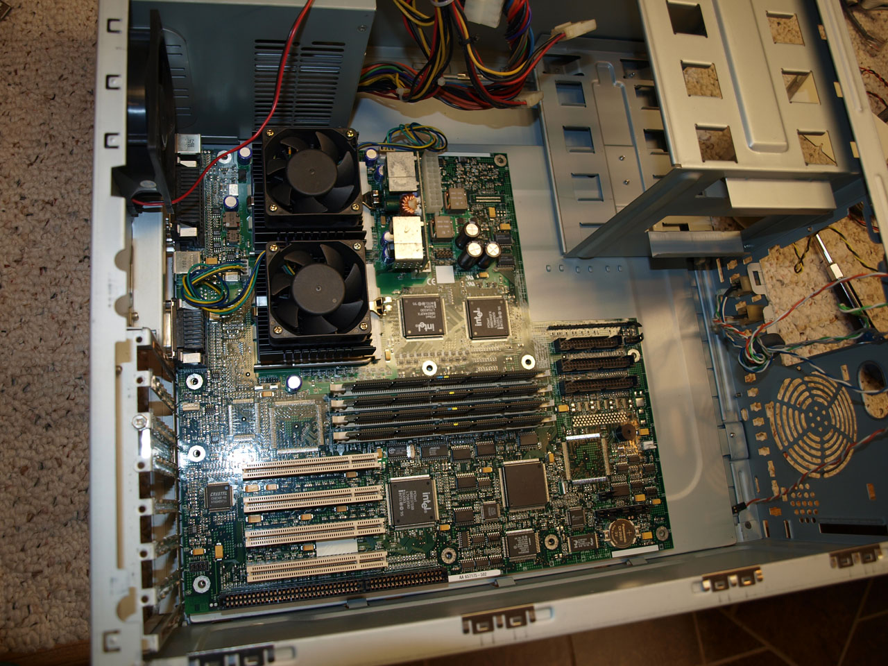

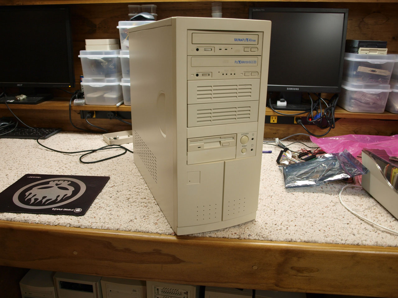

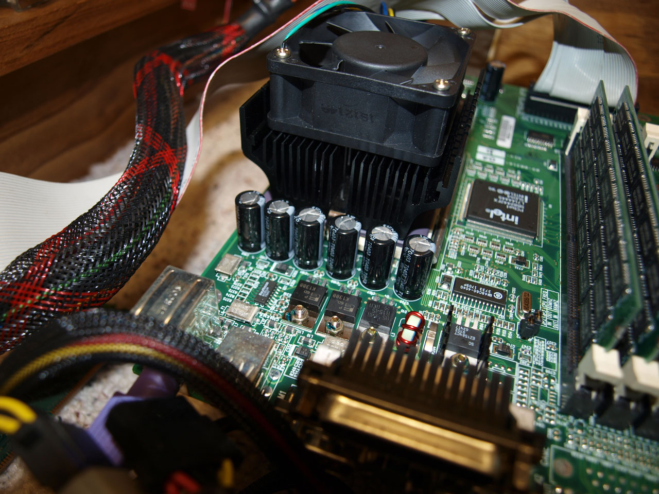

    Laying the groundwork for Build # 2. This one will be a little ongoing, as I'm in search of some Overdrive CPU's that fit the Socket-8....but they're harder to find and pricey. This board already has a pair of 200MHz 512k L2 CPU's that OC to 233 just fine.....but I've already got a Pentium Pro system with those specs, which you already know if you've followed this thread....so I've got to be even more unique for extra cool points! The Overdrive 333's pop up regularly on ebay, but go for $200-ish (I need 2)....I'm not spending that much, so I'll search & scour and I'm sure eventually find a pair cheaper than that! They're basically Pentium2 333's with full speed L2 caches & MMX instruction sets...and of course the infamous Pentium Pro FPU bug fixed. I want to run Win2k and some other stuff on this one, unlike the other running NT4. A pair of 333MHz CPU's, 512mb RAM, and a good GPU will run Win2k very smoothly!
    The above said, I had to conquer the first hurdle....a case that can handle this board. It's a primative eATX, I think it was originally intended for some proprietary Intel server case, given the way it's 'notched'...but by modern standards, its basically an eATX. I wasn't going to waste a high-end modern Supermicro eATX case on this....but I did have an Enlight beige case that looked like it might be a match. It was housing a VP6, but a VP6 will fit in anything, so I stripped it out. It was also the lab rat for the bromine yellowing removal experiment, and it held up well! The case isn't 'officially' an eATX, because of the 5.25" cage; a REAL eATX board would not clear the cage at all...but the lower half has all the appropriate motherboard mount points for an eATX board...the 'notch' of this board saved the day! The board fits this case like a glove, and NOTHING had to be modified! Every mount point on the board has the correct corresponding mount point on the case backplane, and it clears everything....albeit, close in a few places....but get a load of this!!
    Wow, now how was that for awesome fitment!!

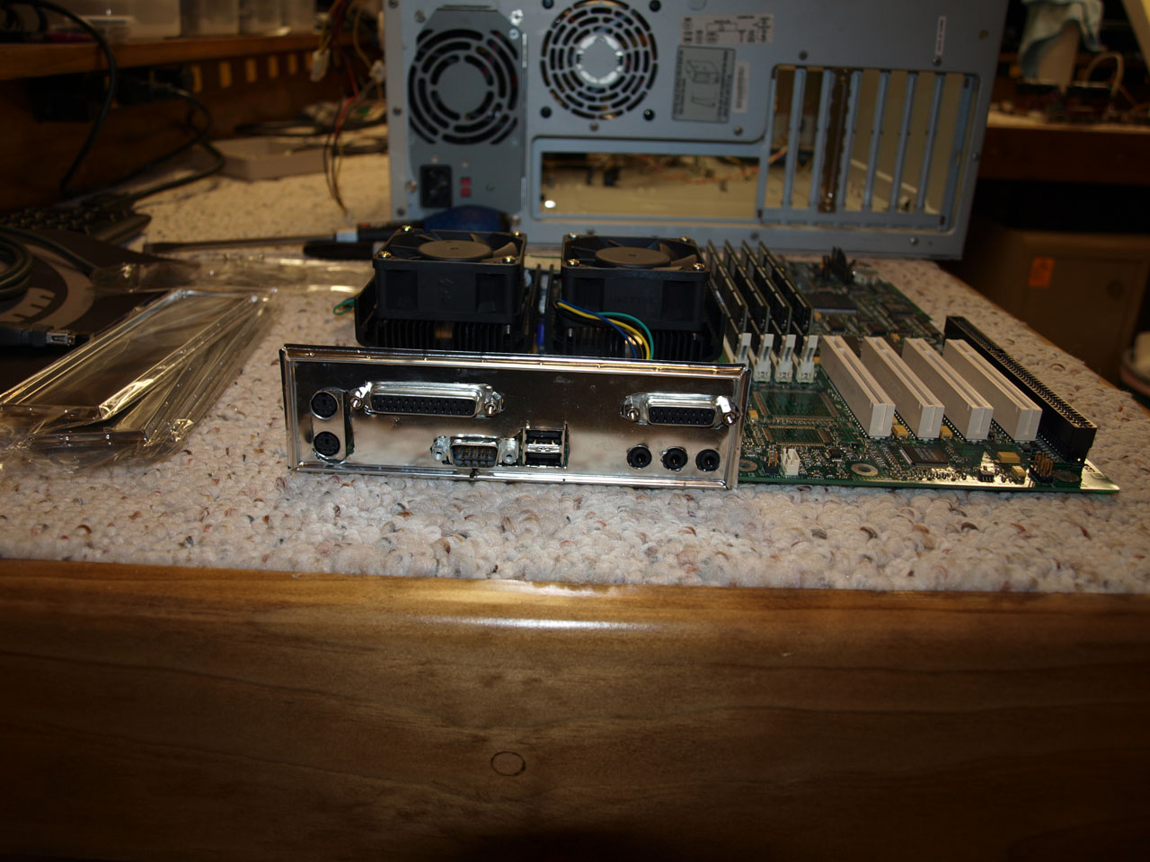

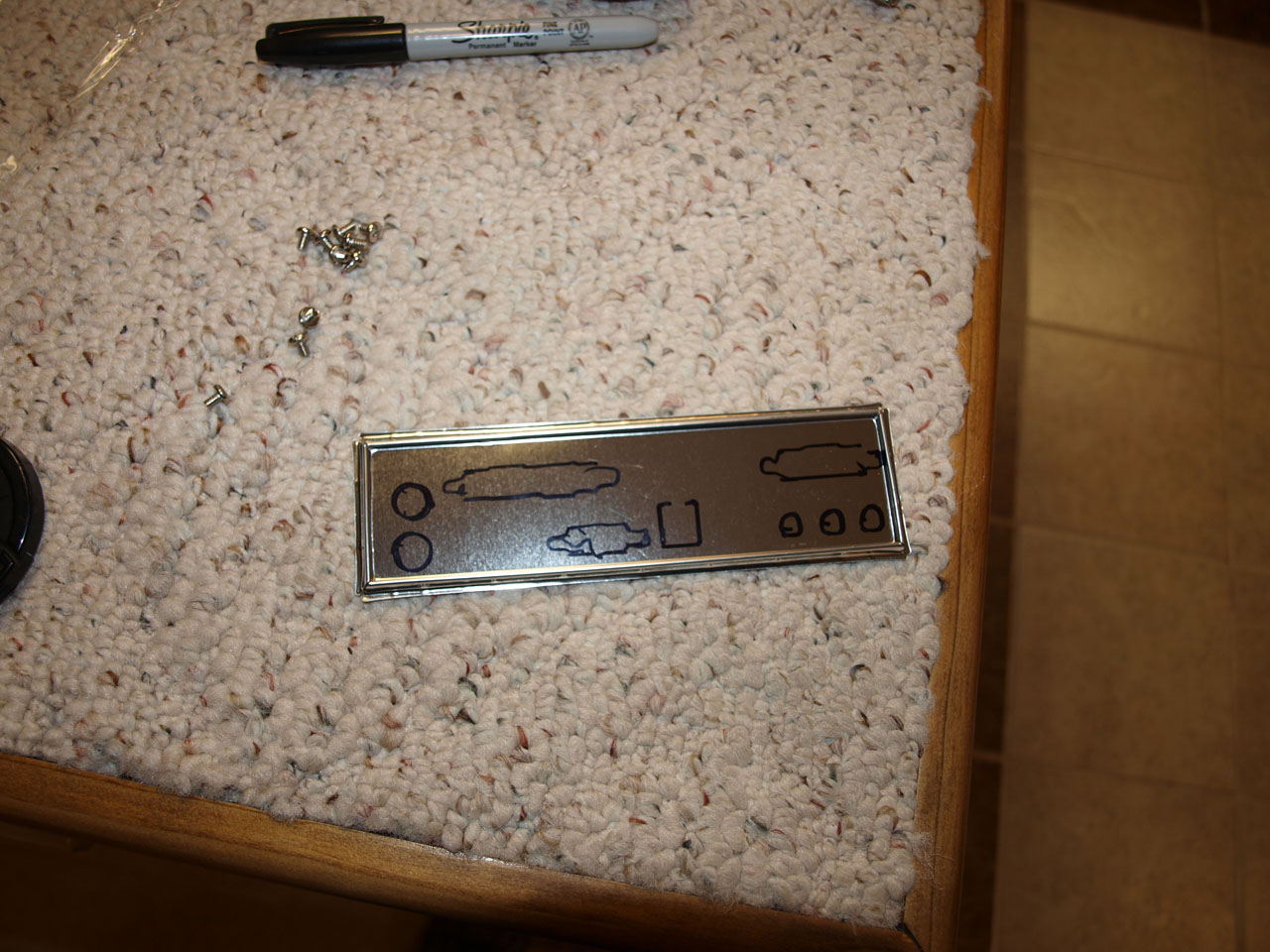

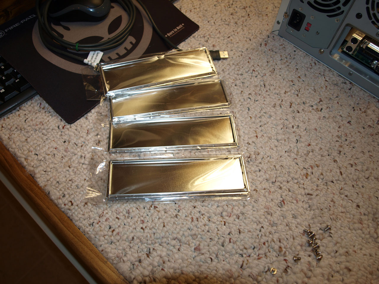

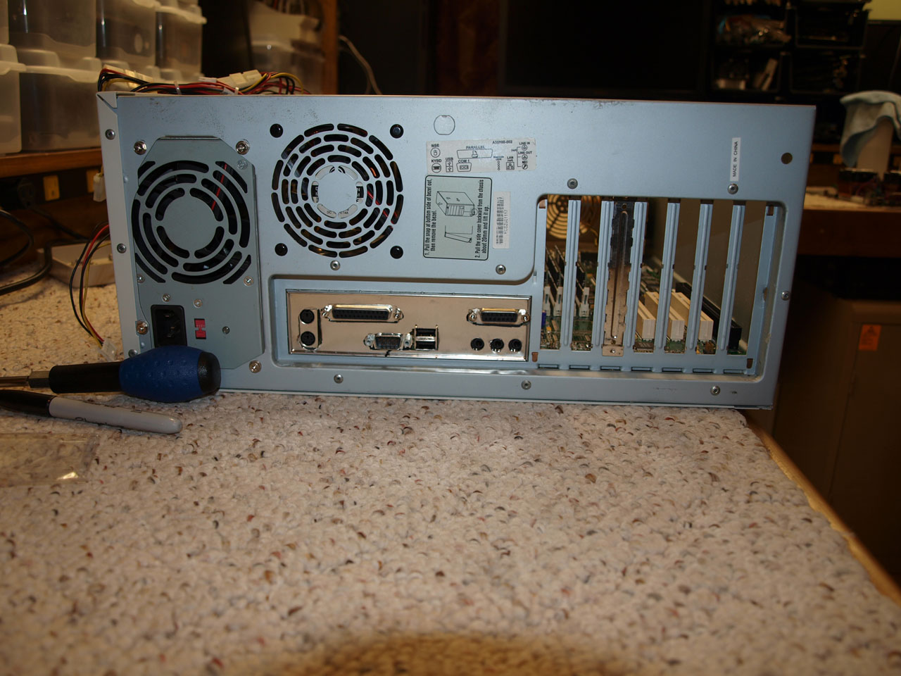

    Now for the goofy non-standard IO shield.....which I don't have, and after a year of looking I haven't found one....so....hmmmm
    I'm going to have to attempt to ratdude one from a blank....I got 4 of them so when I completely hose one I've got spares, they're cheap....Missing IO shields are one of my biggest pet-peeves.....it makes the system look so shoddy & incomplete.

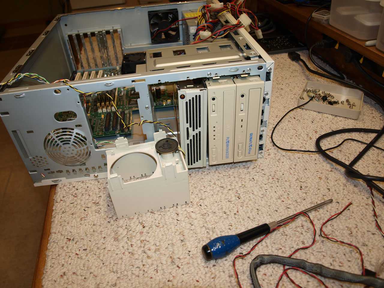

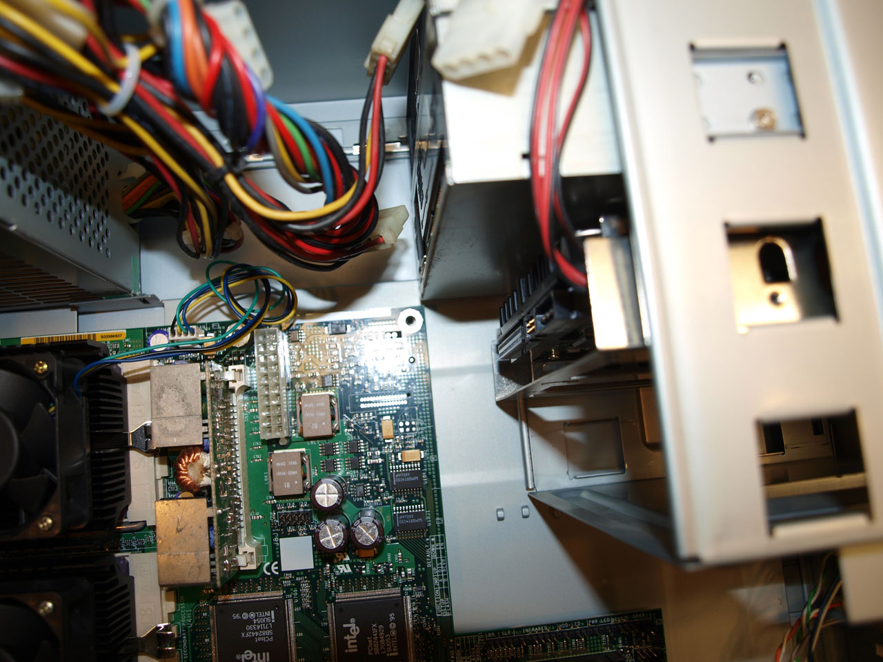

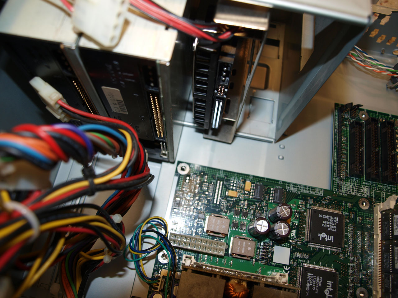

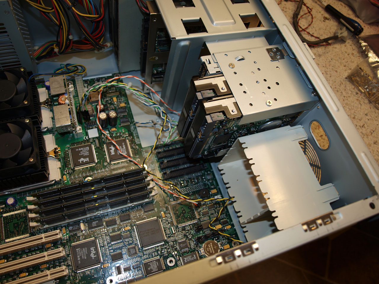

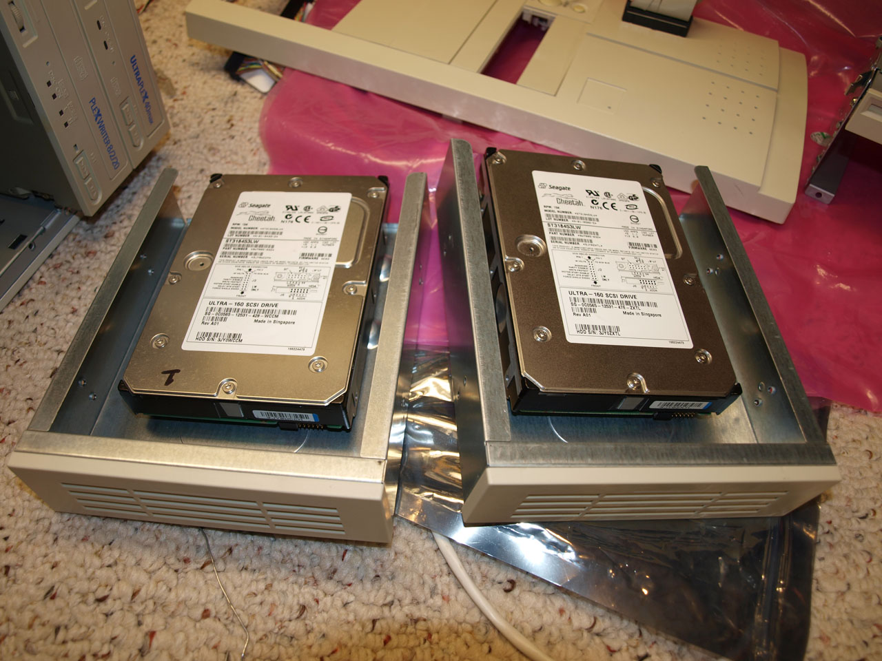

    Test fitting with drives in place....

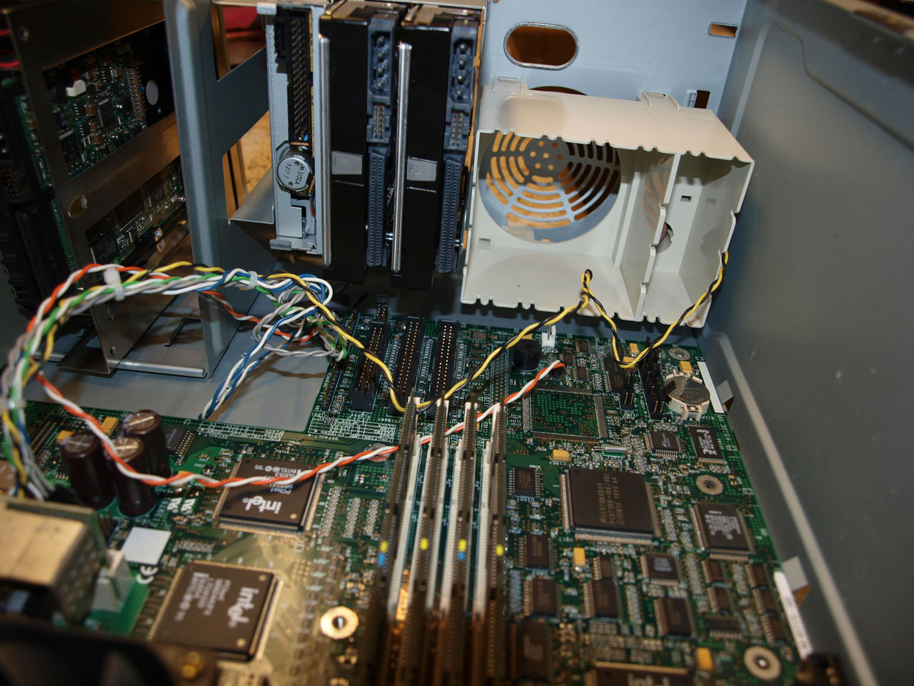

    Opticals clear the board in the corner by ~2mm.....Fanned HDD holder clears by more than plenty.
    Now the lower fan holder & 3.5" cage....all clear! There's a good inch between the board and the 3.5" cage, ribbons may be a little tight in there, but it's no biggie. There will be no IDE devices in this system, it'll all be SCSI. The only ribbon that will be connected there will be for the floppy, and it'll clear by plenty. The fan holder isn't a clearance factor at all.
    This will be a fun one!!

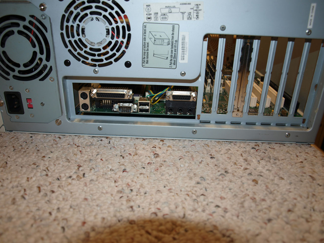

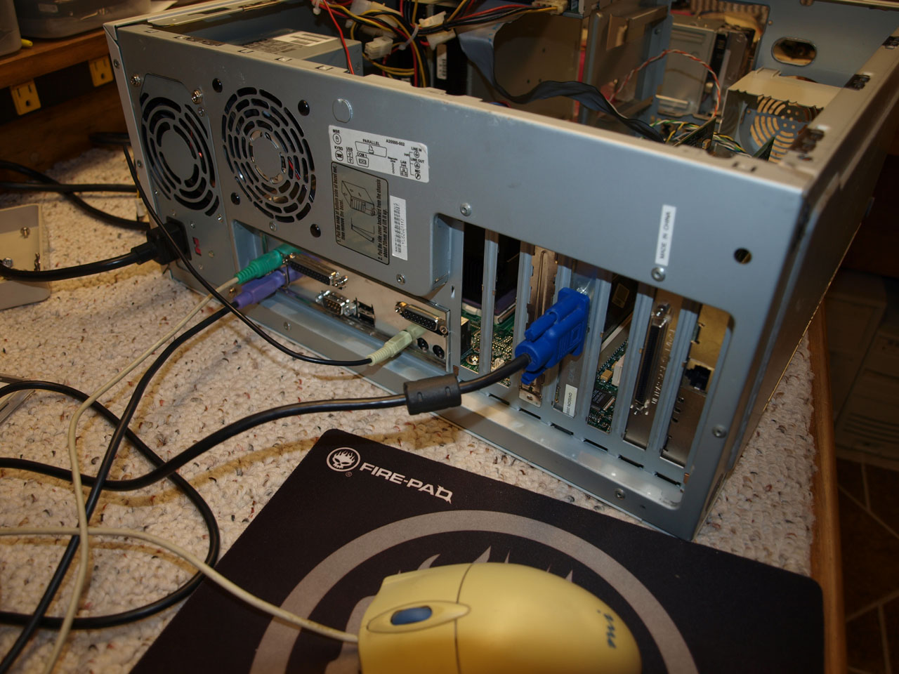

        Ok, first attempt at the IO shield, free-handing with a dremel....
        Marked, using some random IO shield for port patterns, that were measured off the actual board.
        ...and afterward.... Fitted outside the case....things lined up good....but in the case may tell a different story....
        Nope, still lined up!!
        Not sure if I'm going to take another crack at it to 'clean it up' a little....it's not perfect (and no hand-made IO shield ever will be).....but it came out pretty darn good!

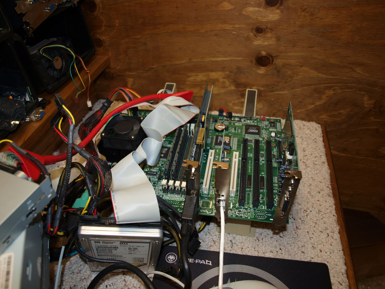

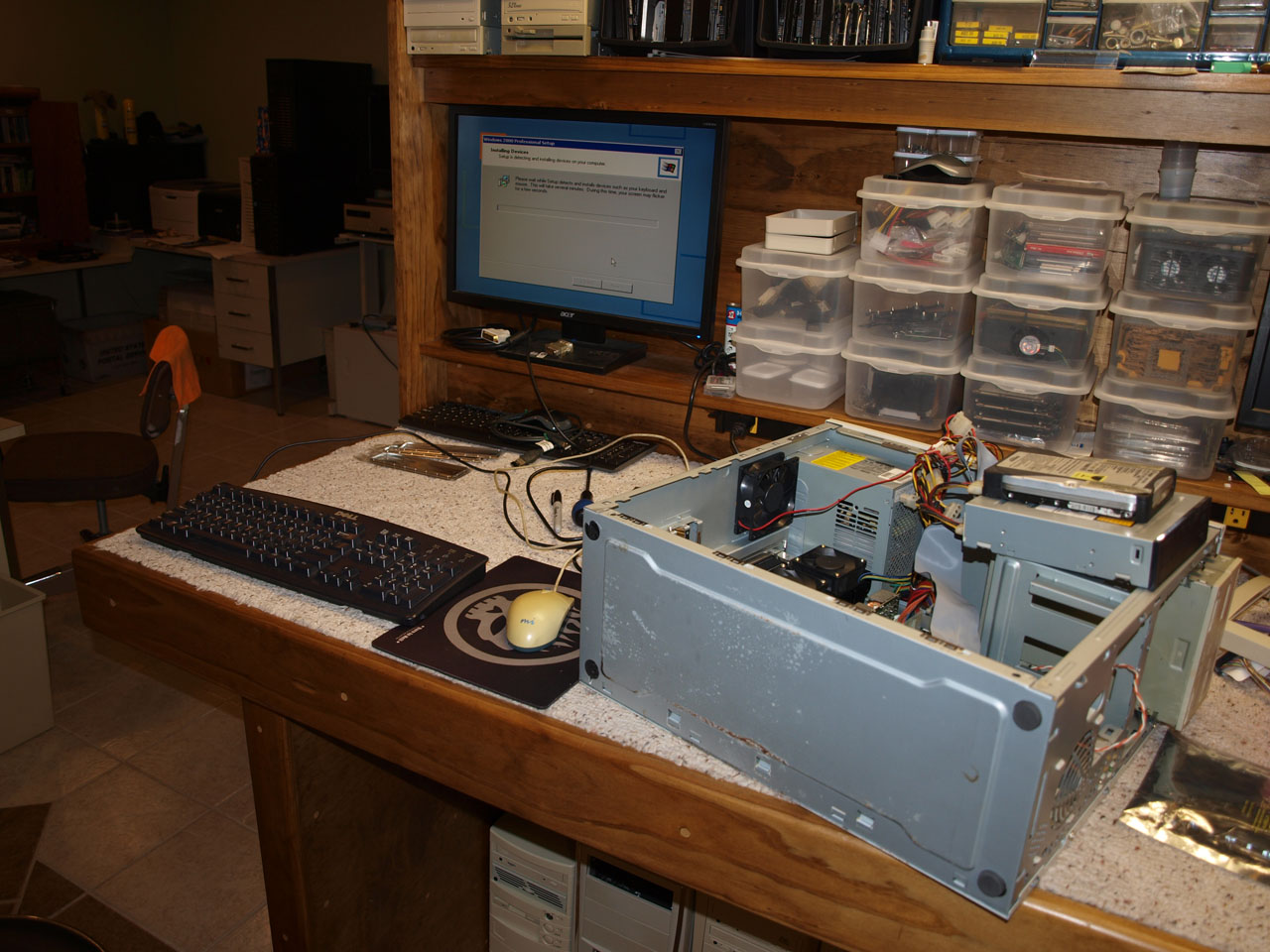

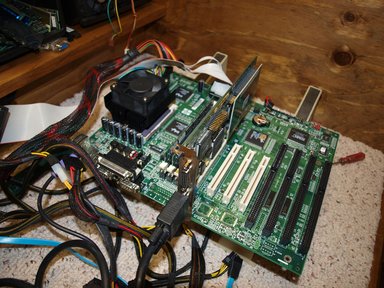

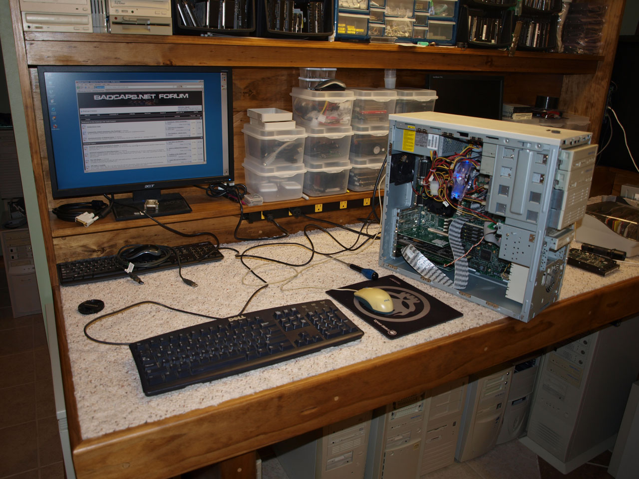

            A little today...I'm limited as to what I can do....I don't have a good GPU for this system, my selection of PCI video cards is limited pretty much to junk....so I'll have to look around...and I still haven't found the CPU's I want....but I did begin a little assembly & testing....
            I opted not to attempt a second IO shield, the first one did just fine.
            Motherboard mounted and a test mockup set. The test GPU is a 512k Matrox Millennium....weaksauce! The IDE drives are just temporary.
            Installing Win2k.

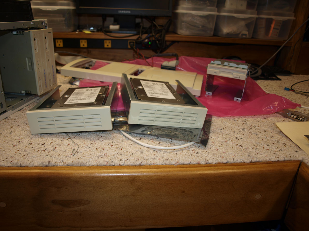

            The permanent drives (not yet installed). I need to find some more Enlight drive rails, I'm out of them it seems... The drives are a pair of 18gb 15k RPM Cheetah's.
            More later....

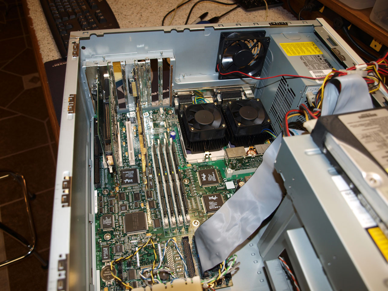

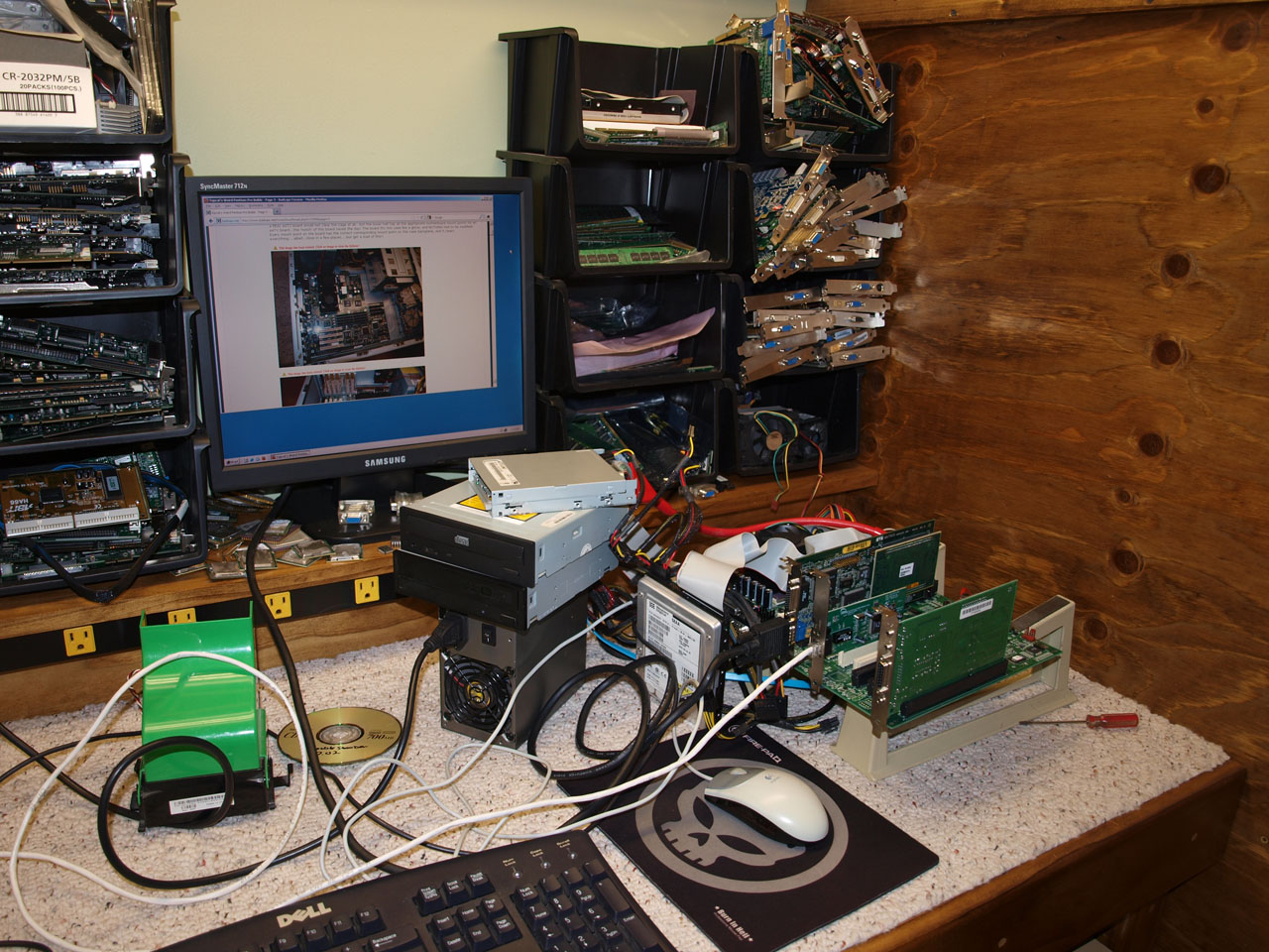

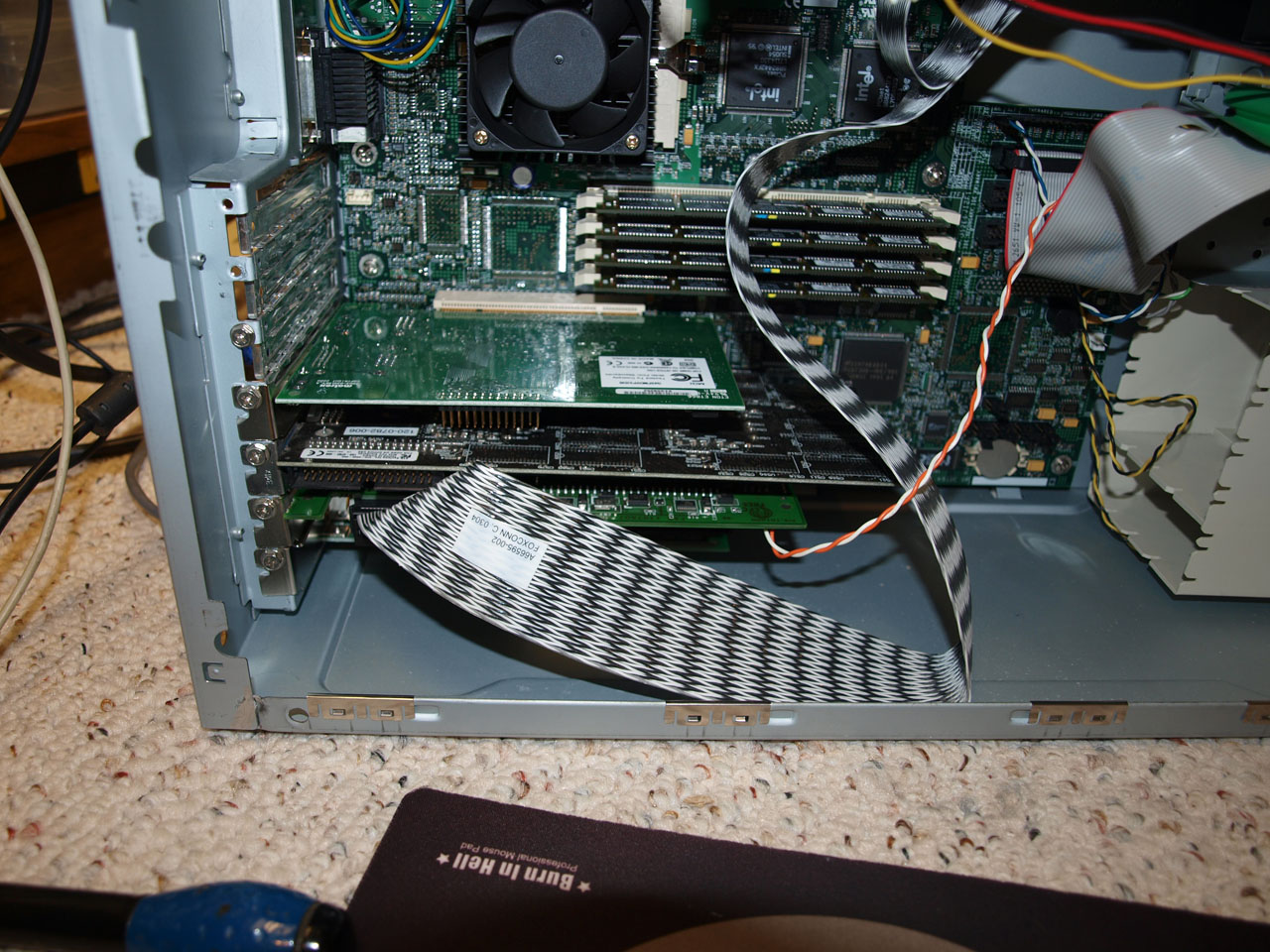

                Diddled around with this a little today...... Notice something awesome that's filling the formerly empty PCI slot?
                I spent $10 on ebay and grabbed a Matrox G450 PCI....those are very close to period-specific and were great 2D cards for the time. 3D will be handled by the mystery card under it.
                Atleast now I can have it in True Color above 800x600! MUUUUCH BETER!
                Things just kind of sitting...and what it'll look like when assembled. I still haven't grabbed any enlight drive rails yet, the bottom 2 drive trays are just sitting in there....the rails are ~$10/pr on ebay.
                More later!

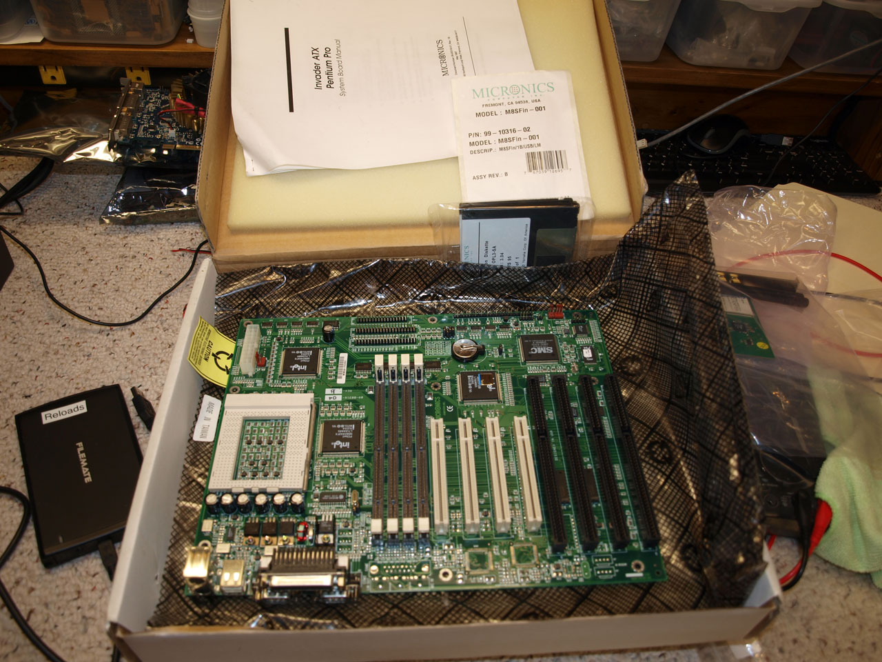

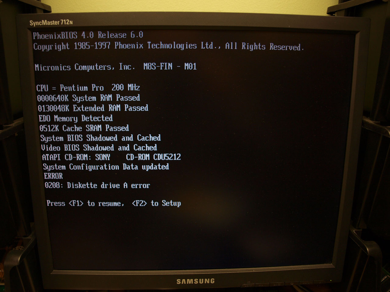

                              Just to complicate this build thread a little, the same source that I acquired the Intel PR440FX from said there was another one just like it here in some more tech junk....
                              Well, it wasn't identical....but close. It was a single CPU Micronics "Invader" (M8S-FIN) motherboard.... New old stock.
                              Blasphemous that this old soul had never had the opportunity to be ran, loved, and appreciated!! ...but y'all know me!! That's about to change!!
                              ...and here she is:

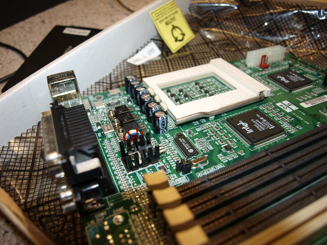

                              The first thing I noticed were the caps.... 85*c on a motherboard? Seriously? Some brand I've never heard of. Yea, that aint happening! I'm not even going to fire it with these, although they did *appear* ok.
                              Recapped with some Rubies and test fired. The first thing I always do with boards like this is check for BIOS updates....this board is so obscure, I couldn't find any BIOS information on the interwebs...
                              Win2k installed on a test drive. Everything is working and happy.
                              Not sure this ones path....but it certainly deserves a build....
