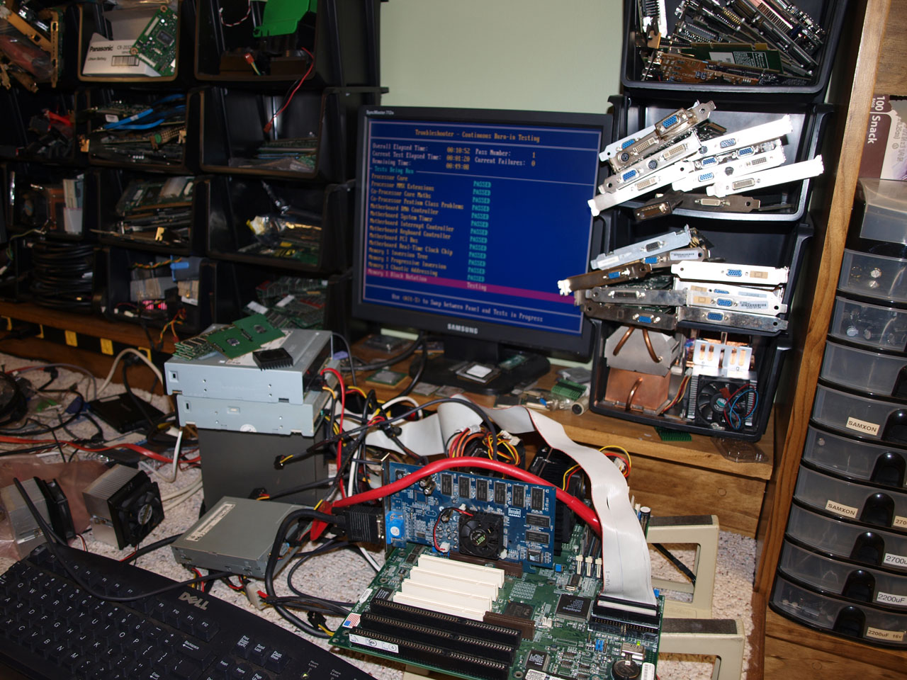

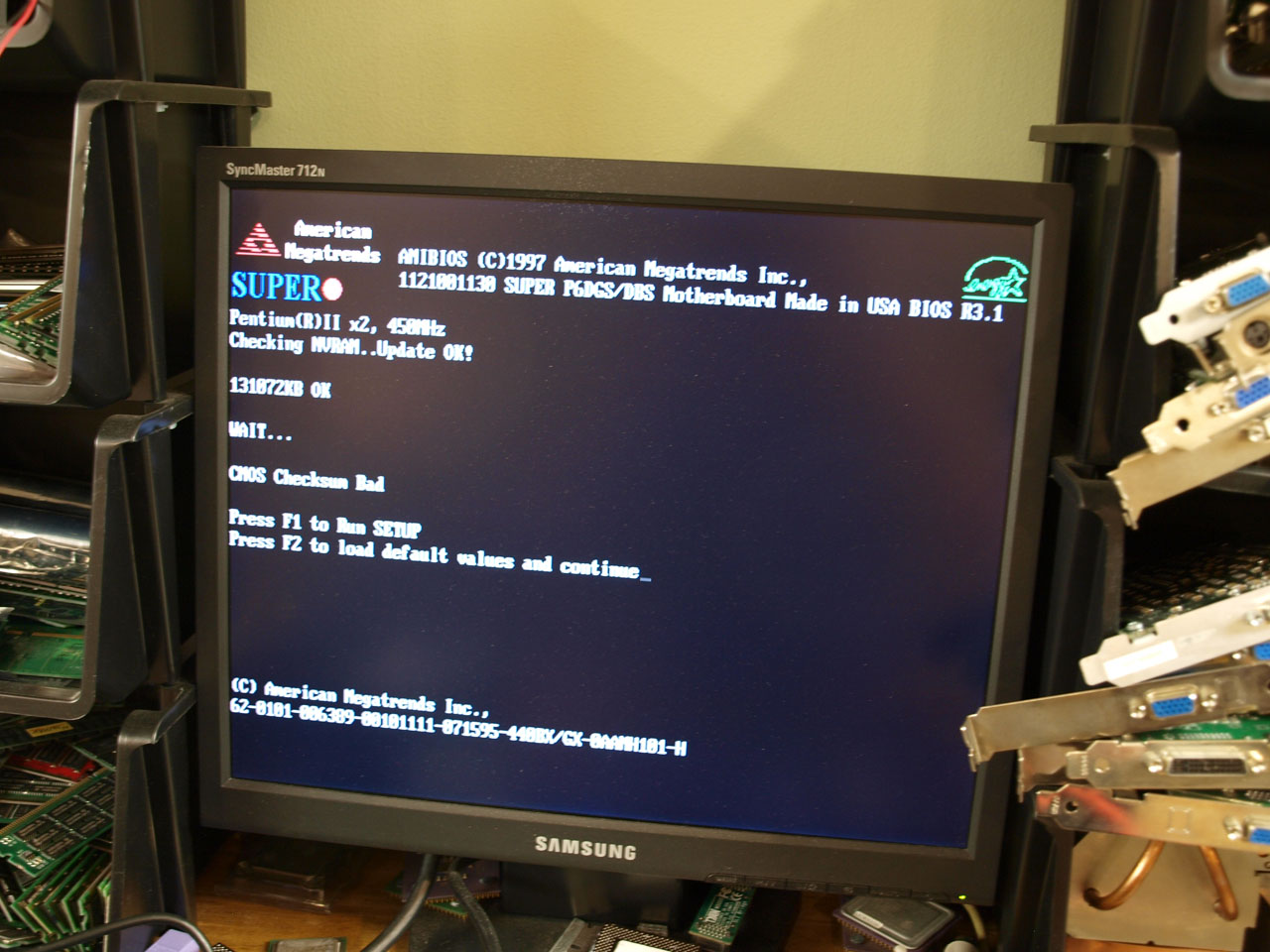

    Test CPU's right after updating the BIOS to the latest. It had 1.0 on it (first release). It's now 3.1.....

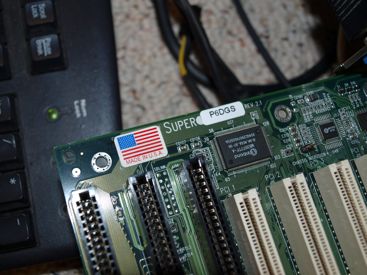

    Only damage I noticed was one memory slot latch was broken....it didn't affect function at all. Caps appear ok....but it has a bunch of those weird/fake NRSY caps that Supermicro was known to use back in those days.
    Uhh ohh....From Russia with love, but Made in the USA? hmmmm
    Testing functions, no issues....that's as far as I've gotten.

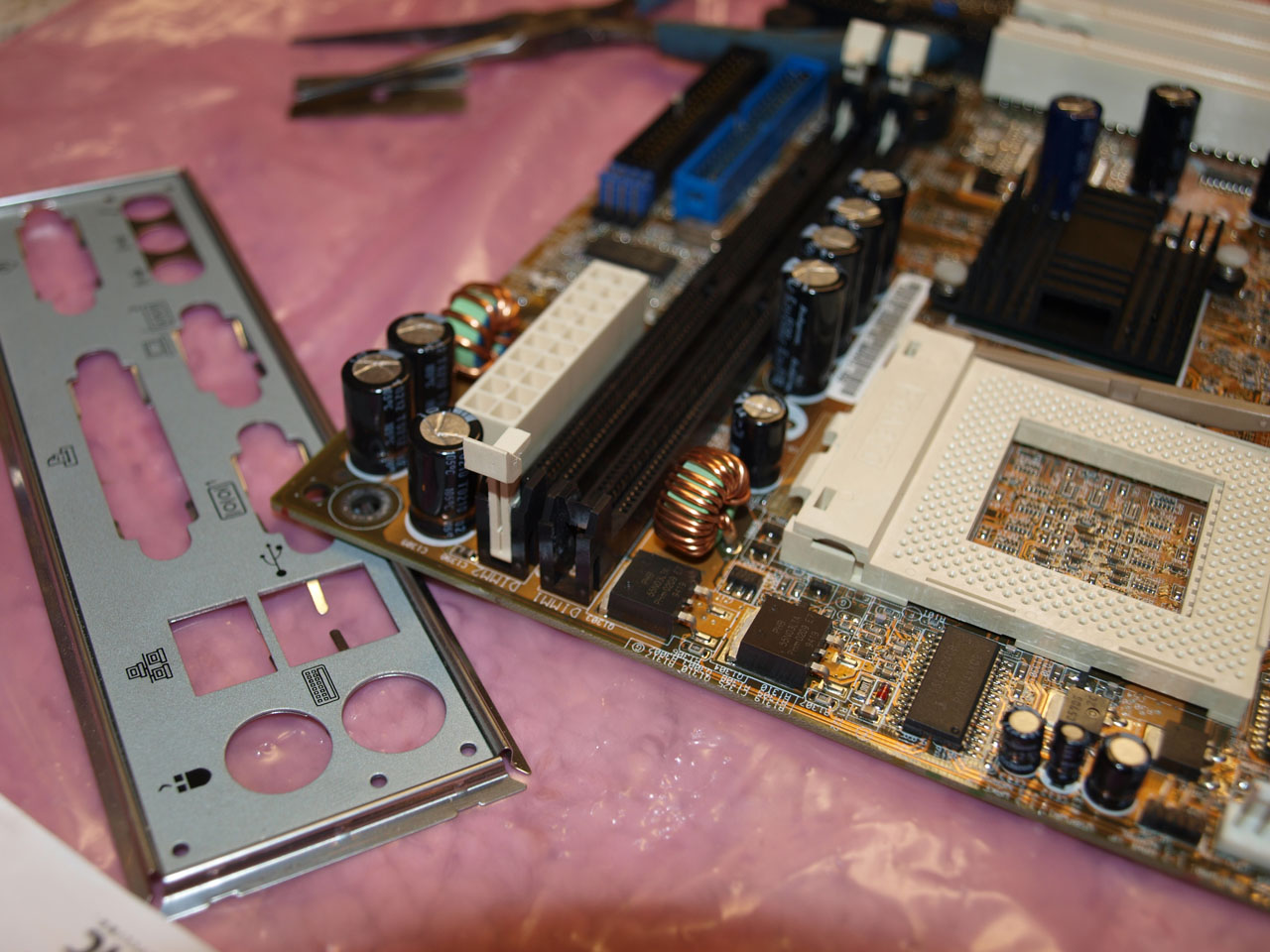

          Re: BCN's Russian Ties! Supermicro P6DGS Build

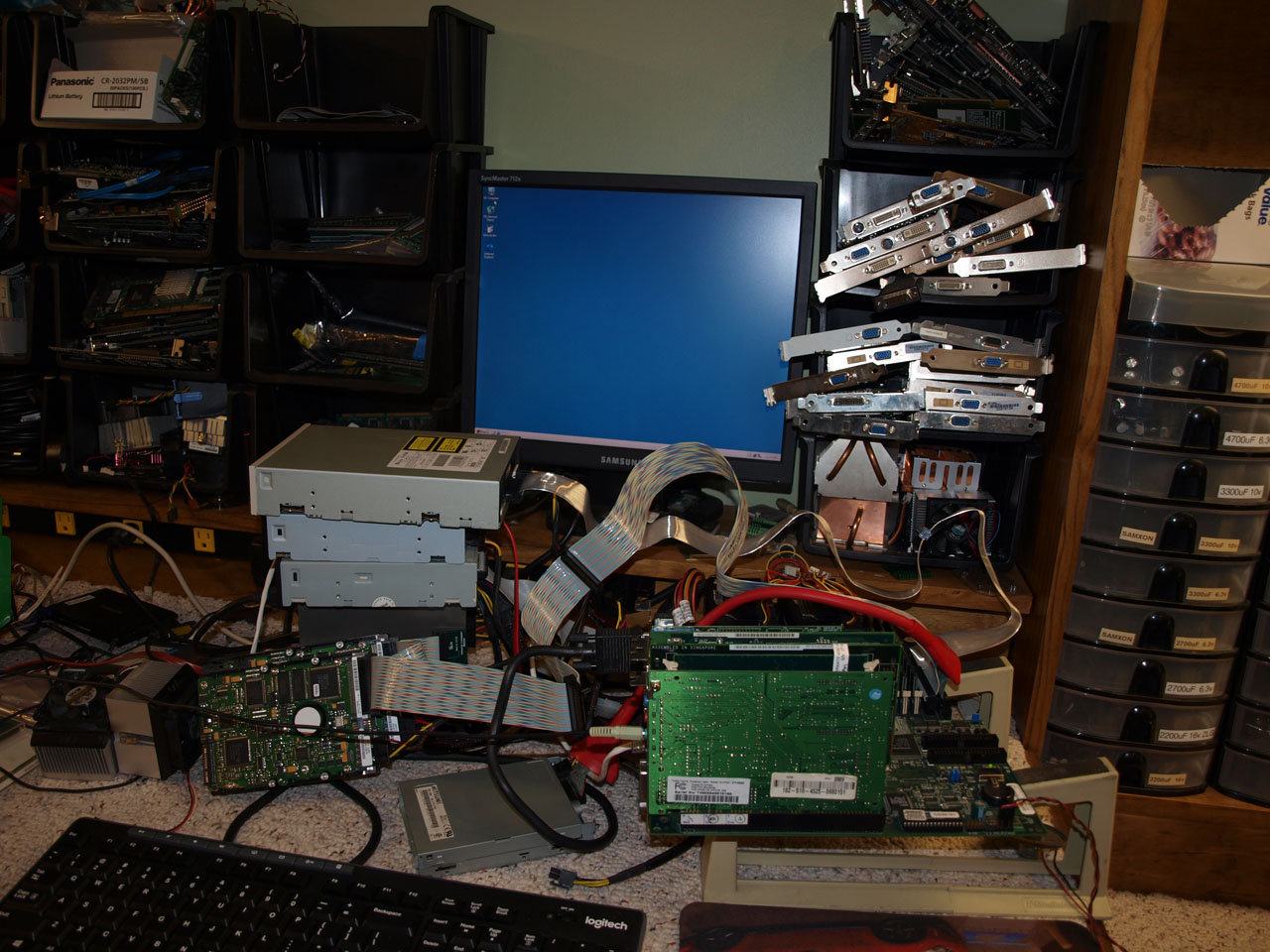

          I forgot to dump the camera today and update this thread before getting into construction mode....
          I did repair the broken RAM slot latch. The slot & latch holder was not broken, just the latch itself. I found a junk board that had the identical style latch, and surgically removed it... I then snapped it into the memory slot holder on this board.....the aftermath was perfection!
          I also tossed 2gb of RAM I had and W2K on it...functioned without issues. It just dawned on me, I don't have any slot-1 CPU's left that are faster than P3 700's....so I just left the P2 450's in it. I did track down the ARO-1130C (with the upgraded 16mb module) raidport controller for it for $19 shipped.

          • Topcat
            The Boss Stooge
            • Oct 2003
            • 16959

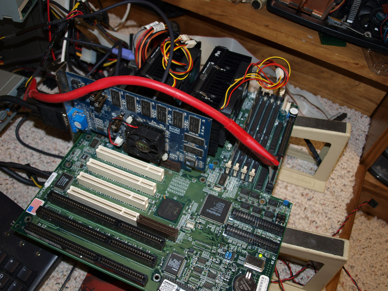

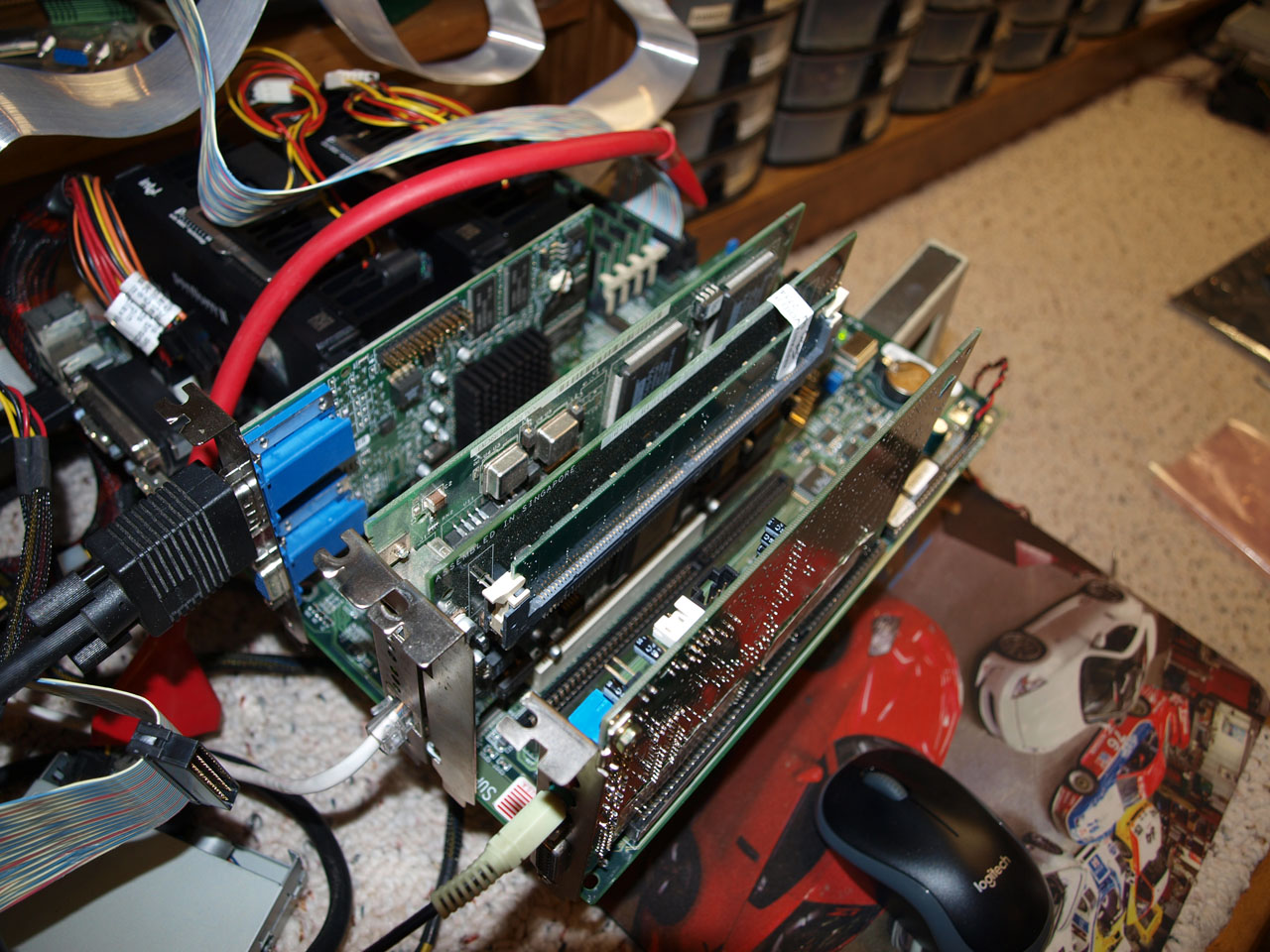

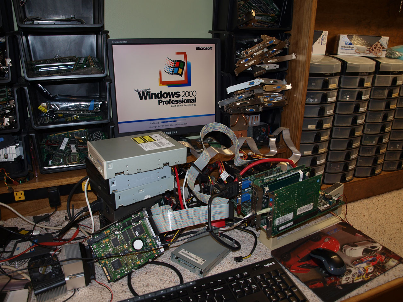

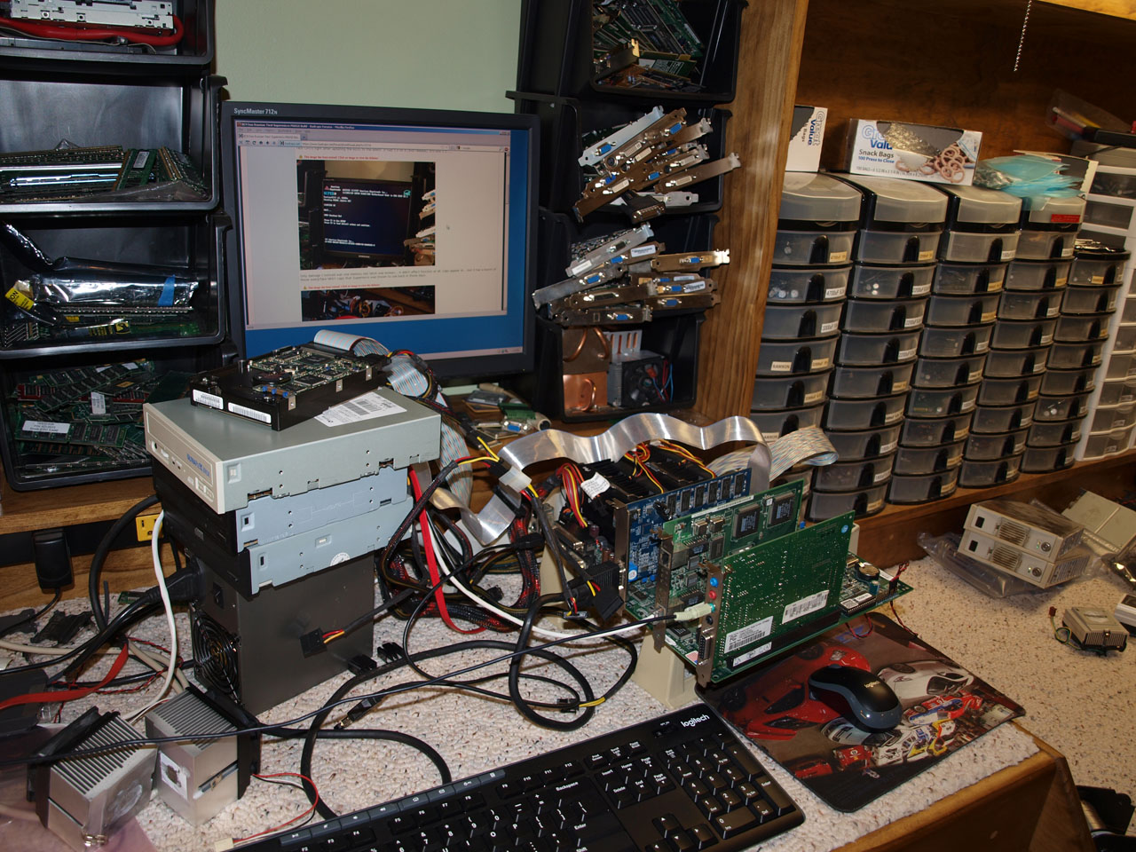

            Ok, I remembered to dump the camera.......so some pics.
            The 'sacrificial lamb' for the RAM slot latch:
            Like it never even happened!

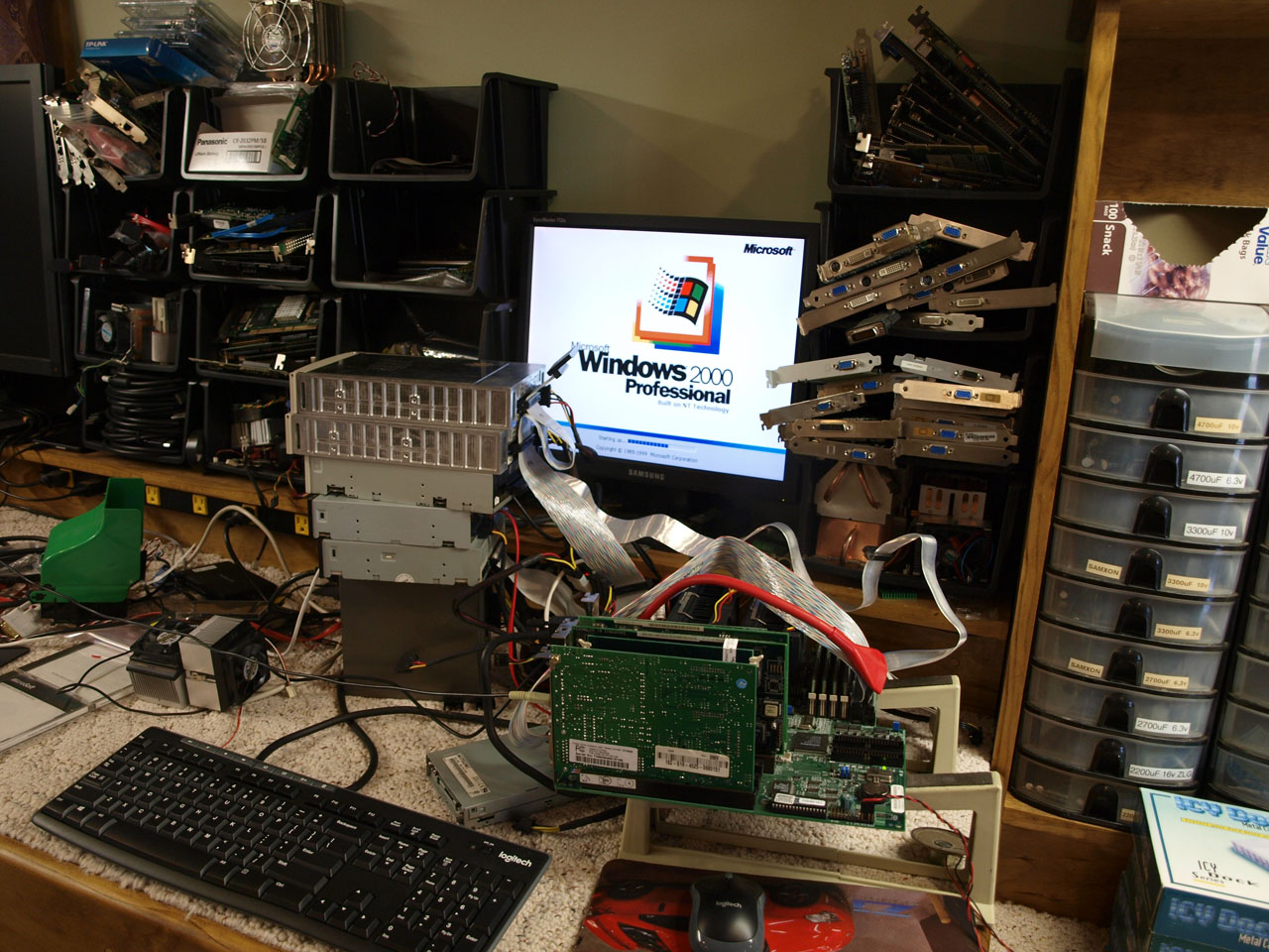

            The Test bed:

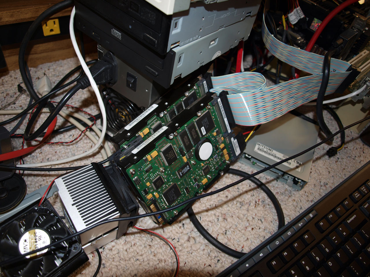

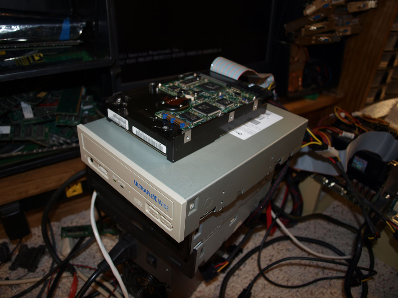

            More plextor goodness and a 73gb 15k test HDD

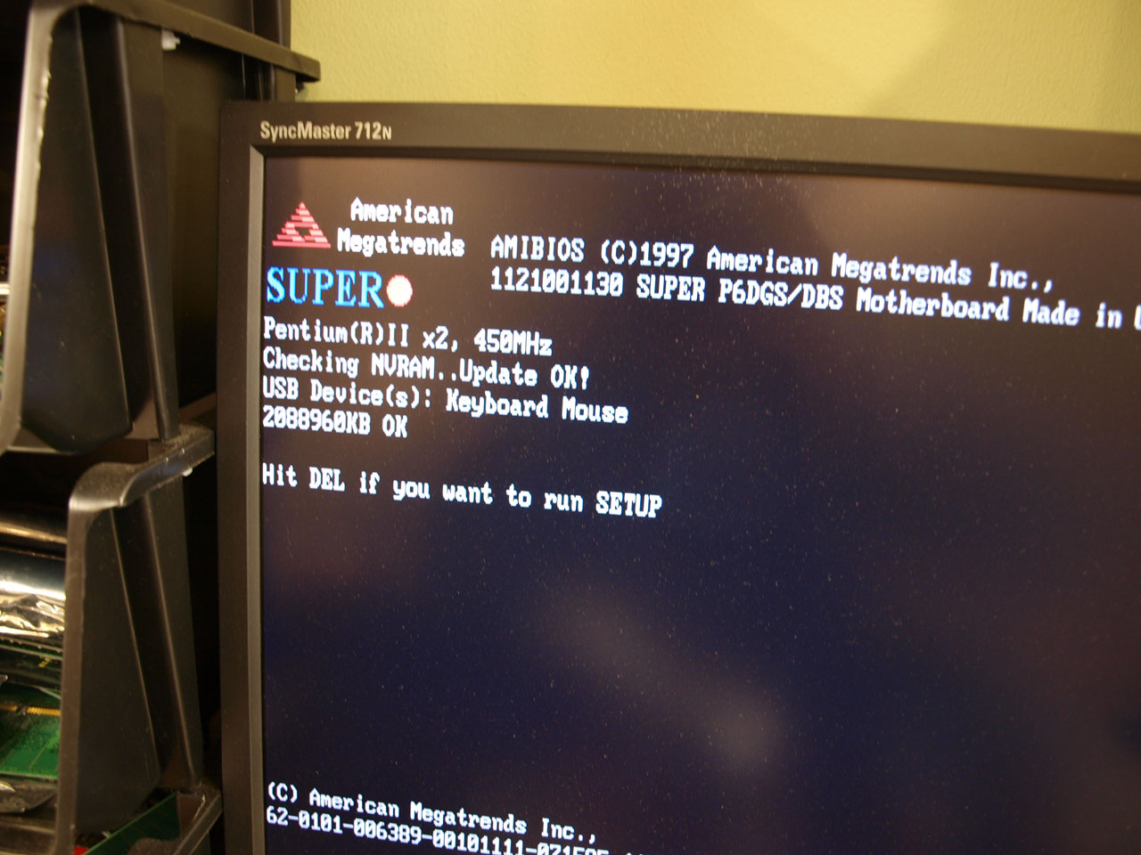

            RAM @ 2gb
            Alive & well.

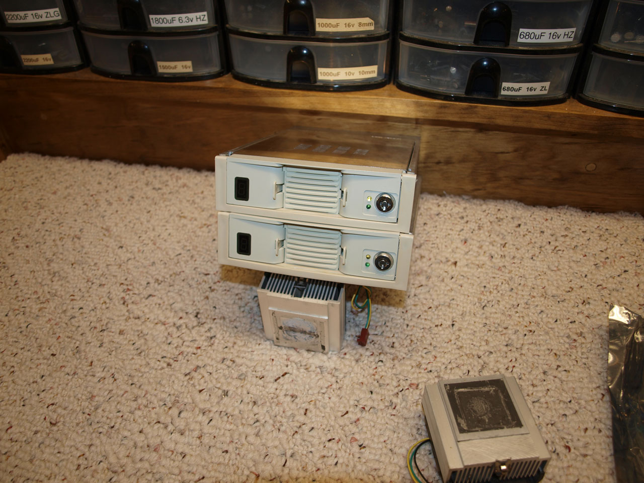

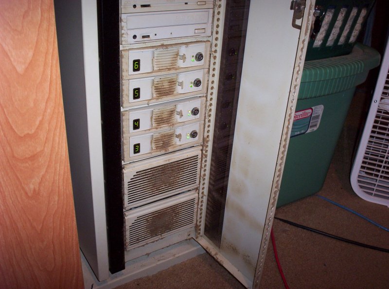

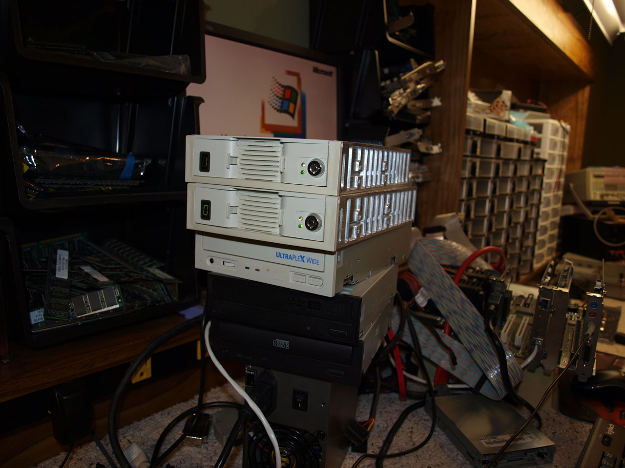

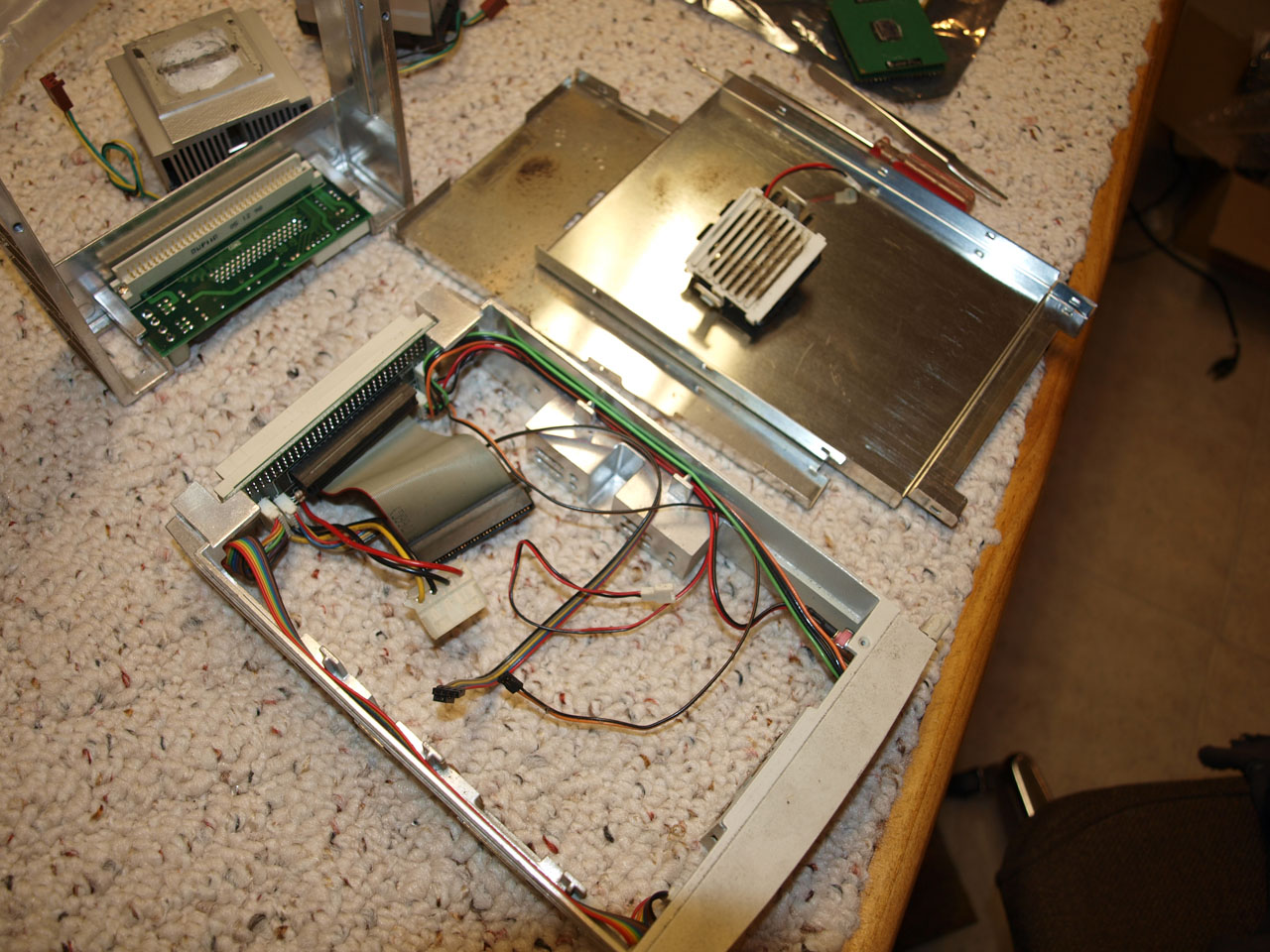

            Now, this is where it gets good! Some original icydock goodness. I've got 4 of these (for 68-pin scsi), bought new in the 90's...but 2 of them are MIA....for the life of me I can't find them. They've been stored away since around 2002. I also have 4x of these NIB for 80-pin SCA. They have been found. They're solid aluminum and very well built...a trait that PC's lack these days.

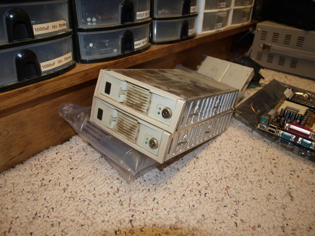

            This is some 16+yr old dust!

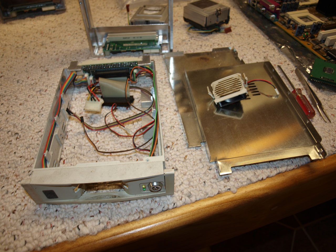

            Disassembled.
            Thoroughly cleaned (hotwashed in the sink) & fans disassembled, greased, and reassembled.
            WTF is this!
            That's all for now....

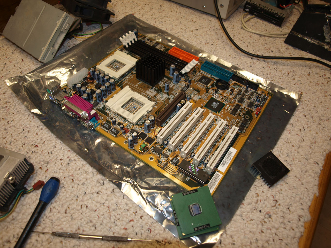

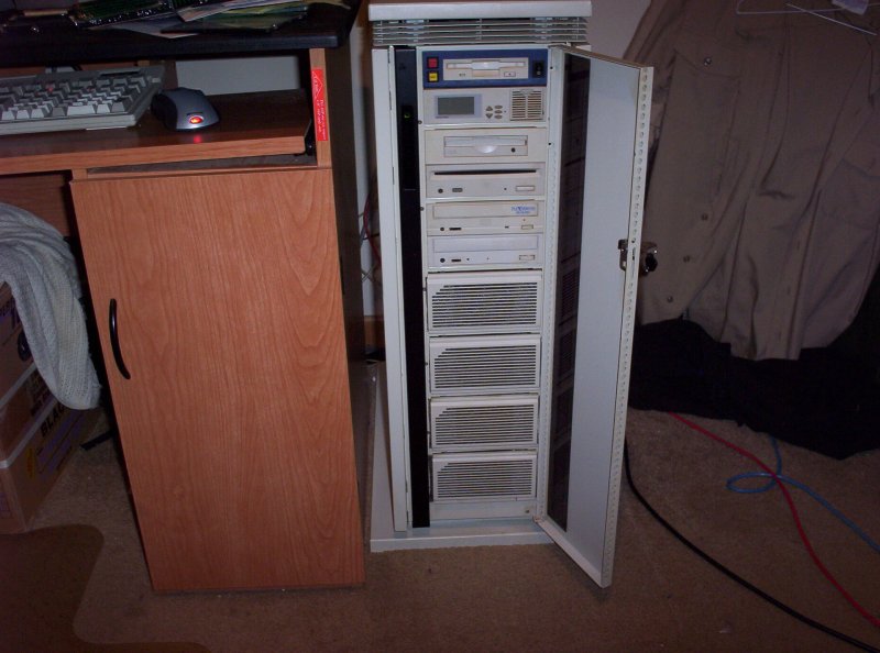

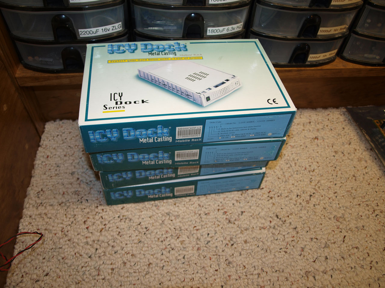

                  No, I sold all those off....I hated every socket-A system I ever had, even the dual ones. This is a trusty VP6.
                  I still haven't located the 2 missing icydock racks....They were removed from service in June of 2005 and replaced with something different:
                  Before:
                  Removed, system cleaned, and replaced with these:
                  Those photos were taken in June of 2005 in the same photo session....which told me when they were taken out of service, and haven't been used since. How or why the icydocks got separated over the last 13 years is yet to be explained....I have no earthly idea. I knew where they *should* have been, but when I opened that box, I only found 2. They've got to be in the building somewhere....but all the places I could imagine them possibly being, they haven't been there.... I still have the other set of 4, new in box that are made for SCA 80-pin SCSI, but I've got another build in mind for those. I do have this pair, which will work for this build....but I tend to not lose things, so these 2 missing ones are driving me f*cking crazy!!

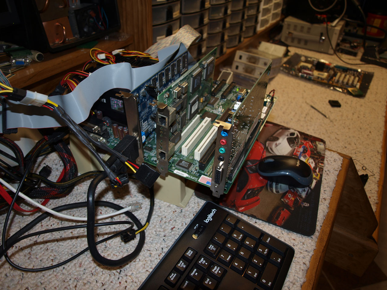

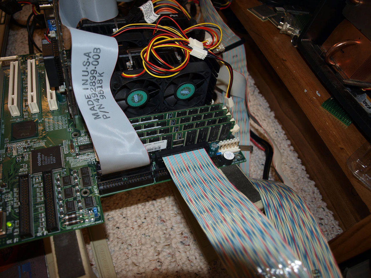

                    The ARO-1130C showed up today, horribly packaged and no anti-static material.....as if by some miracle, it did work....atleast through the firmware 'marriage' process which you have to go through every time you stick one of these into a different board. I'll set up a RAID on it tomorrow and make sure the rest works.

                      The RAID controller (inspite of its horrible packaging) works. I used my last 2 IBM 9.1gb 7200rpm HDD's. OS installed.
                      Dusty, yes.....it'll all get a good cleaning before assembly into a case.
                      The icydock racks.....yes the other two are still MIA.....son-of-a-b....
                      The 4x new in box SCA icydocks....I've got anotehr build in mind for these.
                      I have a case in mind for this one....but it'll take some work to get it there.....so it may take a little while...
