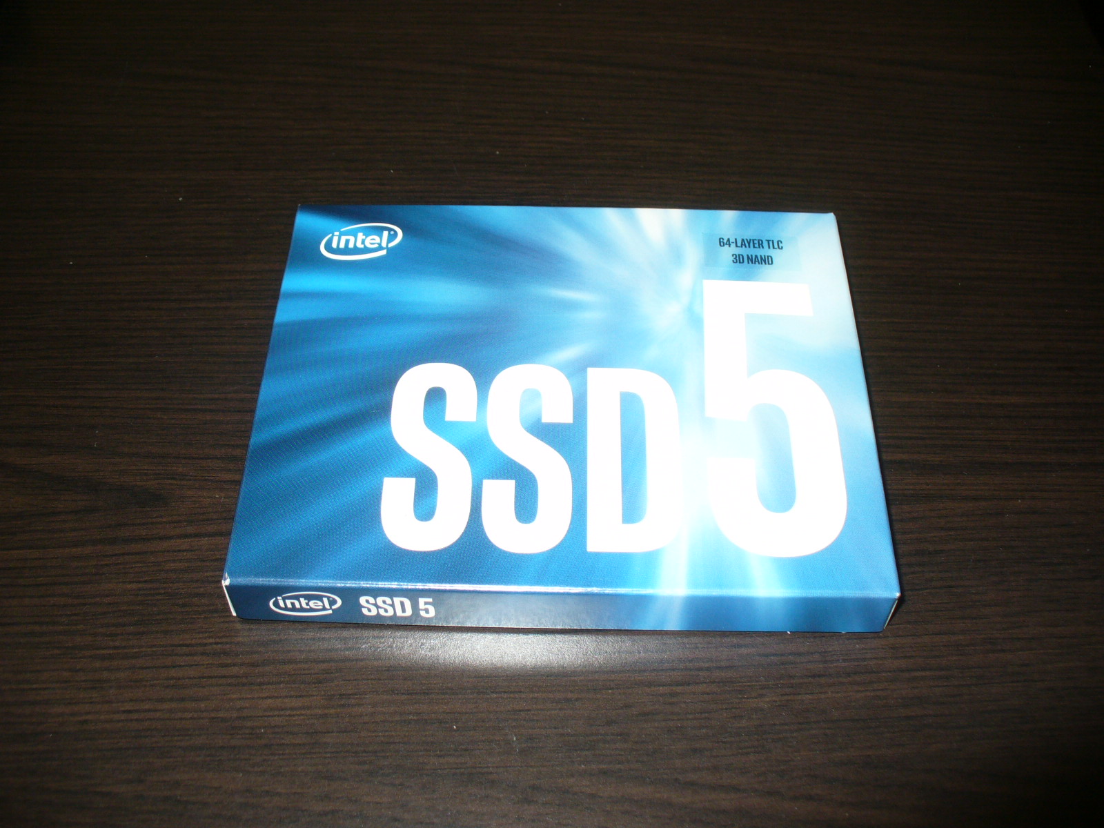

Bit the bullet... and bought an Intel 545s 256GB SSD. I'm in Canada again (another company trip), and Canada Computers had a sale (to match Newegg). Yes, I got raped on sales tax (yay Ontario
) but it needed done, and I had the motivation at the time (along with the tools needed to make the swap, I came prepared.
Pictures:
Shiny packaging:

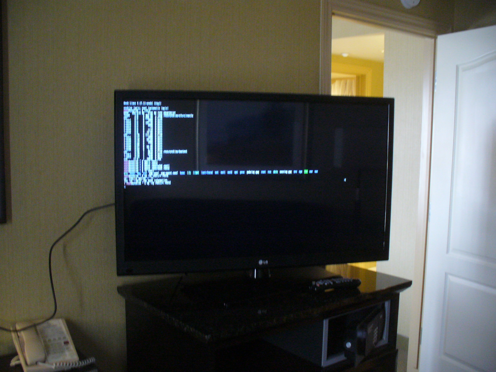

Apparently live arch sticks support HDMI; here's how I found out:
This is what I use hotel room TV's for... otherwise they're brainwash/idiot boxes that I have no use for most of the time. But they do work as a good 2nd monitor and external speaker system

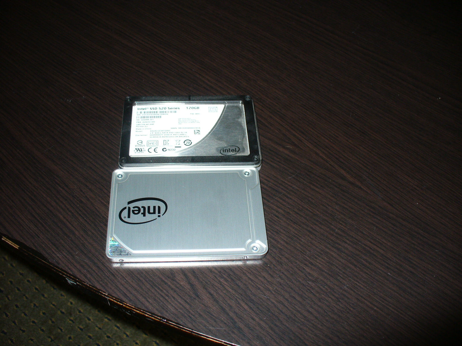

Old and new drives:

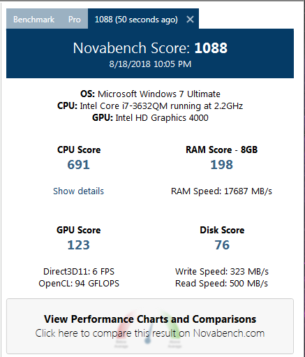

Getting the new drive to run both OS's was fun. The linux part was easy (done it a million times, no sweat)... migrating the windows install was trickier... discovered what "active" partitions are, and once I "activated" the new partitions, I was able to use a windows 7 recovery disk (USB made from the CD ISO) to make the drives bootable from GRUB. All well now... and from the testing I've done, much faster. My disk speeds are no longer the bottleneck as per the windows performance index (went from 5.9 to 6.5, drive speed maxed at 7.9 :P ). And I did novabench it:
As for the old SSD, luckily I was able to remove the black trim ring to slim the drive down; it's now in the keyboard base of my Asus Transformer T200TA (as it's too small for any of my other laptops in service to not have the same problem, but too good to toss/shelve). That poor thing only has 64GB internal storage (and that's double what the base model includes
); good thing ASUS gave some provision for expansion.
