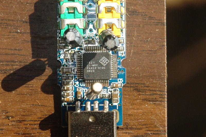

            I was unable to find anything on the chip that identified a manufacture so here is a pic of the chip if anyone can help me out.
            Thanks,
            yonu

              The chip marks aren't useful: the only reference is a post on the NSLU2 Linux wiki for a sound server mod. One guy bought an usb sound card with the same chip and managed to hear only heavily distorted sounds; attempts to find the manifacturer were unsuccesfull and he links a picture where the chip is claimed to be a fake.
              After the fake Kingston pen drives scam, our beloved chinese crap manifacturers are moving to counterfeit usb audio chips?
              Anyway post the USB ID (just read it with "lsusb -a" on a linux console or under Device manager on Winows): unless it's fake too, you can know at least the manifacturer.

                it actually has 2 ids one on the hid side and one on the audio side
                Hardware ID HID\Vid_0c76&Pid_1605&Rev_0100&MI_03
                Hardware ID USB\Vid_0c76&Pid_1605&Rev_0100&MI_00

                      that VID points to JMTek, one of those HUGE OEM manufacturers.
                      i'd say if that chip is a knockoff, it's probably designed after a C-Media chip (CM10x).
                      but even with those you wouldn't have much luck with the firmware thing.
                      maybe you can find a workaround... i.e. some device that connects them in a specific sequence after the os has loaded, with some pause in between.
                      you only need 2 lines per device (D+, D-) so this could even be done with relays.
